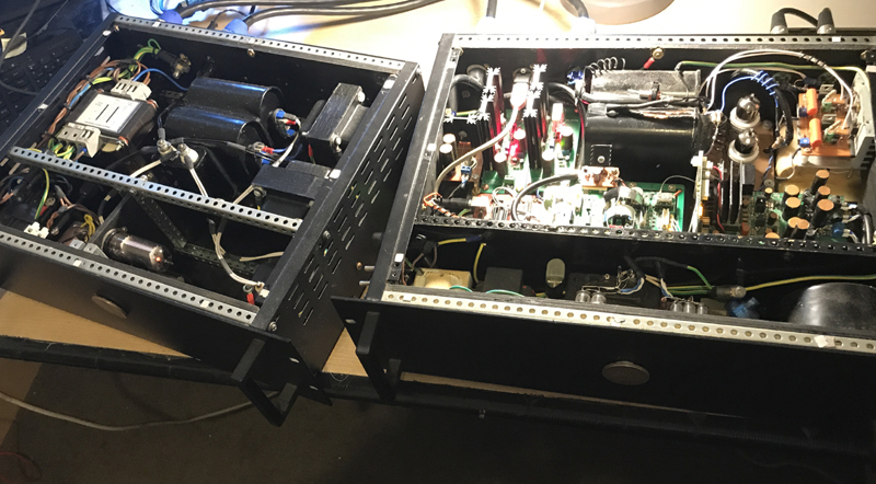

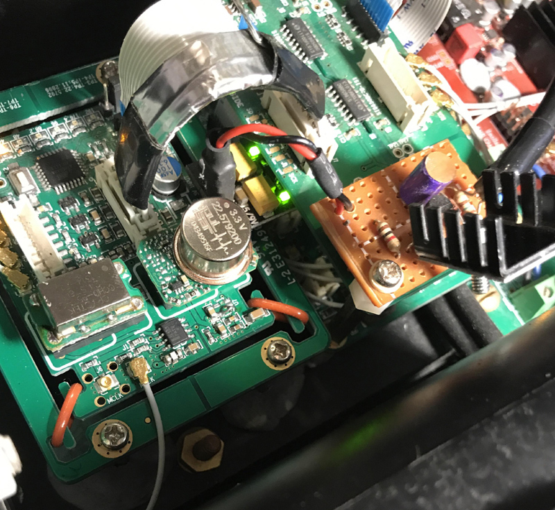

Another Pulsar Clock making music!
I have replaced 22.xxxMHz Crystek with same value Pulsar Clock, also modified Ians Dual Clock board to bypass his on board LDOs and utilised Pulsars ADM7150 Power Board.
What to say.. all you read here is true. I was expecting a difference, but the magnitude of difference is so immediately obvious and not at all subtle.
Not cheap, but all considered.. probably the best money I've spent in audio for quite some time. Like they say, once heard, you cannot un-hear it.
Cheers to Pulsar for the new year, and a special thanks to them for making this product available.
