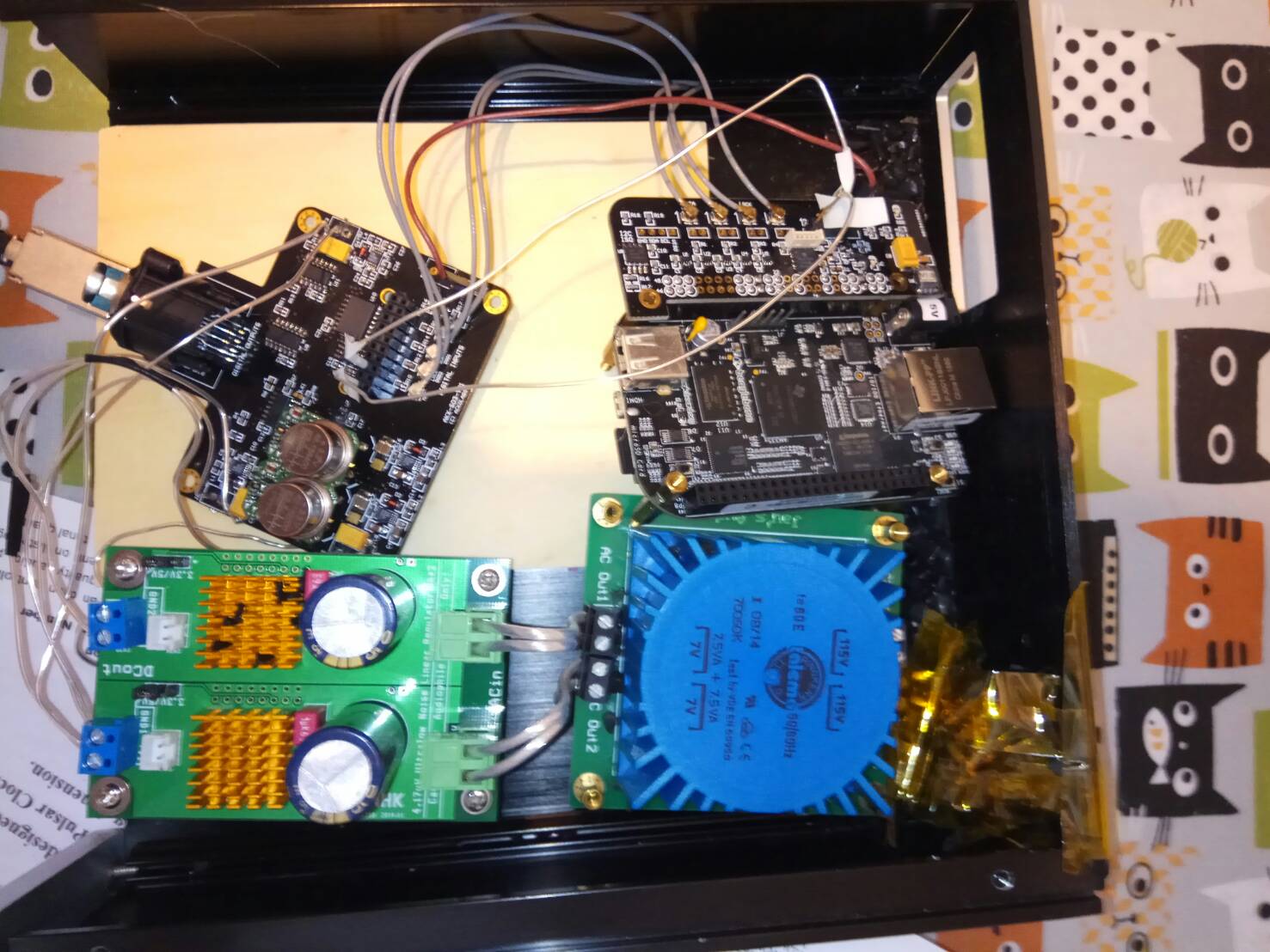

It can improve significantly my system to higher level. My system is Burmester 961, Burmester 032, NorthStar Excelsio and digital music file player including NAS, beaglebone black, ACKO new S03 (isolator and re-clocker). The quality of the network cable between NorthStar Excelsio and ACKO S03 is very important. I use Oyaide CAT7 IS-707 network cable and LINKWAY toolless RJ45 is similar with BIGtec RJ45. LINKWAY is Chinese company. LINKWAY toolless RJ45 can buy from https://www.aliexpress.com/store/pr...32766739328.html?spm=2114.12010608.0.0.L7QyfH
