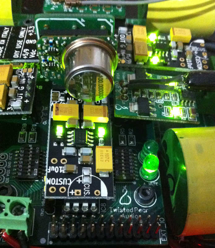

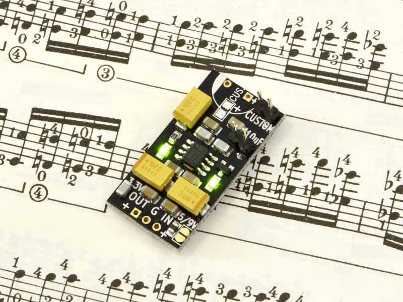

ADM7150 for clocks and DACs

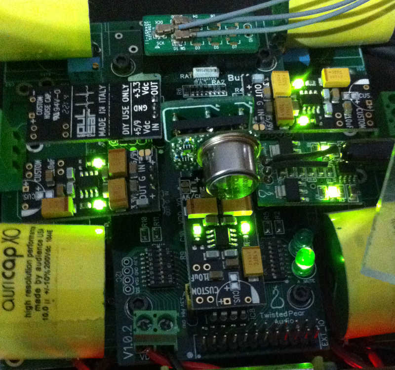

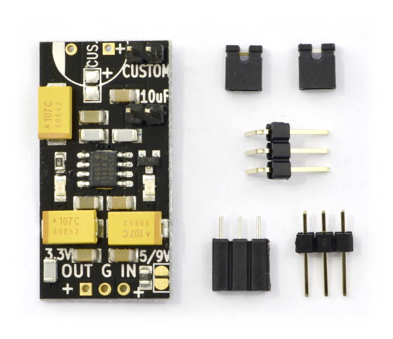

To work at their best the most performing oscillators need a good power supply; we designed the Pulsar Power regulator based on the ultralow noise ADM7150.
The board is ideal to power the most demanding oscillators and both analog and digital DACs sections.
The gold plated board provides a +3.3 Vdc low noise output regulated voltage accepting in input a voltage in the +5 and +9 Vdc range with up to 800 mA output current, compatibly with thermal environment.
To enhance the filtering capability both C0G, Tantalum and X7R technologies are implemented on the whole regulation line.
During the design tests it appeared clear the great influence of the Cbyp capacitor, the ADM7150 noise spectral density roll-off capacitor, so we allowed the user to customize such capacitor, both SMD and/or TH, with an easy jumper selector interface to calibrate it for best performance.

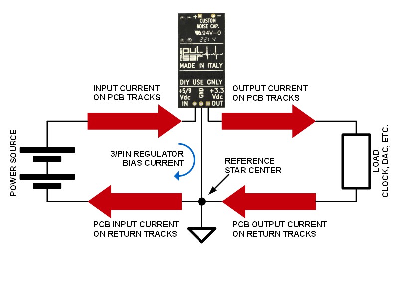

With the 3-pin configuration Vin-Out,No problem with the mass sharing?.In the Datasheet of the ADM 7150,the best level of noise spectral density is Reached with a value of Cbyp between 500μf -1000μf,why annoy to put a lower value?."A little off topic",The Sanyo Oscon SG serie is a good choice for Cbyp,the SG serie is replaced by the SP,it is also good.
In principle a 3-pin regulator doesn't have any problem with the mass-sharing because it operates "in-line" and the ground pin is not used for return of the current flowing through the load, it is instead the reference with respect to the output voltage is regulated.With the 3-pin configuration Vin-Out,No problem with the mass sharing?.
Through the ground pin flows only the small current that is used by the 3-pin regulator internal electronics, a bias current; I made a quick sketch to show the main and bias currents flow on the PCB where the 3-pin regulator is installed. This current is referred in the ADM7150 datasheet as the Operating Supply Current (Ignd) and is in the range 4 to 9 mA.
A line regulator doesn't galvanically isolates the load by the power source so it must have a unique ground reference. This is also the principle of the star ground, a well defined single reference point for all the ground referenced items on the board. Sometimes this star center could be also the whole ground plane if the application allows it, sometimes the ground plane itself is "star shaped" in accordance to this principle.
In conclusion the 3-pin configuration works on the principle of the mass sharing and EMI/EMC problems could rise only at PCB level, but all the PCBs I have seen in our diyAudio world shows great care to manage this issue.

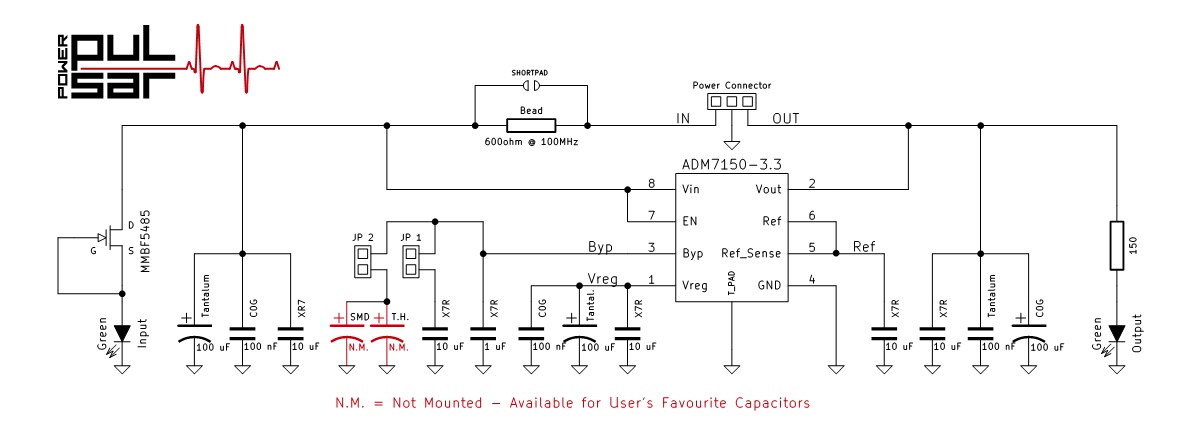

Great question! It is exactly what was in my mind when I saw for the first time the datasheet, I started to immagine plenty of thousend of microfarad installed in the Cbyp location, and so I did as soon an ADM7150 chip was in my hands.In the Datasheet of the ADM 7150,the best level of noise spectral density is Reached with a value of Cbyp between 500μf -1000μf,why annoy to put a lower value?
At this point I discovered the first issue (well documented in the datasheet), the output voltage needed "minutes" to reach the working range!
We designed the Pulsar Power mainly to power up the Pulsar Clock so here I'm referring to our experience in this application but the same criteria should apply also to DACs.
The most impressive and unexpected effect was the influence of the value of this capacitor on the sound. The quality of the sound was influenced by the value of this capacitor and the good news was that it was possible to "tune" the system to perfection just seeking for the right value of this capacitor.
We tested the effect of all the capacitors required by the ADM7150 coming to the triple technology solution, but only the Cbyp capacitor showed a so impressive and useful tuning property on the sound system.
On different systems the best fit value for the Cbyp capacitor changed so we decided to install the 1uF and 10uF values that in our tests showed the best results leaving the room on the board to allocate other capacitors for a perfect clock tuning.
Why this unexpected effect? I thought long to this issue, in principle the Cbyp capacitor should just filter the reference buffer but somehow it influences also the output regulation. Maybe it makes the regulator, let me say, "slower" to react to load demands while in audio applications we need a quick and prompt reaction to load changes to drive Clocks or DACs output with great precision in terms of time (so jitter) and level. A too large Cbyp improves the noise shape and this could be a benefit for less demanding loads while our audio applications have larger benefit from smaller Cbyp because the ADM7150 noise shape is in any case excellent.
With a well tuned Cbyp we reached performances very very near to a LiFePo4 battery.
The Sanyo Oscon capacitors are for sure a good choice for Cbyp, their reputation in audio applications is great.
Any design requires a verification with physical hardware; our experience on the Cbyp capacitor tells that much more than any other component its analytical choice need to be verified by an "on the field" experience.

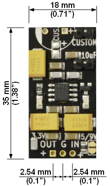

Pulsar Power board size
clsidxxl, your post makes me realize that I never mentioned the exact dimensions of the board, I post them here with the datasheet accordingly updated.

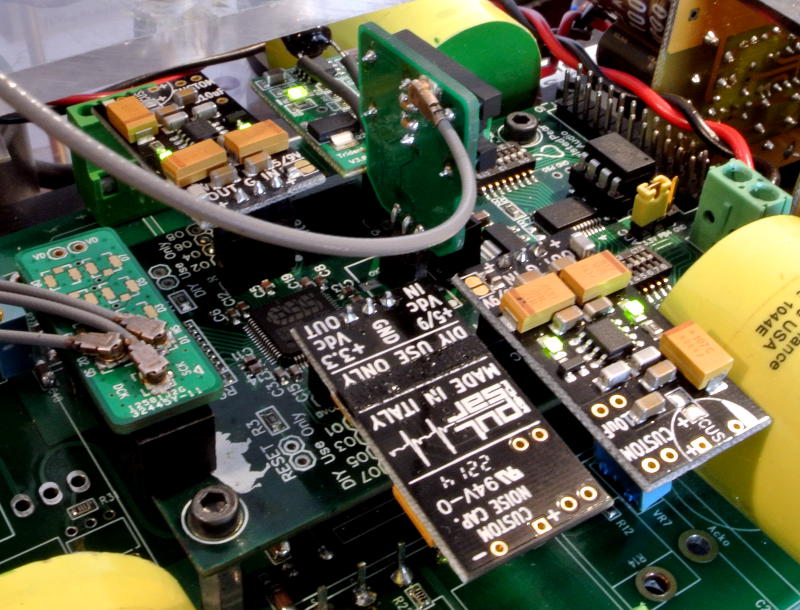

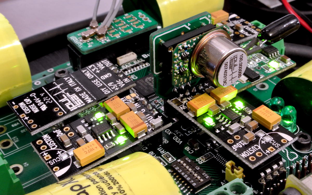

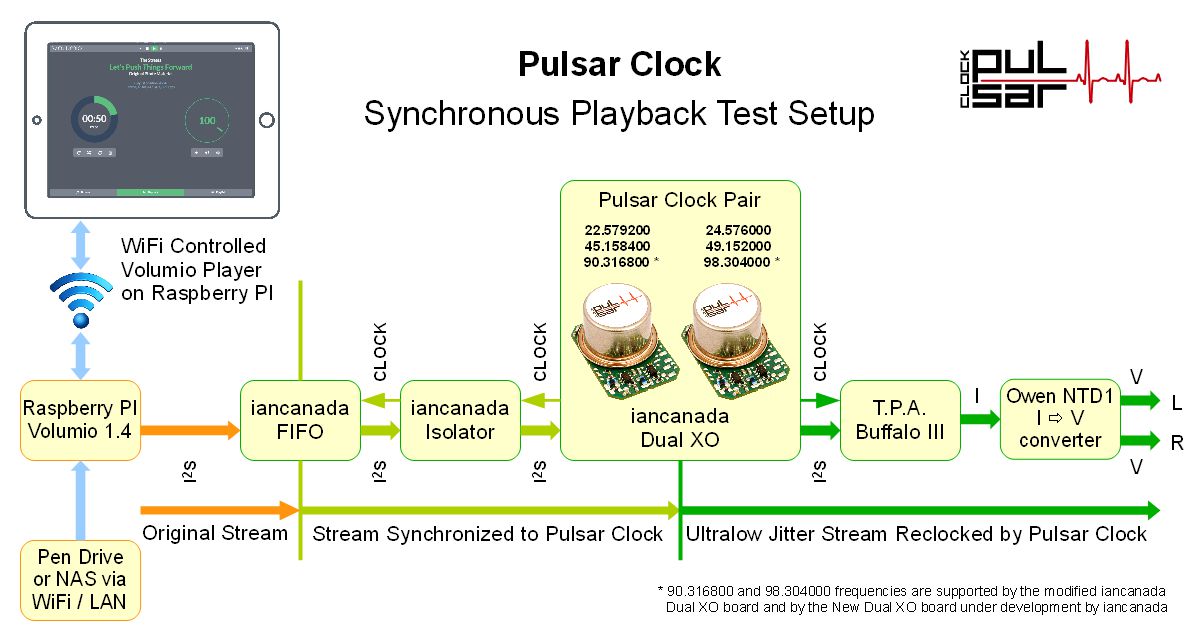

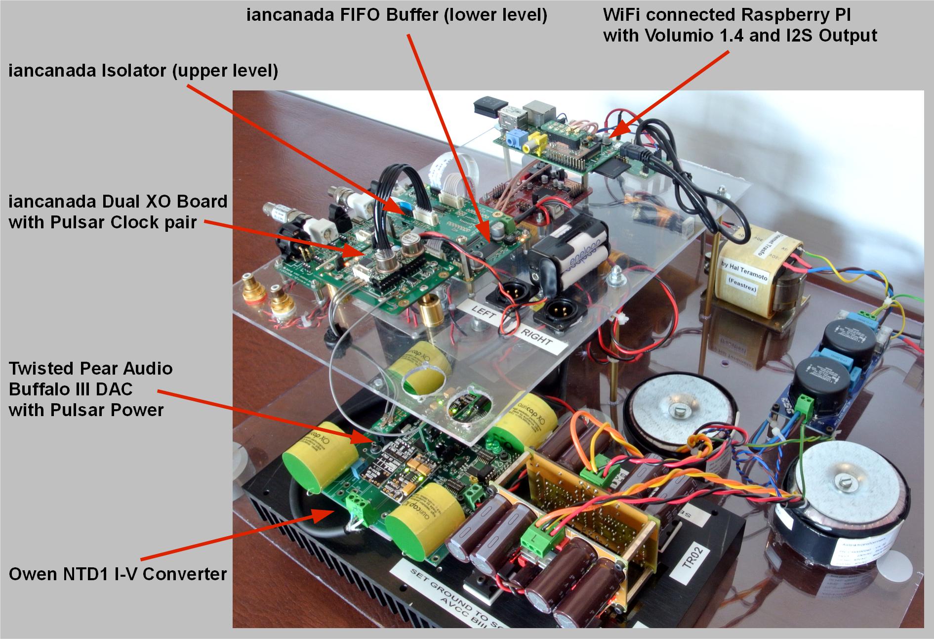

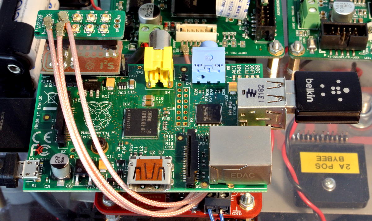

Synchronous Configuration is described by the block diagram in picture S1, the whole hardware is shown in picture S2:
- Player: Volumio 1.4 from Michelangelo Guarise on Raspberry PI with I2S output, a bitperfect player up to 24/192. Picture S3 shows I2S connections from the Raspberry PI
- FIFO buffer from iancanada to synchronize the I2S data flow
- Isolator from iancanada to ehnance data accuracy providing galvanic isolation
- Pulsar Clock pair on Dual-XO board from iancanada, the location where the ultralow jitter reclock is made. Current DualXO version is able to power the Pulsar Clock pair both during the short warm-up and the operational phases. In our configuration we use a 5Vdc battery to supply the DualXO board with minimum noise. Picture S4 shows the "FIFO - Isolator - DualXO" de-jitter block
- ES9018 Buffalo III from Twisted Pear Audio powered by Pulsar Power boards on 3.3V Analog and Digital lines, the board was modified to accept an external clock on the dedicated three pins with the iancanada adapter. Pictures S5 and S6 show the most critical digital path, the connection between the DualXO and Buffalo III boards, this connection could be slightly improved in a fixed implementation but performs very well also in this flexible configuration
- NTD1 I-V Converter Version 3 from Owen, a stunning Class A converter with a state of the art linearity expressly designed to accomodate the Buffalo III board for maximum quality of the analog signal

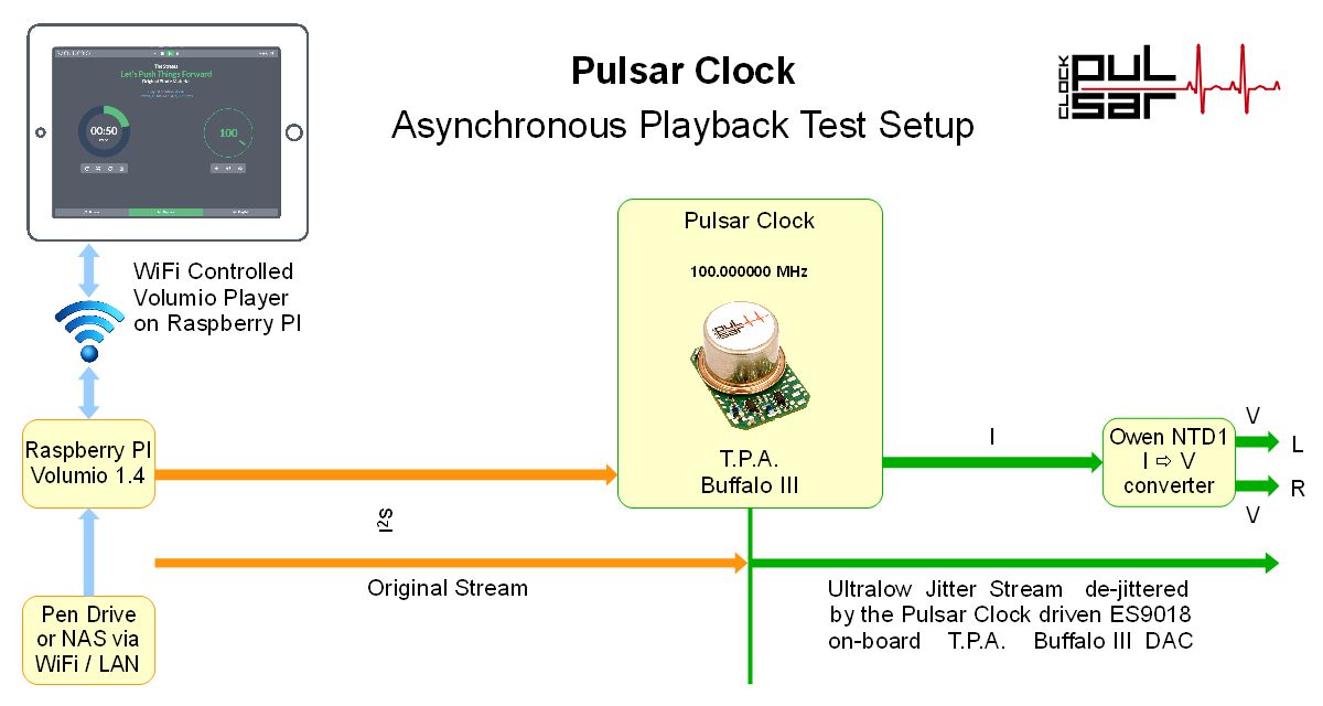

Asynchronous Configuration is described by the block diagram in picture A1:
- ES9018 Buffalo III from Twisted Pear Audio powered by Pulsar Power boards on 3.3V Analog, Digital and Clock lines, the board was modified to accept an external clock on the dedicated three pins with the iancanada adapter. Picture A2 shows the Pulsar Clock on the iancanada clock adapter

S1 - Pulsar Clock Test - Synchronous DAC Block Diagram.jpg97 KB · Views: 1,654
S4 - Pulsar Clock driving iancanada FIFO and Dual XO isolated de-jitter block.jpg180.4 KB · Views: 1,573
S5 - I2S and Clock lines from Pulsar Clock on inacanada Dual XO to TPA Buffalo III with Pulsar P.jpg210.2 KB · Views: 1,506
S6 - TPA Buffalo III with Pulsar Power boards and iancanada adapters to I2S and Clock input.jpg136.1 KB · Views: 700

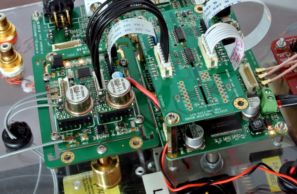

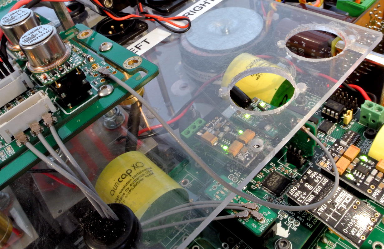

Pulsar,very nice configuration,my set up is very similar,Cubietruck/Volumio-I2S to FIFO/Isolator Digital-Dual XO/ Crysteck CCHD957(for now),I2StoPCMconvertorBoard to Audio GD Ref 7.1.I'm finished setting up,connexion,case aluminium for Cubietruck,proper implementation is critical.
With what you feed the Raspi?you should use UFL cable between the FIFO/Digital Isolator/XO Board.
You said
'''Pictures S5 and S6 show the most critical digital path, the connection between the DualXO and Buffalo III boards, this connection could be slightly improved in a fixed implementation but performs very well also in this flexible configuration'''' What do you mean by fixed implementation?
clsidxxl,
I start from the end, I used with a little bit of fantasy the expression "fixed implementation" to indicate a normal DAC built to perform at home and not to be quickly easily and continuously modified like the configuration that we presented and that we use for test moving among various audio systems sometimes located in cities well far one from another.
Your DAC is what I ment when I wrote "fixed implementation"; I saw in your post #3205 on Ian's FIFO thread the pictures that you published in March and I am really impressed seeing how you modified the Audio GD Ref 7.1 keeping the R-2R converters and changing all the input digital section, a very clean implementation. In that pictures didn't appear yet the Cubietruck, for sure a younger and very valuable substitute of the R-PI.
About your question on the UFL connectors: in the synchronization path from the FIFO to the DualXO you have to consider that the DualXO board doesn't have any UFL connector on the input side making hard the usage of coaxial cables even if you did it on your DualXO where it was motivated by the long lines and the need to preserve the already de-jittered signal.
The key point is to keep under control possible transmission errors induced by the jitter up to the DualXO board where the de-jitter is performed. Consider that the UFL connectors are designed to feed 50ohm lines while digital connections on our boards are not at all impedance matched lines and the cables provided by Ian for sure doesn't induce more jitter than a UFL connection on a such short path.
The most critical data transfer is from DualXO output, where the signal performs its lowest jitter, to the DAC board input and here short coaxial cables on UFL connectors are for sure the best approach.
Your last question: the Raspberry PI power supply is fed via the USB connector by means of a TPS7A4700EVM evaluation board that is partially hidden by the R-PI in the system overview picture.
