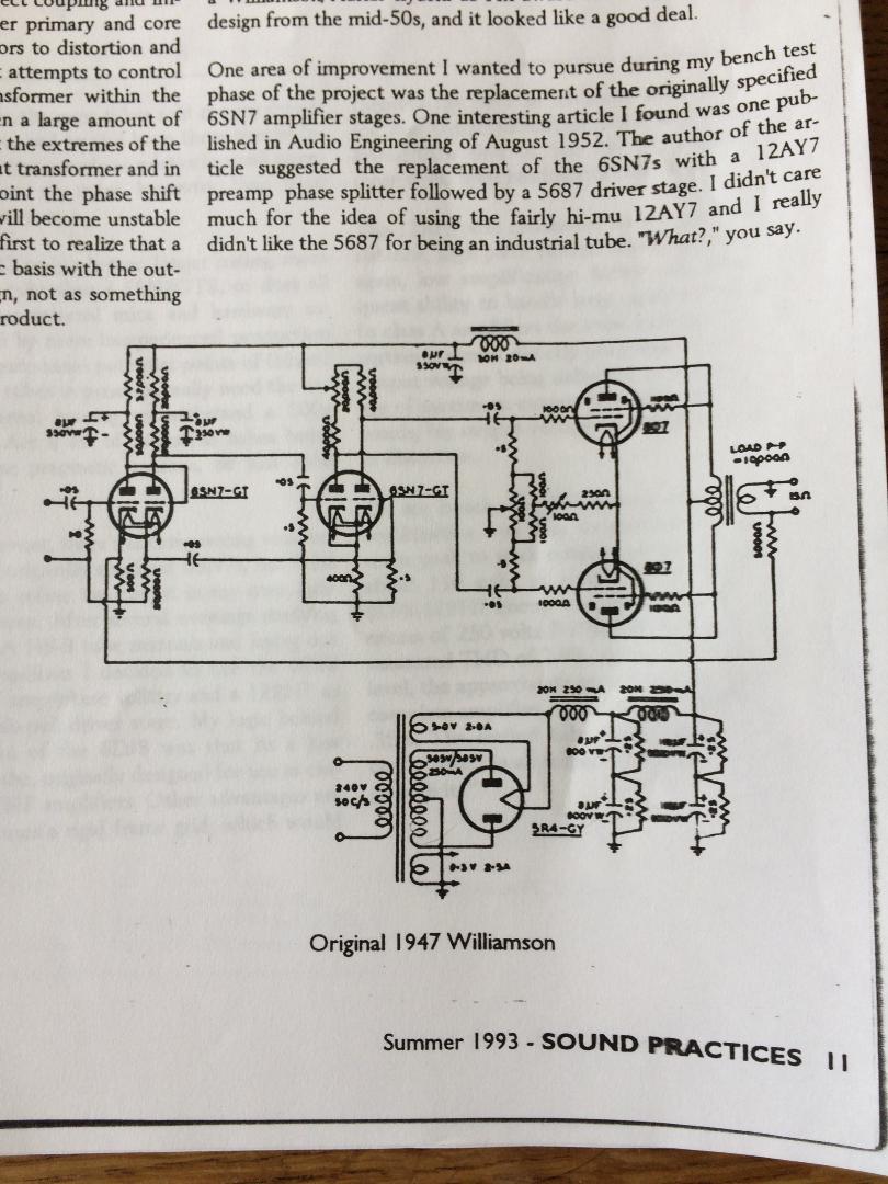

I’ll try to post a picture of the above circuit

Ah, that's the "Radiotron" version by Langford Smith, adapted from the original Williamson to employ tubes available in Australia at the time. There's really no need for so much iron. Williamson used a single 10H choke for the main B+ and am second decoupling choke for the driver and input stages. 8 Henries is sufficient and the second choke is redundant, IMO. None of the later refinements to the Williamson employed it. I prefer to keep the power supply light and fast. The other thing I don't like about that design is that, lacking any bleeder resistor to maintain some sort of current draw, and in the event of circuit failure, you're looking at almost 800VDC sitting on the caps and tubes.

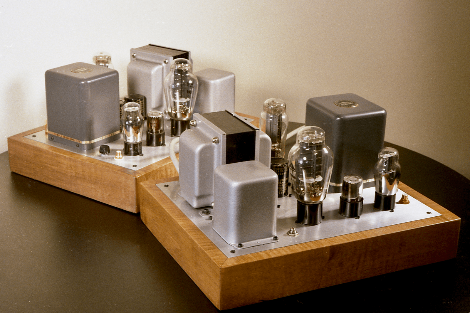

I am working on a new DHT build while still unsettled about ~8mv hum on my AC DHT build. My build follows a common anrrangement observed on similar amps where the PT and OPTs are at 90°. But in this arrangement the direction of the leakage from the PT is still pointed towards the OPTs. Excluding other components, would it be better to rotate both PT & OPTs 90° so that the PT leakage axis is not directed towards OPTs in addition to the axis of both items being perpendicular?
Sorry to reopen an old thread. The quoted post was so good though!
The common arrangement I referenced:
Beautiful amplifiers!

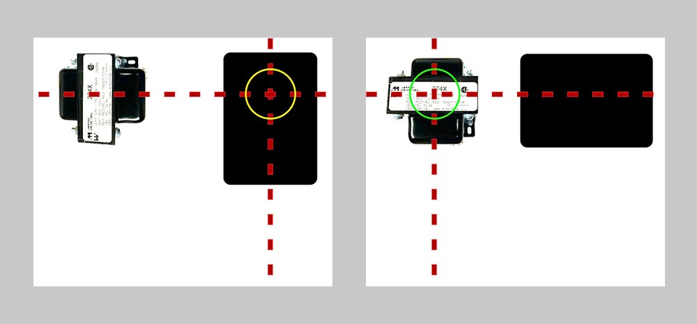

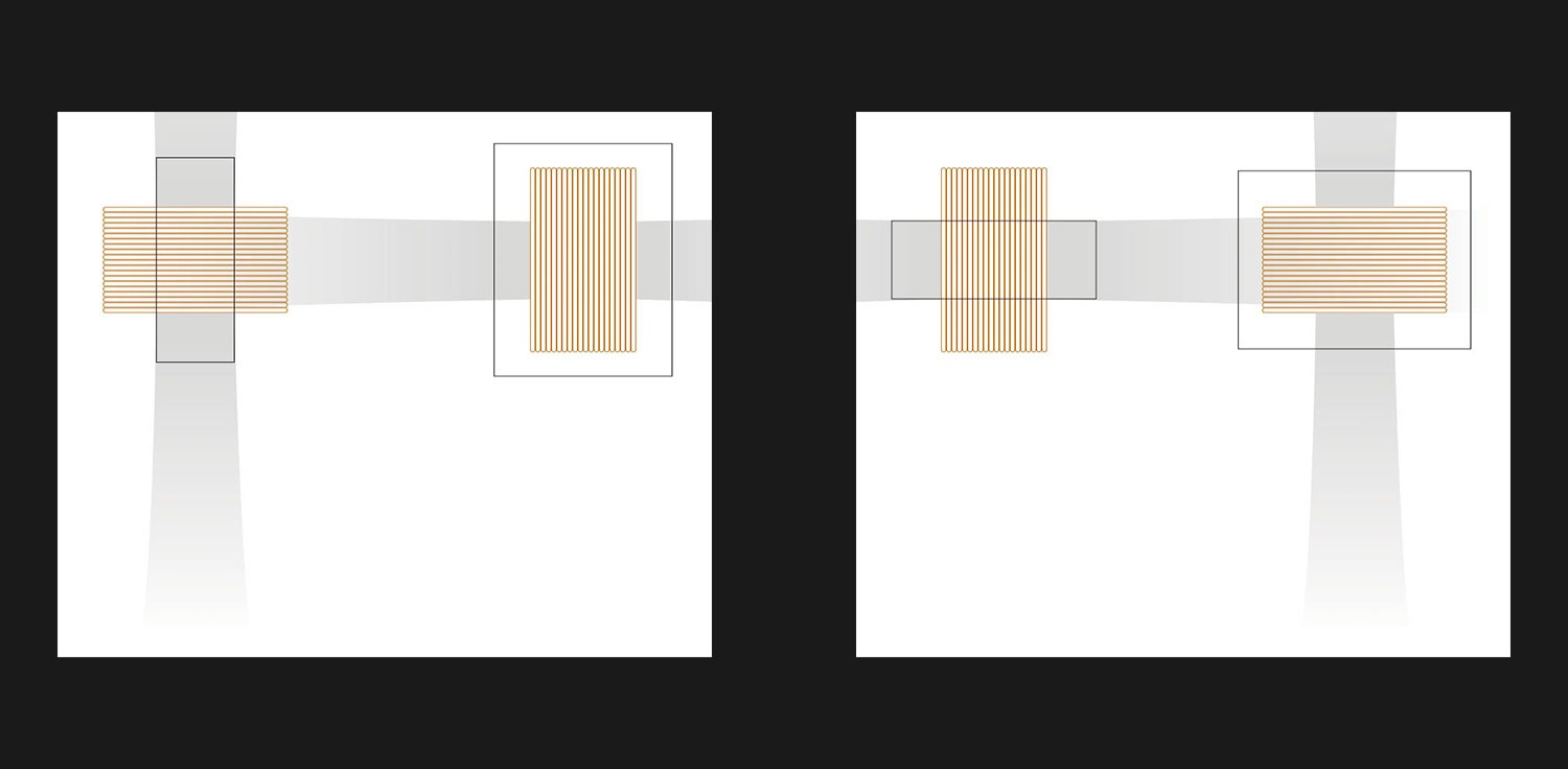

1. When I said Axis, I meant a straight line that goes through the coil windings of a transformer or choke.
Consider a coil, represented by a circle drawn like this: O
The axis points up toward you through the O, and down through the O away from you.
Post # 34 left picture, left magnetic device:
The coil is wound from West to Up, UP to East, East to Down, Down to West (one turn, now repeat for many turns).
Think of this coil as a Tire on a wheel.
The choke or transformer Axle (Axis) points North to South.
The Axis, in this case North to South, is the major magnetic field direction.
2. On a steel chassis, the magnetic fields are conducted all over the chassis. Because it goes everywhere, it can "twist" according to the magnetic field sources, and the chassis shape and dimensions.
The frequency of the hum is predominantly according to the magnetic source device:
Power Transformer mains frequency, 50Hz / 60Hz is dominant
B+ Filter Choke (full wave rectification), 2 X power mains frequency; 100Hz / 120 Hz is dominant.
With equal amounts of hum, generally:
50Hz / 60Hz; versus 100Hz / 120 Hz; . . . our ears tend to be more sensitive to the 100Hz / 120 Hz hum.
Thanks for clarifying. I understand. I'm only left wondering if there is any difference in the below options. Both options keep the axis at 90º
As far as I know, as long as the spacing from one set of laminations to the other set of laminations is the same . . .
there should be no difference on an aluminum chassis.
Perhaps a magnetic chassis skews the magnetic fields and makes a difference between the two orientation examples (often the laminations dimensions differ, one a square, and one a rectangle.
I have seen some working solutions where one set of laminations was rotated more like 30 Degrees to 50 degrees relative to the other set of laminations.
Only by driving one device, and measuring the output of the other device, and rotating one of them, will you be able to pre-determine the outcome before they are permanently mounted.
Don't forget, if you use a single ended output transformer, a choke (especially when in a LCRC filter), and a power transformer . . .
you will have 3 devices to orient versus each other. Push pull output transformers are less sensitive to magnetic fields than single ended output transformers.
When I had to use an existing magnetic steel chassis, I sometimes mount the magnetics away from the chassis . . .
I used 1/4 inch tall aluminum washers between the chassis and the choke or transformer mounting tabs, and used non magnetic screws to mount it.
I did this to possibly reduce the magnetically induced hum, but I never tested the difference (with and without the spacing and non-magnetic screws), so I do not know if it makes a difference or not.
The laminations are now spaced above the steel chassis by 1/4 inch. If this makes a difference, then there will be an additional improvement of
6dB more hum reduction if the spacing is 1/2 inch (square law of the distance, d).
Of course, this spacing looks kind of silly.
The other reason I like aluminum chassis, is that I usually use the hand drill my Dad gave me when I was 5 years old.
Steel is too hard to drill that way.
