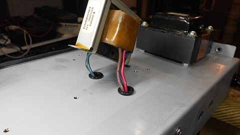

The amp is a set of monoblock 300Bs (3.5k to 8ohms) based on the popular Radiotron circuit for 2A3. Most of the circuit is the same as drawn by JELABS with the exception being in the PSU: PT (with higher secondary voltage), reservoir cap and choke. I have tried 3.3uF, 10uF and (currently) 20uF size reservoir cap. Original 5H choke replaced with 10H. The latest changes (20uF / 10H) rendered a measurable, but only minor, improvement.

If my estimates are close, the ripple at the junction of 20uF and 10H is about 8Vpeak to peak (the current draw is about 127ma for 2 output tubes, 2 driver tubes, and the B+ bleeder resistor; Xc of 20uF @ 120 Hz (full wave rectification).
Then, at the junction of the 100uF and the end of 10H, the ripple is about 14mVp-p (10H is 7500 Ohms and 100uF is 13 Ohms; divides 8Vpp by 13/7500). 14mVp-p /2.828 is about 5mVrms. After the voltage division the
And the root of the impedance ratio: (3500/8) = 21; the B+ ripple at the output should be about 250uVrms.
If your DMM is good enough, you should be able to measure the ripple at the junction of the 20uF and 10H choke (caution, very carefully).
It appears that your 8mV ripple at the amplifier output transformer secondary is caused by:
Either 8Vp-p across the choke magnetically couples to the single ended output transformer,
Or your AC powered filaments are the problem.
Remove the choke off the chassis (do not touch it), and see if the ripple reduces significantly. If it does, you need non-magnetic washers and non-magnetic screws to mount the output transformer off of the magnetic steel chassis.
Or use an aluminum chassis.
If the hum is still there, it is time for two DC power supplies for the 2A3 / 300B filaments.
