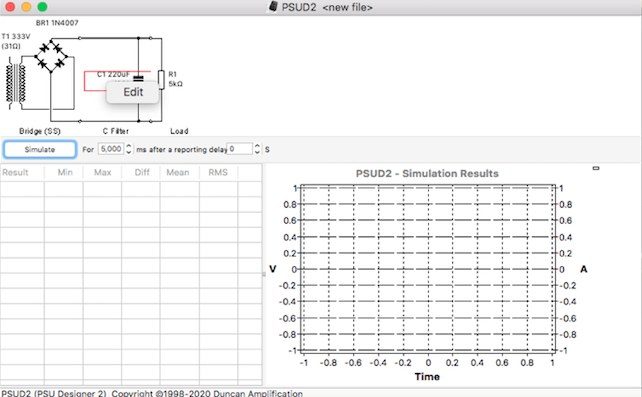

I still have not figured out what is wrong with the elusive right-click (two-finger click on the Mac) to get the sub-menu to change the default PS schematic. I already made sure the two-finger click is enabled in my Mac settings, but still don’t reach the sub-menu. I have not used it recently, but PSUD2 worked fine for me on Windows machines.

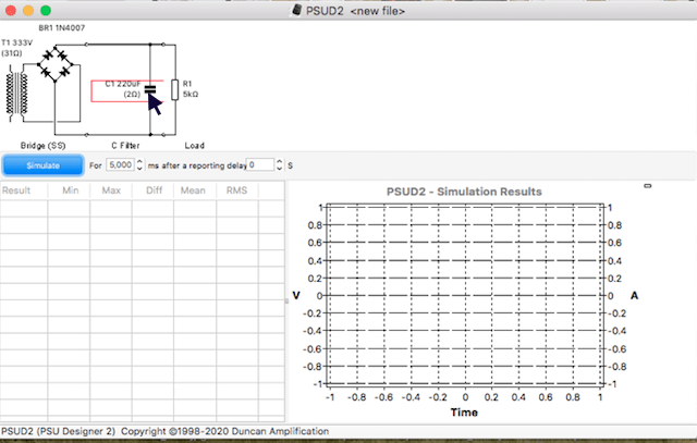

Do you get the red box around the circuit section when you move your cursor over it?
Yes, I get the red box when I move my cursor over it. When I do the two finger click, or a double click, I get the same input box where you can change component values, but nothing like a sub menu where you can choose to add CL or RC sections to the schematic.

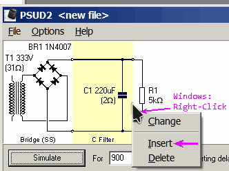

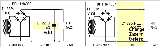

On Windows is different? No red box, instead yellow blocks. TWO kinds! One for "part", one for "stage". My screen-grab is not picking up the menus but something like this:

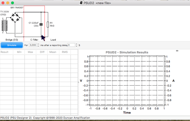

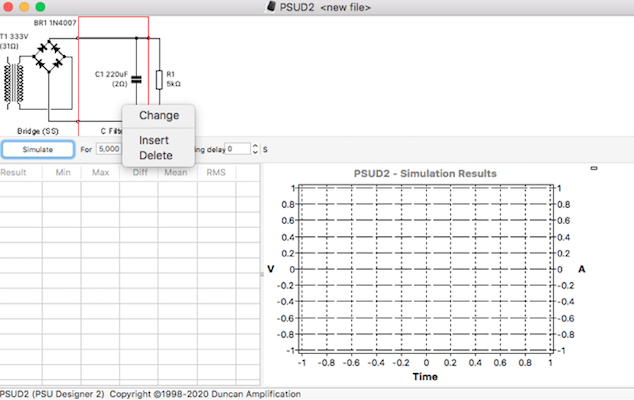

Francois, If you put the cursor right on the component it will do as you say. If you put it near the bottom of the schematic with the power supply filter section above it will put the red box around the entire section, like the larger yellow rectangle in PRR's post . Then you can change a block type or add one.
Thanks for your help gentlemen, @Hearinspace and @PRR, especially.
That’s what I was missing! All is well now, when I do the two-finger click after hovering near the component to get the “big red box“ first.
