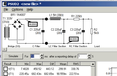

The number of buttons on a mouse is a religious issue. I even know Windows machines with a toothpick jammed in the mouse right button to disable it. The loss of functionality is more tolerable than the wacky things Windows may do when Rt-Clk is hit by accident. Also Rt-Clk events/menus are poor discoverability. Very abstracted from Real Life.
In Real Life we would pick up the wire-snippers. Or maybe look for a disconnect. Yank here!
In the GUI, balloons or large dots could be the trigger for Insert/Delete actions.

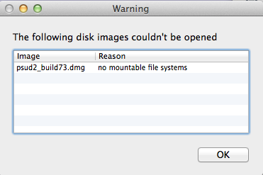

I tried to open DMG file downloaded from the site. Not working...
osx could not open at all like othet dmg-s. osx is 10.9.5. Message is @ .png
I will try on newer osx... 🙁
Your version of macOS is way too old. Apple introduced a slightly different file system in macOS Sierra. I suppose Duncan packaged the DMG in a newer Mac with new file system.
Not sure if Duncan can repackage the DMG file in older file system so that people who are still running macOS el-Capitan or below can mount the dmg.
initially I had the same issue with my MacBook Pro 2009 (not compatible beyond el-Capitan) until I found a way to hack it to run Sierra. PSUD runs like a Champ.
