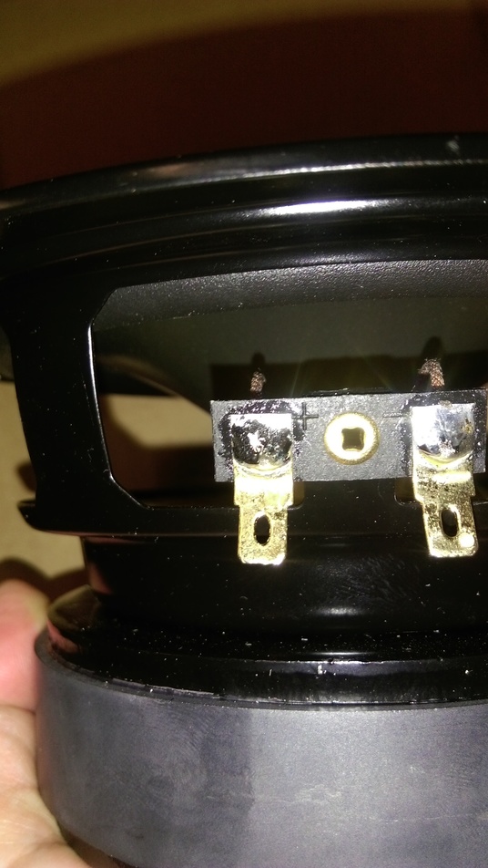

There is a + mark on mine but it’s not very clear. part of it is under the metal on one of the tabs

Did you connect positive wire on + tab or on tab where is red mark. It seems to me that red mark is by the wire connected to tab with - on plasticThere is a + mark on mine but it’s not very clear. part of it is under the metal on one of the tabs
