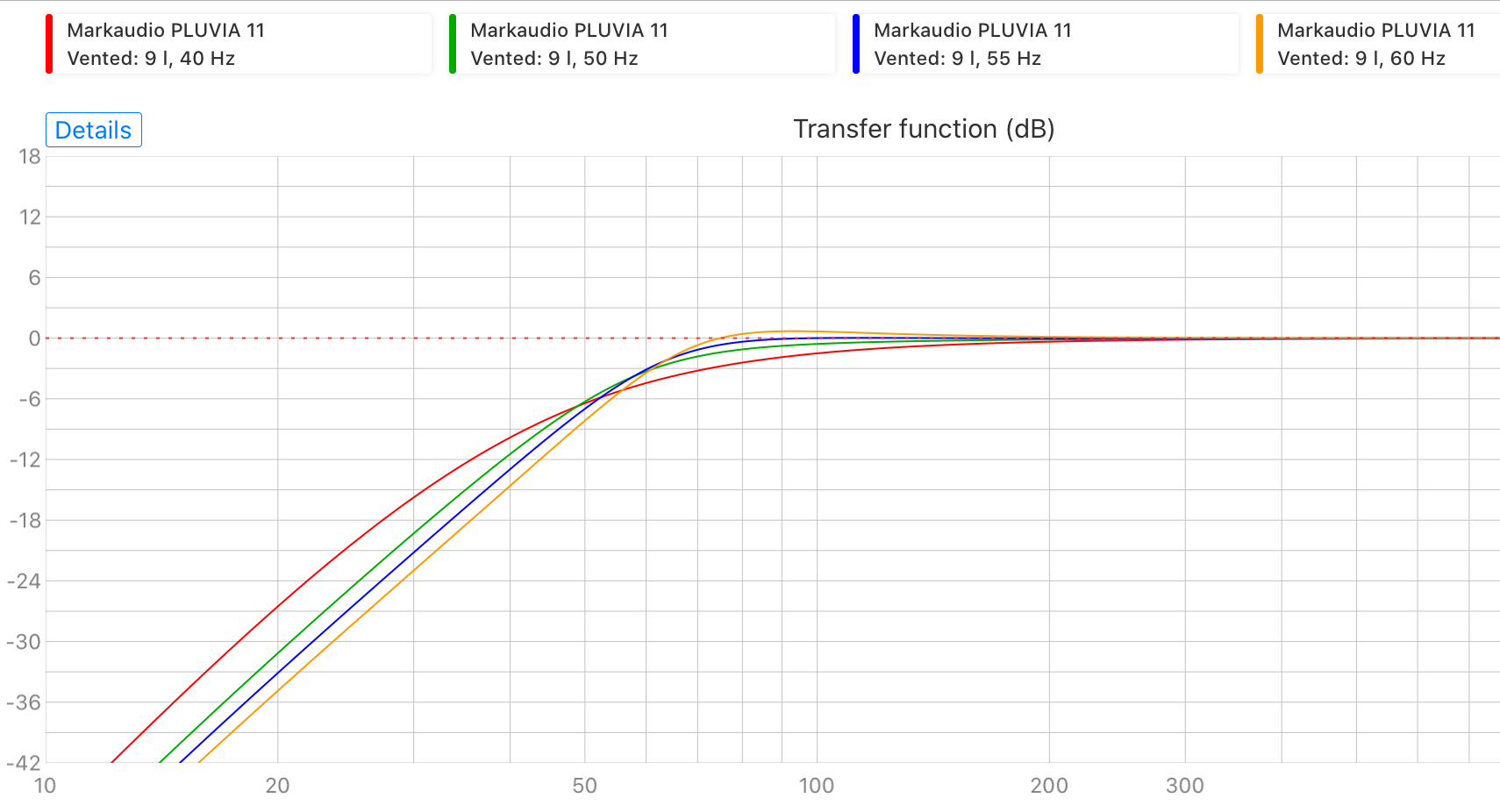

Assuming 18mm sheet material it’s 9 litres not including the driver, binding posts an any bracing
We’d better start a thread?
As noted in the original post the drivers spec similarly to the Pluvia 11. So here’s some porting options in 9 litres.
Note that Tuning to 50hz gives a -12 of around 40hz which is close to what the MRB was supposed to give Going by reviews

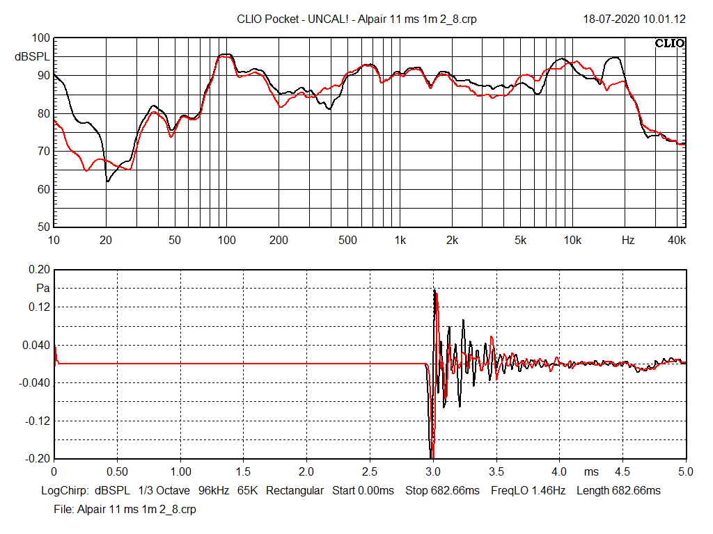

I am enjoying these as they break in in some test cabinets of approx. 11.5 litre internal volume. I think they will only get better over the next few days.
I have attached a quick frequency measurement showing the Sota 11R and Alpair 11ms in the same cabinet as a reference. The 11ms is already broken in.
I think it is a pity that not more pairs are available. At this price its great value.
Red trace is the SOTA 11R, black is the Alpair 11ms.
