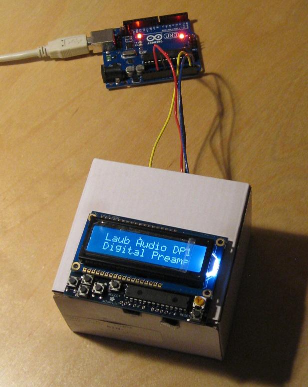

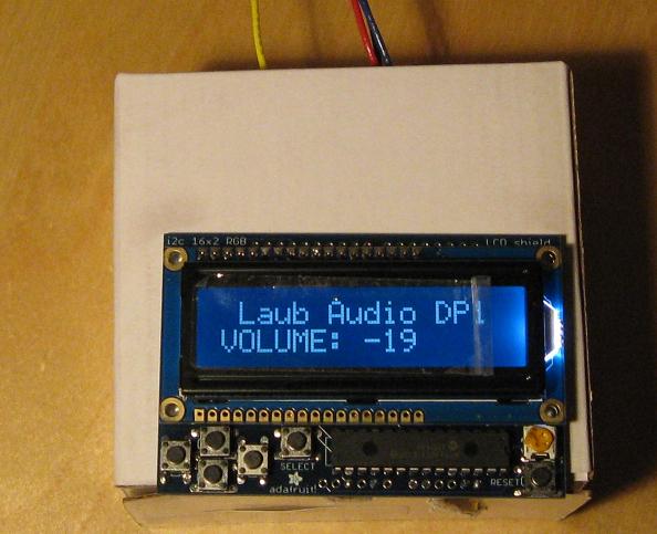

I finally got the Arduino up and running and have implemented some code that will read user button input and increment volume up/down and/or change inputs. See pics, attached below. Fun stuff!
I did some more coding and have added the feature that the user can rename the inputs.
Instead of having to choose from INPUT 1, INPUT 2, INPUT 3, INPUT 4, etc. the user can enter up to 16 characters that describe the source equipment connected to the input, like "USB INPUT", "TUNER", "Berkeley Alpha", or whatever 16 characters the user chooses from the set of printable ASCII characters (ASCII 32-127).
The input names are saved to the EEPROM and loaded into memory each time the board starts up.
