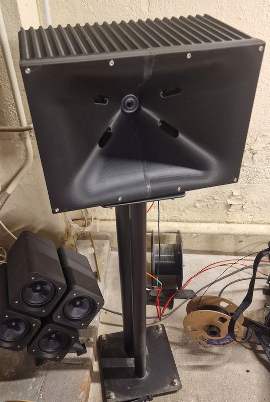

I fixed the weird buzzing and have my first pair of horns running. New cabinets and a stronger print fixed the issues. You notice on my first post that the horn has a crack on the edges. I'm pretty sure that was causing bussing along with a loose screw in the banana plug plate. The new cabinets are also a LOT more sturdy with doubled up 18mm ply. I still need to do a couple more coats of paint but I was so excited to listen I haven't finished yet.

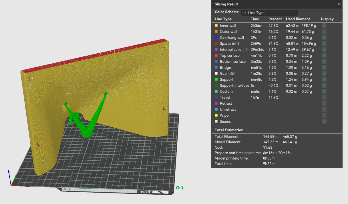

Can you share the current print settings? Wall thickness, top and bottom, infill, etc. Anything contributing to strength. Also, did you find an optimum angle to place the part to minimize the amount of material required for supports? I rotated the STL about 55 degrees from upright and it needs ~125 grams of filament for supports.

@Narcisse91 I use a wall thickness of 4 loops and 30% infill adaptive cubic with a .4mm nozzle. I'm sure a thicker nozzle would be better provided you are willing to do a bit of sanding. For the orientation, I use the glue face on the print bed. I found that greater rigidity was achieved by prioritizing wall thickness over infill. You shouldn't need and supports for the print. But, I some for the ports and entry just to be safe.
Let me know if you need anymore settings. The rest are pretty much default from bambu studio.

Thanks for that info, and the picture. Bambu was applying supports when I arranged it like that and I haven't had luck getting a smooth surface anywhere where there were supports, but if it has printed ok for you like that, I can manually block supports on it and give it a shot. The only real advantage I saw to printing it in a different orientation would be to enable ironing and try to get a smoother surface right off the printer, but now that I've got it the way you did, it is a lot less filament and ~6 hours shorter print.

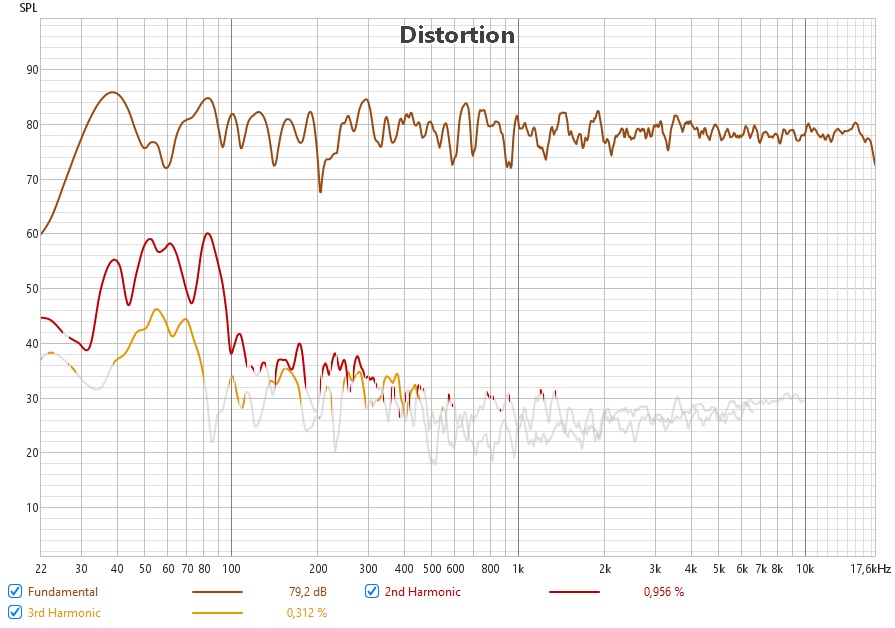

Thanks for the STL file. Here's a new clone from France. The enclosure is also printed with a Bambu Lab A1. Below is the bass speaker with eight 13 cm drivers.
For testing, I'm using a t.racks DSP 4x4 Mini Amp for the horn.
The subwoofer is filtered with a MiniDsp Shd and a separate amplifier.
