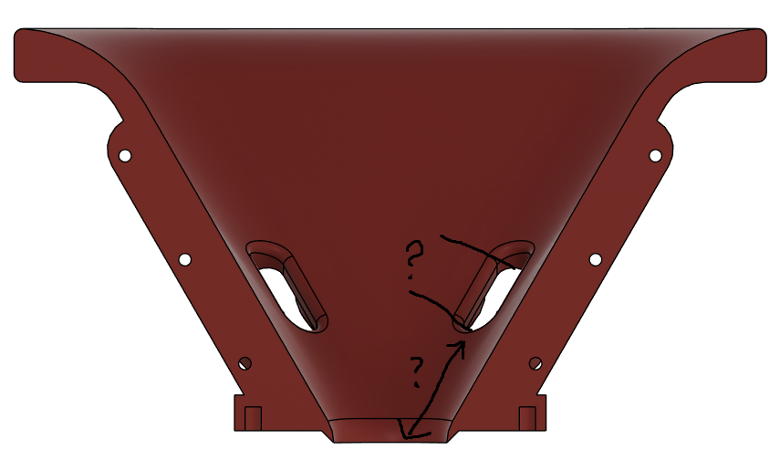

What is the distant as shown?
Would you share the STL?
thanks
I will be sharing the STL once I am finished.
Reactions: Wright

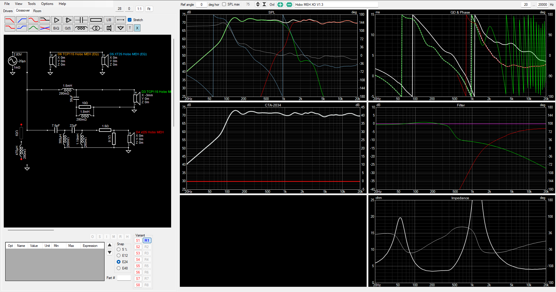

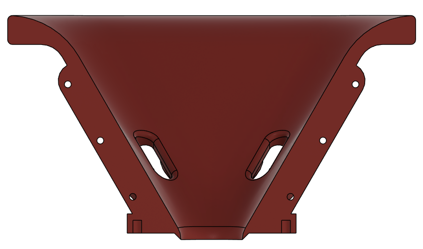

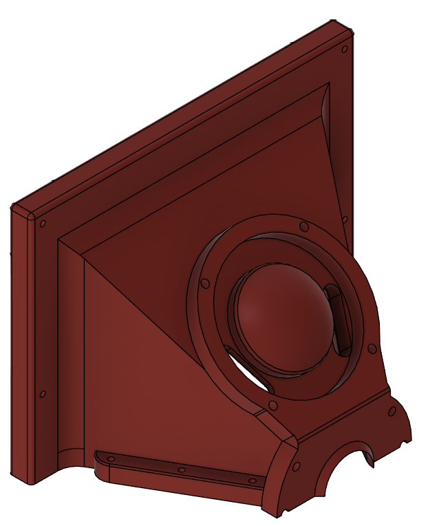

I'm still working on this, I need to build new cabinets to house the final design. I'm also thinking about ordering a KABD and making this a portable blue-tooth speaker. Anyways, here is the STL! I want to make an organized write up but I just haven't had the time. This simple/cheap MEH idea turned out to be a lot more work than expected.

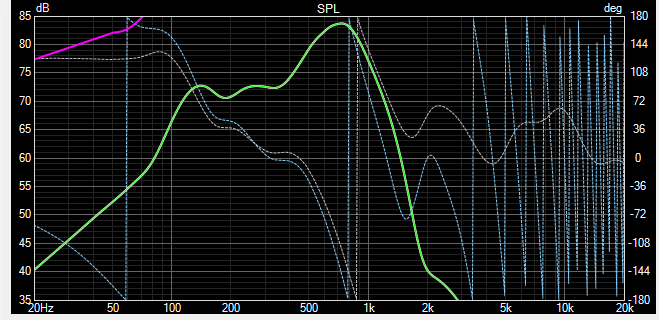

Here are my DSP settings. I still need to take polars with these.
Tweeter (Inverted Polarity)
Gain: -3db
High Pass Filter: 1400 Hz, Butterworth, 24 dB/oct
Low Shelf EQ: 4200 Hz, -9.2 dB, Q 0.9
Woofer
Gain: 0db
Low Pass Filter: 3000 Hz, Butterworth, 6 dB/oct
High Pass Filter: 65 Hz, 12 dB/oct (slope type unspecified)
High Shelf EQ: 450 Hz, -11.5 dB, Q 0.9
The high pass on the woofer is optional but recommended. I turn it off for low volume listening. At higher levels it reduces port chuffing.

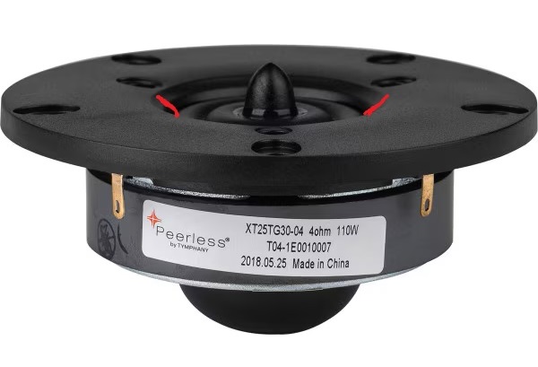

Thanks for your work, making MEHs accessible is a very noble thing to do 🙂 I saw that there a different versions of the XT25 tweeter, which one do you use? is it the Peerless by Tymphany XT25TG30-04 one from the picture?
Thank you again!
@amori yes the Peerless by Tymphany XT25TG30-04 is the one I am using. There are other tweeters that will also fit but untested.
XT25BG60-04: The dual ring version. Will probably have similar performance. It's a lot heavier though so I would find a way to support it in the cabinet if possible. It will also require a deeper cabinet.
DX25TG59-04: The dome version. I really want to try this one. From what I have researched, the extra surface area of the dome could assist in achieving a low crossover frequency. However, I am skeptical on the high frequency performance > 10khz
Other candidates that might work but would require mounting/throat modifications: DC28F-8, RST28F-4. I wanted to try a bunch of these, but I quickly realized that I could buy a nice set of compression drivers with the money instead.
If anyone is interested in experimenting with one of these tweeters I can give you a file with updated mounting holes.

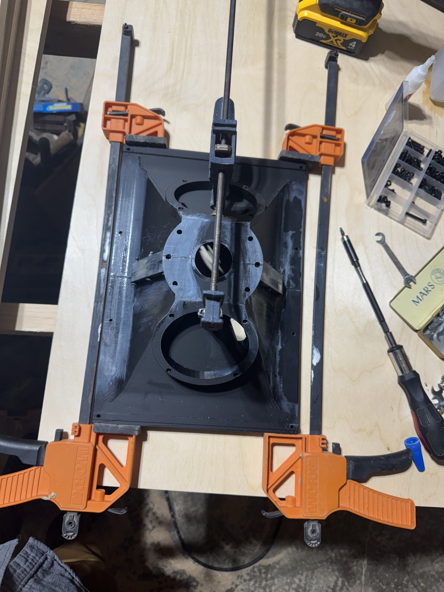

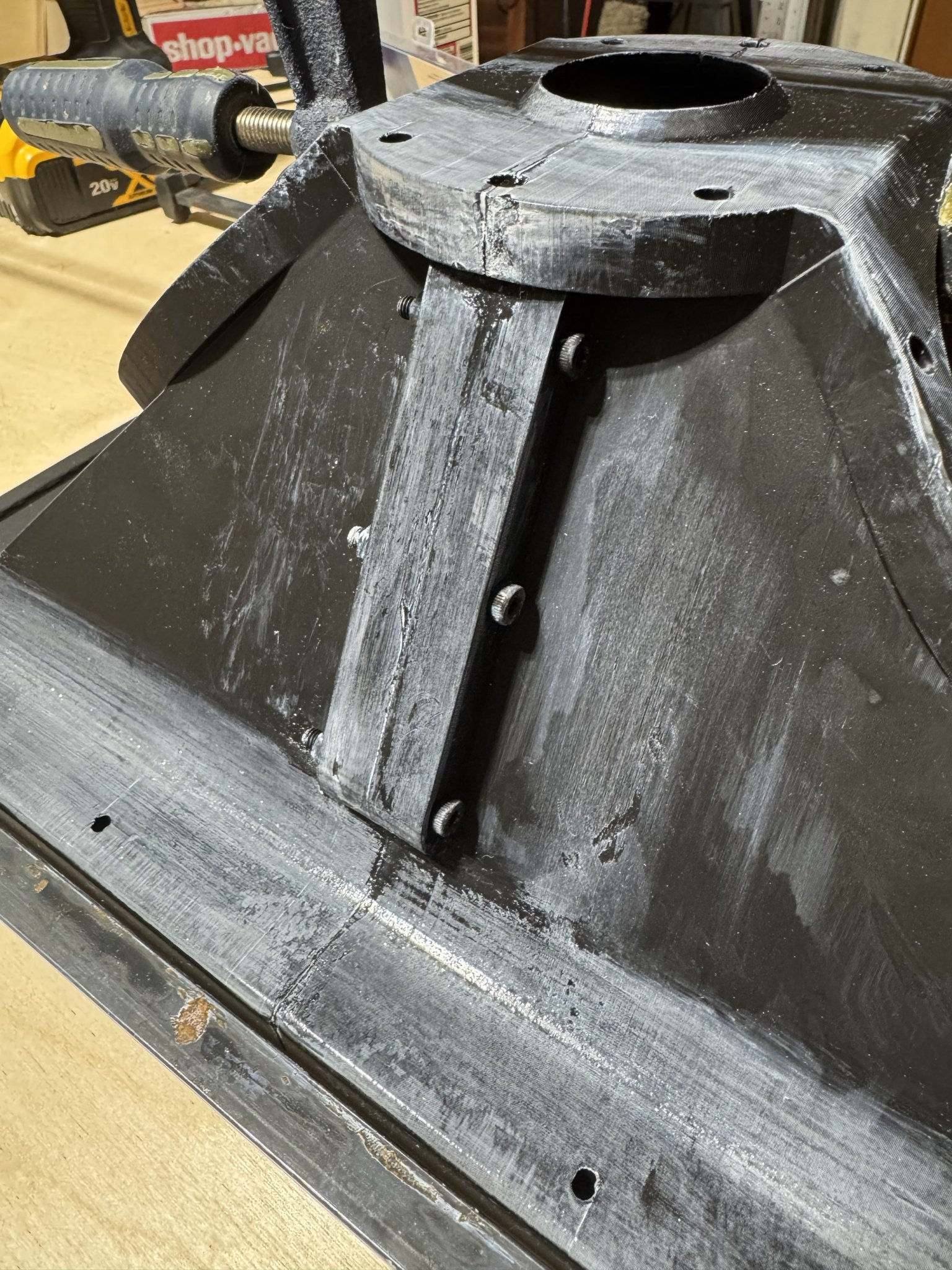

Sigh... I'm convinced. I hear a very slight buzz at higher volumes. I was thinking it was my tweeter and have been driving myself crazy trying to fix. Will order a bigger nozzle and see if it improves things at some point. Maybe I can print it in ABS and give acetone smoothing a try.
I am also planing on gluing 6mm plywood triangles to the flat areas around the horn to fix what I got. That might help a bit.

To cut back on potential vibrations, I think a mixture of wood and plastic would be an effective way to reduce them. All angles are 45 degrees so assembly would be pretty simple compared to making the whole thing out of plywood. You could make all these cuts with a circular saw and a circle jig, tools most people seem to have in this forum.
The phase plugs bottom half is plywood to reduce vibrations, with a printed cap on top to reduce chamber volume. My only complaint is it removes the threaded insert mounting option, which was super convenient.
