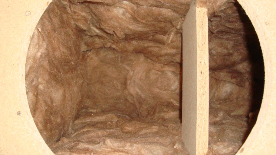

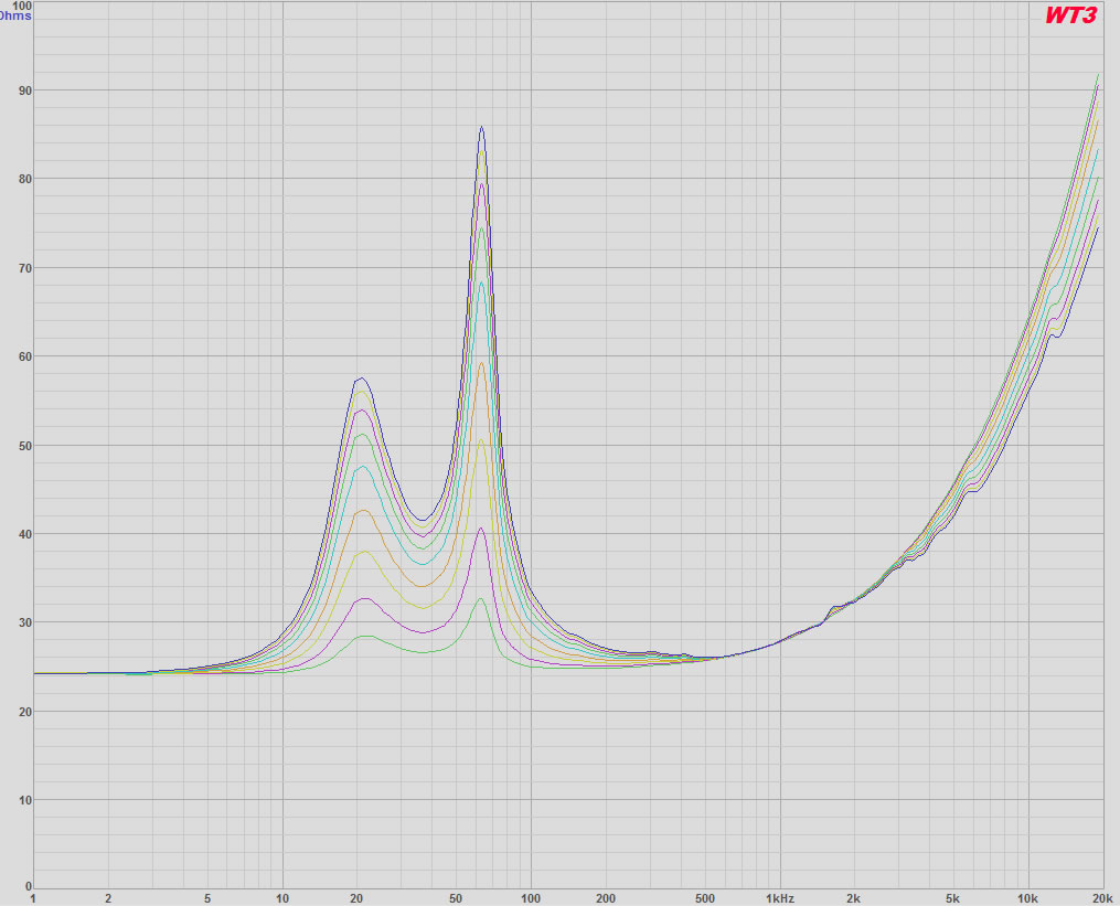

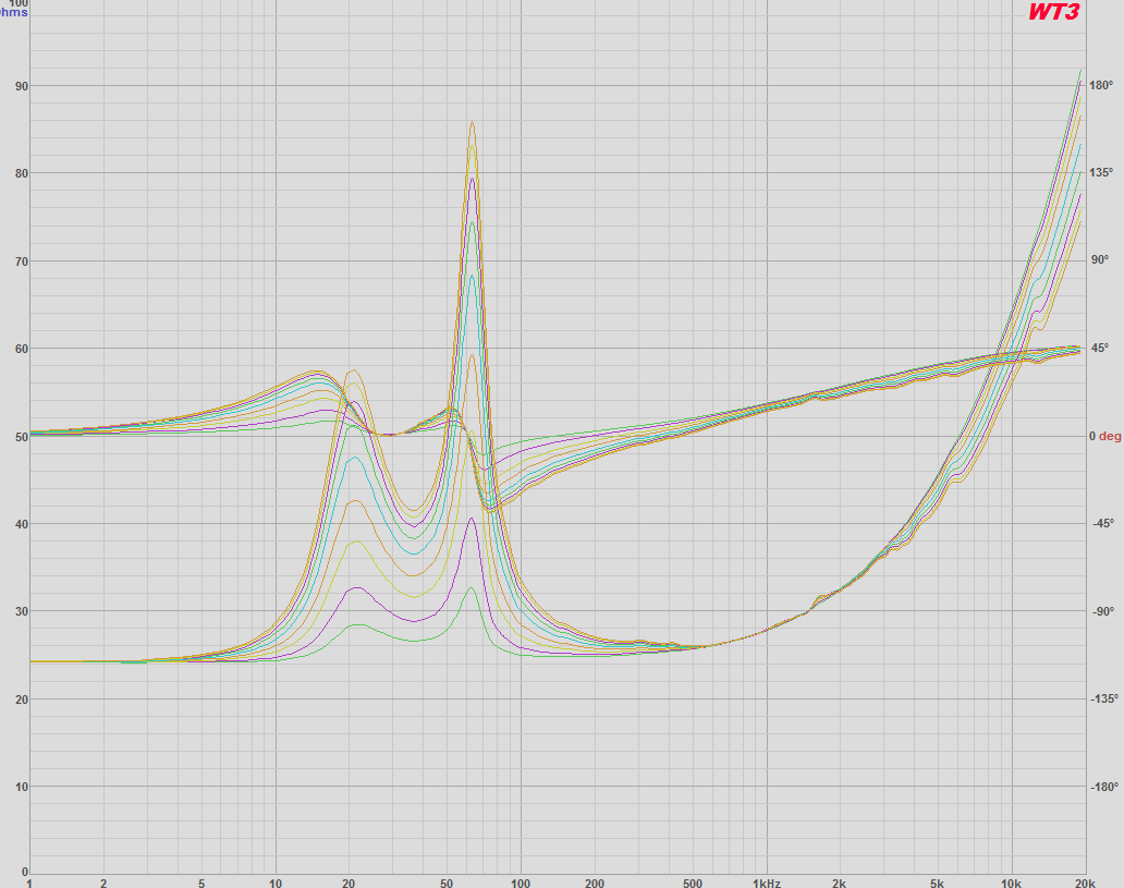

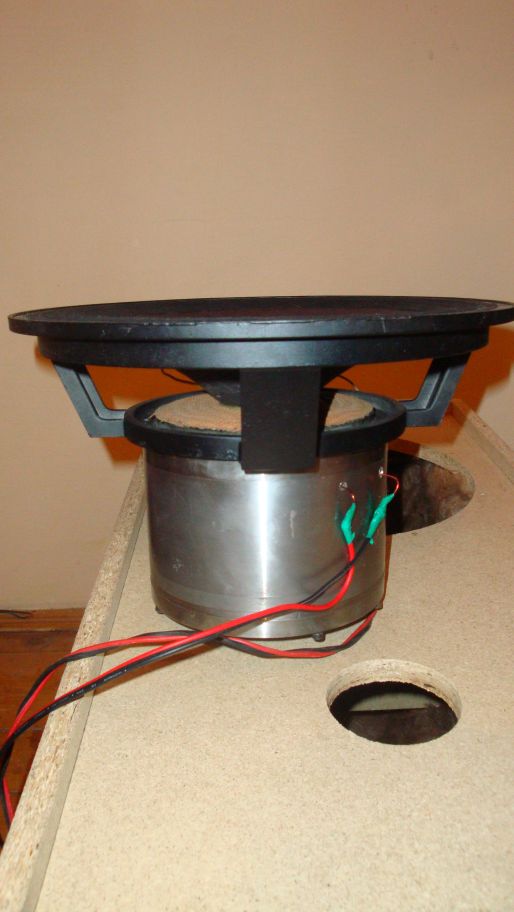

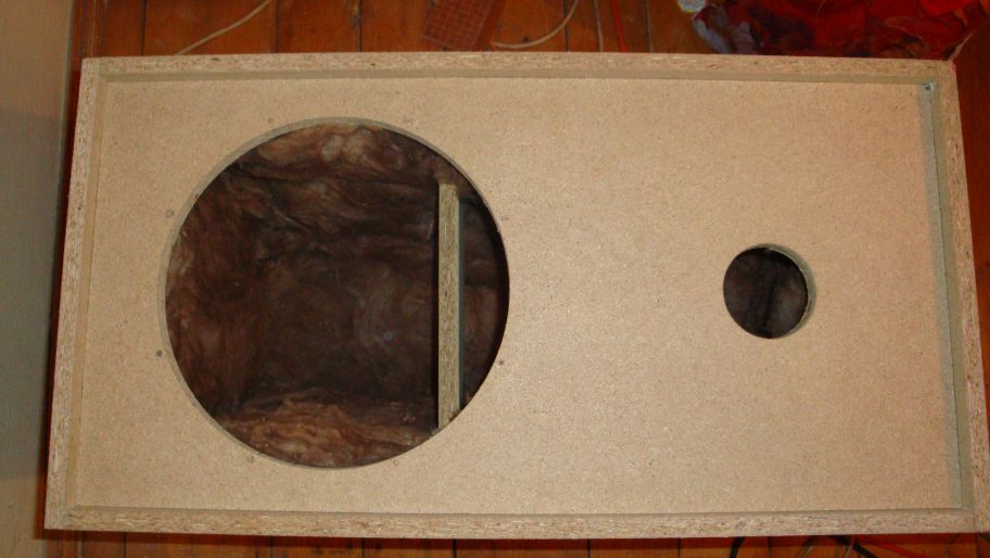

This weekend i made a test reflex enclosure from fiberboard. 110L tuned around 40Hz. I wanted to see the impedance curves with different current through the field coil.
I used a 32 ohm ECCAW voicecoil from tests i did before ( i will post on these as well as soon as i arrange the data) so the lowest Qts value (3Amps through VC) is aprox 0.4.
Here are some pics:
As you can see pretty much a typical behaviour at low frequencies. At high frequencies we see that the impedance drops with increasing current through voice coils. Permeability of plates changes with the changing flux density. We can see some little glitches appearing gradually in the linearity of the curves with increasing current.
I could not associate these glitches with any dips or peaks in freq response, could be resonances too subtle, and with weak current through field coil there is not enough energy to excite them.
Using it in reflex is a waste though of efficiency. The high-mid region would need notch filtering. Horns are the way and that will be done pretty soon.
Here are some pics:

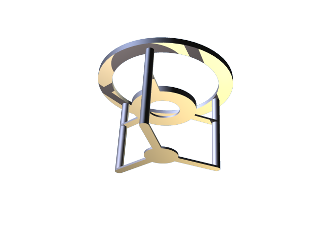

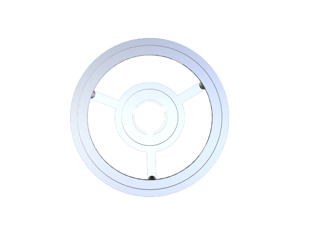

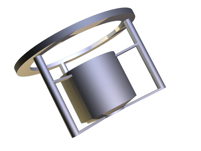

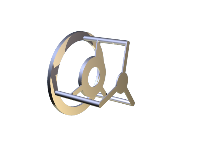

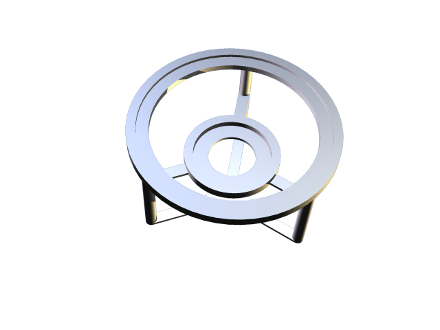

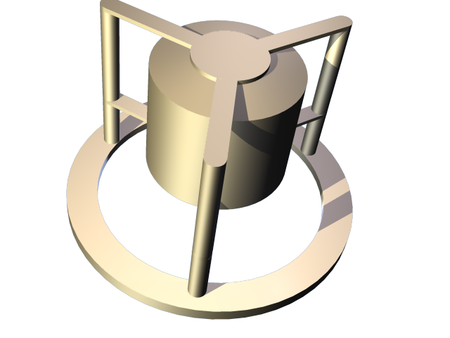

Here is my idea of the frame, will take shape soon.

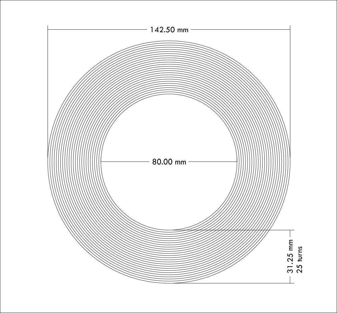

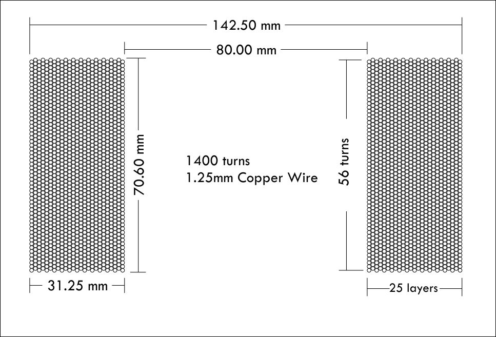

I have been listening for a little while now and i am pretty much please with where i am now. There is, of course, room for improvement and this is what occupied my time lately.
The magnetic structure suffered a few tiny but important changes as well as the voice coil. I have underestimated the battle against inductance in an underhung design. The relationship between electrical parameters makes it difficult to make a choice and i still have a couple more options to test and evaluate.

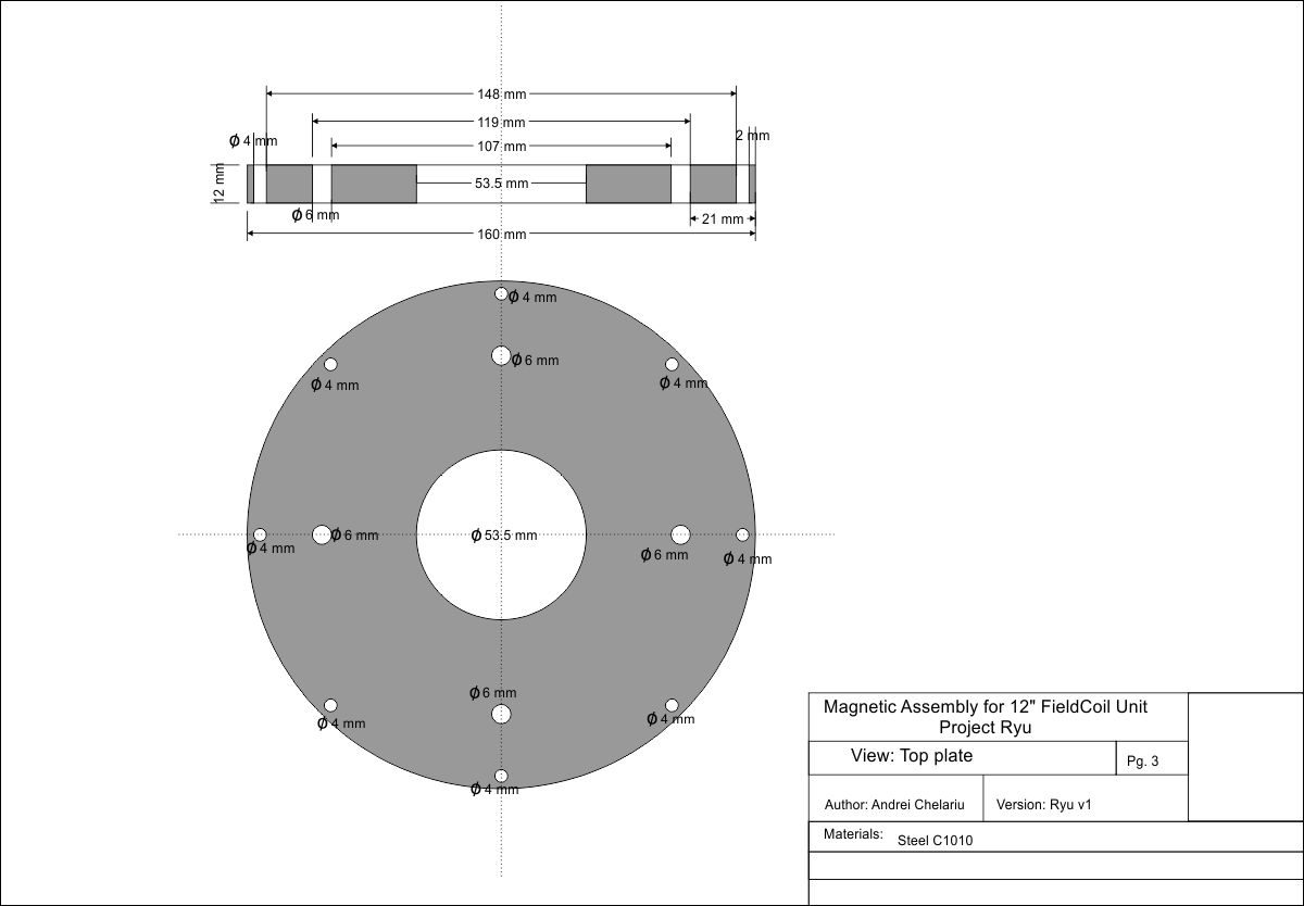

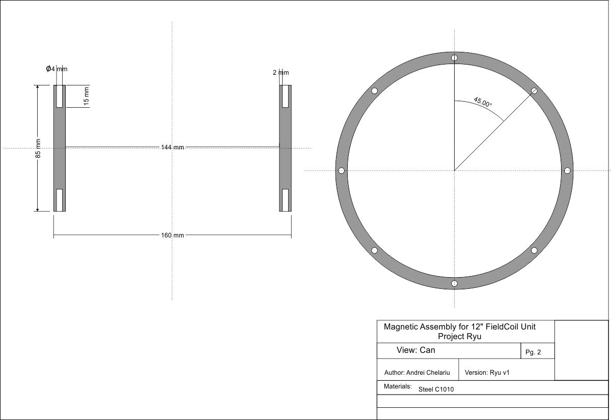

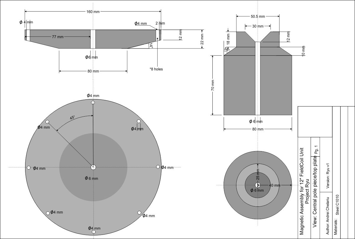

So attached you will find plans for the first version, if there are builders going this path i can provide more info, sketches etc.

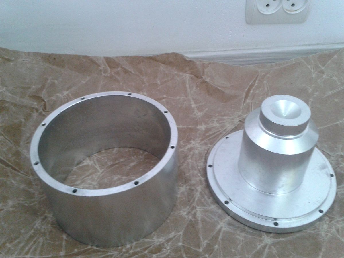

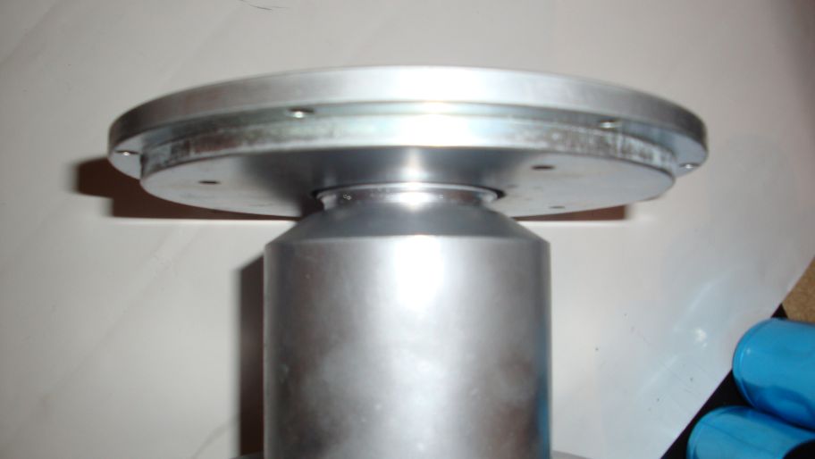

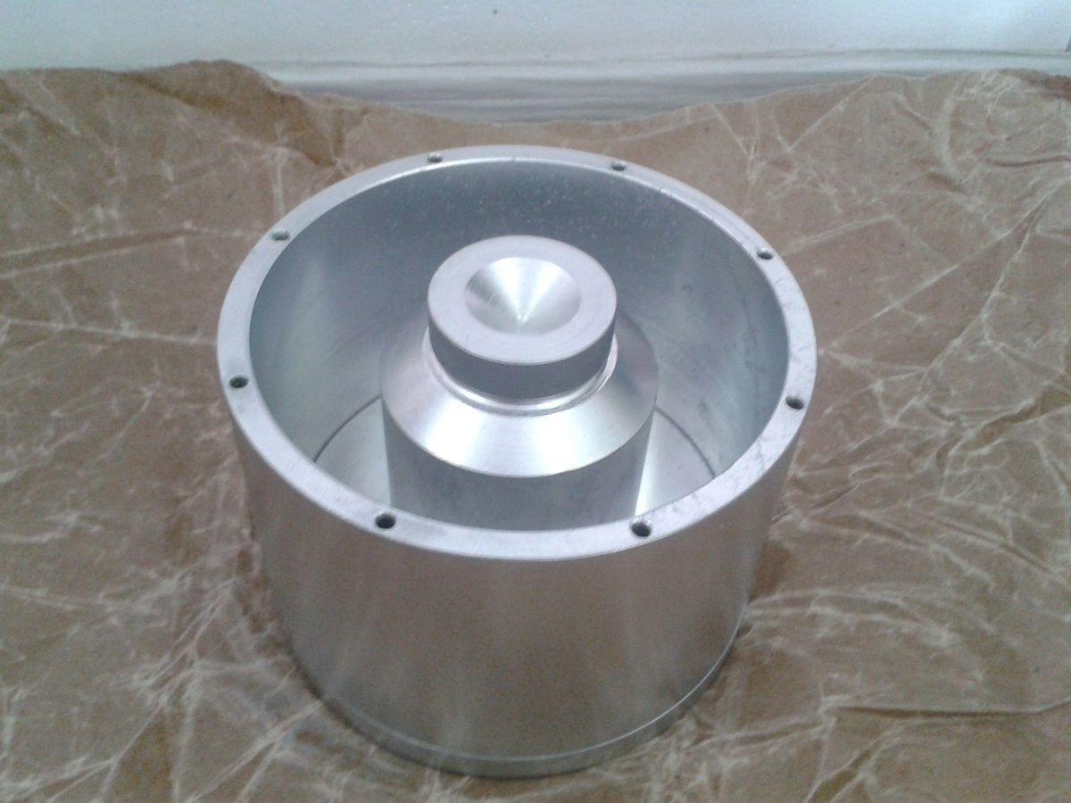

Also some pics with the new motor structure, allows for a more precise assembly, central pole and bottom plate are from a single chunk of metal, a nice change on the gap geometry.
With the new structure i hope i will finally defeat inductance.

Yes, the sketches are for the first version tested. The new version has some improvements that i will need to put to the test.
There is still some polishing to be done and i will upload more detailed pics and rest assured the sketches as well 🙂.
Also in page one the view is the central pole piece and the bottom plate. Top plate is on page 3.
I believe the sketches of the first version represent a good foundation for anyone who wants to explore sound with a field coil speaker.

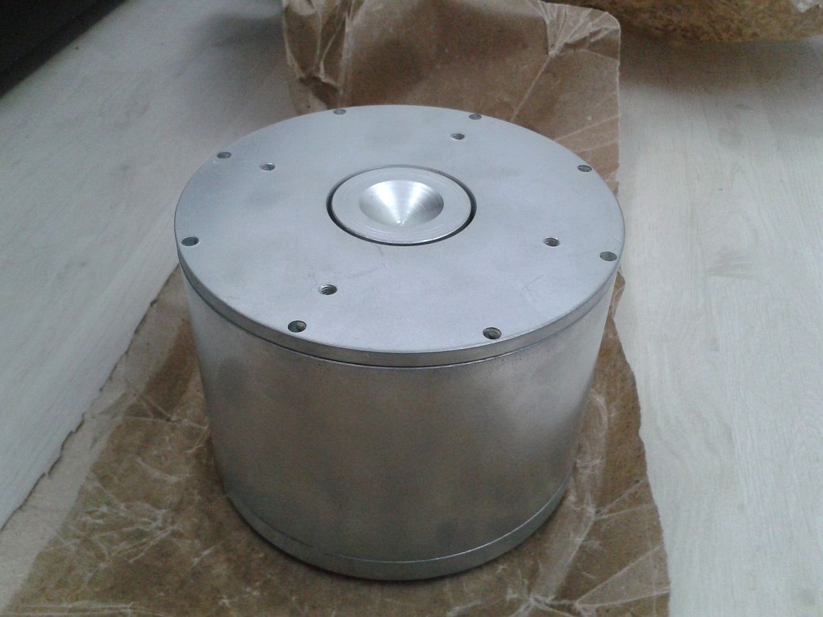

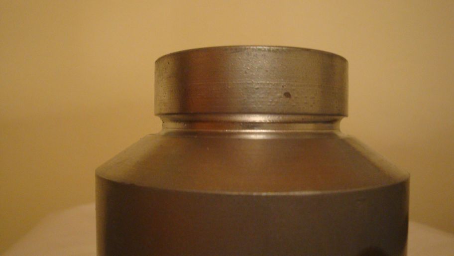

Here is a close shot of the new central pole piece with the T-shaped top.
In that groove i will fit the copper shorting ring. Also with the top plate so you can get an idea of position and such.

🙂 this should have been as a christmas present under the christmas tree!
Great job ! The frame is not diy?
Cheers guys,
@Allar88 frame is still not diy. I have a hard time finding a big chunk of aluminum or sheets thick enough to machine the frame parts and what little i found was very very expensive. But 2013 will bring the diy frame i'm sure.

You could always do a bolt/sleeve/slab construction like the Dynavox woofers are assembled. That wouldn't take much thought at all.
