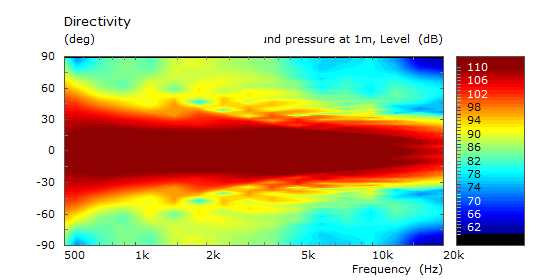

As LineSource pointed out for 12 inchers 1khz is about the 90 deg point. Once the whizzer cone is added, things change. From low high frequencies (1-3Khz) , depending on size ( mostly voice coil diameter as i have noticed) up to about 5-7kHz both cones work together and after that the whizzer cone has the significant role in output. Therefore the directivity pattern is pretty different from a normal mid-bass unit. A 2" voice coil makes life hard in this matter tho.
Below is an AxiDriver simulation of a whizzer cone i want to try out. This is just the whizzer without cone. Reality will be different because there is no way to tell how it will interact with the main cone and the simulation has the whizzer connected to chassis through wide surround.
There is much work i need to do to determine whizzer cone parameters. I have simulated various shapes, diameters and heights. Haven't done much regarding a possible phaseplug.

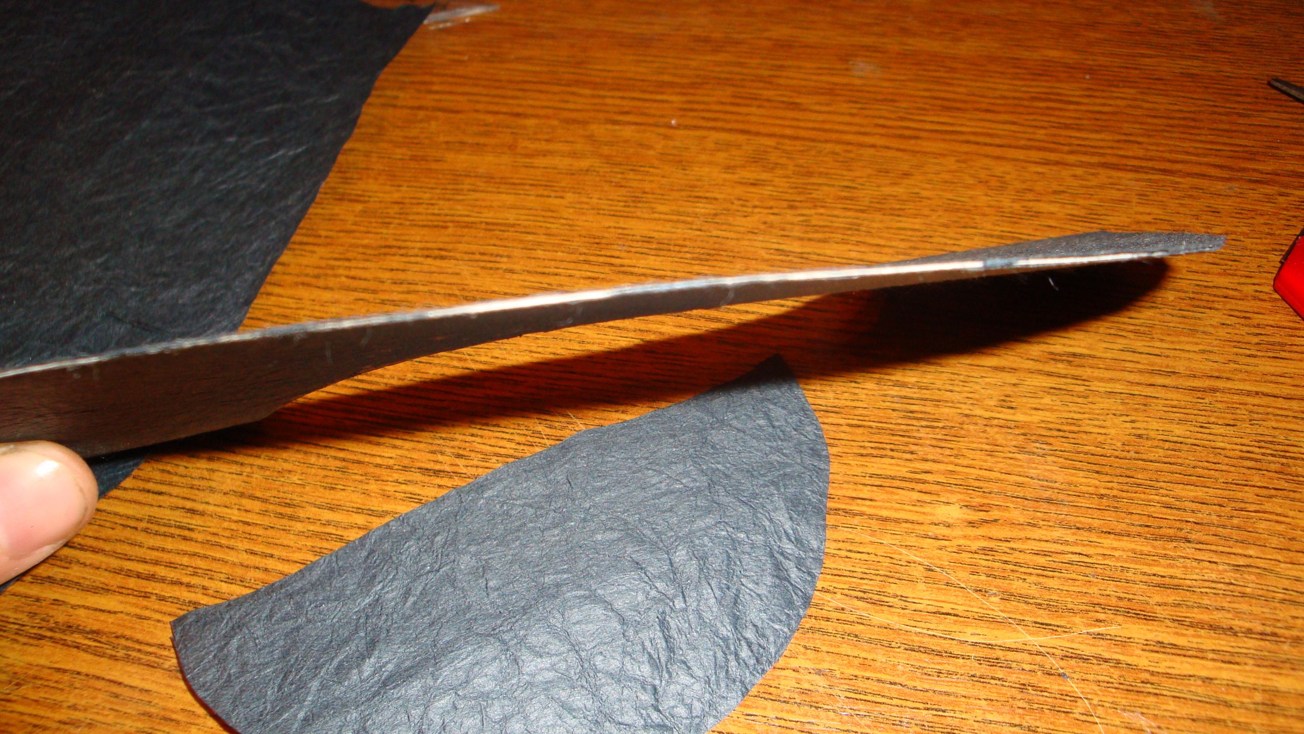

This weekend i started to test some cone shaping. So far i tried straight cones from a single plain sheet and petal cones. These are just try-outs but here are some pics:
To stiffen the cone i layered the paper like a sandwich putting a higher density one in the middle. Should try the opposite too.

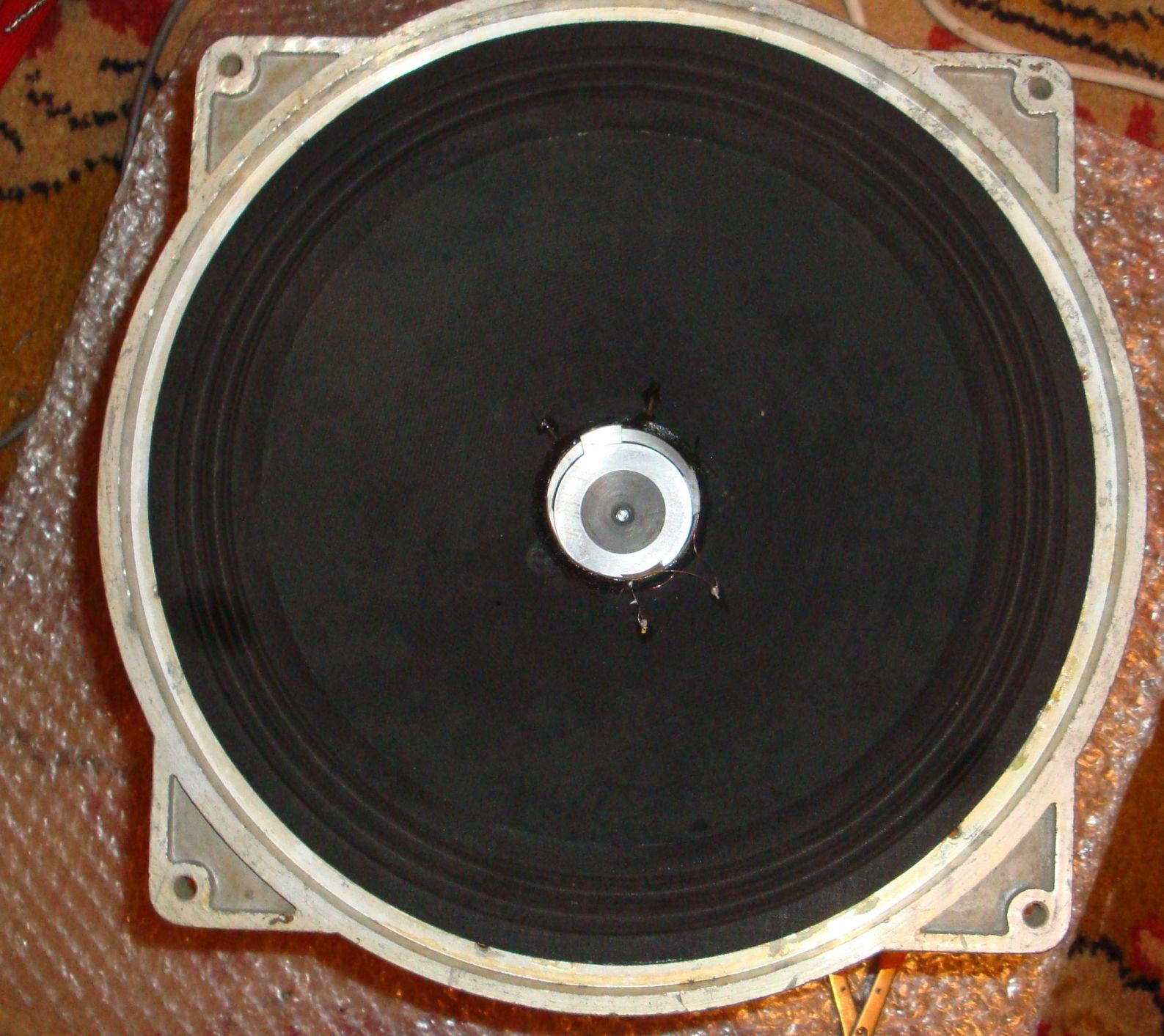

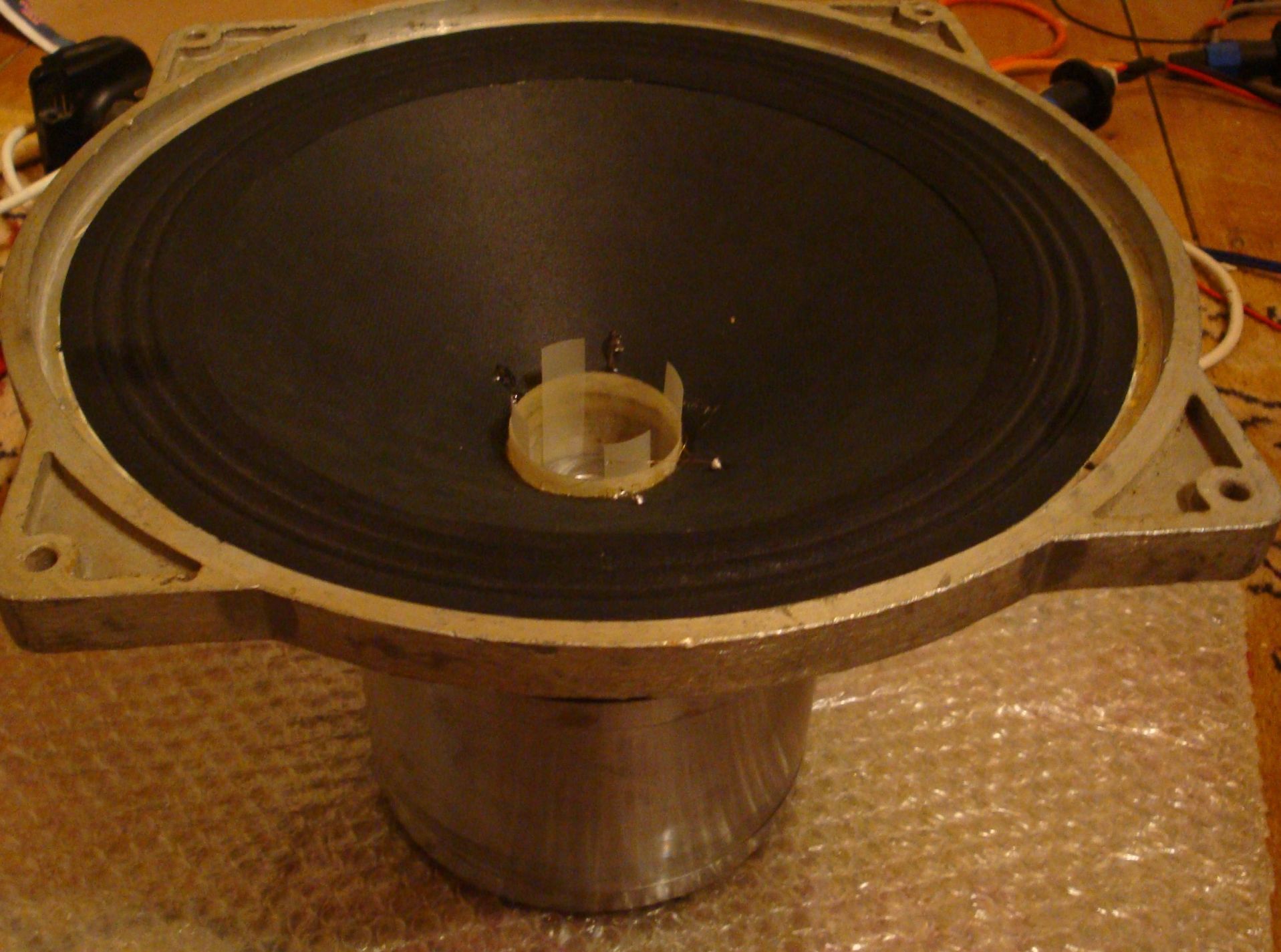

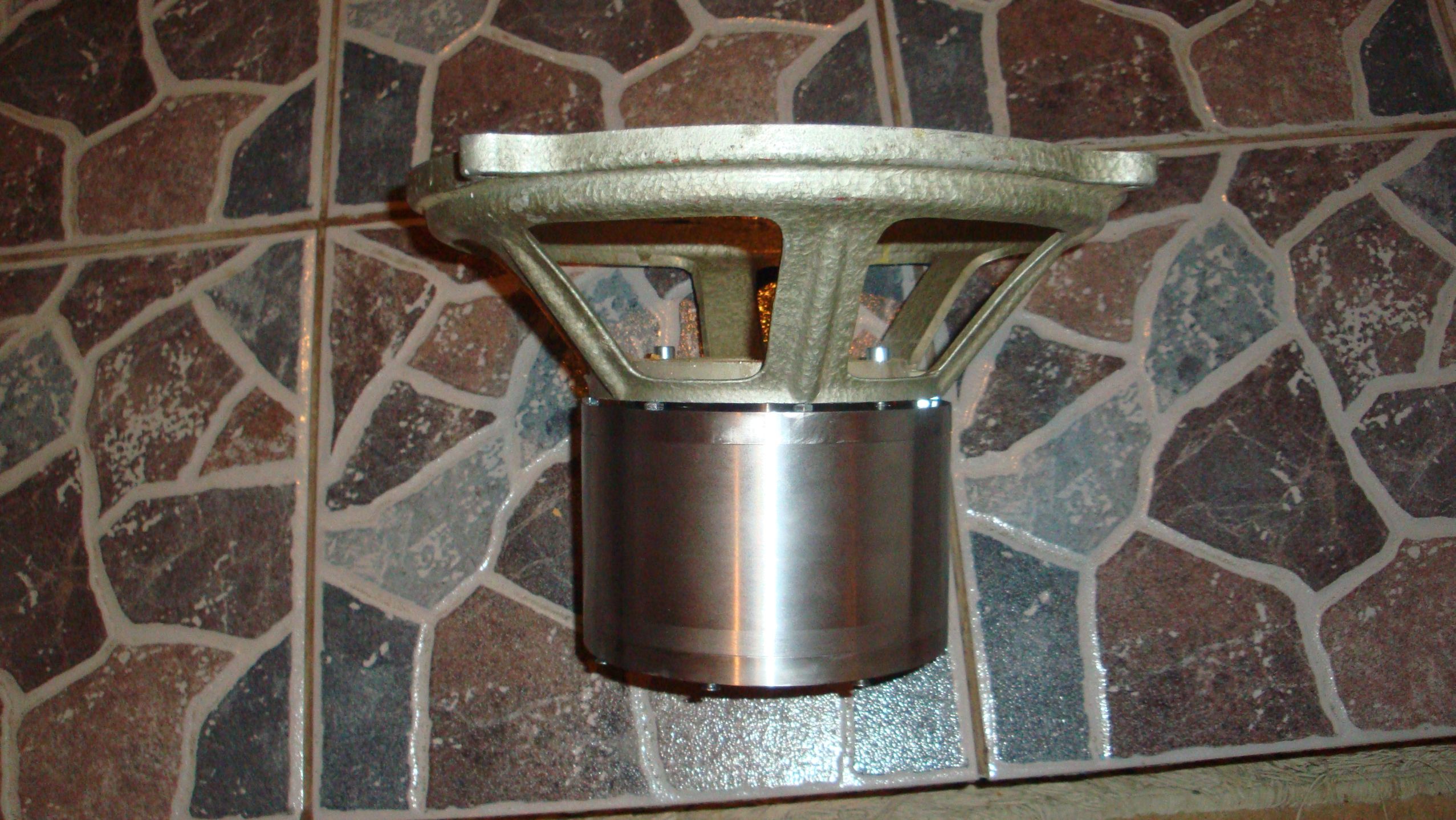

Things are progressing.

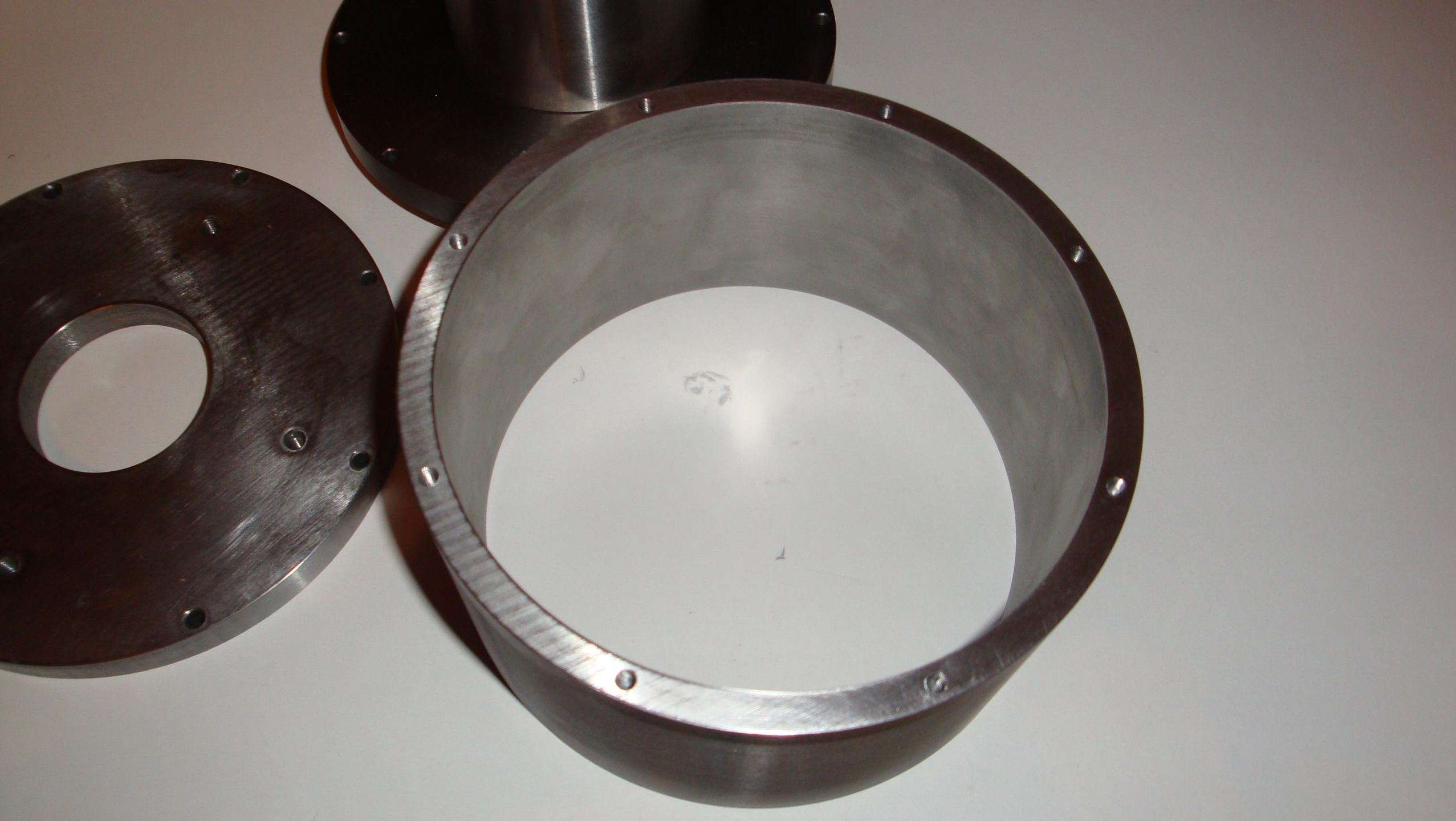

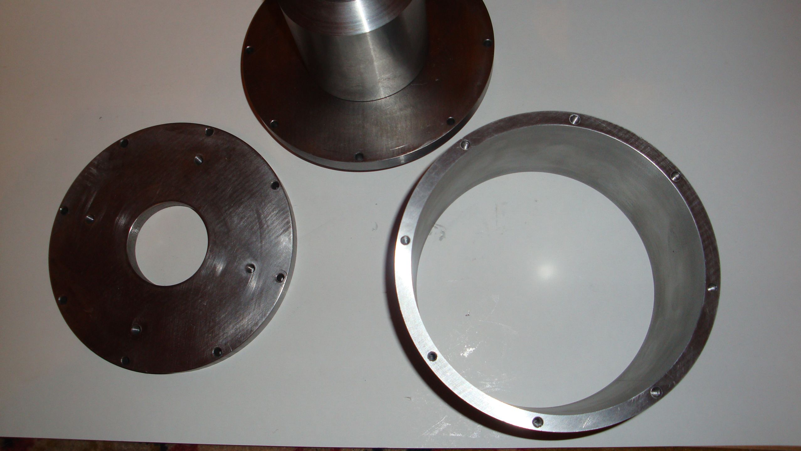

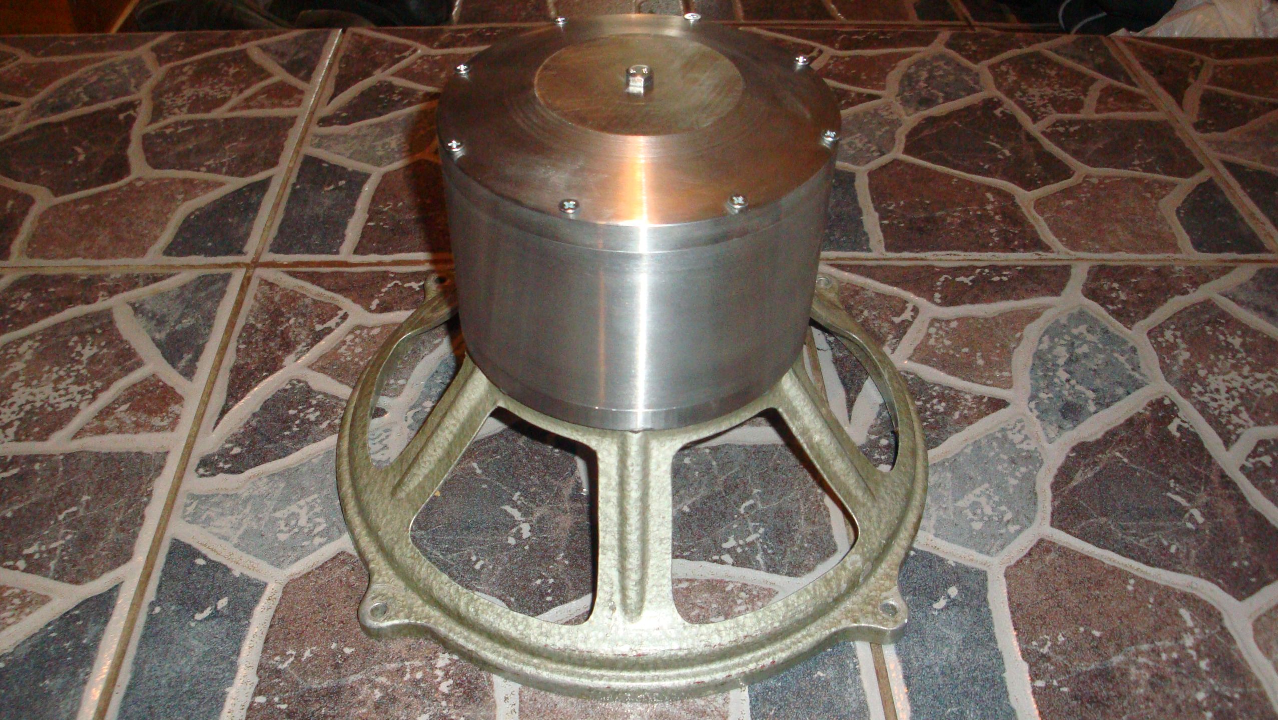

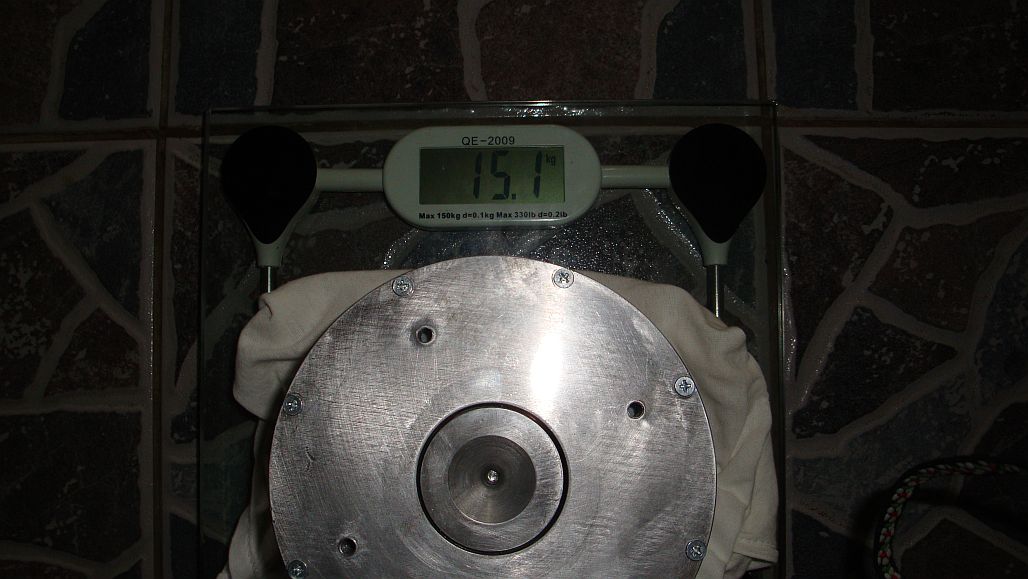

Here's the assembled structure w/out fieldcoil on a vintage 12" Al frame:
I will use nicer screws in the end, these are what i had on hand. 😛

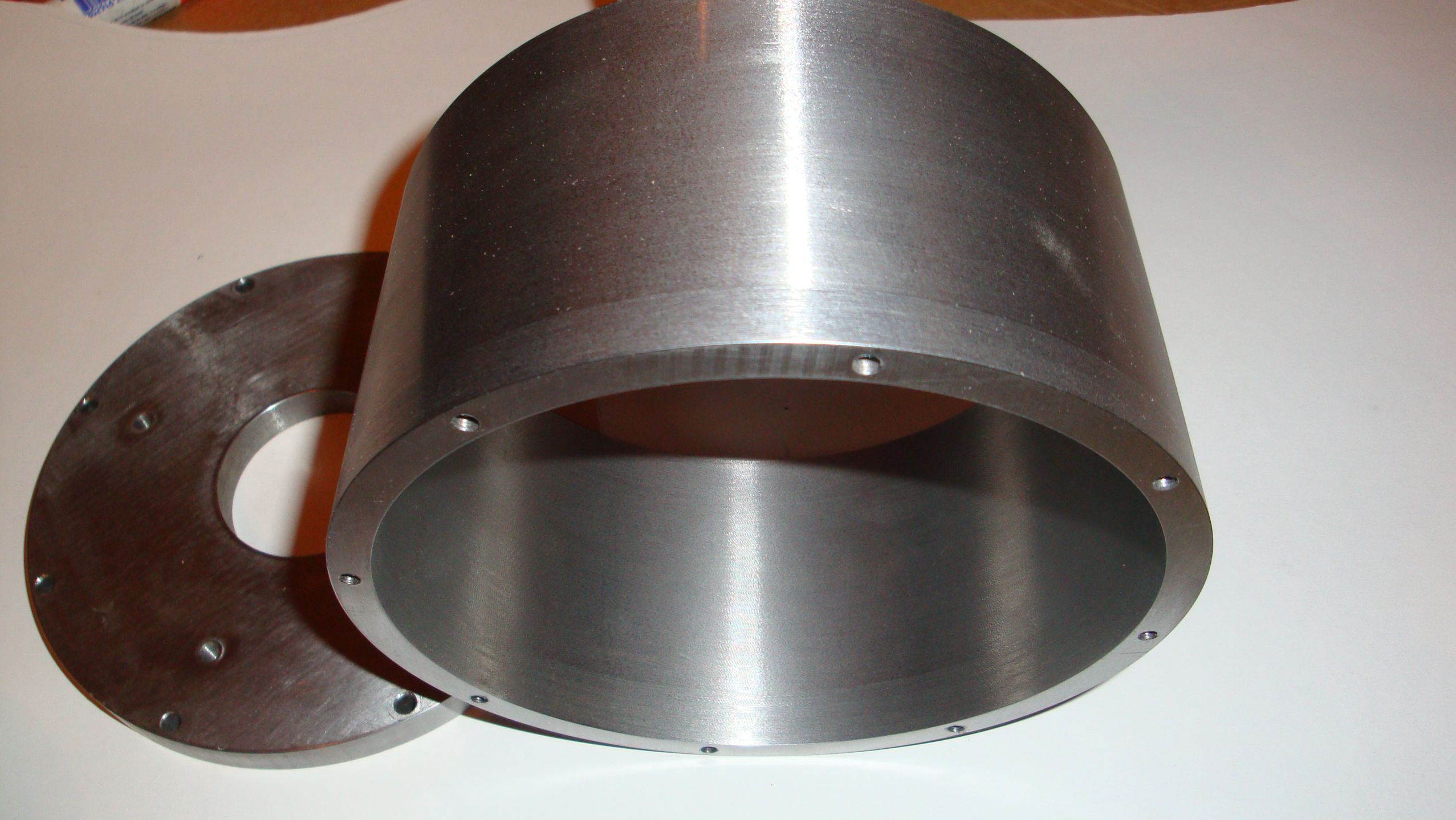

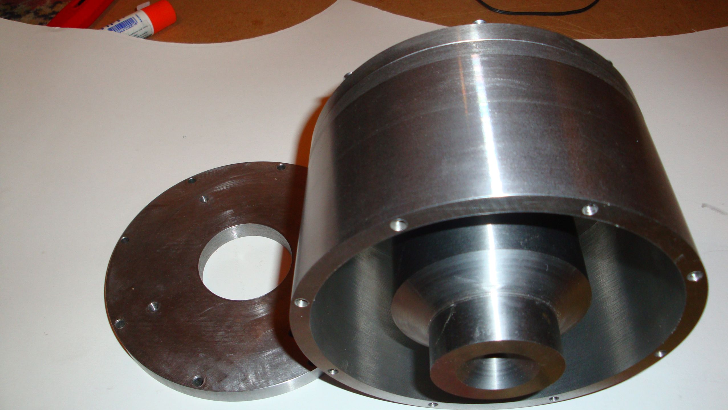

Wow, that motor structure looks great. 😀 Do you have drawings of the various machined parts you could post in the event that others might want to copy your efforts?
Hello Kevin, yes, after some testing of the motor and if no major adjustments are needed to current design i will post the full schematics.

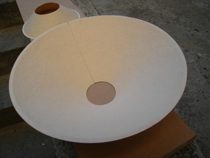

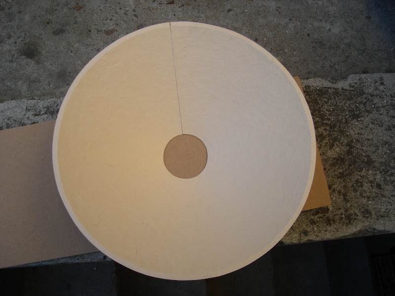

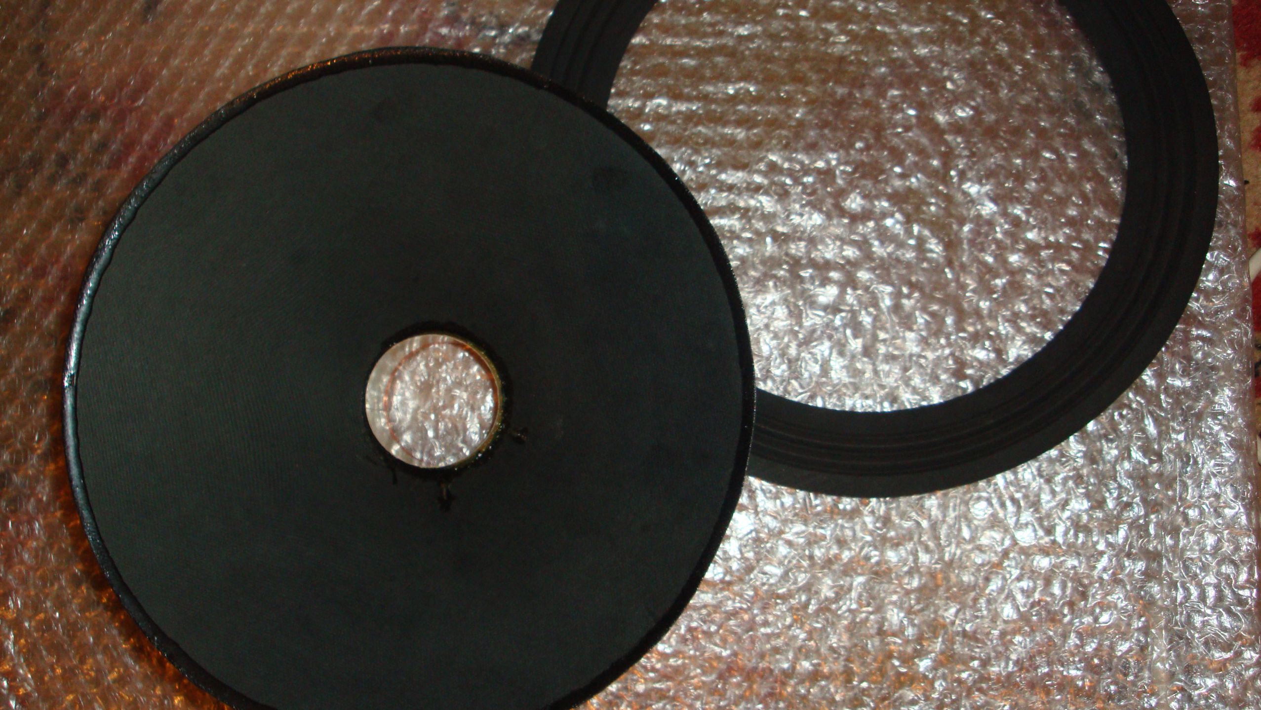

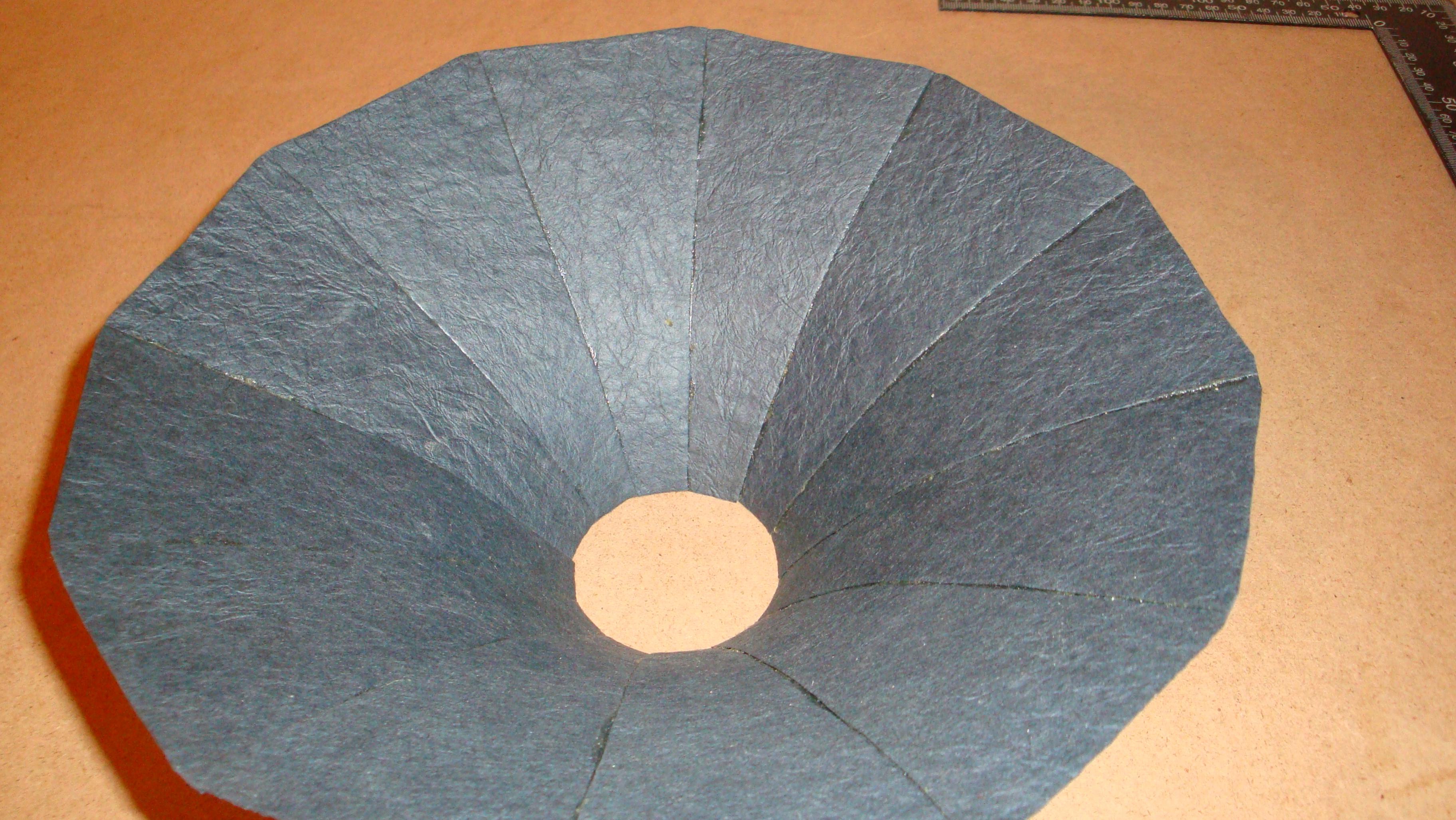

But here is a little teaser. A friend and countryman helped me and manufactured a couple of mullbery paper cones. Here are some shots:

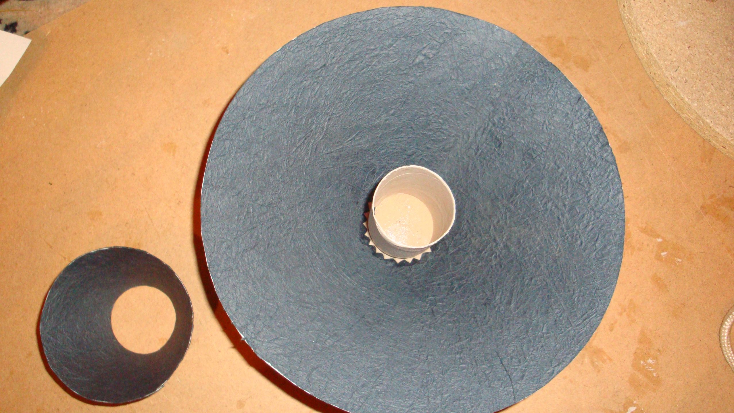

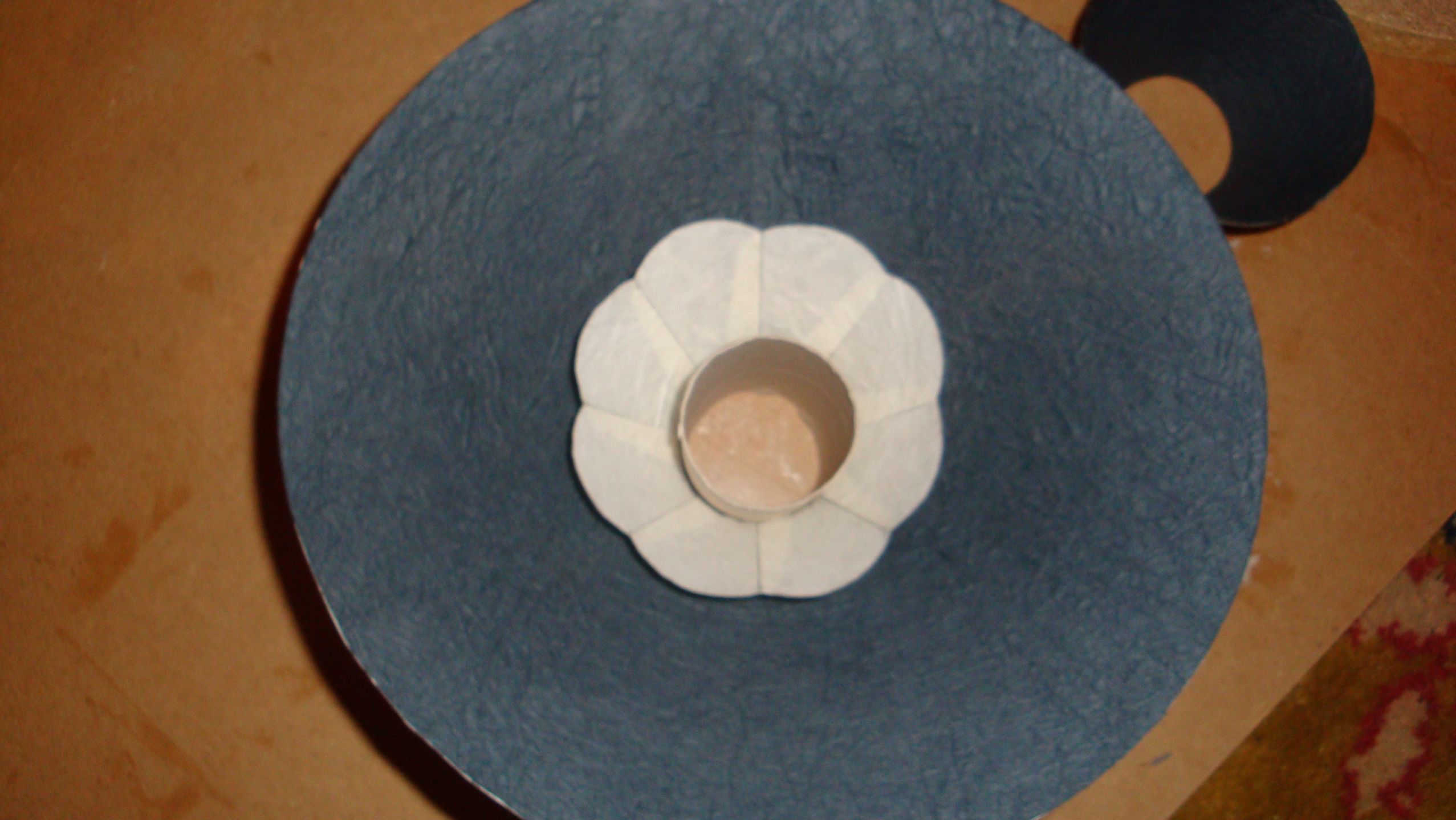

I'm also making exponential curved cones, from 12 petals, washi paper. I'm still experimenting with stiffening the washi.
I will test everything i can. Straight and exponential and maybe hyperbolic but i fear the curvature will be too great.
So far mass is well within my goal. I will perform as much tests and measurements as i can and my equipment allows on all cones and whizzer types. Hopefully phase plug variations too.

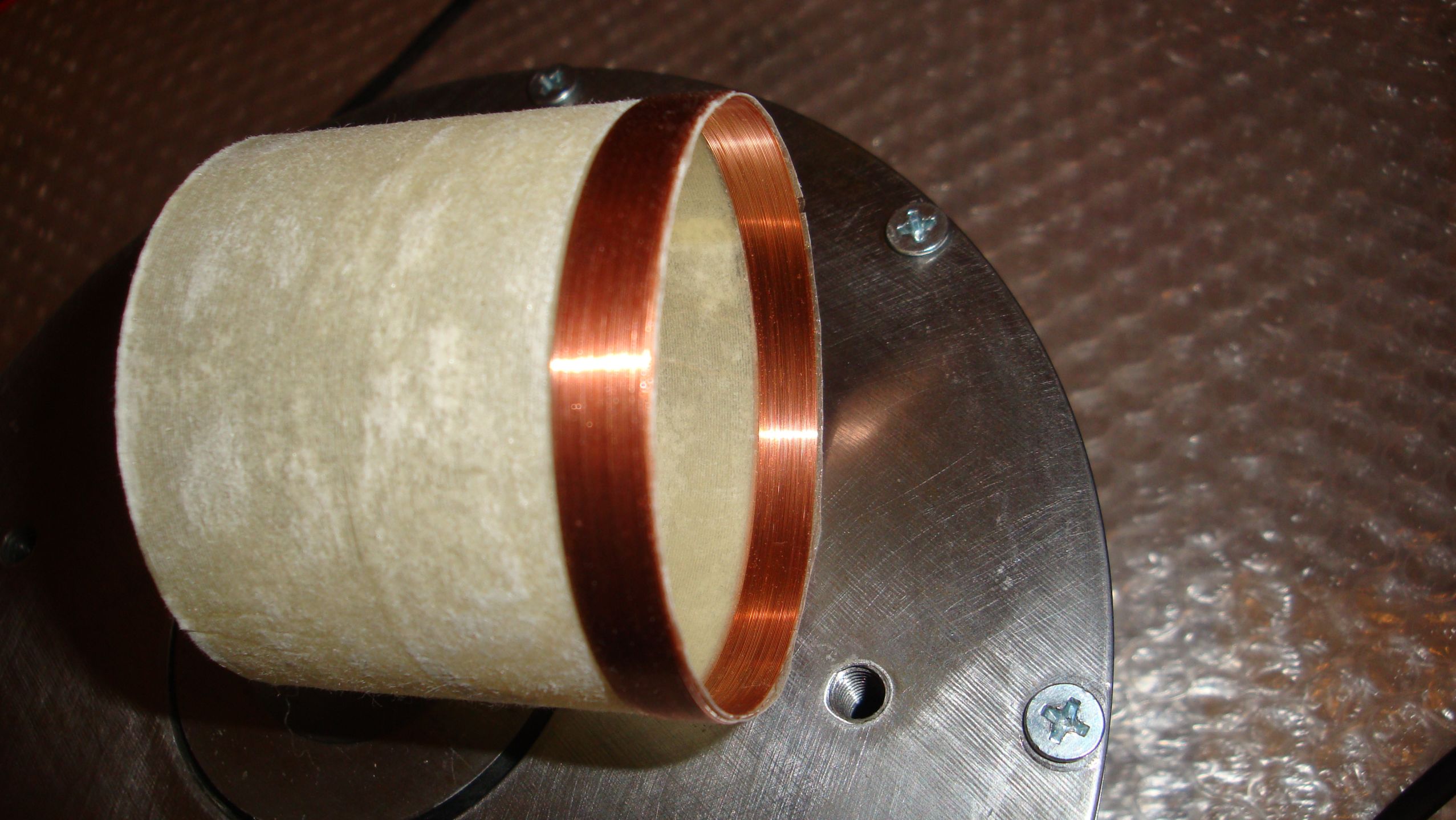

Hello,

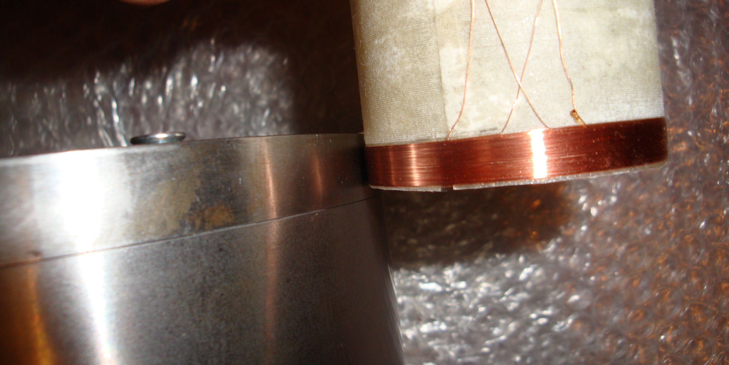

The thin wire at first although allows for greater lenght in the gap increases the number of turns and so increases inductance but there is a way to wind it to get around that... i think 🙂
QUOTE]
....cross winding? Time consuming or even possible?
Beautiful work!
Peter
Im not really sure what you mean by cross winding applied to voice coil.
What i am considering is 2 coils in parallel. One on the inside and one on the outside of the former.

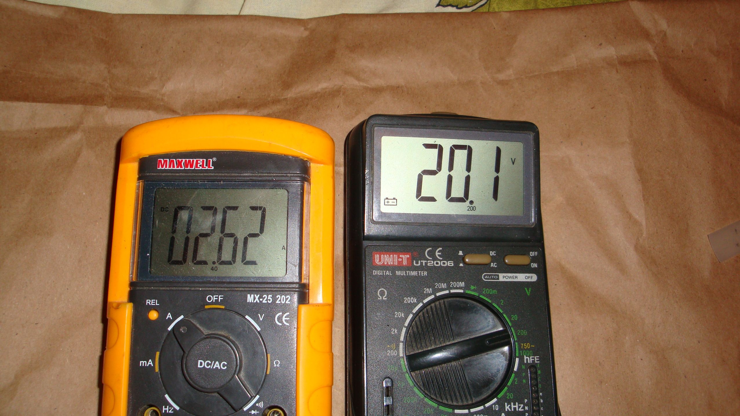

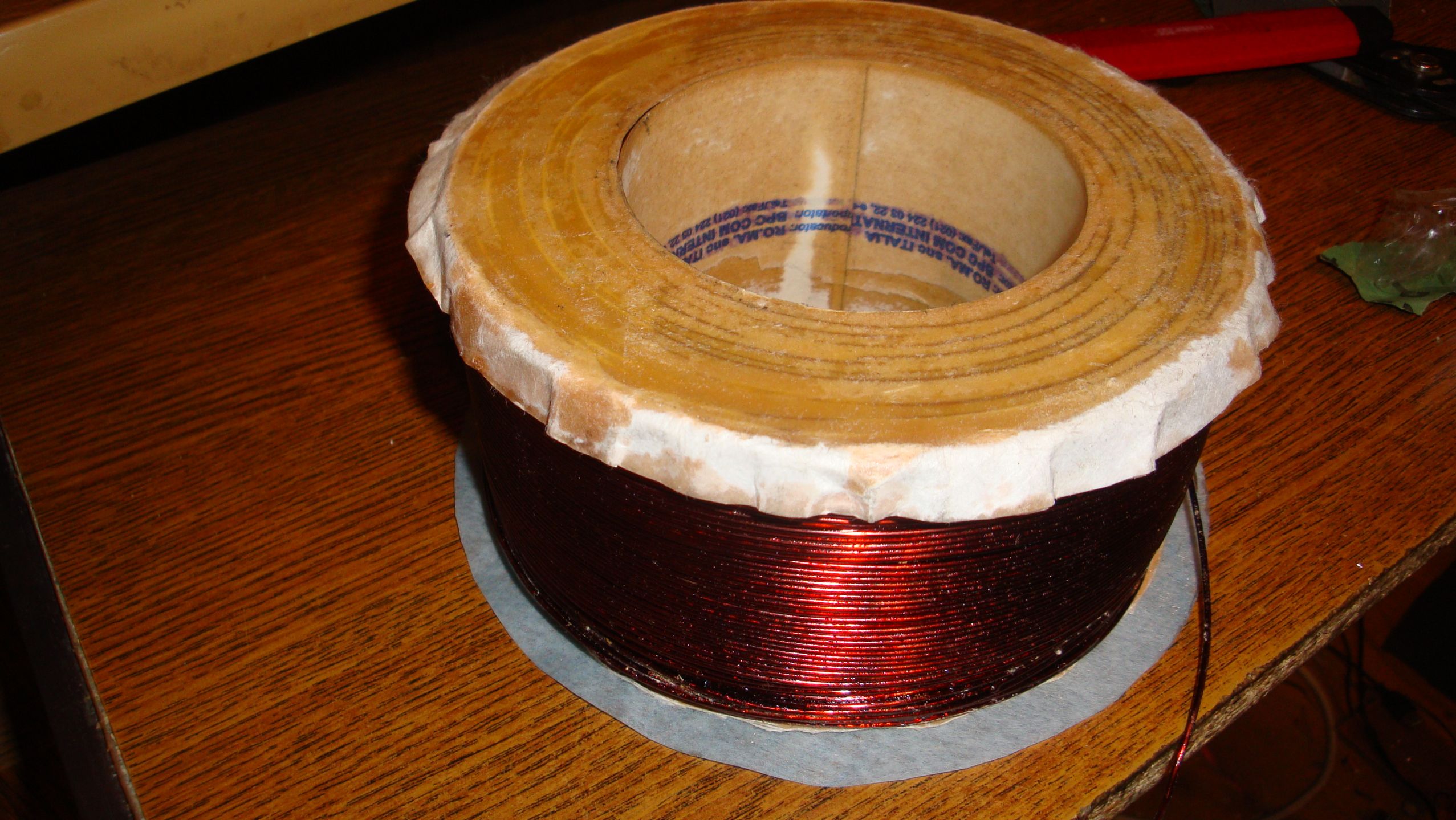

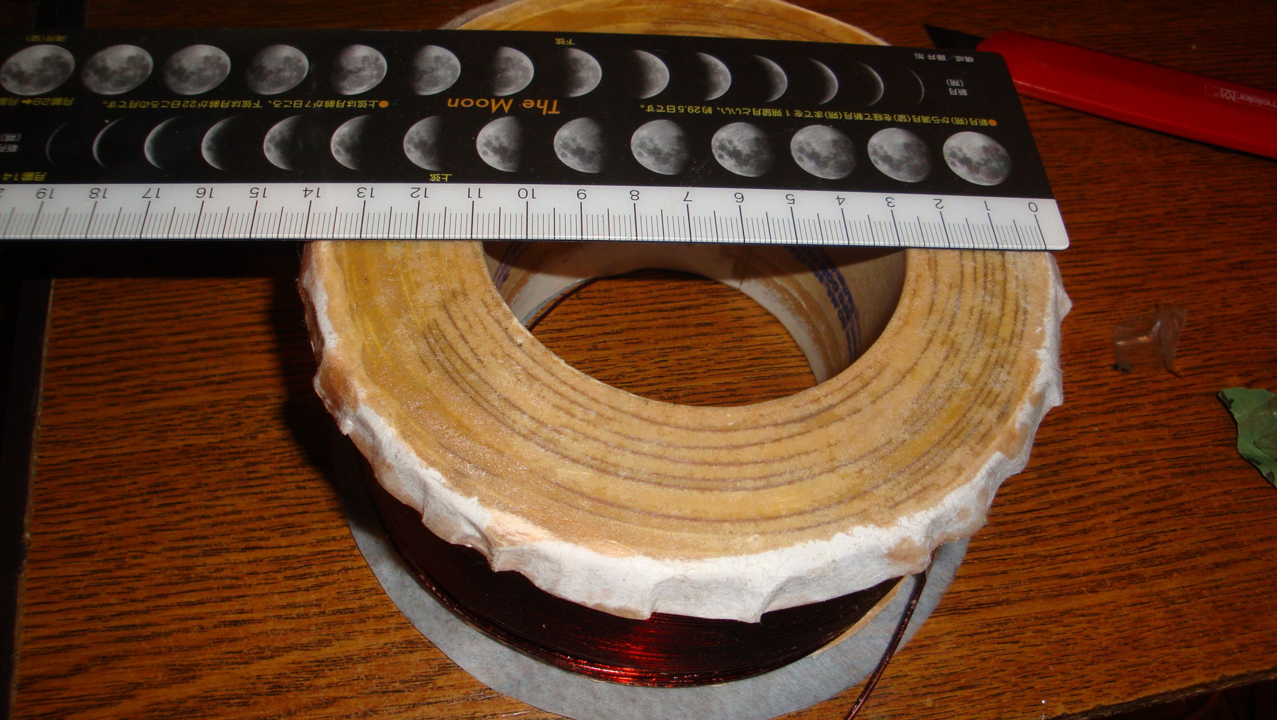

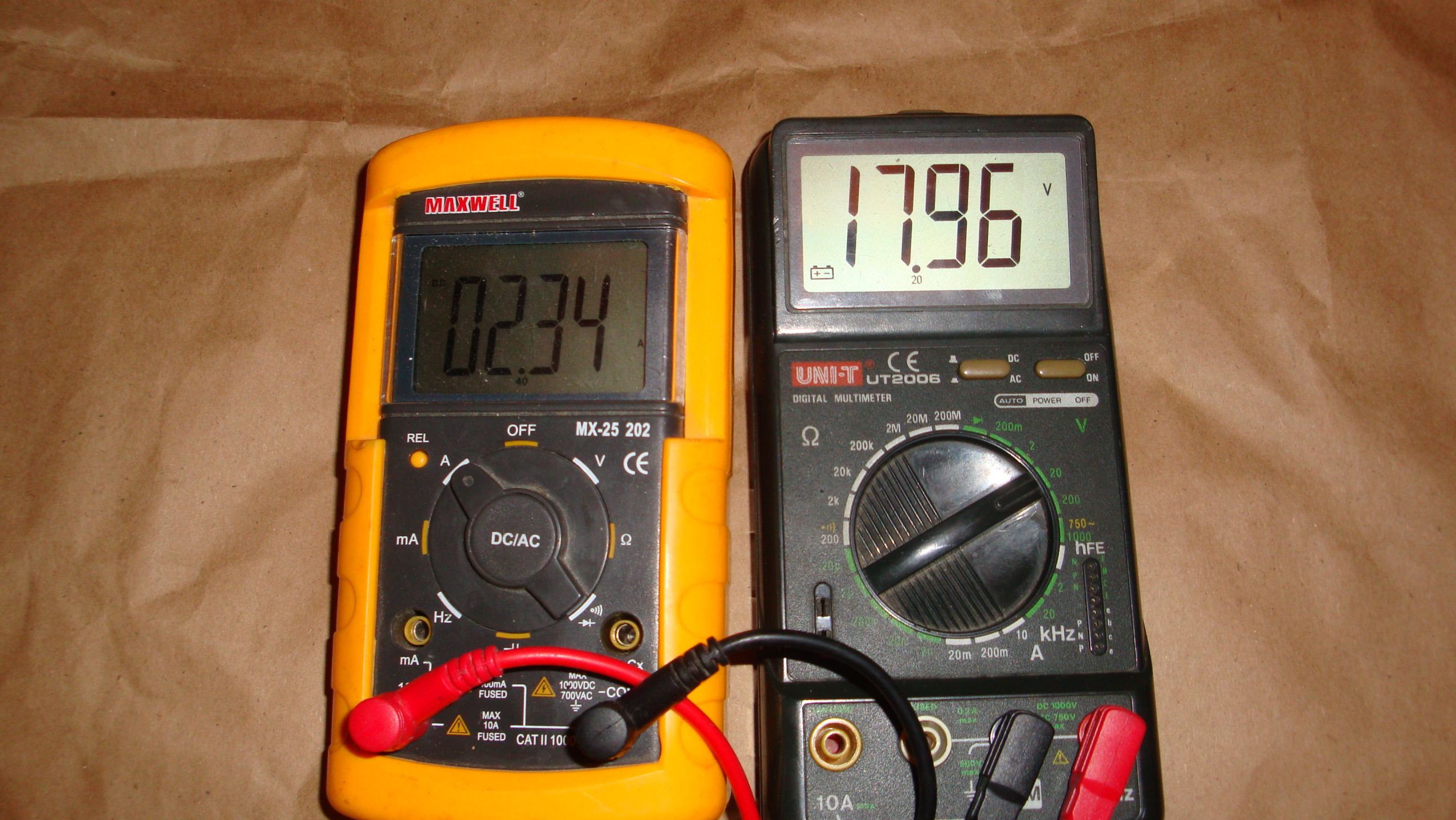

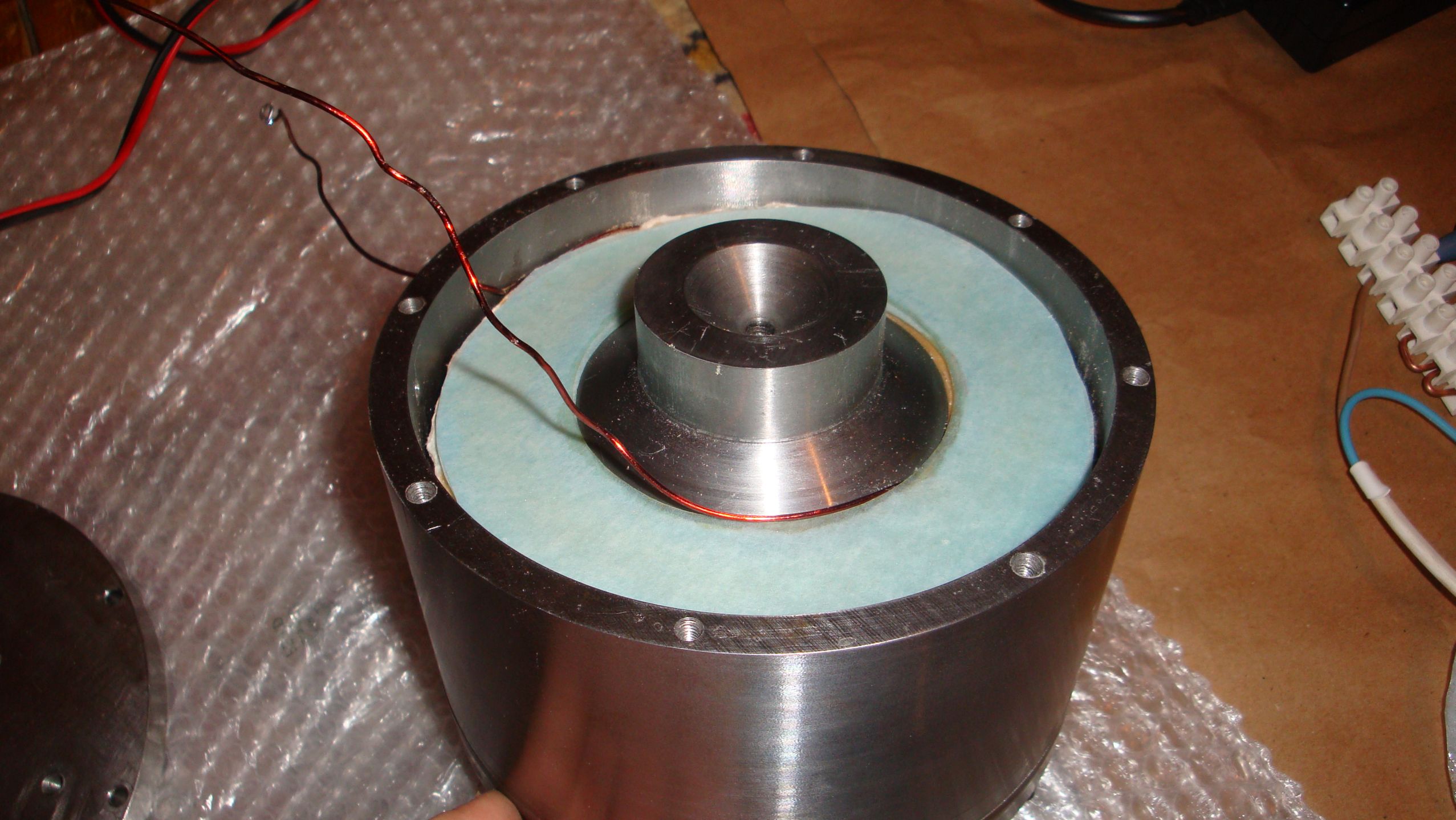

This weekend i was able to perform a few tests. Placed the field coil inside and did a few measurements of field strength. FC measures 7.1 ohms and 124mH. The higher DC resistance will require a higher supply voltage than my initial goal.
Because of the enamel coating the wire thickness is smaller, for a 5.3 ohms FC the motor structure will need to be a tad bigger.
In order to determine the field strength i had to measure BL, after that knowing L i could determine B value. BL can be computed by measuring the impedance of a complete assembly so i used a factory cone to quickly put together the loudspeaker.
I used an 16V/7.5A IBM power supply at first and that gave a current of about 2.2A through the FC. I made another power supply with a multitap transformer a 35A bridge and 2 x12000uF/56V to test other supply voltages.
Results are the following:
A---------- V---------- Rdc-------- Fs--------- Qes-------- SPL-------- Mms--------- BL--------- B
2.38------- 17.98------ 13.47------ 33.65------- 0.258------ 96.47------ 38.94------- 20.72------ 1.48
2.52------- 19.34------ 13.57------ 33.65------- 0.255------ 96.52------ 38.94------- 20.93------ 1.50
2.65------- 20.3------- 13.59------ 33.65------- 0.2496----- 96.62------ 38.94------- 21.17------ 1.51
4.33------- 33.6------- 13.74------ 33.65------- 0.21------- 97.34------ 38.94------- 23.13------ 1.65
It seems that FEMM simulations predicted a good value and I am right on target with a B value of 1.5T at 2.5A. The factory cone is heavy so the SPL isn't spectacular.
at 2.5A heat is not an issue, at 4.33A the motor structure was warming up but still not a big problem, you can also observe the rise in Rdc because of that.
