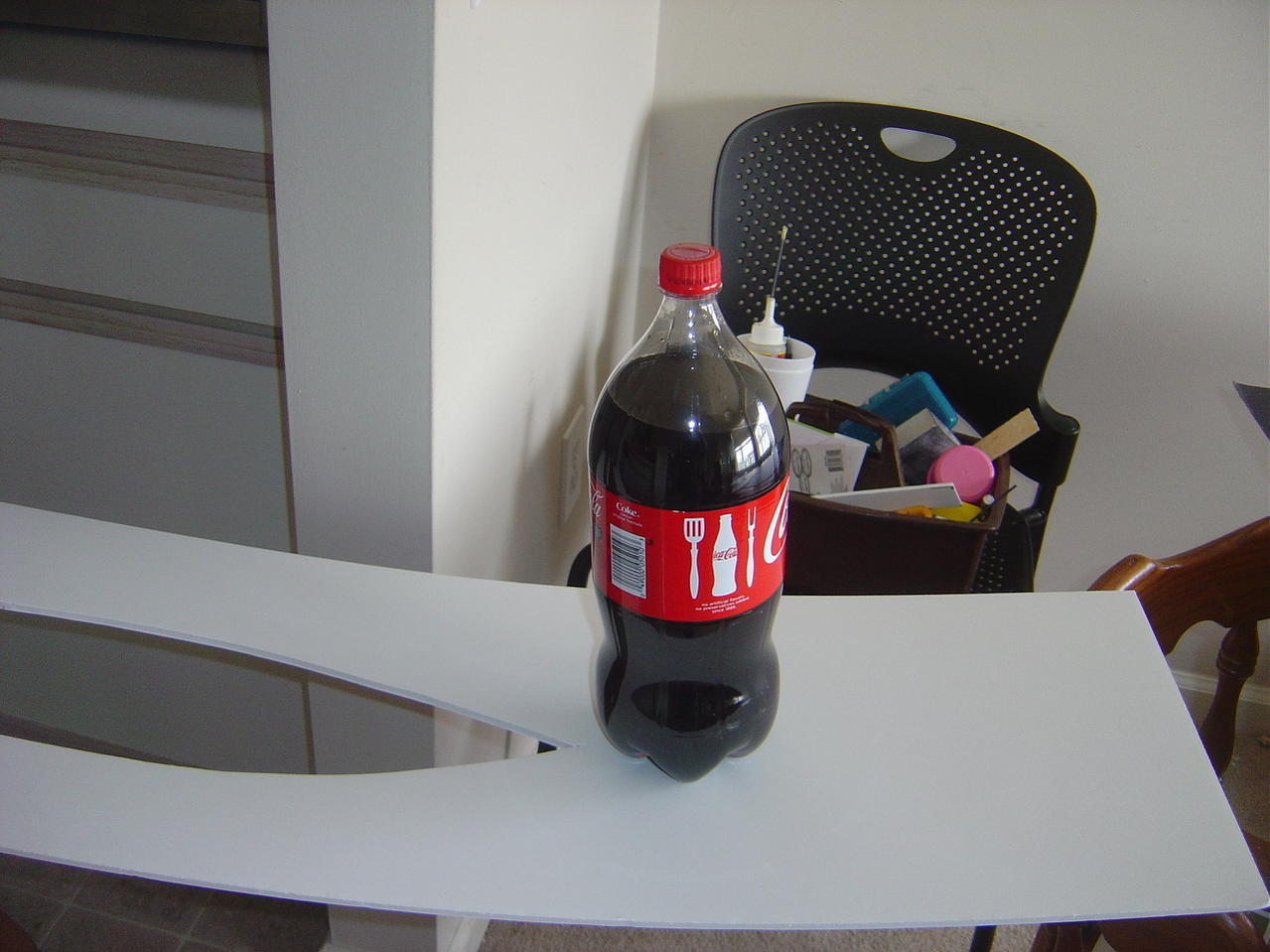

I bought 2 20 by 30 inch sheets of cold press heavy paper. Its 300 grams for a square meter. It was cheap and I know I'm probably going to trash it trying to make a cone with it. I don't think I can cut one cone from a single sheet. So I might do a half per sheet. That way there's a seam on each side of the cone. The seam will give it more rigidity. I've even though about doing it in 4 pieces. It would make the cone stronger as far as flexing goes.

Maybe try an uneven multiple, like five or seven sections - the 5 "petal" surround used on some of the Vifa speakers really does work very well and is very good at reducing resonances.

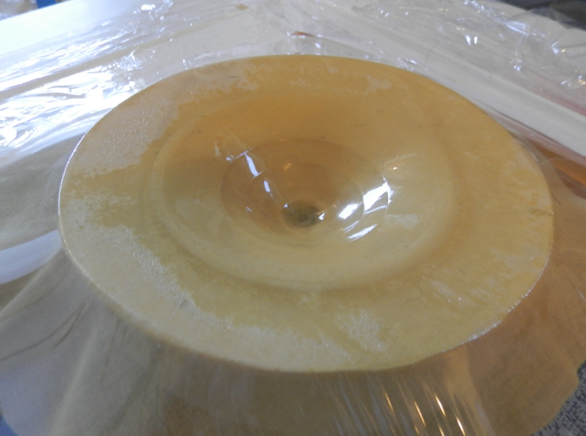

If you are going for a ultra light cone for your woofer, you could use 3mm depron. I made a cone for a 6” full range and it had a weight of 0,9grams (hard to beat), but the material was not stiff enough to support high frequency. But this might bee a interesting material for a woofer, and you can make it very strong by making it as a composite material with paper on each side. See picture.
Also depron has a high degree of self damping, so if you are up to experiment this might work for you.

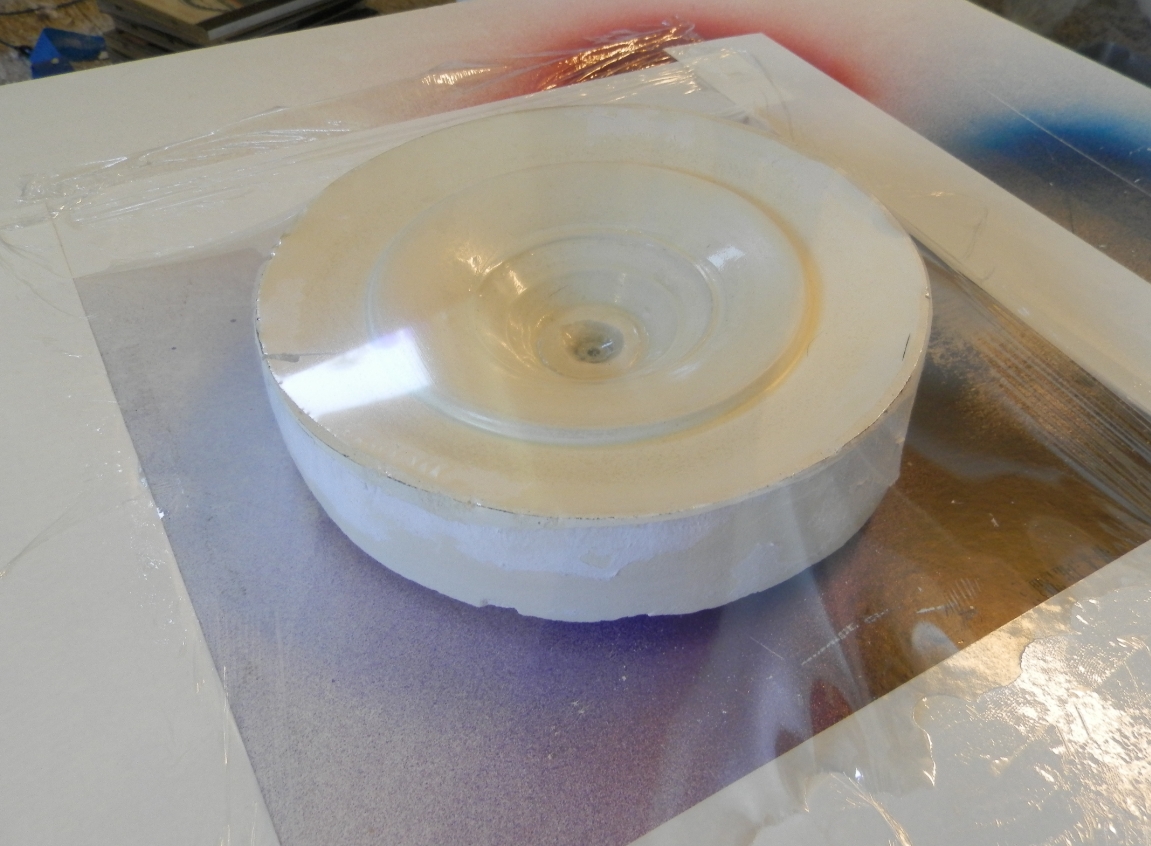

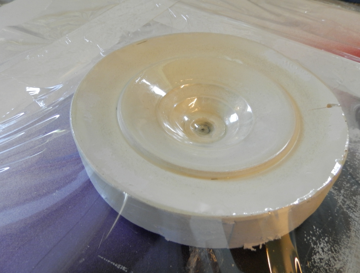

I have also added some pic's of how I do the vacuum cone this one I used the primer 92 epoxy it's curing up a bit harder that the aero-epoxy. also I got some epoxy that can stand up to 180 degrees C for voice coils.

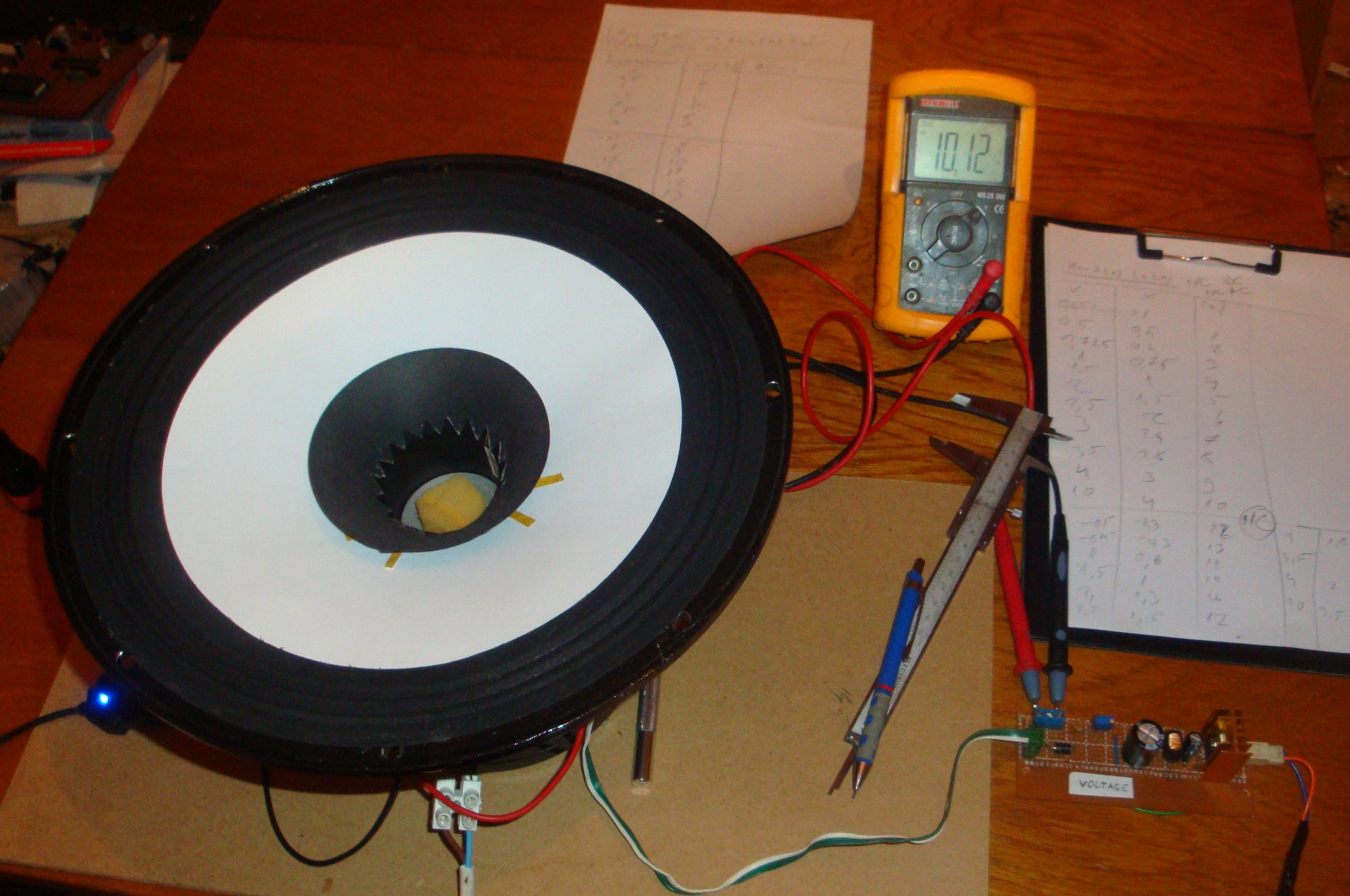

Alright some data now on the development of my 12 incher ( I know Frank's been waiting 😀 ). I started procesing the data on the reverse way i introduced it so first version tested was with the voice coil no 3.
Characteristics:
Paper former
Nominal Diameter: 50mm
Height: 5mm
Wire diameter: 0.15mm
Wire: ECW
Dual voice coil, 2 layers each.

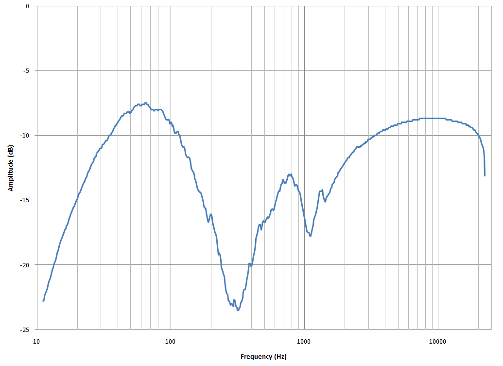

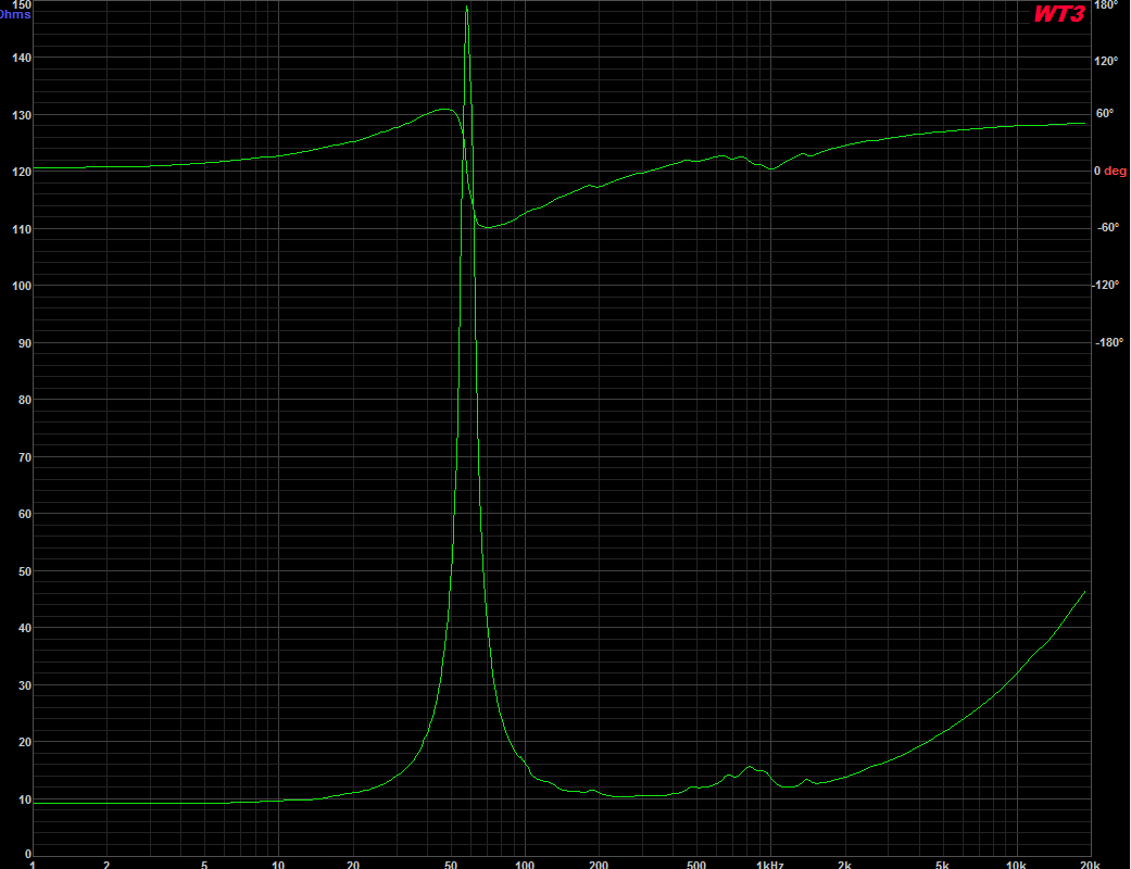

This is the heavy voice coil, lots of copper in it. Below you can see impedance curve of one such coil.
You will notice high inductance, its the big coil (the other vcs will get lower haha) Also the disturbance around 1k. Havent figured that one yet.
Fs just below 60Hz still in my good zone.

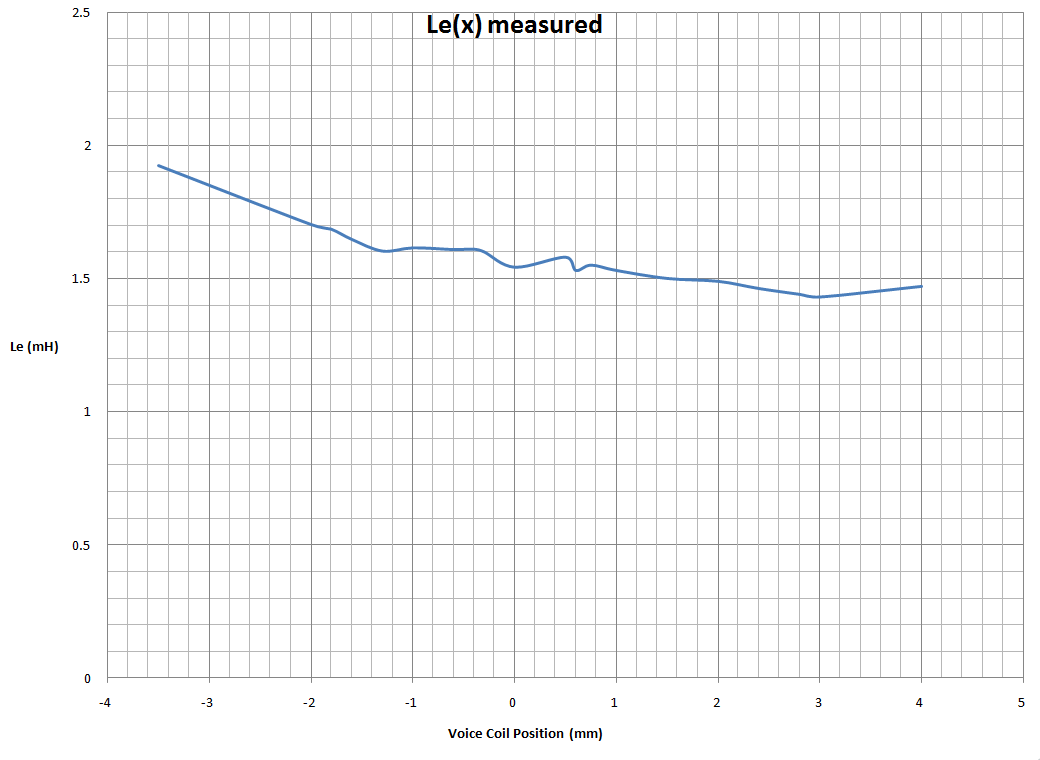

I wanted to plot Le(x) and BL(x). Le(i) and Kms(x) would be great too but i still need to find some practical solutions. Even Le(x) and BL(x) not sure how reliable they are but they are pretty close to FEMs and also similar in variations denoting the influence on each other.
I couldnt move the cone with pressure but since i had 2 voice coils i put a DC voltage on one coil and measured impedance on the other. The DC voltage will created an offset in voicecoil position so i can see it's influence on those parameters.
To adjust the voltage i made a circuit based on LM2576T-adj. Using a multiturn pot can grant you a high enough sensitivity to adjust in mV range. Schematic is the easy datasheet one.
Right now i got the data for +/-3.5mm excursion. Looks pretty good with the normal tilt towards the inside of the motor where fringe field is stronger. Negative values indicate position inside motor, positive values indicate position outside the motor.
Even tho inductance is high, delta is pretty good, advantages of underhung motors.
Because one voice coil is connected to voltage supply it will appear as shorted to the other. Here is impedance curve without supply connected but shorted.
Here you can see impedance curves with VC mostly between +/-3mm. You will see 2 spikes at different resonance frequency. Thats taken at +/- 4mm excursion and Kms(x) kicks in on this particular model.
To show abit about impedance and what happens i swept a sinewave on one voice coil and measured the voltage on the other one. In the graph below basically it is the Back EMF and you can see how it actaully follows impedance because they are closely related, intimately i might say.

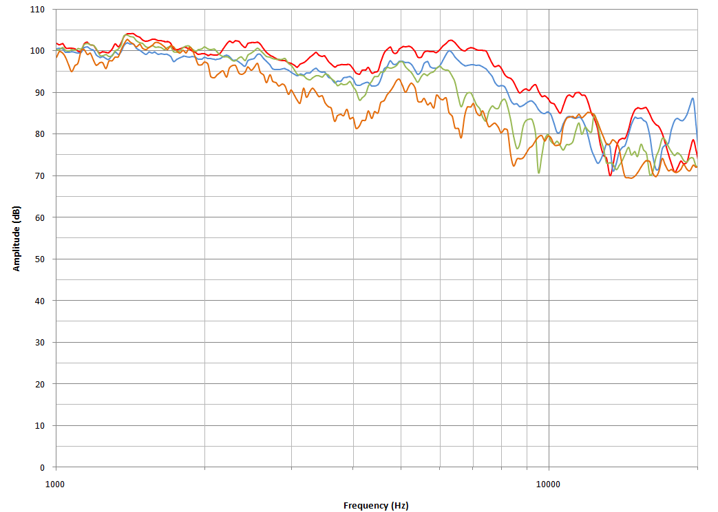

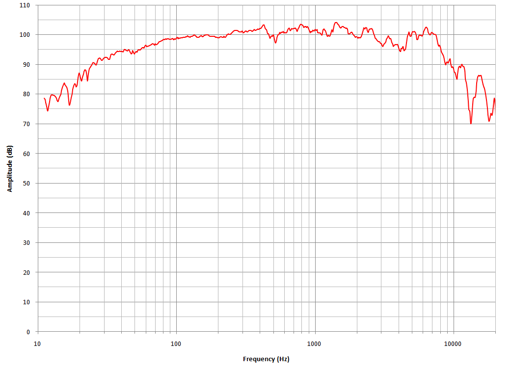

To finish for tonight the frequency response and impulse response:
Here is a zoom in also showing 30, 45 and 60 deg off axis:
<sigh> Still not in the last octave but looks promising, maybe with the other voicecoils?

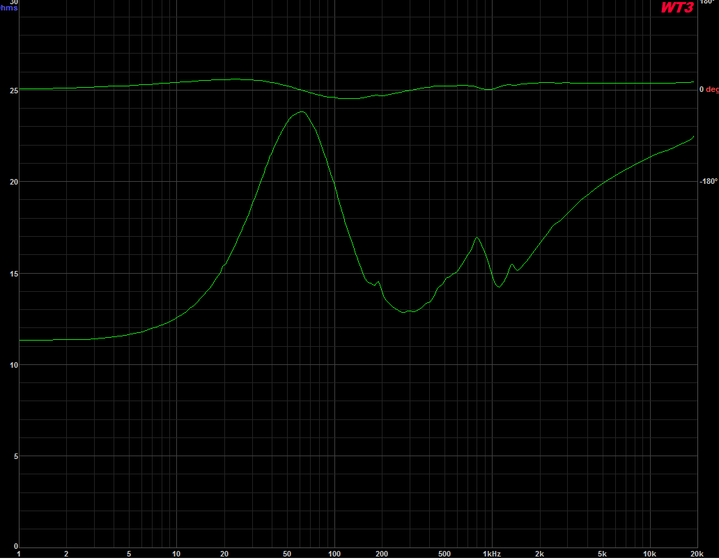

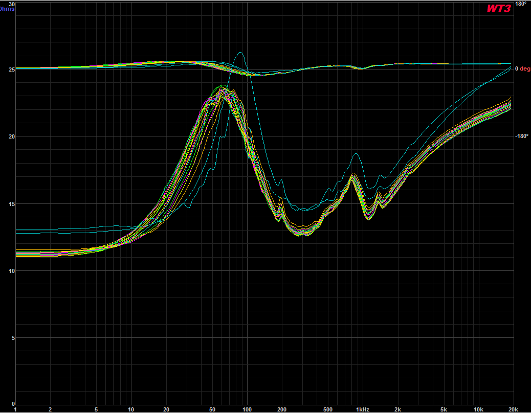

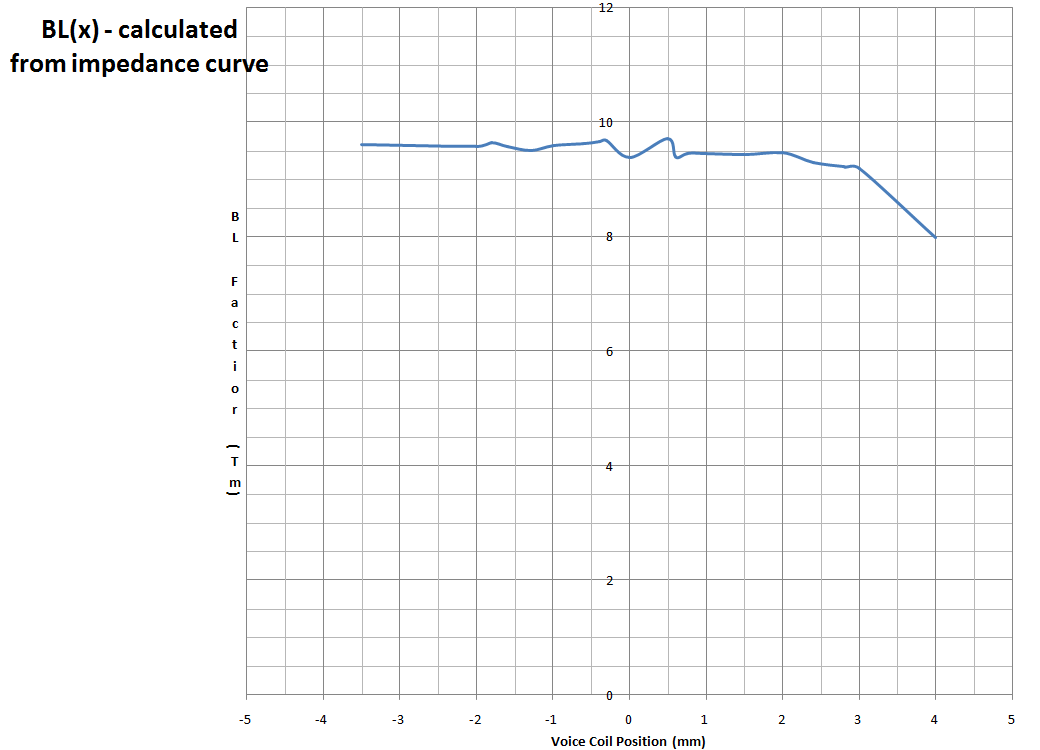

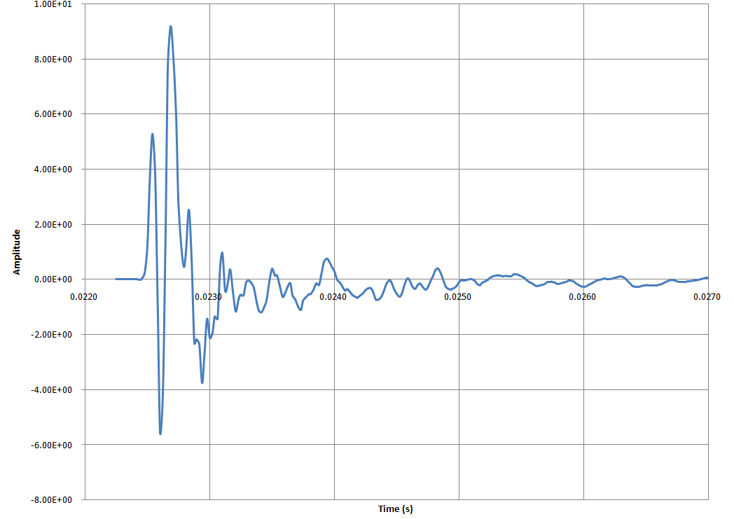

Thank you, I want to figure out what that 1k bumb in impedandance and back emf is, also I've looked at an IR distance sensor in order to automate the BL(x), Le(x) and Kms(x) measurements. Im not sure how precise the sensor will be because i havent found any resolution data on it but it is cheap (about 5$) HSDL-9100-021 from AVAGO. Looking at the datasheet tho, measuring from 40-50mm from the device it will have a 15-20mV slope for 10mm distance so that would be 1.5-2mV/mm so would need at least 12bit adc and/or low noise amps.

The disturbance around 1K isn't this typical for spider/surround resonance freq. ? I thought I read something in a article. Maybe I can find it if you like. Mostly there are two spikes one for the spider and one for the surround. (depends on weight and strength)

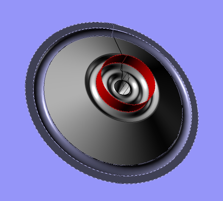

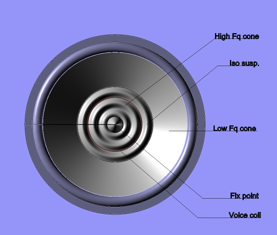

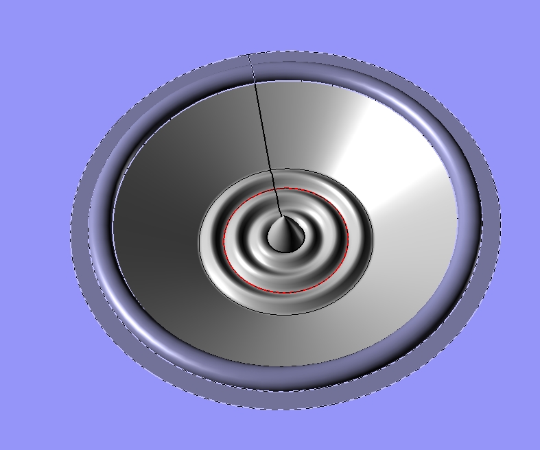

I was thinking about how to make a design without a spider, and I came up with this idea. This is inspired by the Vifa's ring radiated tweeter. I wanted to use “spider” as a part of the cone to work at high frequency and the main cone as the low frequency.
The drawing is just a sketch, just to give you an idea.
The centre is a fixed point this is where the high frequency cone is attach, is has the shape of a spider and act like one. The high and low frequency cone are isolated by a suspension that allow low frequency to travel to the large cone.
Please feel free to comment.

Frank thats pretty neat, 2 rolls between voicecoil and phaseplug might be too much.
Frank look at the altec duo-cone drivers. They are very similar to what you are trying to do. Figured they might give you some insight.
