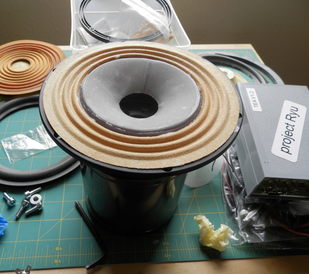

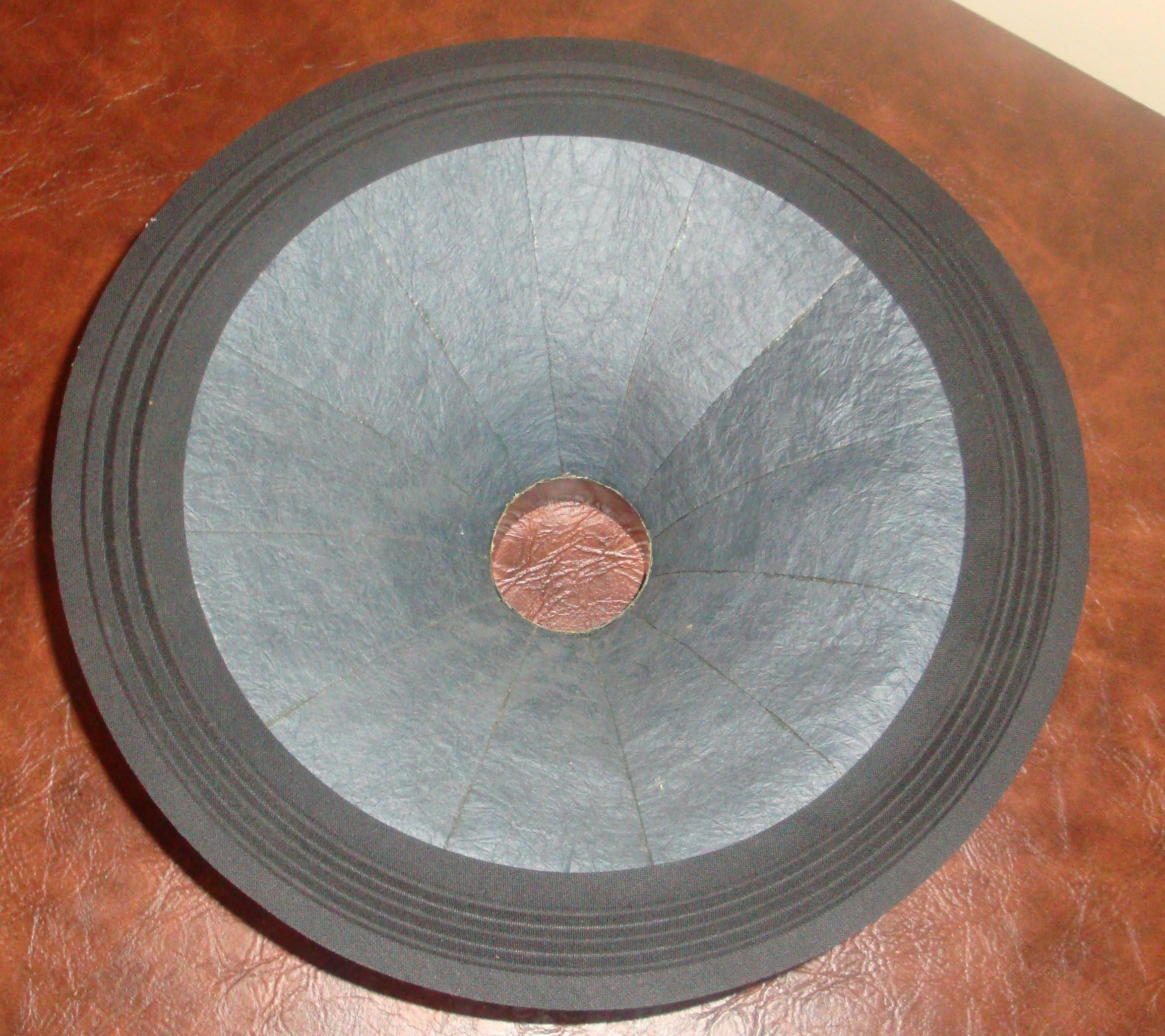

Yes.... please post a picture of your cone, I would love to see it
man, I need to build that chassis soon 😡 😛
Very nice, I like the pattern.

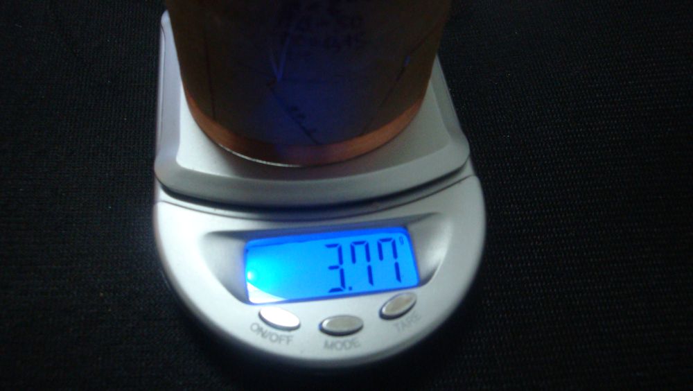

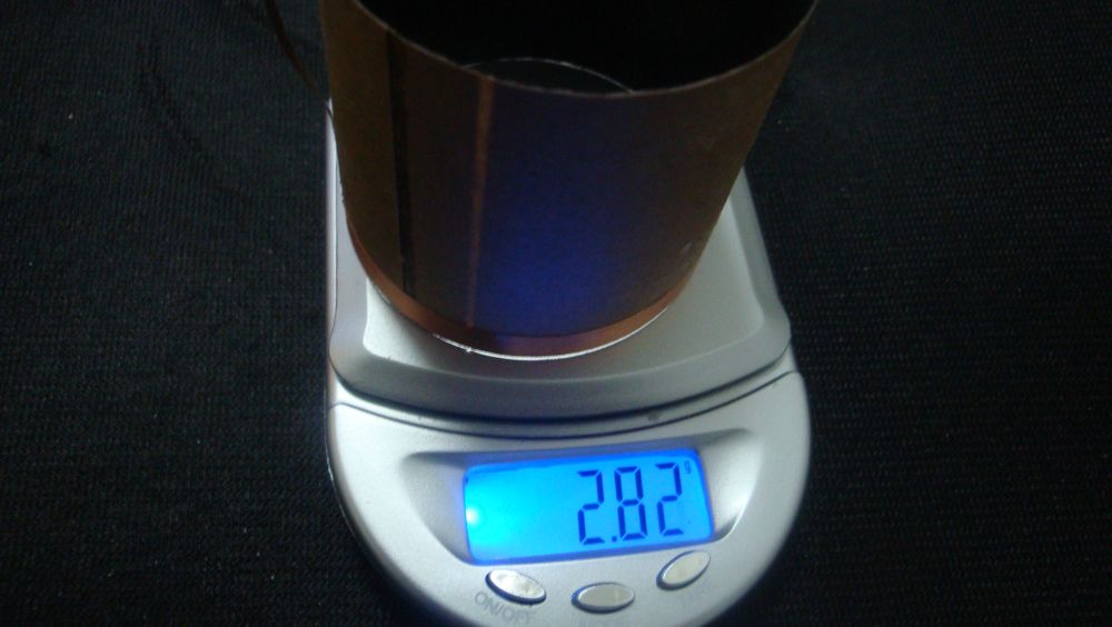

Did you weight it? Hope the voicecoil/cone joining point is strong.
Nice cones tinitus, like Hentia I like the patten to. Is that Kapton you use for coil former?
Will you make a short description on how you made it, always looking to learn new stuff.
Where did you get the pigytail wire?

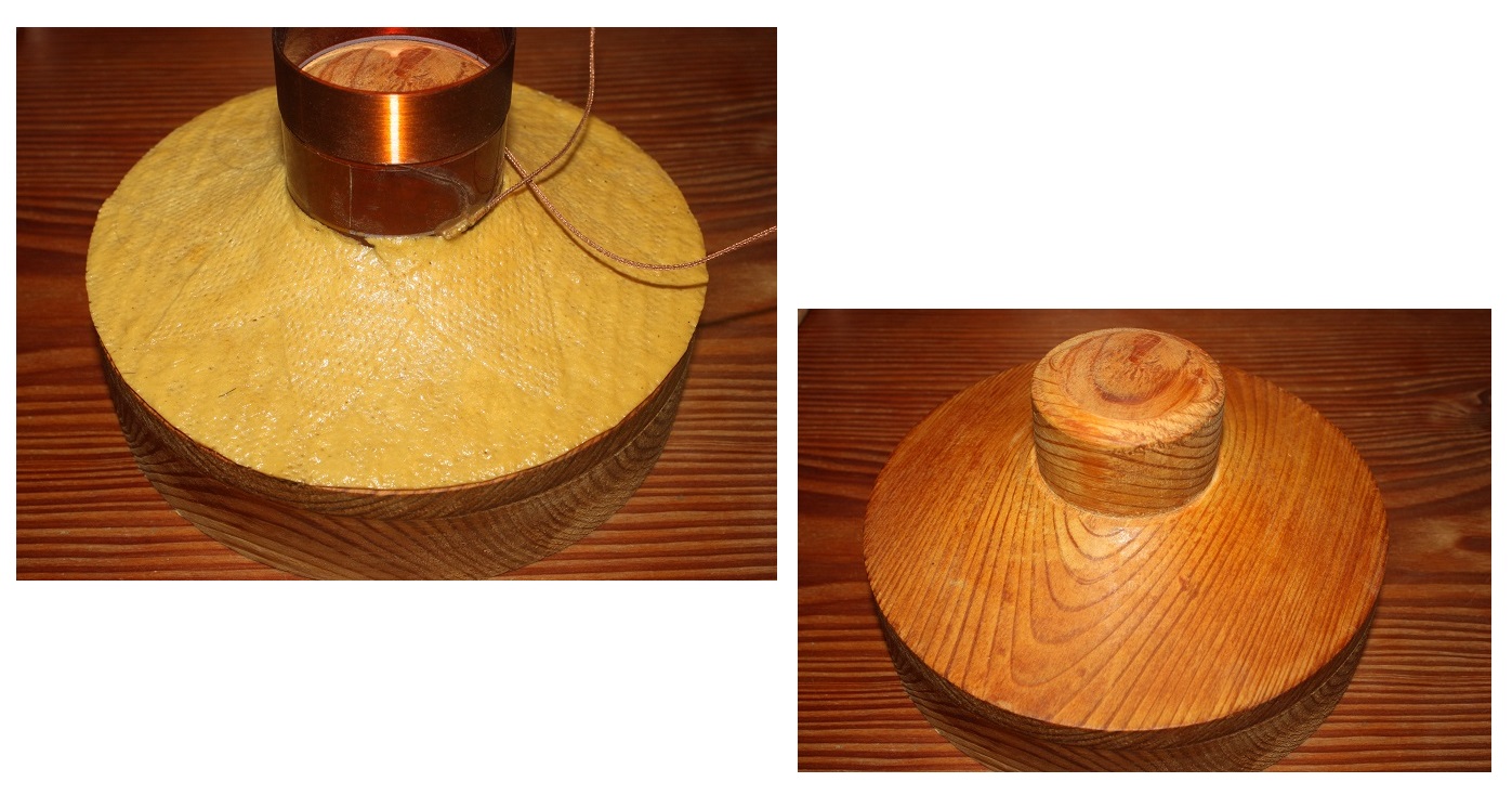

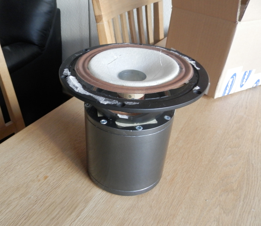

I made this 'mold'
voice coil is put on the centre tap
and diaphragm/cone is molded directly on to it
if needed I can put on more reinforcement on the back
it was supposed to be a midrange only
didnt have ambitions for the heights 😀
Nice job, tinitus. It looks like you have treated some kind of cloth, is that correct and if so what is the base material.

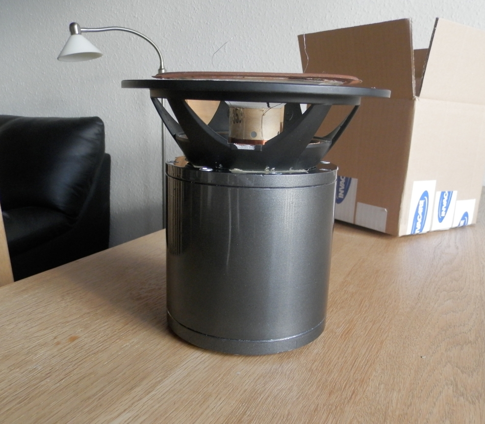

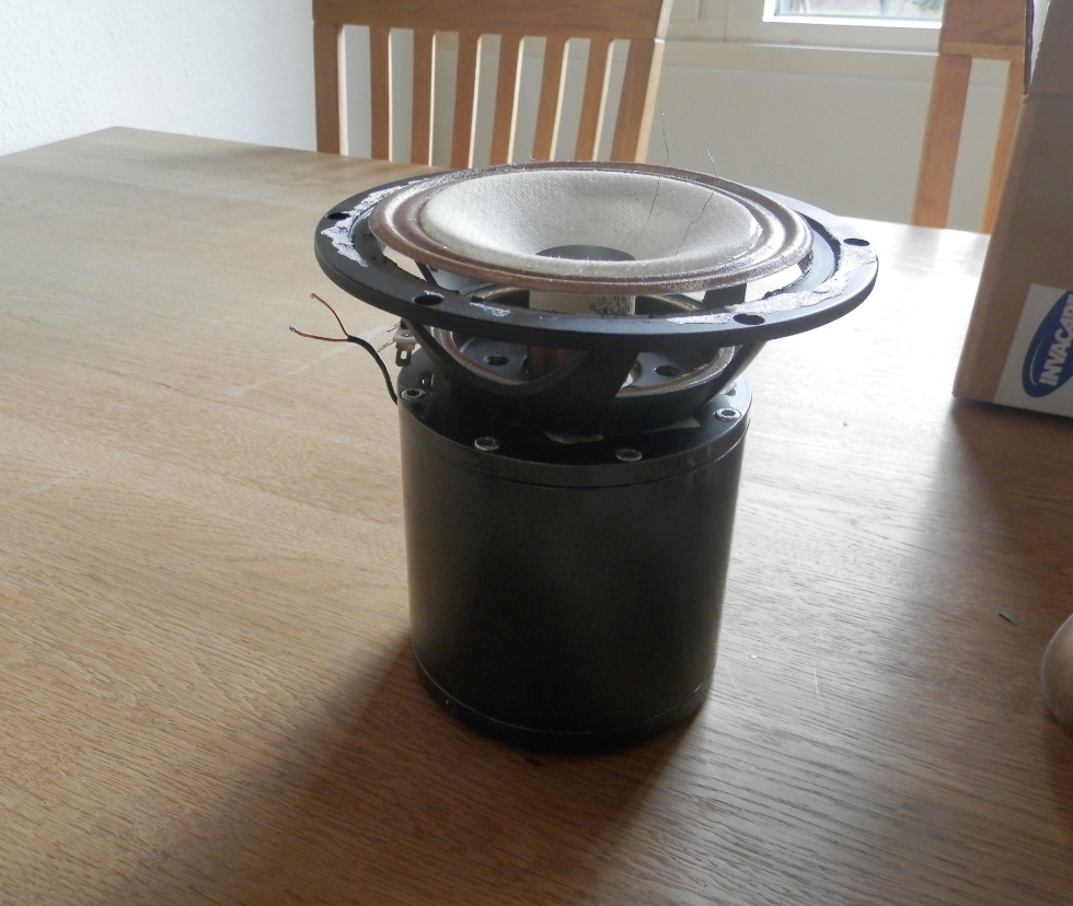

Got the field coils from Hentai today, he did a amassing job. I put on a basket and a cone just to see, it looks wild..Here is some pic's.
Next step is to design a strong basket for the unit.
Take care
Take care
Glad you like it Frank. Yes it is serious audio there, looks very good. Can't wait to read about sound impressions.
That looks like fun!
My respects for very impressive work by Hentai.
Serious postal costs too, I expect!

hey, using a spider for the surround, thats clever
do they have them somewhat smaller ? 😀

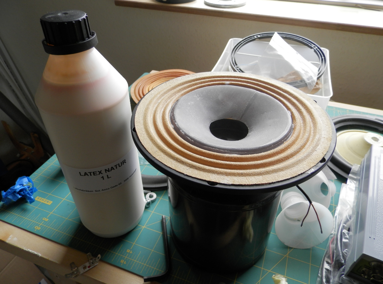

btw, I have a DIY cone I made using lighter foaming poly glue
I can post pics if interested
tinitus, you gave me a idea, thanks.....Using a spider could work if it was softer and airtight, I spend some time to figure it out how to losses up the addictive in the spider. I found that ammonia dose the trick, next step is to get it airtight. I found that latex milk dose contains ammonia and can seal the holes in the spider at the same time... and what do you know.... it's works beautifully. Took some pic's.
tinitus, you gave me a idea, thanks.....Using a spider could work....

sorry I forgot to answer
I used cheap industrial dust cloth
special papery one with lots of holes
base/resin is ordinary foamy polyurethane glue
made it a long time ago, and would probably do different today
actually, the kind of thin fiber matt you put on walls and ceiling before paiting might work too
but if you want a really light cone, it might be best to use pressure molding, or vacume bag technology

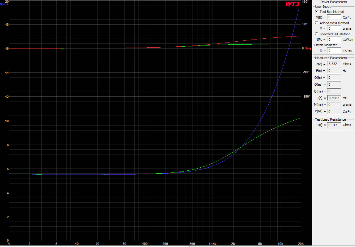

Meanwhile i have tested the double voicecoil theory in which one voicecoil is shorted and one has signal applied to it. The attached image shows the inductance behavior.
Blue line (red for phase) represents inductance of one VC with signal applied and the other in open circuit.
Green line (yellow for phase) represents inductance of one VC with signal applied and the other in short circuit.
As you can see at 1Khz not much of a difference but indeed going up in frequency the shorted VC helps out. Frank was right thinking of this. Ofcourse now the question that remains is this worth getting the extra mass of one more VC or not?
Test was done with identical VC placed in the middle of the gap and copper shorting ring placed under the gap.

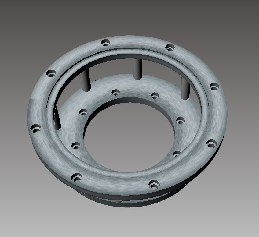

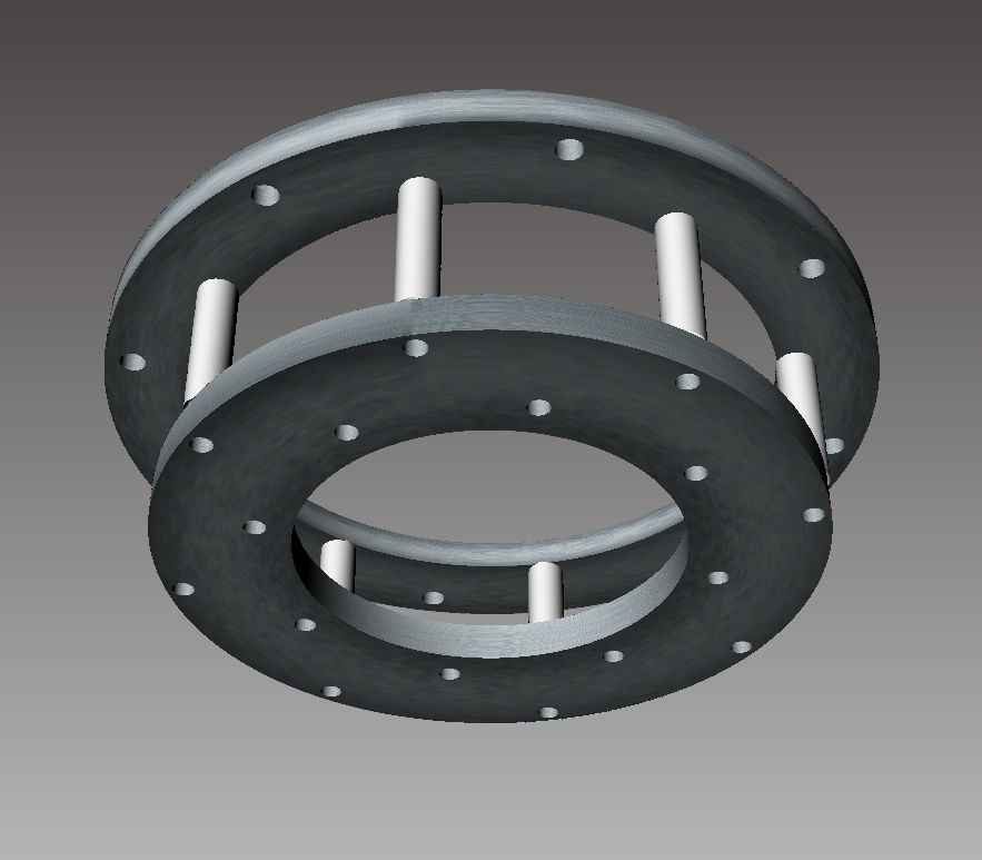

Looking good Hentai, Glad to see you got some time for your 12". I have send my drawing for the basket to the work shop, hope thy will start milling next week.

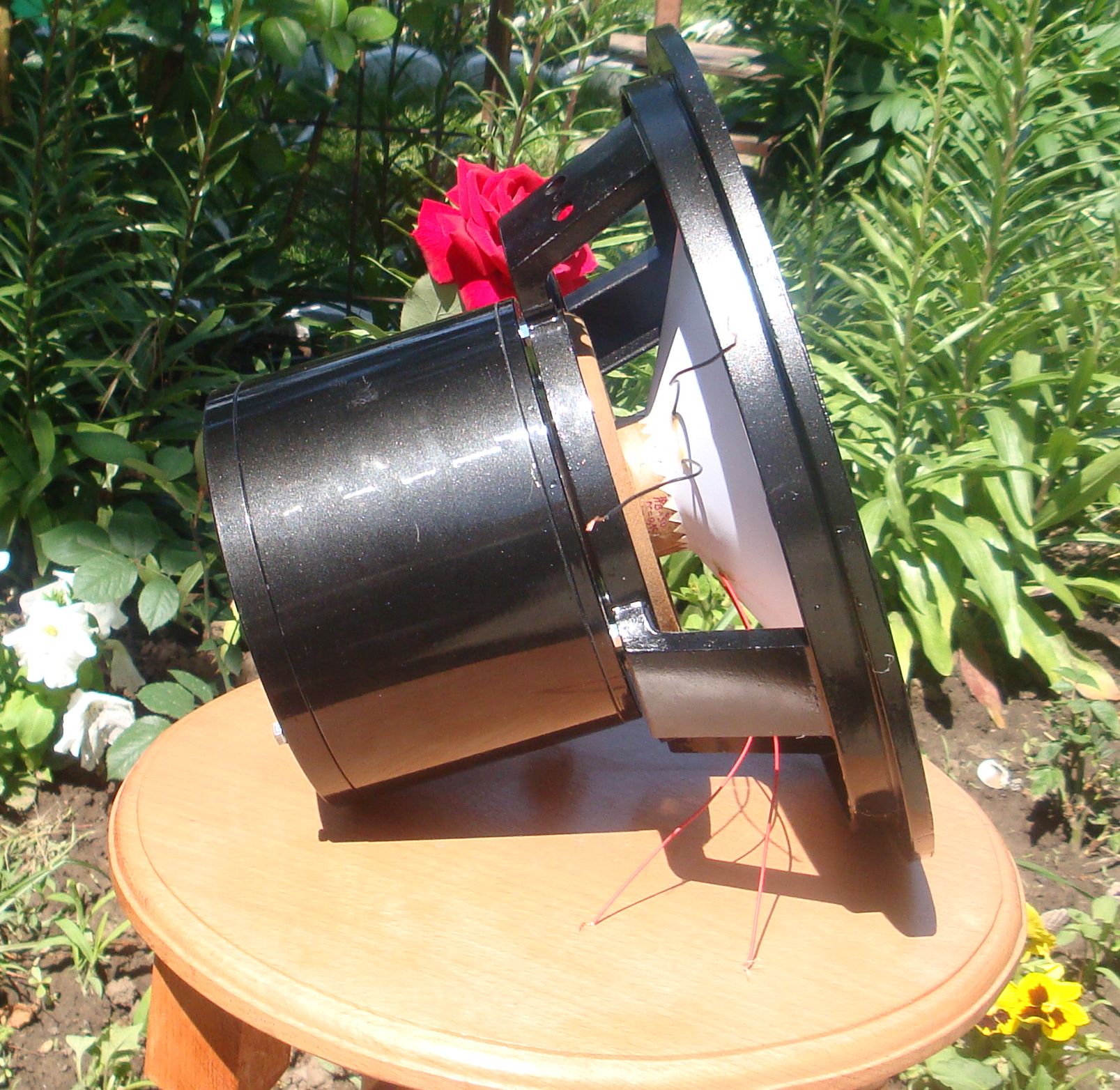

I just got some news, they will start to milling the basket for my unit's Monday. It is made from 10mm aluminium and is black anodized when done, the two rings is hold togeter with 8 psc 10mm spacers.
Here is some pic's
Take care
Here is some pic's
Take care
Hi, Looks very good Frank but does it match the mounting holes on the motor?

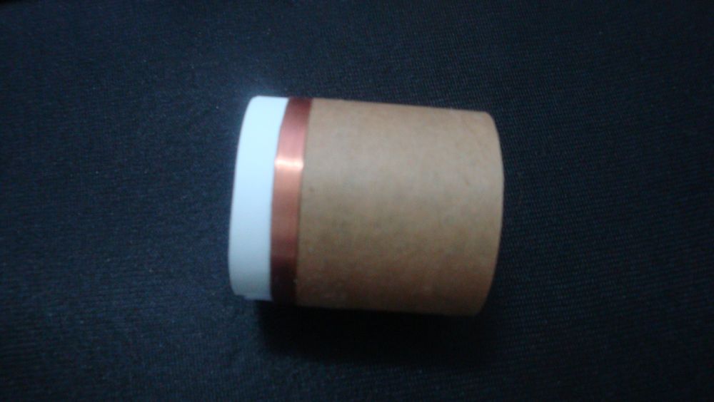

Voice coil now have paper former and i dont believe i will return to anything else anytime soon. There are 3 types:
1. single layer
2. 2 layers - 2 voice coils with posibility to connect series/parallel/independent
3. 4 layers - 2 voice coils like 2 but each voice coils is made of 2 layers in series.
Posibility to connect as 4 ohm, 8 ohm, 16 ohm and voice coil 3 as 32 ohms. Using 0.15mm ECW (copper wire) you can see the weight of each in the pictures.

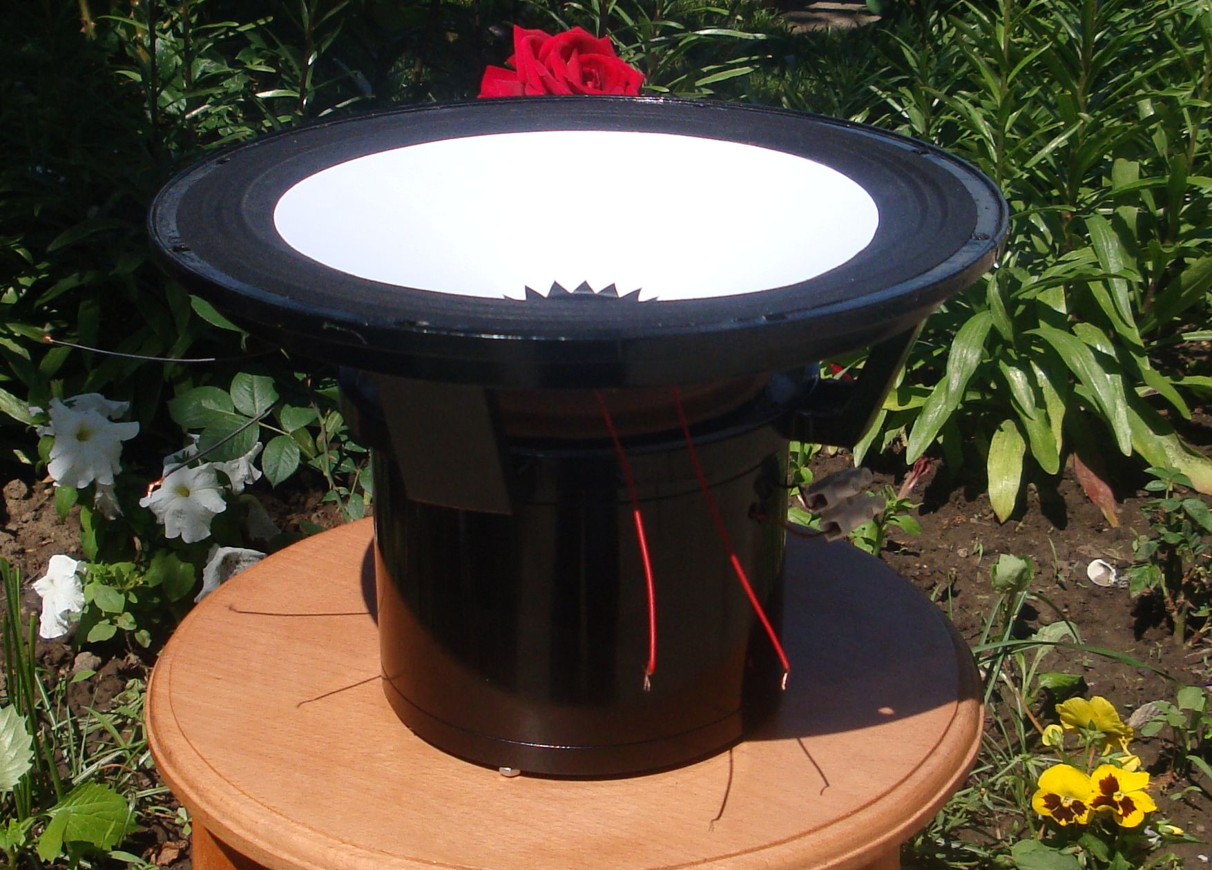

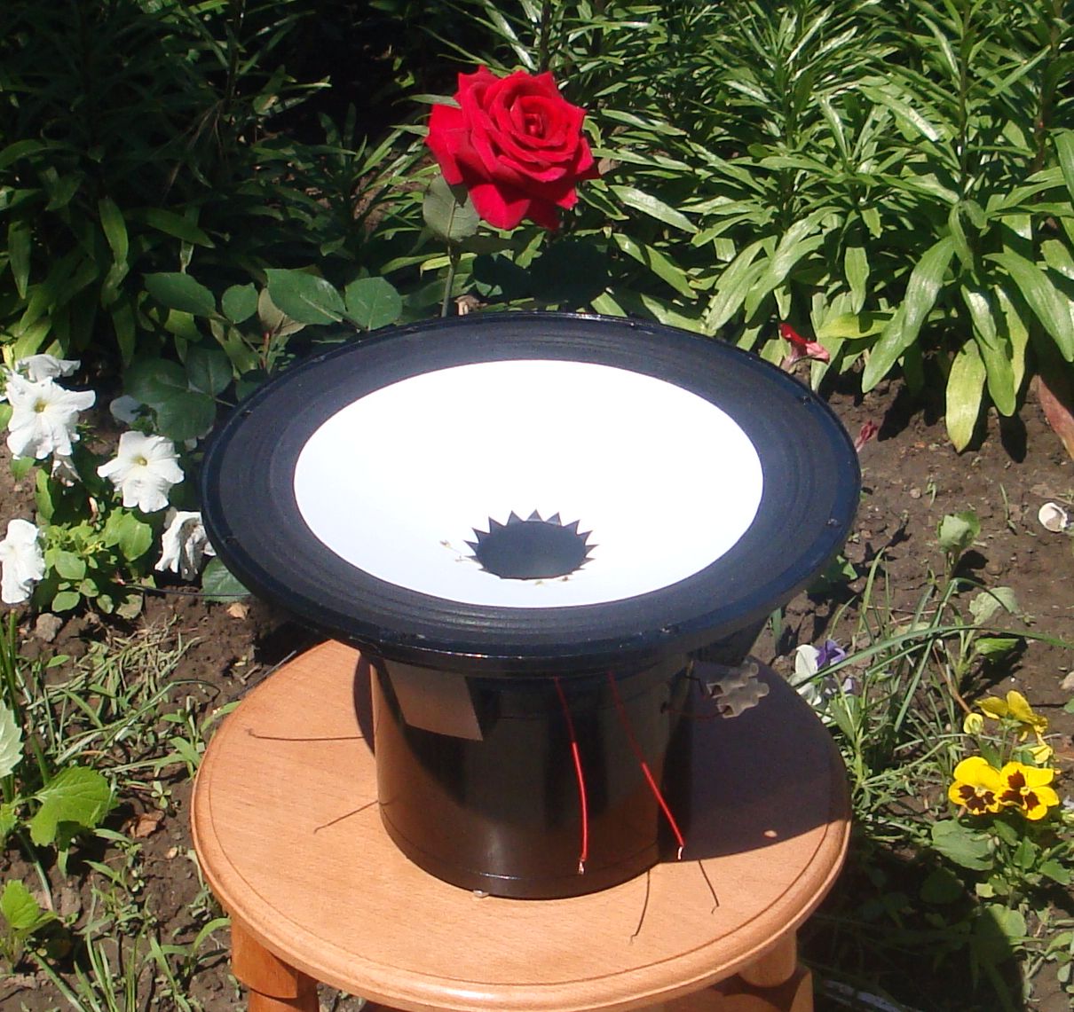

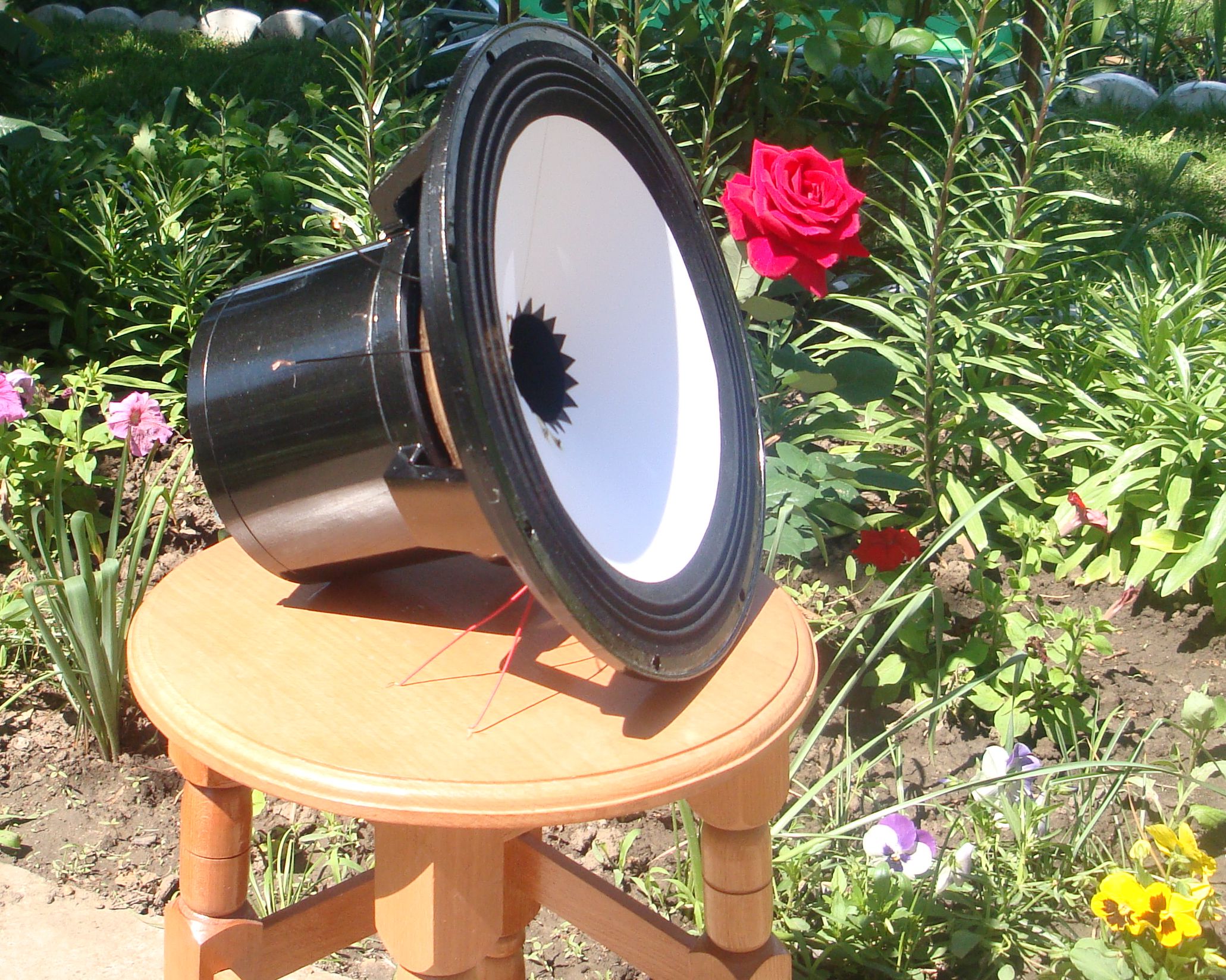

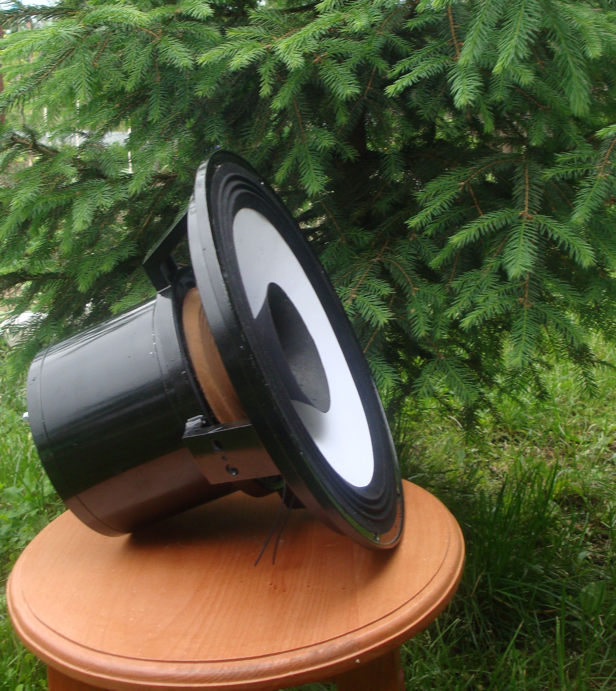

And here is a 12" unit model 0PX (i started with 0AX 🙂 ) first without whizzer then with whizzer attached. In my back yard for the scenery 😀 but im not a good photographer sorry.
Well this is it for tonight. Will get rest and will post more tomorrow and i hope i can attract you in a math discussion at a point.
Hope you like the pictures.

Hi Hentia
Man that unit looks awesome, very nice job..... I was just about to wright to you, reg. the shorted voice coil see this video... Neodymium magnet in copper pipe - YouTube weird stuff.
Looking forward to see some data.
Keep up to good work, take care

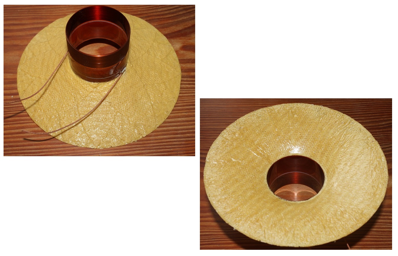

Getting the right paper is a trial and error process most of the time. Mostly because most places that sell paper dont provide enough data to compute any real prediction of behavior. Most info you will get will be density which will help you calculate mass.
You can start up with normal calligraphy paper. A friend i know uses Mulberry paper and with good results. I was and still am set with washi, sounds great but hard to work with and usually turns up too heavy to make it stiff.
Curving the cone also makes it stiff.
Here is one of my first cones with washi. Pretty stiff, 27g just the cone tho. Even so i liked its sound the most.

Im going to coat the paper with damar varnish I made specifically for this purpose. I will also try pva too. Just to stiffen them.
