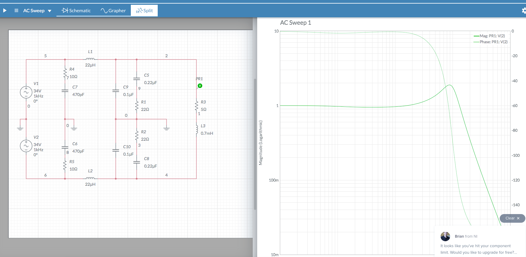

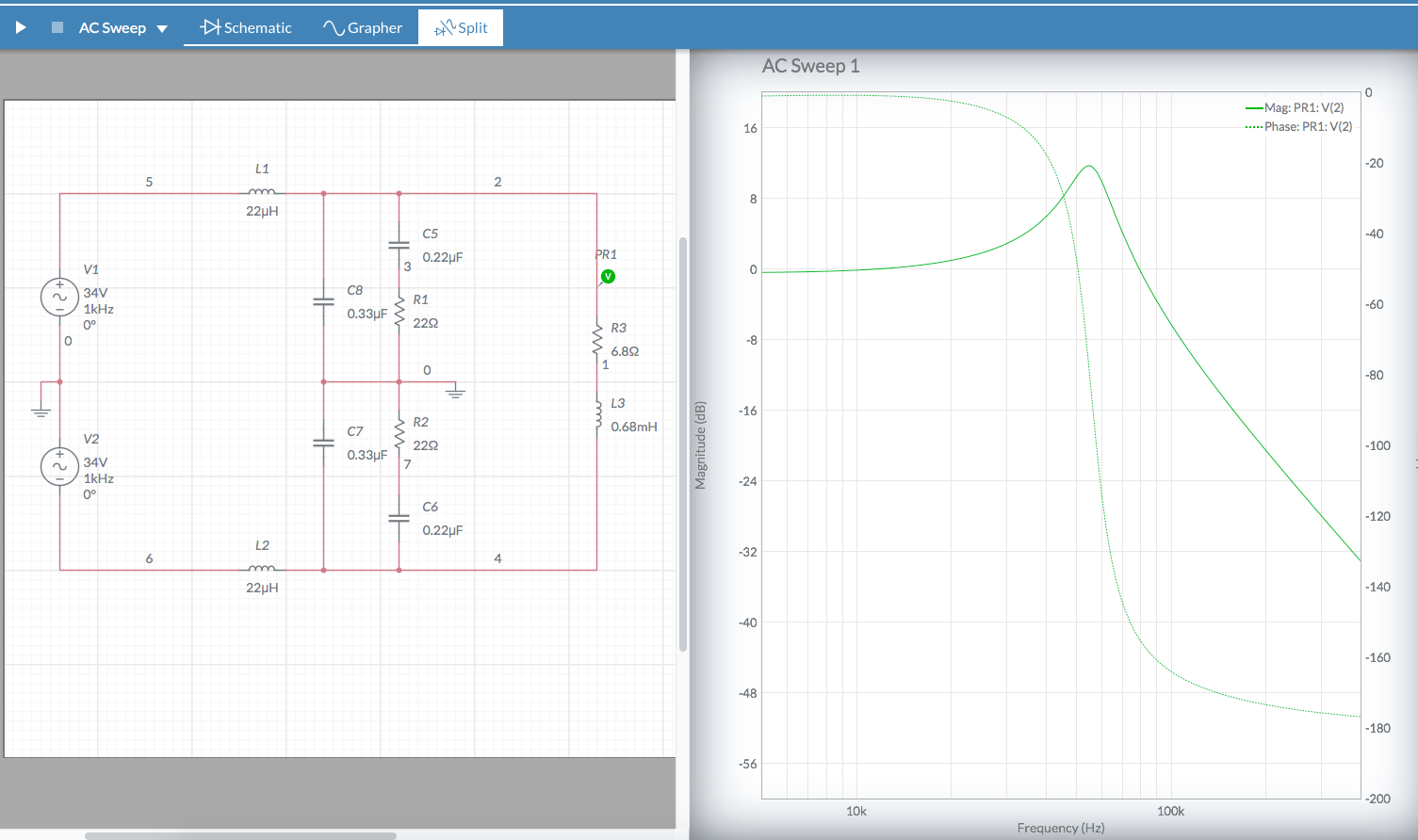

I've developed a circuit on MultiSIM Live. Tentatively modelled on a full range speaker 5ohm/0.7mH. See attached.
This seems better than the original, however high freq is not attenuated very well, just acceptable. Freq scale is not visible. Left side RC snubbers don't do anything in this simulation, but will generate some heat (about 0.1 W on R) in the actual circuit. Single ended circuit is enough for simulation, this way you won't hit into simulation limitation so soon.

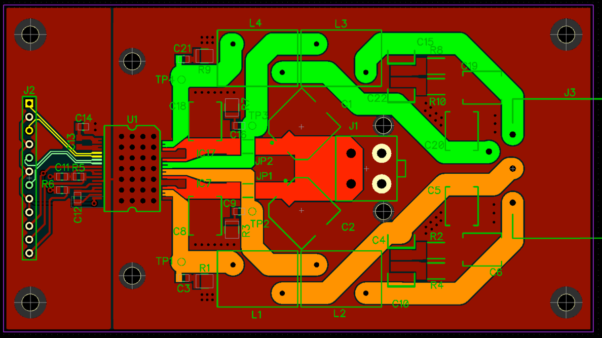

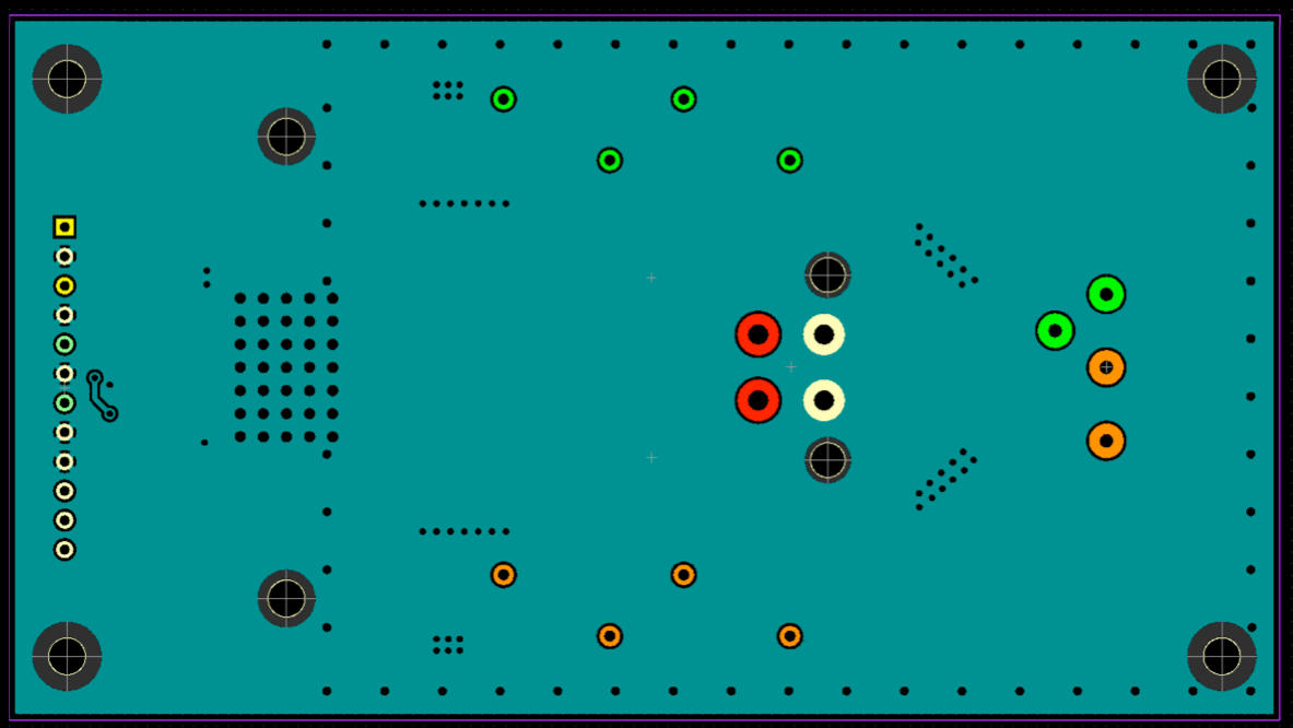

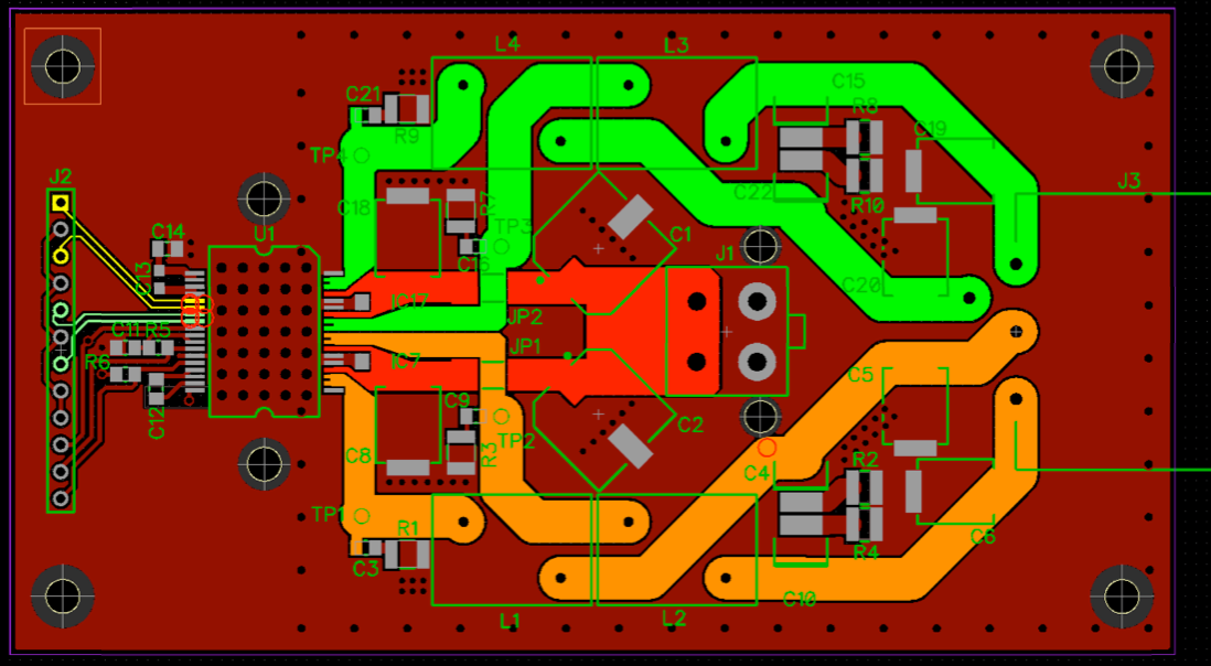

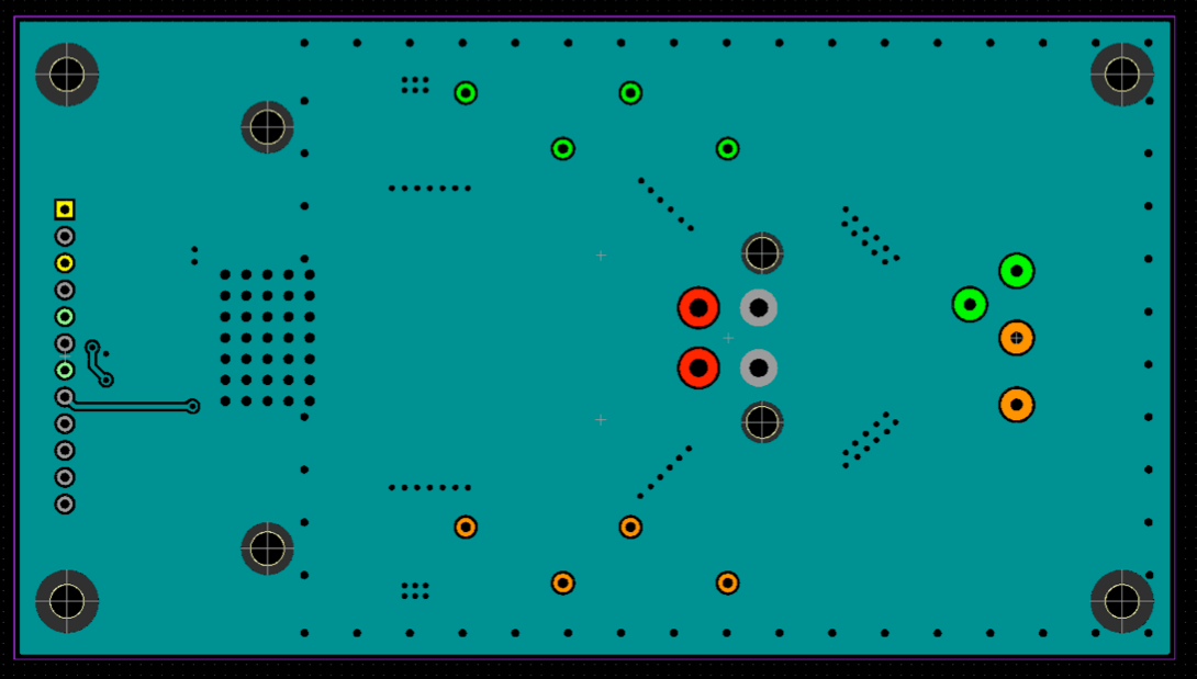

Take care of bottom side also! (I mean show it!)
GND pins of connector should be connected directly to GND polygon on both sides!
The stitching vias are better to extend up and down as much as possible, but a single row is enough. Generally the best is to form a complete guard ring from gnd vias around power stages, but not neccessary here.
PWM inputs should be better kept separated from each other, unless you are sure you don't want to use BD modulation.

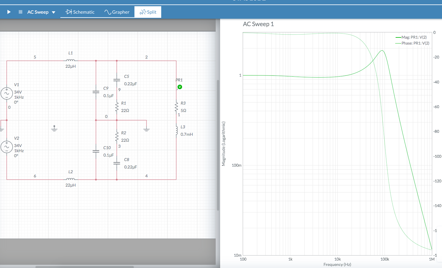

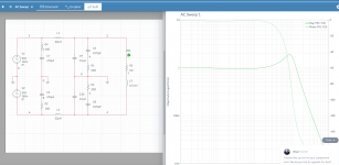

Thanks for your insight Pafi. It is much apprecieated! Here's a chart with frequency.
You're welcome!
As I thought, the attenuation at switching freq is quite low. This is actually not an audible problem, but it will look nasty on oscilloscope (too high carrier residue).

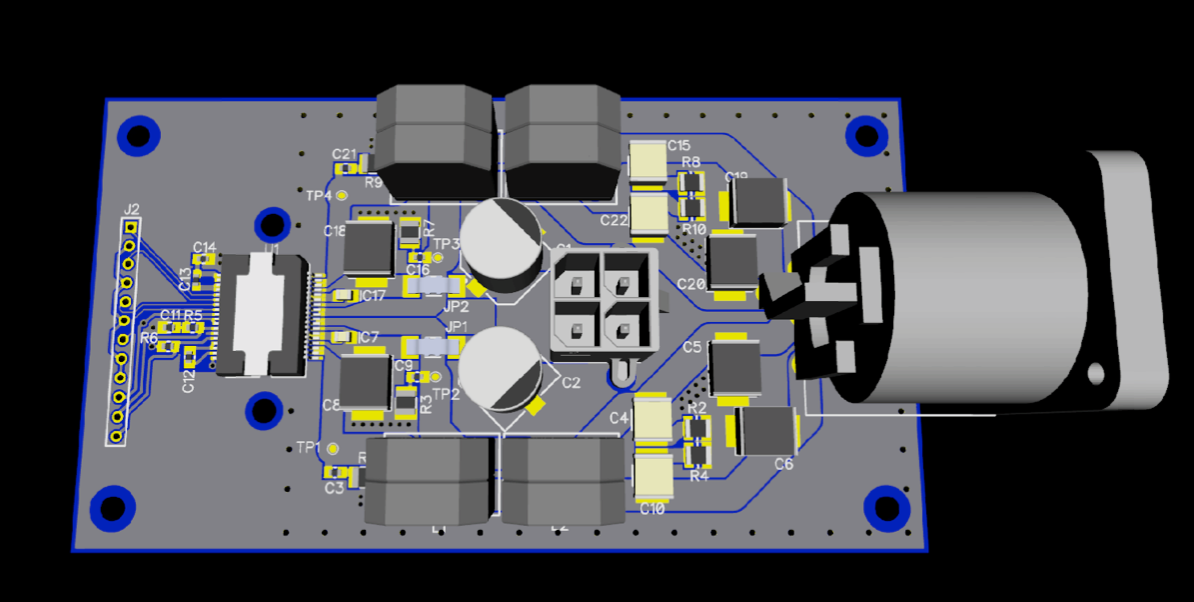

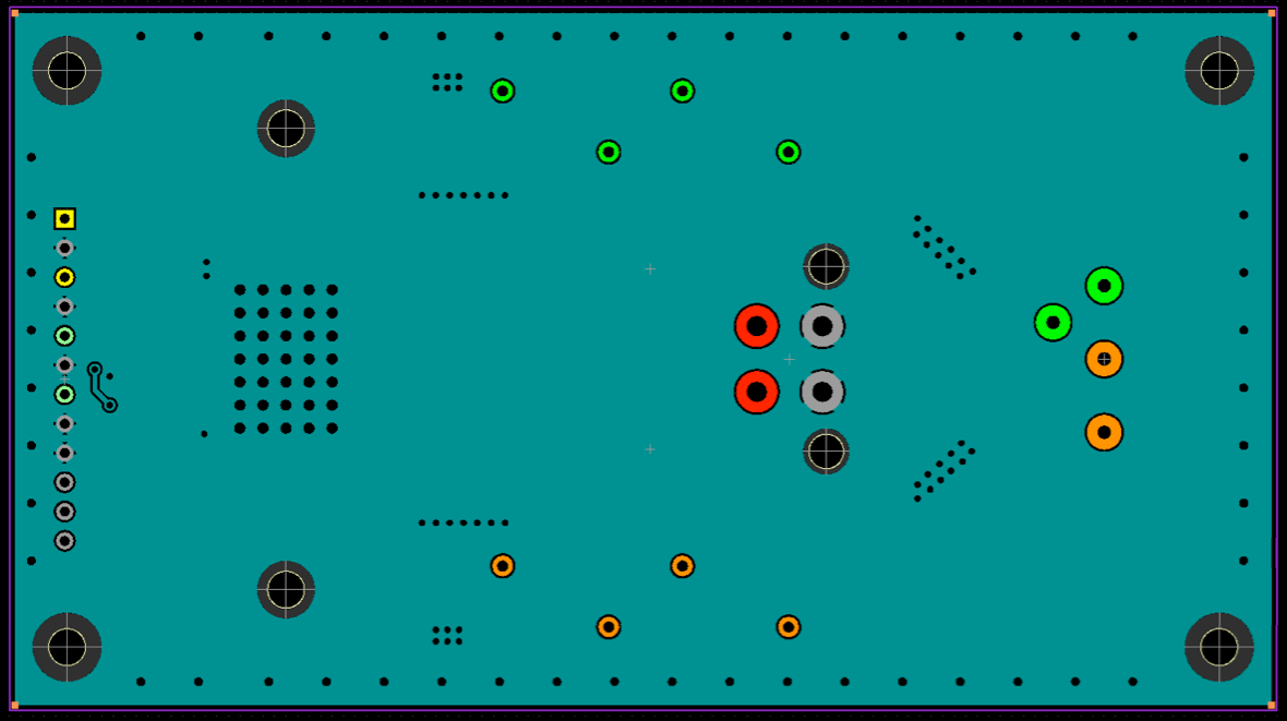

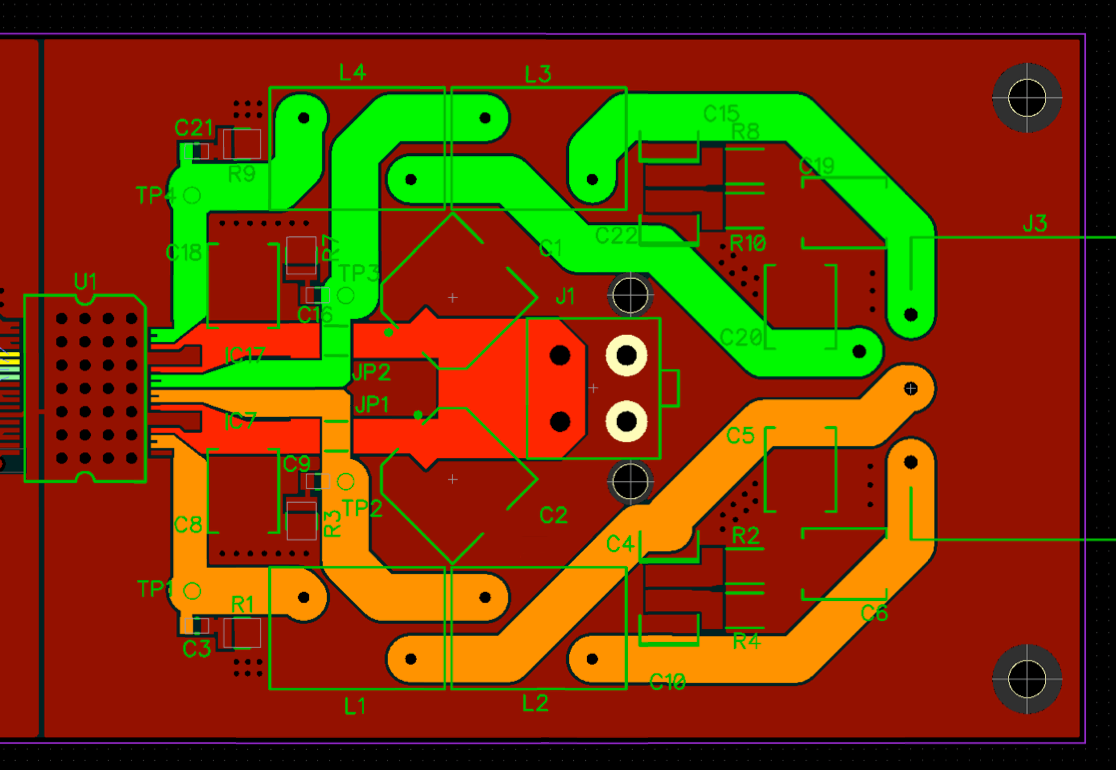

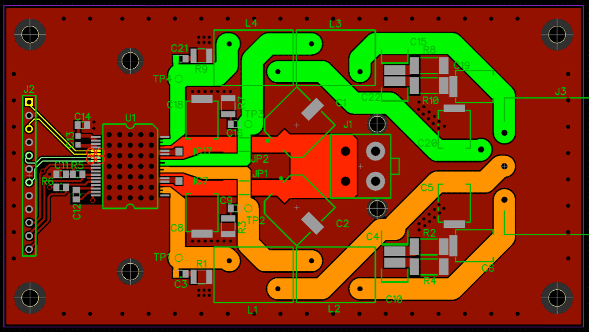

Thanks Pafi, making some changes now - see attached.
Guard ring should be around the power section only! (Right side of IC.)
