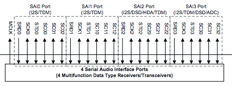

Next on the agenda is the DSP board. We have 4 digital I/O ports available.
Do I need to worry too much about digital isolation? A bit tricky when they are transceiver ports. I might consider isolation for SAI2 Port ( possible HDA connection to a PC motherboard codec).

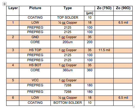

Making some progress with the DSP board. Laying out with this 6 layer stack up.
Layer 1 - Signal 1 (Low Speed Signal)
Layer 2 - GND
Layer 3 - Signal 2 (High Speed Signal)
Layer 4 - Signal 3 (High Speed Signal)
Layer 5 - VCC
Layer 6 - Signal 2 (Low Speed Signal)
I've been considering the PWM output routing. Any tips here? There are 9 pairs of PWM_HI/PWM_LO - 3.3v CMOS.
Would it be prudent to route as impedance matched differential pairs with
PWM_HI to layer 2 with PWM_LO directly beneath on layer 3?

DrM, here's the proposed stack up. This is one of several standard 6 layers at my printers.

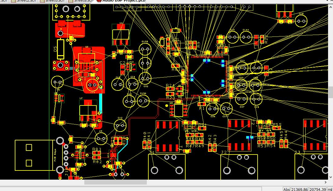

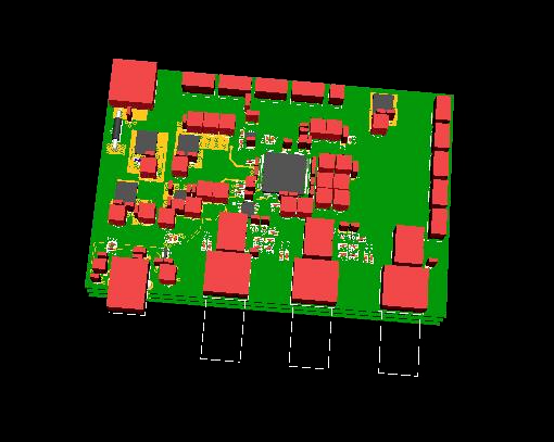

Sneak peak pic so far.
The three RCA conns ( 43-028 ) on the bottom edge are the 2 x SPDIF in / 1 x SPDIF out. They are from Canford in the UK but I've seen them elsewhere under other brands.
DELUXE RCA (PHONO) PANEL SOCKET PCB mounting, black
Just behind them are the Newava S37211 digital transformers. I look forward to a loop through test with the UPL to assess the DSP.
Across the top edge are the i2s, TDM, HDA and DSD inputs. On the right we have the 18 PWM out pins along with pins for amplifier feedback (protection etc).
On the bottom left is the USB port for programming the DSP.
