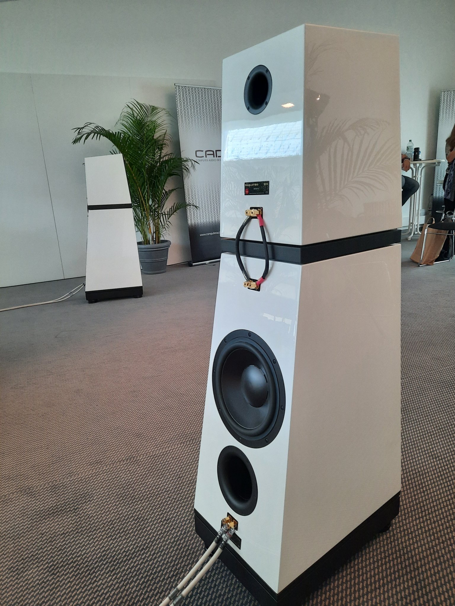

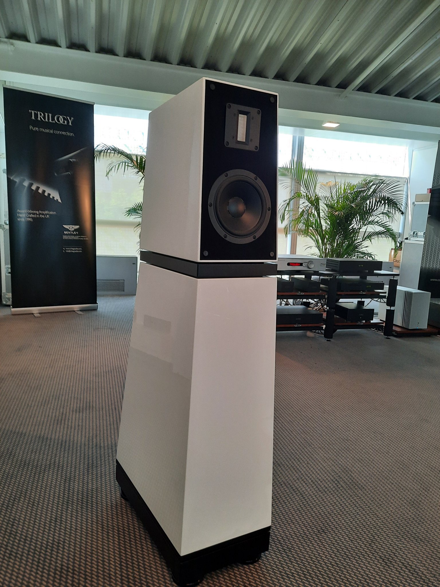

Hello Haraldo
I have listened to this speaker you fell in love with and looked it up closely since I found the construction to be very interesting... the drivers layout and the integration of glass.
I didn't imagine the price to be so high! Alas, the hifi world really gone mad 😪
I was unimpressed with the presentation at the show, (maybe show conditions to blame)
Yet I do not want to discourage you, I simply believe you can do better.
Thx for you input @noamgeller .... it may very well be that the Audio Physic guys really don´t know how to demo their own stuff..... I heard the Audio Physic products play heaps better when demoed by their Norwegian dealership, compared to what they do....
I was at the original launch of Audio Physic Cardeas Plus+ provided by Dieter Kratochwil and another guy (don´t remember his name).... it is my impression they had no idea what they were doing when demoing the speakers, I would be able to do the demo much better myself if I had free hands with the setup.....
I love small standmount speakers that integrate well and provide that magic, it´s just the case that I really also in addition want that insane speaker that scales .... with zero limits .... I like to switch speakers based on the mood 🤣

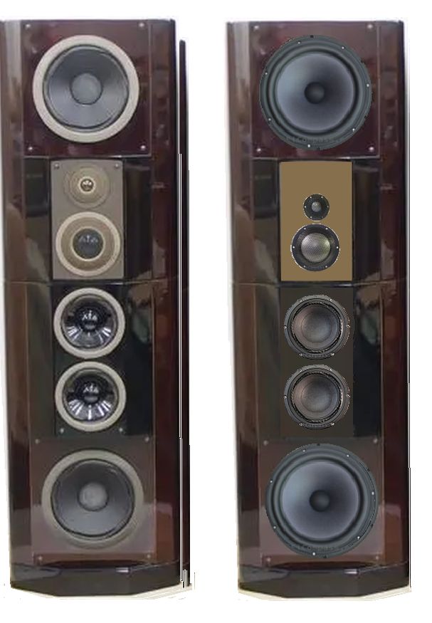

Audio Physic Medeos, diffractions tell them nothing. Even visually, the square cabinet is ugly.
Take the example of the Technics SB M10000 from 1995.
https://ldsound.info/technics-sb-m10000/technics-sb-m10000-ldsound-ru-3/
T25B
M74B
PTT6,5W 2ks
SS W26 4ks (2ks back side)

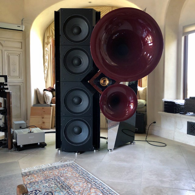

I never made horns work that well for me, there always seem to be this effect "Tom Waits singing into a megafone", that does not work so well to me unless I am listening to the song where Tom Waits is actually singing into a megafone....
Two of the ideas at least from my side is: Go big or go home, It must look like a piece of modern art
I was touching on the ideas of some of the Troels Gravesen dedisngs, but they look too much like DIY, square ugly boxes again...

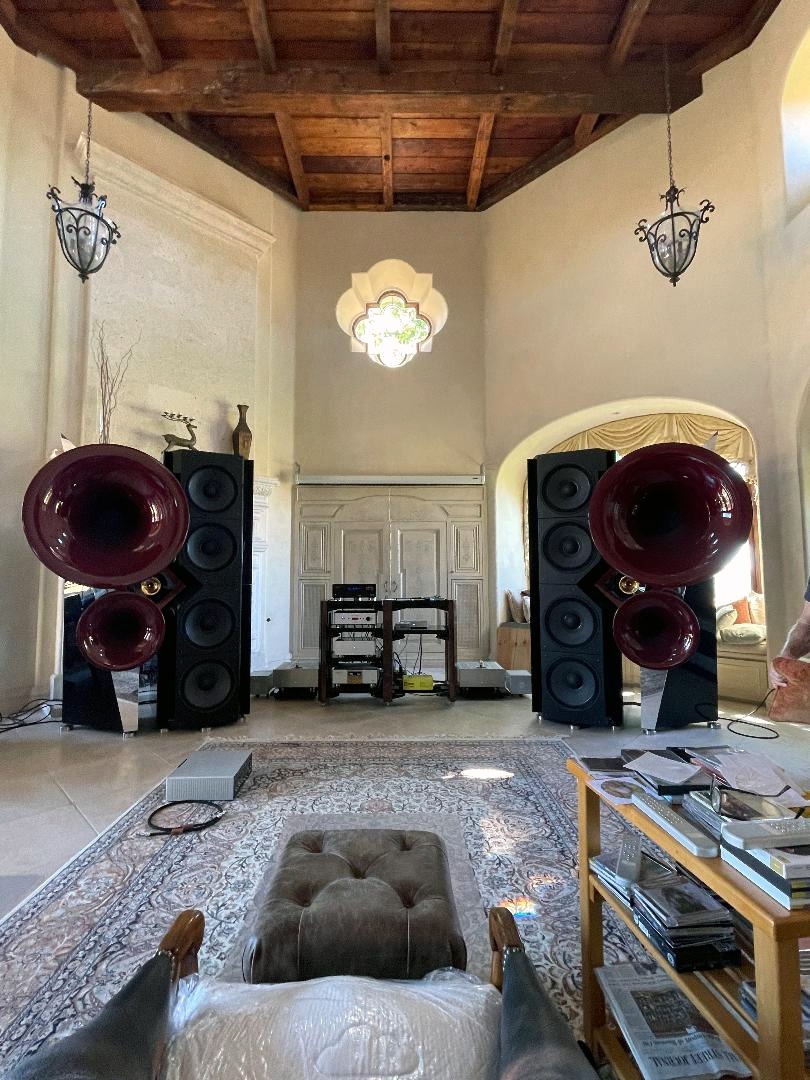

Here is some shots of where I am at the moment
Audio Physic Avanti III
A pair of Duntech PCL-15 studio monitors at hand (need driver replacements)
4 x Audio Physic Rhea II
Trinnov Amethyst preamp
Adyton Cordis 1.8 Signature poweramp
Krell KAV400-XI amplifier at hand, if needed....
Studer A727 CD Player
Auralic G1 streamer
Audio Technical XT-LP140 turntable with Ortofon black cartrdidge
Self-made bass traps, up to 60 cm on deepest point
Lots more acoustic stuff coming in, also full-height bass trap on left, killing first freflections on sidewalls, hanging absorbers in ceiling, and more .... 🙂
All speakers and subs hard spiked onto stone plates
Stone plates isolated with Valhalla tech pads, resonance around 5 to 7 Hz
As you can see, I am very subscribed to "Joachim Gerhard style" speaker setup, I tried a lot of moving around and this is what works best to me 🙂
