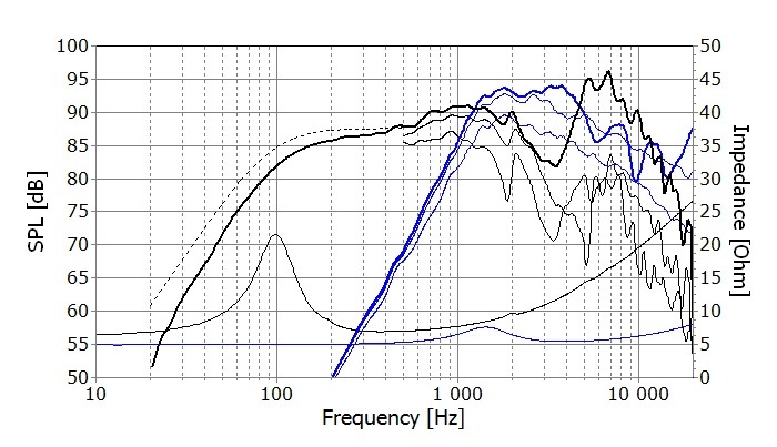

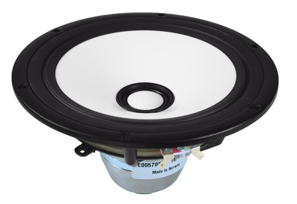

Anyone had any experience with the Seas Excel coax drivers?
Generally, looking at the measurements, the tweeter response looks very "rough", but thinking about Seas reputation of quality
Still .... it´s not a Kef 🤣
http://www.seas.no/index.php?option...atid=60:seas-excel-coaxial-drivers&Itemid=361
It will impress your friends with it's appearance, but an MEH would likely sound a lot better.What about this small tiny diy project for start

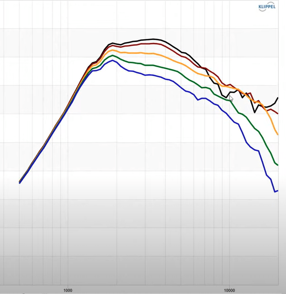

That tweeter response is atrocious. Good luck with that.Anyone had any experience with the Seas Excel coax drivers?
The manufacturers graph is very hard to read with all the tweeter and woofer curves overlaid.Generally, looking at the measurements, the tweeter response looks very "rough", but thinking about Seas reputation of quality
Erin has measured this one and posted a review, the tweeter response is about as good as you could hope for in a coax and is anything but atrocious. The on axis has some wiggles as they all will, as that is where the interference is greatest. As soon as you move off axis that has disappeared.
I was looking at the woofer and thinking how I'd want to cross it low. Then it occurred to me the higher sensitivity of the tweeter could be used to advantage in that respect. The baffle step would help there too.. so maybe all is not what it seems.the tweeter response looks very "rough"
I do have other reservations, it's not a perfect tweeter environment.. however I'd find it interesting having a go at making it work.
And that's the point of KEF - they are more or less the only coax drivers completely lack of these on axis wiggle (Genelec ONEs does it also) and in addition have very broad HF dispersion. They had a few variants of their "lemon squeezer" over the years but they finally figured it out - big respect for that!The manufacturers graph is very hard to read with all the tweeter and woofer curves overlaid.
If you listen in a living room with a few meters distance ... it's not a big issue. But at closer distance in a controlled room you hear it.

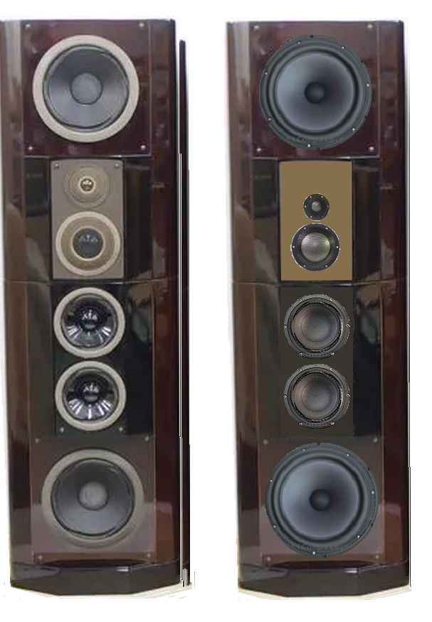

THAT's how to build a fullrange speaker in 2022! 😎Audio Physic Medeos, diffractions tell them nothing. Even visually, the square cabinet is ugly.
Take the example of the Technics SB M10000 from 1995.
https://ldsound.info/technics-sb-m10000/technics-sb-m10000-ldsound-ru-3/
T25B
M74B
PTT6,5W 2ks
SS W26 4ks (2ks back side)
(The SB Acoustics 12" NRXL woofer is EXTREMLY good and cheaper as the ScanSpeak. And of course we build a double bass array if possible ... 😉)
