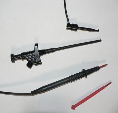

I am paranoid about test points and slipping probes as my hands are crappy. I add insulated link wire away from anything that can hurt and where I can clip on probes easily.
expensive click
To avoid 'expensive clicks' you can use clip-on probes
like the ones shown in the picture.
Usually i decide what i want to measure before applying power,
and attach the clip-ons before applying power.
For adjusting bias/offset i use the screwdriver shown at the bottom of the picture, insulated with heatshrink.

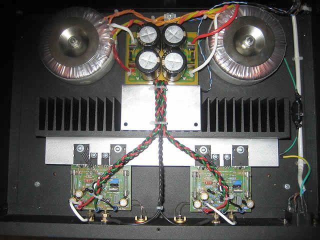

Looking at the picture of your amplifier after rewiring, apparently you have failed to comprehend the advice about lead dress given to you previously.
Sofar you didnt manage to exclude even one possible cause of the (subjective) erratic behavior of your amp.
In fact , the probe slipping made you move into the opposite direction, introducing yet another variable.

I still think the layout is wrong as there has been plenty of examples given with the amp modules at the back close to the signal inputs and power supply at the front so there is less chance of interaction.
By doing that you eliminate one variable and have less chance of hum as well.
While you have signal, speaker and power wires all together plus a power supply between RCA inputs there's a strong chance of pickup...... hummmmmmm.

As I said before this particular layout was suggested to me by Hugh. Hugh himself used this layout for one amp he made. Its the only one which will fit for this 2U case. Your suggestion will not fit into a 2U case.
But Klaas is talking about lead dress. ITs not so much the layout he is criticising.
Hi John,
That is true, but a great project begins with a good layout. Once the basics are understood, a layout will generally present itself after a few attempts.
I don't think there are many of us that simply do a great job in the first try. It takes some research and planning. There is the difference between someone who doesn't plan and gets mediocre results, and someone who does plan and gets excellent results.
-Chris
Personally I would try avoid placing supply board in between trafos
May not matter, but you never know
Though I suppose it could be rated as a well proven layout
Most impportant would be to get signal input lines away from supply
And thats achieved 100% by such layout
