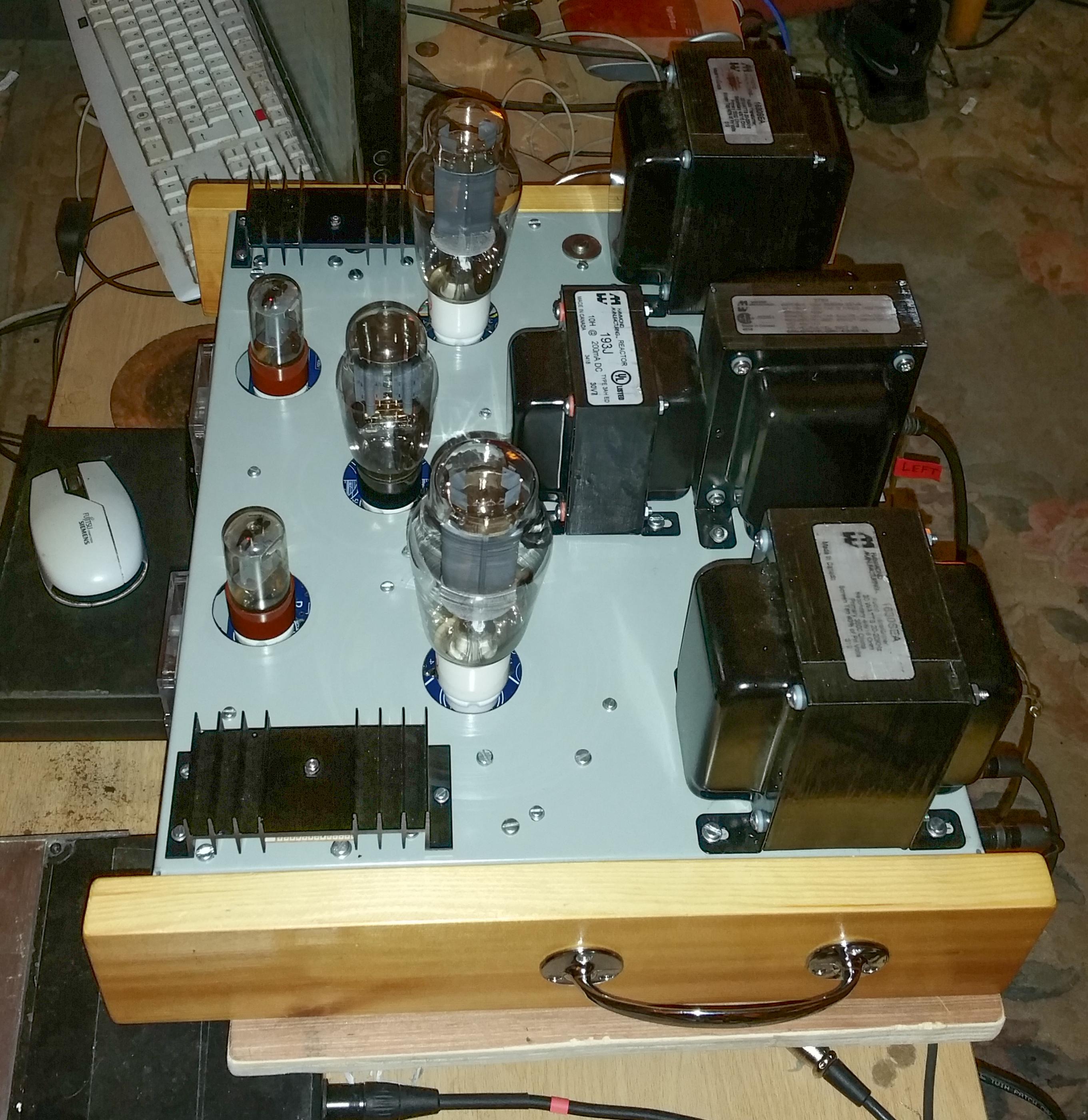

Looks great!
One thing I notice is that the choke is oriented magnetically the same as the output transformers. At least it is offset toward the front, and the output transformers to the back.
You might try rotating the choke 90 degrees if you still have hum.
With steel chassis, I have sometimes raised the choke and output transformers off the chassis by using 1/4 inch non-magnetic spacers.

Since I took out the Hammond interstage transformers, and replaced them with your suggestion of using the IXCP10M90S instead, the hum pickup has disappeared. Taking out the first 6SN7 stage stopped all hum pickup in the driver section. I have more than enough gain and voltage swing (200V P-P) from the one half of the tube. All my pre-amps can deliver at least 10 Volts RMS signal.post # 76.
