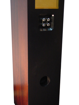

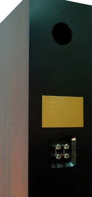

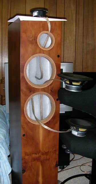

The chinese clone has 2 ports 70mm I.D x 135mm long , I don't know if this is the same as the original but I'll guess it is ?🙄
External measurements are :
1244mm high
235mm wide
343mm deep
Appears to be 3/4" thick walls all round with NO internal bracing !
some more photos to follow...

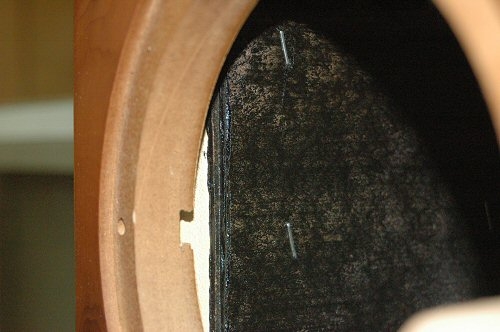

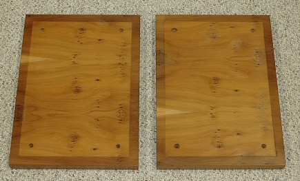

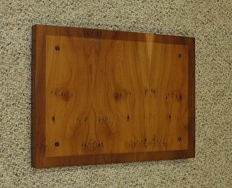

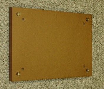

Front and rear panels are probably 1", with 3/4" for all other panels.
With this, when I subtract 1" for spikes (somewhere in the Stereophile review or ProAc literature) and cabinet volume works out to be 66L, which is exactly double that of the Response 2.5...
Yeah , and the plinth is 1" thick .( not sure if the overall height figure includes this or not ?)

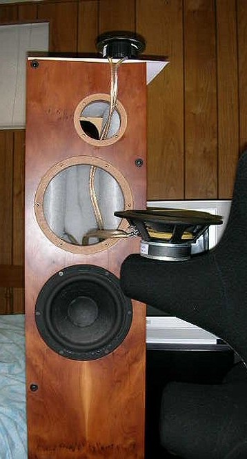

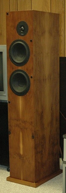

From one of the pictures posted by andrew01 I get these misures:
Assuming 1244mm high (without the plint and spikes),
The tweeter center is 126mm from the top
the woofer 1 center is 304mm from the top
the woofer 2 center is 526mm from the top
I think with at least +/- 1mm error (if my printer is ok 😉 ).
Later I try to predict the orizontal position..
surely is better to measure on the real speaker,the photos some times are not very closed to reality.
b.r.
Sorry.. in the proac site is said that the plint and spikes are included in the 1244mm vertical height.. So my values are wrong!
I've found that for plint and spikes we have to add 1'' aka 25,4mm, so the correct height is 1218,6mm. Is it right?
Bye
