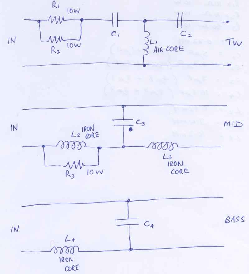

Well gents , to quote the line from Star Wars :-
"they're cloners , and damn good ones too".....
thanks to our "cloner" friends on the Asian continent , who have
answered my many questions etc etc.
I have established the correct crossover.
see attached.
Values are:
r1 = 10ohms , 10W
r2 = 10ohms , 10W
r3 = 50ohms , 10W
C1 = 5uF ( 4uF + 1uF )
C2 = 4.3 uF ( 3u3 + 1uF )
C3 = 8uF (4u7 + 3u3 )
C4 = 10.1uF ( 6u8 + 3u3 )
L1 = 0.32mH
L2 = 0.42mH
L3 = 2.0mH
L4 = 10.2mH

All we need is someone to model that crossover in their fancy crossover software ( which I don't have ) and check that it all lines
up with the published crossover info from the stereophile article....

hi andrew,
fine helps from you!,thanks a lot.
only a question : are you sure that the l2 = 0.42 and l3 = 2.0 and not l3 = 0.42 and l2 = 2.0 ?
about the tw i suggest to try with 9500 until the real model will be revelated.
the woofers are 18w8535 for diy : too much cost for the customized one!
b.r.
Yes , sorry , typo mistake.
L2 = 0.42mH
L3 = 2.0 mH

You're correct about L2 & L3.

I had a quick poke in Speaker Workshop to simulate that crossover, and I think the crossover is the real deal.
I think the original L2 and L3 are correct values. ie. L2 is 0.42mH and L3 is 2mH. This gives the MT crossover frequency of ~2.5Khz.

Just to confirm , I've double checked my crossover ( in the daytime this time ! )
and L2 is 2.0mH and L3 is 0.42mH........
sorry for any confusion.
why would L2, which is the series inductor to the woofer, need to be 2mH?
I thought the bottom woofer would be taking care of baffle step losses....
Maybe you should ignore me. Probably throwing a spanner into the works...
dunno , wouldn't have any idea , not a crossover expert at all.....just traced the circuit thats all.........it's up to the gurus here to work it out !

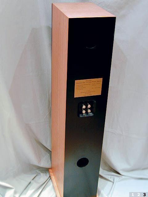

Some more details about position of the drivers on the front baffle, the size and position of ports on the rear...

the net of the upper wf is a 3rd electrical order,equalized by the r in parallel to 2.0mH inductance.
varing the res you can vary its support : that's frequency response,impedance and phase.
the bottom wf is filtered with a 2nd electrical order with frequency cut-off lower than the upper.
no great problem with baffle step correcion.

somebody who have the 3.8 could easy measure all dimensions we need.
about the port position i've found this one.(too dark)
b.r.
- Proac response 3.8 crossover
