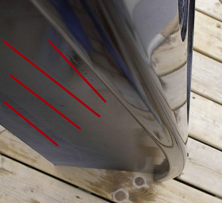

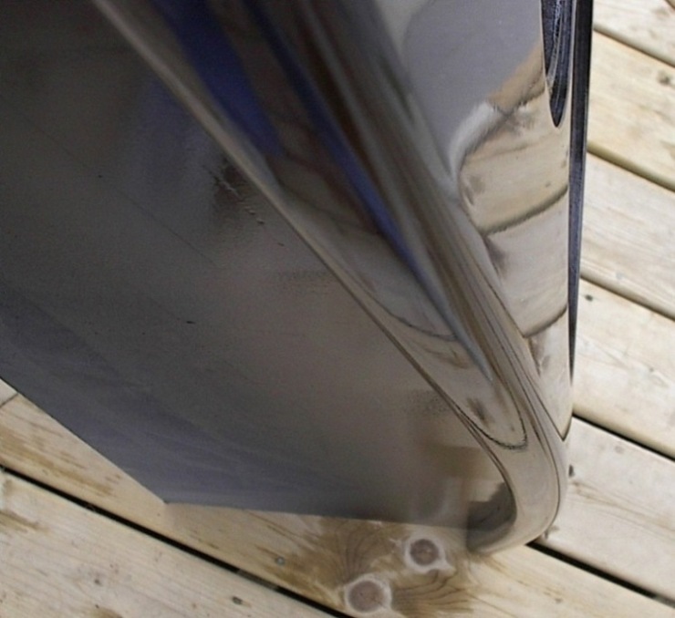

The biggest problem with priming MDF is the end grain. Everyone knows that it absorbs quicker than the face grain, but the real problem is that it can suck the solvents and/or resins out of the paint and leaving an inferior finish. It will literally seperate the paint as it's being applied.
Treating the edge grain with a urethane based finish prior to priming will block this absorpsion problem.
In the pic below is a speaker baffle that is laminated with 2 layers of 5/8" MDF. The first layer was glued, clamped and screwed to the box. the second layer was just glued and clamped - no screws. As can be seen, there is quite a curve to it (about 5" out of line). It took considerable clamp pressure to curve the MDF, and the only thing holding it on is yellow carpenters glue.

Love the curved baffle - but I notice what looks like lines in the finish down the left hand side of the image. They appear quite similar to the problems I've been seeing. Are they an artifact of the camera/reflection of something else/a different problem?

The area you pointed to is the side of the box, and is un-finished (just hit by overspray). It will be given a layer of cherry veneer plywood. Only the curved front baffle is finish painted. As I mentioned before it's two layers of MDF glued together. No line is visable at the joint, in fact it appears to be a single solid thick piece. The picture is a few hours after painting (10 coats).
Here it is before primer:
