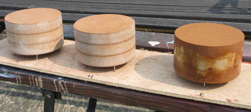

I did another three test blocks, coating one with shellac, one with wood hardener (which I didn't try last time) and another with epoxy. This time, all the blocks were left in my living room for a few days before sealing, and were completely sealed (i.e. not just the sides and top).
Before applying the sealer, I also filled any holes/lines with Plastic Padding PP100 filler.
You can see the test blocks in the attached photo.

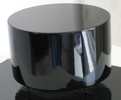

...I then flatted the three blocks (applying a second epoxy coat as per the instructions, and more shellac/hardener to the other two). After another flatting, the blocks were sprayed with black cellulose.
Very strange result; this time, the glue lines became immediately visible on the epoxy block - as if the paint had managed to 'eat' only into those areas. I've still not worked out why that happened, as it didn't the first time I used the epoxy.
The other two blocks also showed the lines, in the case of the shellac, pretty much the same as before.
After flatting the paint, I was able to remove all traces of the lines on the blocks.
This time, I had some proper lacquer, and sprayed around six coats using the HVLP gun. This showed the lines on the epoxy block again (though to a slightly lesser extent)! Weird.
I left the blocks for a week and performed a finish sanding/polishing as before, and this managed to get a very good finish on the epoxy block (it wasn't too hard to flat out the lines again).
After another week sitting in my living room, the epoxy coated block still looks fine, but the lines are starting to appear on the other two.
Attached is a photo of the epoxy block.
Conclusions:
1) Epoxy is the only coating I've yet found that will prevent glue lines reappearing (not even 2k high build automotive primer will do it).
2) Leaving the blocks inside to 'equalise' the moisture content to that of the intended room placement didn't appear to help that much.
3) The lacquer I used was a single pack product, and is still soft after two weeks (easy to put a fingernail into it). As a result, during final flatting/polishing you end up leaving fingerprints and marks as you handle the block. Unfortunately, it looks like I'm going to have to buy (or at least hire) a compressor and airfed mask, so I can spray 2k lacquers.
