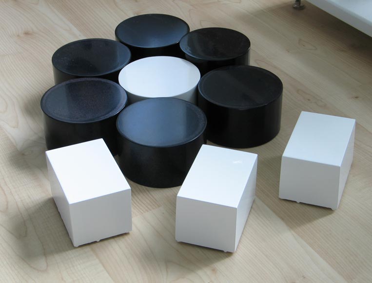

Finally, I can offer what I hope to be a conclusion to my experiments in finding a suitable coating for MDF.
The 2K urethane blocks were sanded and polished a couple of weeks ago, and none have shown any signs of lines appearing.
I was following Ant's "How-to for a high gloss finish" thread, and to be honest, I haven't done a great job (they're a bit scuffed) but all (2K urethane and 2K urethane + 2K clearcoat) look like they will take a nice shine.
To summarise...
All below were finished with black cellulose paint and 2K clearcoat:
The above blocks that worked well were left for a long time (many weeks) indoors after glueing, and several weeks before sanding and 2K clearcoat. I left a couple of weeks before final sanding/polishing the 2K clearcoat.
Of the urethane painted blocks, a Cascamite glued block was given several coats of 1K white urethane, with a week drying time between each coat. This has shown no lines, but even weeks later is just slightly soft (it will take a fingernail). Coating with 2K clearcoat is not possible, as it reacts and discolours.
The three rectangular blocks have been discussed in previous posts, and were all Cascamite glued then painted with 2K white urethane. One was sealed with Cascamite before painting. The other two had the paint applied to the raw MDF (like the 1K urethane block mentioned above). One of the raw coated blocks was finally given a coat of 2K clearcoat.
All these blocks were given 2-5 days between coats, as the 2K dries very quickly.
So, my recommendations:
To summarise...
- PVA glued + very heavy epoxy coat -> good
- PVA glued + thin epoxy coat -> some lines
- Cascamite glued + polyurethane varnish coat -> good
- Cascamite glued + thin epoxy coat -> good
- Epoxy glued + polyurethane varnish coat -> good
- Epoxy glued + thin epoxy coat -> good
- Keep the MDF indoors (in a dry location) as much as possible.
- Glue with Cascamite (now I believe called Polymite) or epoxy.
- Apply plenty of pressure on the drying surfaces.
- Epoxy works well if you can spend the time building up many smooth thin coats
- Solvent based urethane works very well, though the (safer) 1K version doesn't seem to dry as hard as cellulose, let along as hard as the 2K version.
- Take your time - the longer you leave between coats, for the paint to sink and shink, the better.
- Gently sand between coats - especially to attack the glue lines if the paint has sunk.
