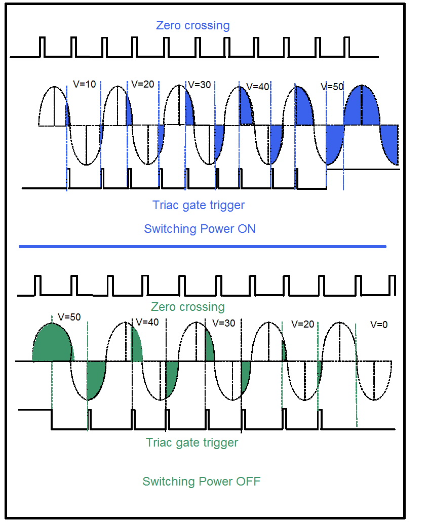

This is it an update report of the project. Attached it is a timing diagram of the final timing programmed in the micro for the switch ON/OFF sequence. The final timing was tested in both EI and a toroidal transformer without any current spiked. Ran both 500 times flawless without any problem. Also I used it to turn on a light bulb and ran as dimmer. Everything ran smoothed. Now I am still working in the printed circuit board. The final module it is going to be an stand alone chassis to allow it to be use externally without any internal modification.
