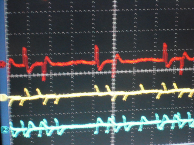

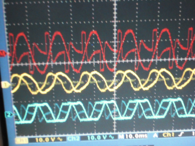

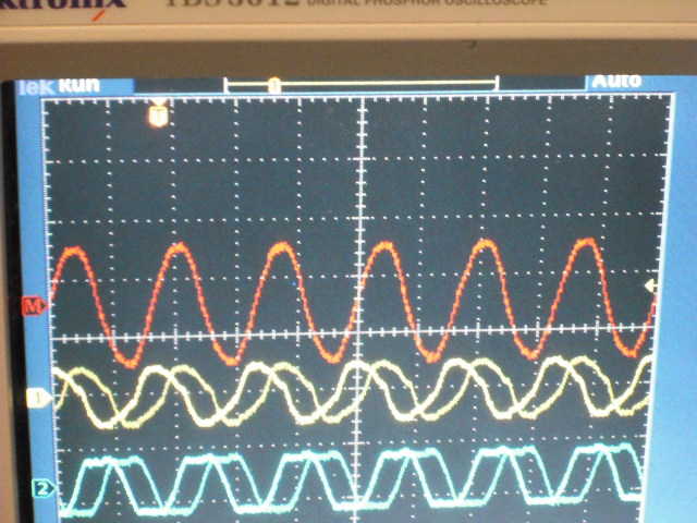

Thank you everybody for the information. Right now I am out of town so my project it is on hold. I ran my prototype in a loop 500 times ramping up/down flauwless. No problems. I need to do the test with a toroidal and if it is ran OKAY I would said that the problem it is fix. I am going to take some pictures of the scope showing the secondary AC wave form of the output. There it is not spikes and it is cleaned.
Well this is a challenge for me. I would like to fix the problem permantly and I think I am in the right track. I also used current inrush limiter in all of my repaired but I still think this is a better solution slowly ramping the volatge from zero to max voltage without any spikes or noise. Nobody can stop you from using the inrush current limiter.

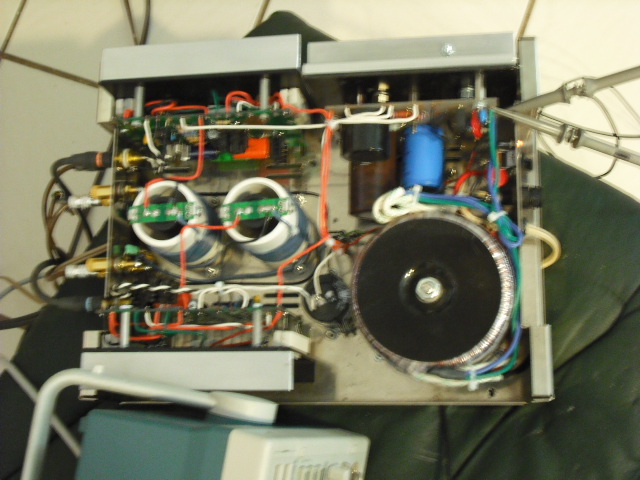

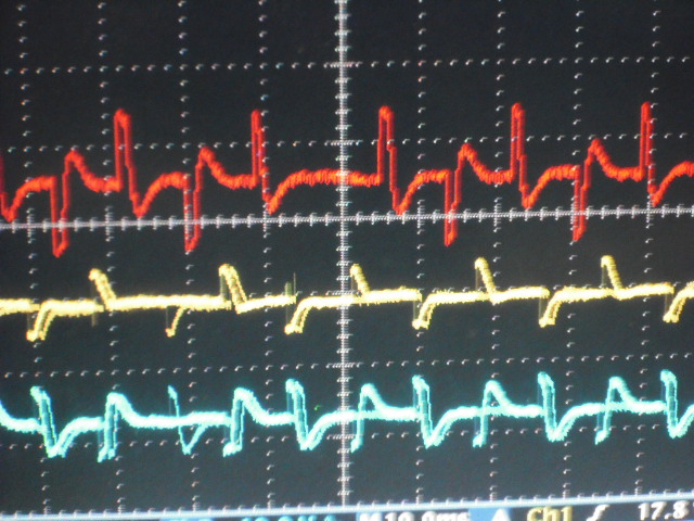

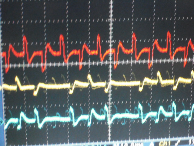

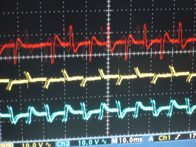

I am back home immediately started working on my project. Ran the same test I did to the EI transformer using a Dynaco 120 with a toroidal transformer. Ran it by ramp the voltage up/down repeatability for 500 times with the same results as the EI transformer. No blown fuses or spikes. Attached are some pictures showing the waves going up/down the peak. I have to scope them differentially due to probes are ground in the scope. The red line it is the differential. You can see that waves are clean with no spikes what so ever. Now I am working in the printed circuit board to finish the project. Well I need to do one more test and it is test it in an equipment using tubes to see how the filaments look like when the voltage it is slowly ramp up.
