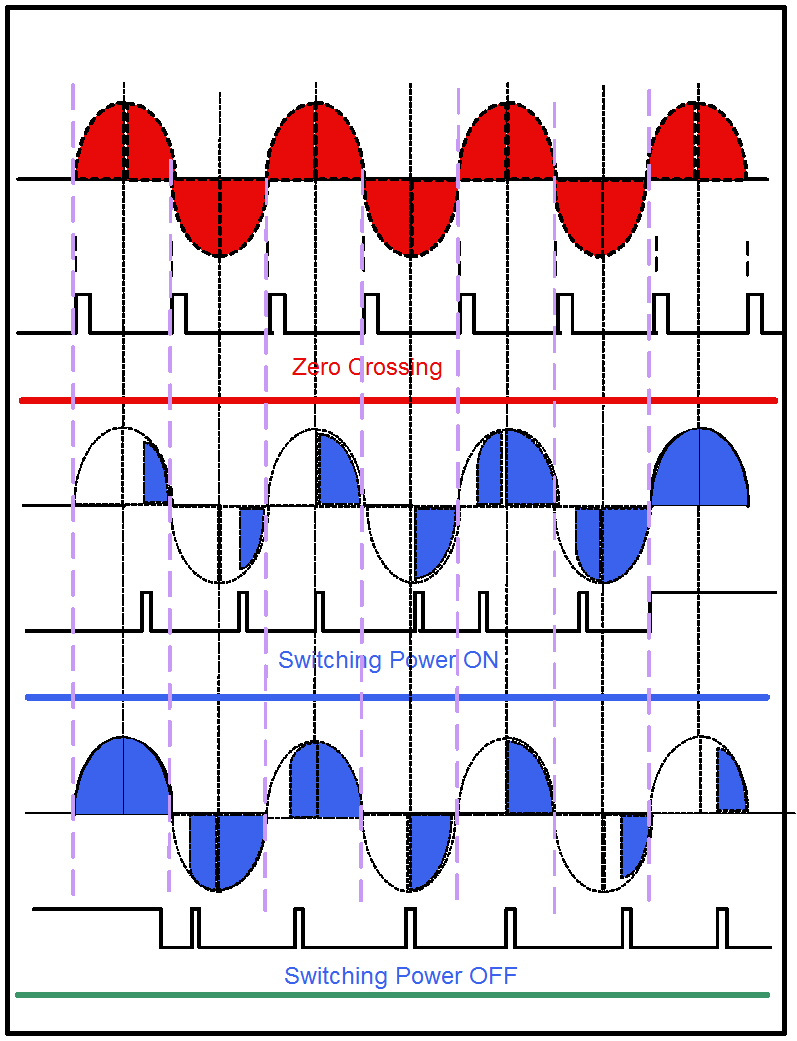

My theory to solve the problem it is the use the microprocessor so at the zero crossing to start bringing the voltage slowly up by controlling the triggering of the triac from the end of the wave cycle to the beginning. This will slowly bring the voltage from zero to full voltage. To switching OFF I will used the same procedure by at the zero crossing slowly bringing the voltage down starting by controlling the angle of the wave cycle from the beginning to the end of the wave cycle. By doing it in this way it will leave the transformer in the dull state with no magnetization or the core will not have magnetic polarity? Hummmmmmm????
There are two question from the above explained that I need to corroborate and couldn’t find the answer searching the Net. If the toroidal transformer is switched ON/OFF always at the zero crossing will it have zero residual magnetic polarity in the core? Will it only have a barely small left over flux due to the hysteresis of the iron core?
I would like to ask if there is a member that has some transformer expertise that can corroborated/answer it. All members are welcome to advice/recommend in the design/development of the project.

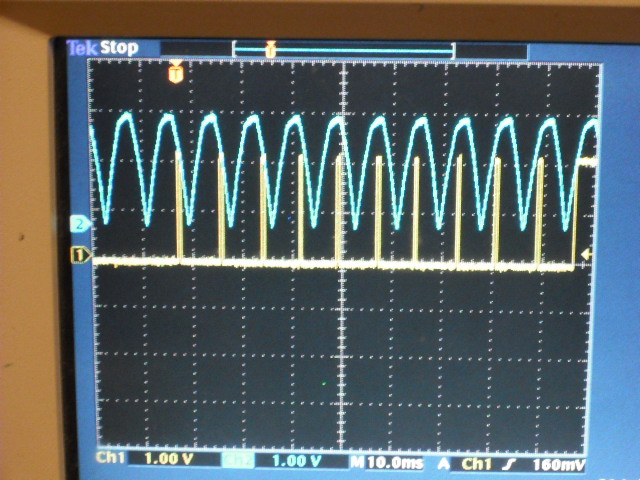

I ordered a isolated chassis mount triac and a non-zero crossing SSR to built a full running prototype. Right now the status it is waiting for parts.
Attached is a timing sketch showing my theory and a picture showing the preliminary triac gate triggering circuit/software development. You can see the triac triggering pulse moving from the end of the wave cycle to the beginning. Both +/- wave cycle most be triggered to balance the magnetization of the core.

Anyway, you arrive at a correct solution for the wrong reasons: starting with a small initial flux of either direction, and increasing it progressively to reach the full excursion after a number of cycles is a possible solution: it is a soft-start, in short.
It will retain the maximum possible magnetization, because the voltage and current (the magnetizing one, which is important here) are in quadrature.
If you want to simplify the circuit and avoid the full soft-start option, you can switch on the transformer at the maximum of the voltage.
That's what SSRs for inductive loads do. They generally have a special suffix.
They won't be able to eliminate the power-on surge completely, but they will reduce it to a reasonable amount.
Of course, a good dimensioning of the transformer will also be of great help.

I just got the parts and did some test and it ran OKAY. I have small glitch in the switch ON that I am overshooting the cycle wave at the beginning. It is in the software, If I terminated the cycle half way everything ran good.
I did a test switching the EI transformer with the switch and the current reading jump from 3.8 to 4.7 amps. Using the micro the current stay within the limits of 1.7 amp. No jump and it is cleaned.

I used the soft start it is running good. Yes with the switch I have some good reading. Maybe like you said I was synchronize with the zero crossing. One thing I noticed is that once you reached the half of the cycle wave the reading of the voltage it is at the max. I still need to do some adjustment in the software. I have a tube tuner and I am going to do a test to see how the filaments light up.

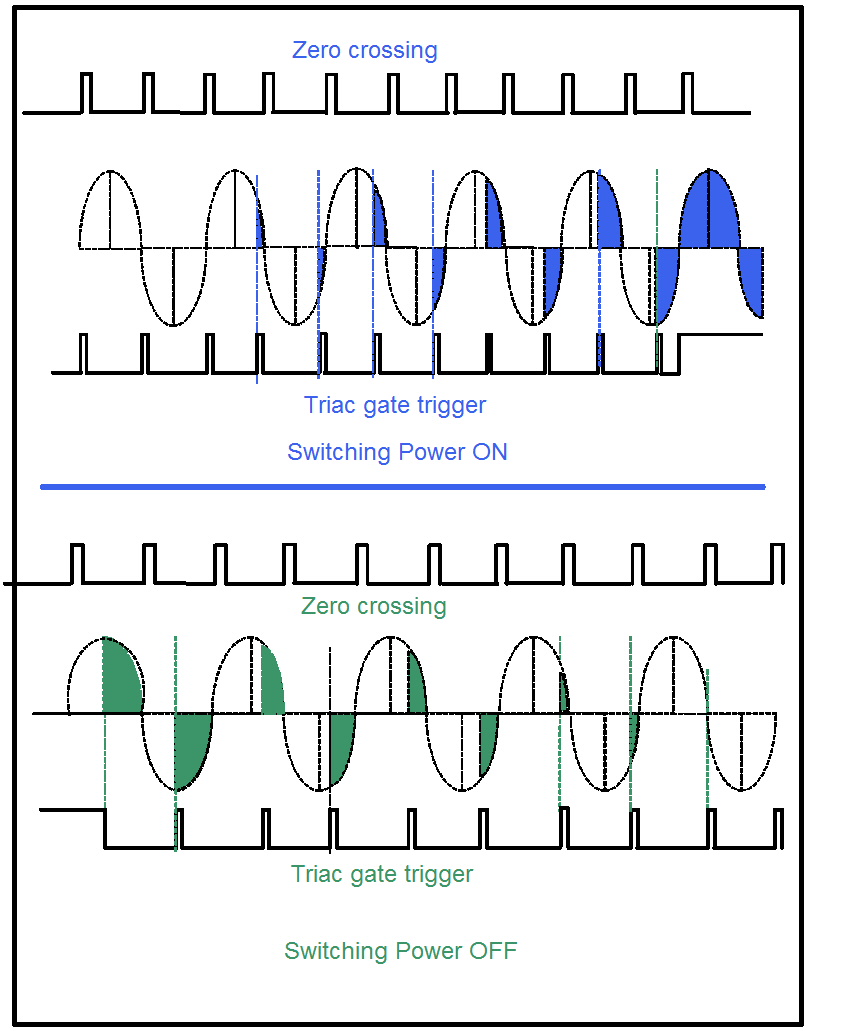

This is reporting the status of the project. Finally I finished with the software after five different drivers. When testing the final one for the first time immediately a problem was encountered. “Call Houston I have a problem”. This problem was not expecting or prepared for it. When firing the triac from the end of the wave cycle to the beginning from about 30% or 30 degree of the wave cycle the transformer started humming badly and the current when up almost to 18 amps. It is sound like a bell ringing. Tried different thing but was unsuccessfully to fix the problem. During the testing I ran out of fuses so temporary fixed the problem by using a 20 amps fuse. The light from the blown fuse looks like a super nova explosion. The problem happened in both directions. So during the testing I noticed in the scope that this was happening after the wave cycle was at the peak going down. By doing some changes to the triggering timing in the cycle wave angle found that the problem when away at the peak. At this point no current spikes was noticed. Tried switching ON/OFF 3 to 5 times in sequences and every time was successfully completed without current spikes. Making the necessary adjustment to the software so the triggering of the triac start at the peak going down and from going up to stop at the peak everything started to run flawless. Try a soft start by ramping the wave angle cycle up to the peak and down from the peak and it didn’t show any current spikes.
Some of the members already pointed out some of the problems that I may possible encounter but the humming was a big surprise. One suggested to trigger the triac at the peak in both directions would worked out but what I was looking also was to be able to ramp slowly the voltage up and down so it can be use it also in the tube amplifiers. This will extend the life expectancy of the tubes by preventing the filament temporary brightly light up until the heat increase the resistance of the filament to the normal operational temperature condition. This will eliminate the stress in the filament.
Right now I am testing the circuit using a Dynaco 120 transformer with an output of 85 volts AC 3 amps with a load of 2.0 amps. Modified the software by adding a loop to repeat the ramping up/down test 100 times and stop. No problem encountered. Also need to do the same testing using the toroidal transformer. Everything up to now it is looking good and the project look like it is very feasible. I can not count victory yet until the test it is done using the toroidal transformer. That it is the main goals of the project. Need to go to Radio Shack to buy some fuses. Also working in the printed circuit board.
I would like to thank every body that participated with comments and suggestions. Every one was welcome and taken them in consideration for the project.
Please keep in mind that I am not a technical writer. It is hard to explain in words was going so any body can understand it.
Attached it is a sketch showing the final timing.
