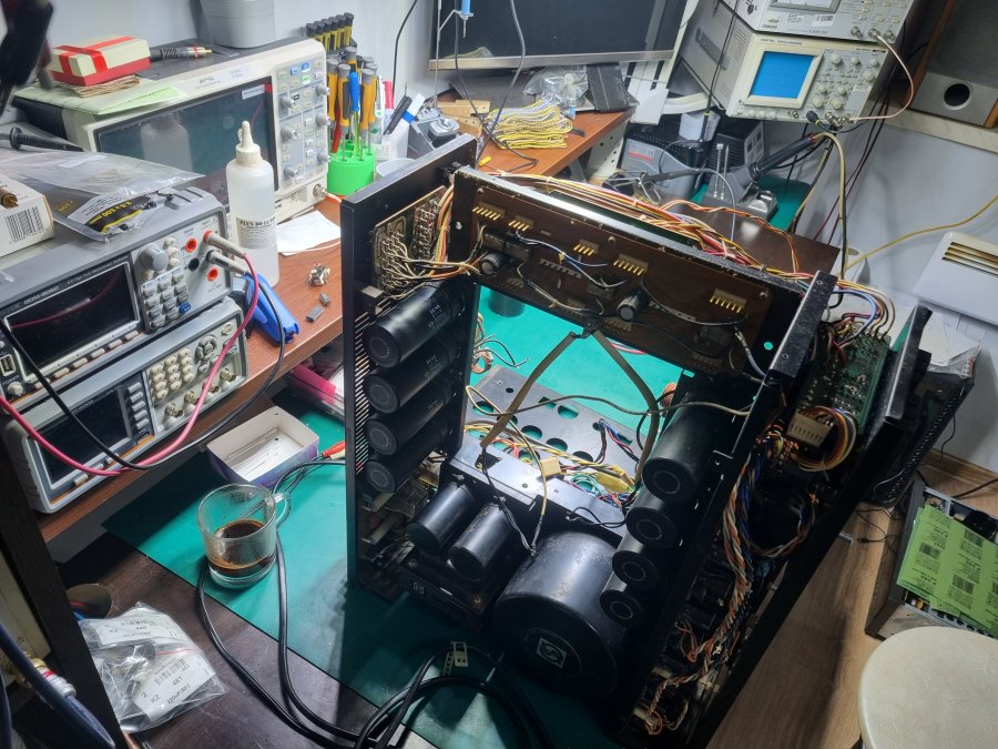

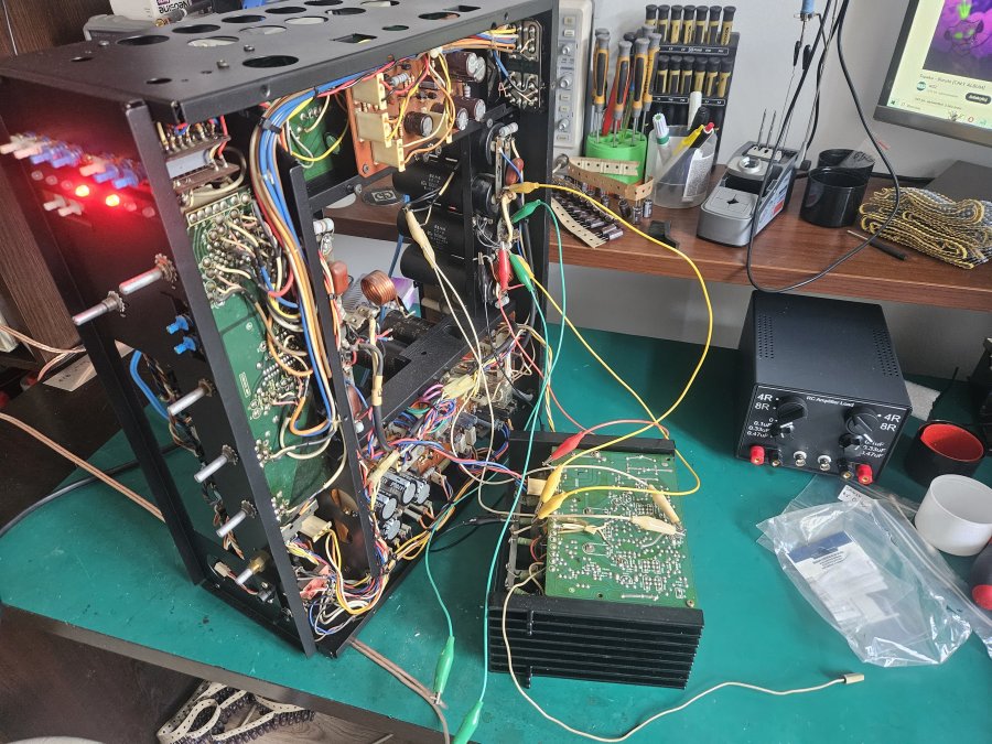

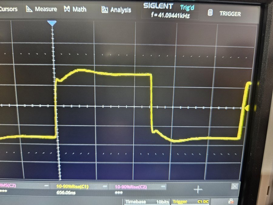

AU-X1 is a specific amplifier, the design assumptions and specifications were beyond research capabilities at the time
Most important:
Common problem is the inability to set the +/-11V voltage, then you need to change the value of the R73 and R04 resistors from 5.6k to 3.9k, the lack of voltage stability most often results from problems with the limiting resistors R41 to R44, the diagram obviously contains an error, in fact these are two resistors connected in series with a resultant value of 13.8 ohm It is worth adding an interesting fact that engineers improved the design of the amplifier practically throughout the entire production period, the last modification was a complete redesign of the main board of the phono preamplifier.
If you need any other info let me know, i restored hundreds of them.
If you will make those modifications the amplifier will be stable and will sound like it should without decrasing its performance

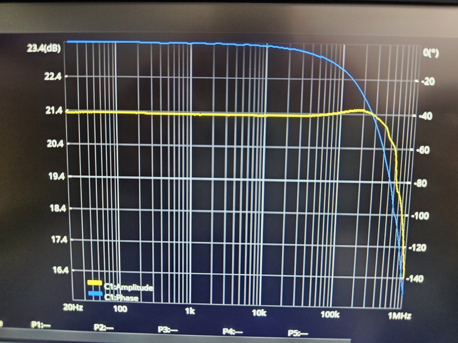

One i own personally, after all the mods its stable with square wave 10Vpp 8R+0.47uF up to 200kHz, rise time measured is 0.3uS, the bandwidth is up do 600kHz -1.5dB, and 1Mhz -3dB

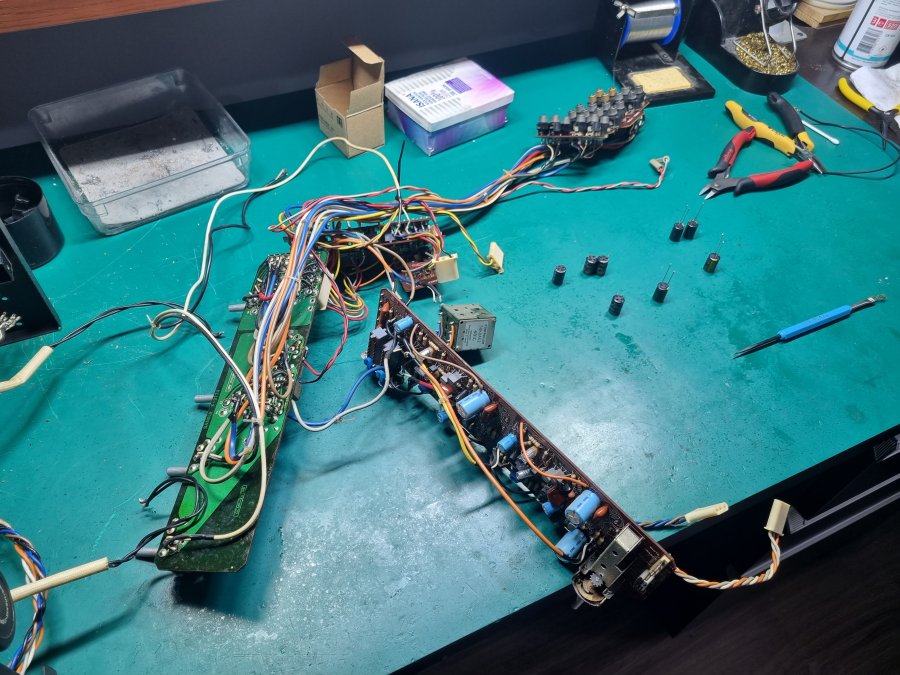

Most important:
- Replacing Black flag capacitors
- Modification of the GND of the line preamplifier through 3 star-connected capacitors
- Modification of the GND of the main board of the turntable through 3 star-connected capacitors (Most often already introduced at the factory)
- Replacing fuse resistors less important but worth doing
- Changing the value of pre-driver decoupling capacitors from 33pF to 47pF (Often already introduced at the factory)
- Removal of ceramic capacitors from MM preamps
- Replacement of MV-12 diodes with 2 series-connected 1N4148 diodes (8 in the power supply, 2 in the power amplifiers, 2 in the preamplifier) Does not affect failure rate but improves offset stability
- Modification of the GNC of the MM preamps, cutting off the non-inverting input and connecting it with a 0.33uF capacitor, then connecting the transistor input with a 1M resistor to the output of the MM stage

10VRms 8R + 0.47uF 40kHz
Performing stress tests, its stable even with such connections

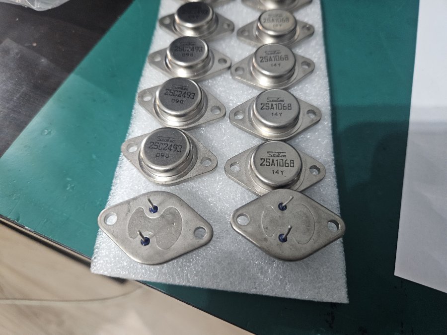

Every one is repaired with original NOS transistors
