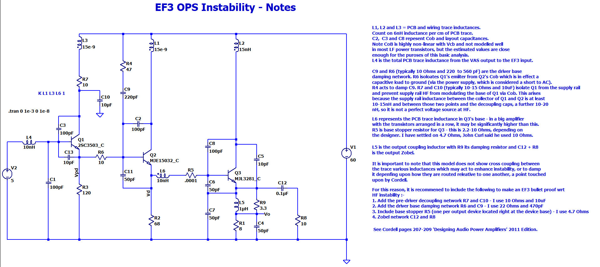

I put some notes together on EF instability based on Cordell's book and my own experience. Its not perfect, but it does provide some general guidelines about how to make an EF3 bulletproof.

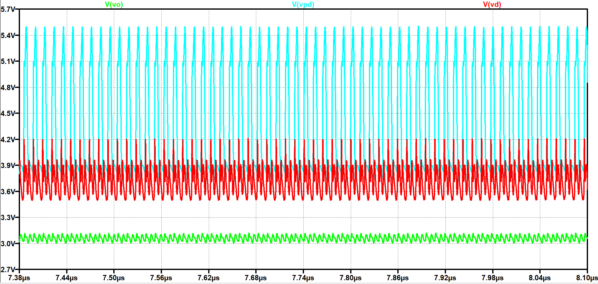

Here is the oscillation WITHOUT EF3 instability precautions :-
I used 10-15 nH PCB trace inductances in this model, whereas Cordell used 35nH in his which will in general result in lower oscillation frequencies. On small signal emitter followers, I've had problems at 180 MHz, and on a beta helper in a VAS circuit, 20-40 MHz. My first EF3 in 2006 oscillated at 4 MHz (used MJ21193/4 output devices) which was cured with base stoppers in the output devices and a 22 Ohm and 1nF driver base damping network. I've not had a EF3 problem since then, using the simple techniques 1-4 outlined in the 1st graphic above.

Thanks for doing that. I knew about base resistors and collector decoupling.I put some notes together on EF instability based on Cordell's book and my own experience. Its not perfect, but it does provide some general guidelines about how to make an EF3 bulletproof.

How do you measure that in real life?I've had problems at 180 MHz, and on a beta helper in a VAS circuit, 20-40 MHz.

And if I happen to have a 20/40 Mhz scope I would not notice anything?With a scope
That is likely good enough. Oscillations tend to be gross - the voltages appear wrong and the amplifier is getting hot! It may even be jamming radio receivers.

Depends if it is digital or analog. 20 MHz analog scope will show a 100 MHz signal. Digital will not.
Then it would be easiest to judge their presence by power consumption (rail current draw)?Oscillations tend to be gross -
Current draw is only a clue. Use the oscilloscope.Then it would be easiest to judge their presence by power consumption (rail current draw)?

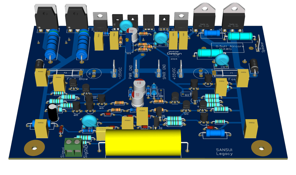

- Preventing Sansui AU-X1 output stage oscillation burn out
