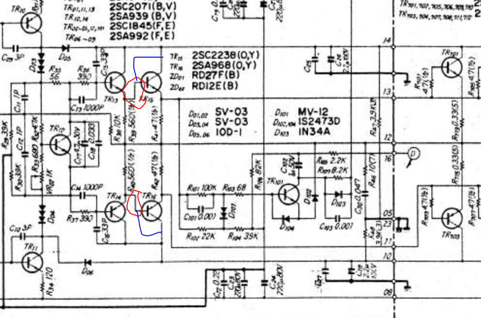

It can't be 680 and 1nF as that sets the -3dB bandwidth at 234 kHz - that would show up on a frequency response test. They are quoting DC to 500 kHz.Hi.
680 + 1 nF.

The arrows you point to above are not part of loop compensation. The 47 Ohm resistor across the JFET sources sets gain - it's not a loop compensation component. The 22 pF cap is likely for local stability reasons, or to balance the gate load capacitance between the two halves.
Placing the Zobel AFTER the output coupling coil is not considered best practice for the reasons I gave earlier - and especially so if you are using an EF3 which easily oscillates at HF without precautions or sloppy layout. Looks like they corrected it on later models though.
I just noticed the VAS outputs are also loaded to 0V with 39k resistors. You see this on a few amps of this vintage and it's usually being done to try to flatten the loop gain. At around this time - and still prevalent in some circles today - there is the mistaken understanding that if an amplifier's loop gain or open loop gain bandwidth is low, it will not be fast. As explained in many texts on feedback (Jan Didden also did an article on this specific issue a few weeks ago), this doesn't make the amp faster. Opamps that slew at 100 V/us have -3dB open loop bandwidths of <10 Hz and full power bandwidths of 200 kHz.
The diode chain you show looks to me to ensure the pre-driver and driver don't saturate - only the VAS transistor can. Since the VAS device is usually faster than the drivers, it should recover more quickly if overdriven. This copuld be an issue in this amp because the VAS and front end are supplied off a higher voltage than the OPS.
This is a fascinating design. It has high gain and two poles (at 30KHz and 120KHz). I am not surprised that it is on the edge.

Loading the VAS adds local feedback to it. It is often a very valid thing to do - especially when more than two gain stages are used. In the standard 2-stage-plus-followers topology it makes very little sense.
The 39K resistors set the gain of the VAS and the frequency of the pole at the VAS output. They are necessary because the VAS does not function as an integrator in this design.
ETA - The pole from the 3pF capacitors is ~400KHz.

You can shape loop gains of >120 dB to ensure adequate gain and phase margins at the ULGF rater than loading the gain out. It may require more than one pole - zero pair (so 3 or 4 pole compensation) in the comp network, but it is doable. However, my personal opinion is why do it when below a certain level, distortion is not audible? You are just creating complexity.
Ed, you still have the integrator function via the caps returning to the inverting input - at some point, the VAS stage gain has to be curtailed if there is to be any chance of stability since the OPS ultimately sets the ULGF and the available phase margin. By comping the amp like this, the amount of current available to charge and discharge the comp capacitors is greatly increased. If they had used standard miller comp, the quoted slew rate 260V/us would have been difficult to achieve. It is still an integrator stage.
The VAS is loaded in the manner shown in the Sansui circuit almost certainly to flatten the loop gain response, and they used very small Miller caps to try to maximize the loop gain before flattening it out with the 39k load resistors. A lot of these vintage design approaches were based on misconceptions and are discussed i.a.o by Cordell, Self, Putzeys and recently in Jan Didden's audioXpress article.

Bonsai - The 3pF capacitor around the VAS is technically an integrator, but only above 400KHz. It is the third pole that I see in the Sansui amplifier.
The dominant pole is at 30KHz from the 680pF capacitor after the input FETs. The 120KHz pole is on the VAS output. I also see two zeros, one from the 470ohm resistor and other from the 1pF lead capacitors. I can tell that Sansui had a hard time making this amplifier work. 😉

2. The OPS is an EF3 if I'm reading the schematic correctly. These are prone to instability unless treated with care - again, Self and Cordell discuss this in-depth (see especially Cordell).
Yes. There are very high probability of instability.
Place something like 100-150 Ohm in red circles between first and second followers.
Place something like 100-300 pF in blue line between base and collector of the second follower.

Just a side question - why are such caps placed between base and collector when collector is connected to the voltage rail and not between base and earth?Place something like 100-300 pF in blue line between base and collector of the second follower.
Collector pin (i.e. voltage rail) is physically nearer to base or is there some other technical reason?
The power supply rails are at 0V to AC because of the PSU caps. The advantage of this is you are not injecting HF signal currents into the ground network, but instead the rails where you get some PSRR rejection help and the HF signal currents are routed back to the star ground, assuming the board it laid out correctly.

This is a well known and say classical way to stabilize EF3.
Connecting the capacitor between the base and collector minimizes the inductance as seen by the transistor. This connection also creates a path for high-frequency noise to couple from the supply rail to the signal, but that is less problematic than inductance.Just a side question - why are such caps placed between base and collector when collector is connected to the voltage rail and not between base and earth?

If the capacitor were connected between the base and ground, then the inductance (as seen by the transistor's base-collector junction) would include the supply decoupling capacitors and PC board tracks. That is not very much until frequencies get into the MHz to tens-of-MHz.

The 33pF capacitors swamp the non-linear base-collector junction capacitance. At least, that is my understanding.
