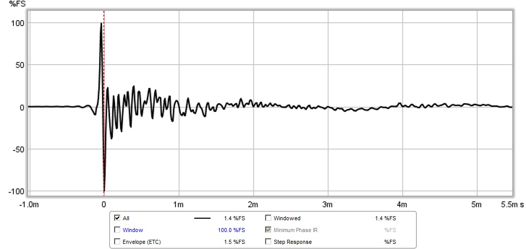

You are right about the sibilance. I will need to adjust the EQ to tame the 12kHz peak which shows up in the IR. Like I said, this is the initial EQ and still needs some work.

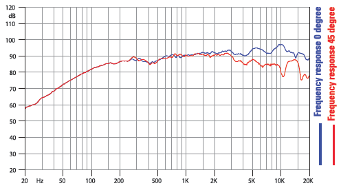

Don't laugh or just do but haven't got to the point yet where have experience REW and technical plots as IR, you know only last week got the UMM-6 microphone so will come, but in reality i need to read some manuals regarding IR. Have a feeling though it's that first 0,083mS down or upward ringing after the 100% ones.
Attachment is just my interest/curiousity or trying to help little, look 3FE22 8ohm datasheet frequency plot, could be that the 45º reading 12-15kHz upward boom, that when it passes through horn lens will be added more or less on axis.

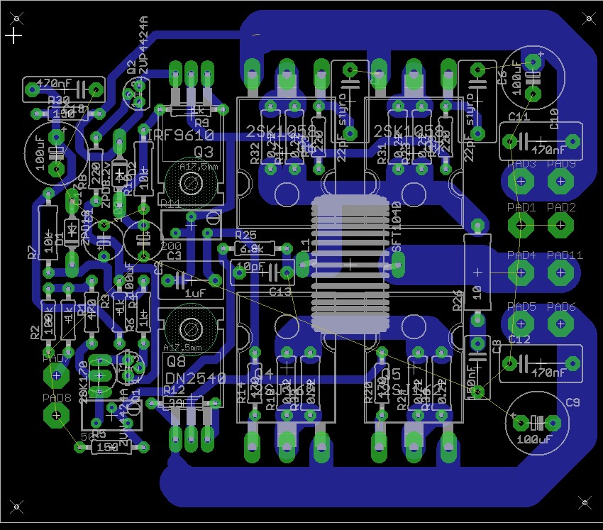

Afcourse I need a amp for the tapped horn first.
This is a allfet amplifier and has very low impedance. Thus not
a hybrid, for max 100 Hz it is not needed, but go test this amp
with a wideband speaker to hear all sound from it.
almost ready with the PCB.

Kees,
Neat design there - what are the design's performance specs? There is an inductor - almost looks like a class D but you are an analog guy through and through so probably not. 🙂

You are right, I do not like D, I have it elsware, it is in allfet threads, I have get my inspiration from there.
This momente I am busy with a loudspeaker jigg for measuring speakers, it constists of a 6 watts class b amp and some opamps, it will work a lot better with limp then through a pc headphone output.
And yes it is OT.

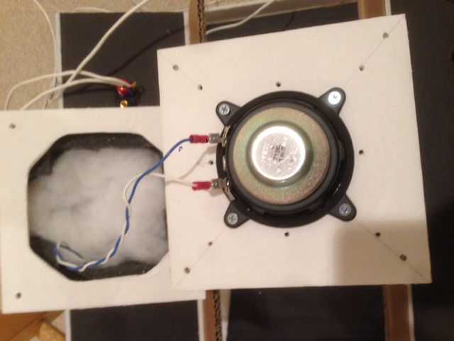

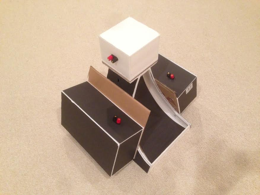

Just thought these might be useful for folks to see the interim stages of the build showing a closeup of the the throat flange where the driver bolts onto, and the rear chambers and how terminal binding posts are attached as well as how they are lined with foam.
Throat flange (note sandwich construction of FC-3-layer cardboard-FC):
437853d1410363692-presenting-trynergy-full-range-tractrix-synergy-tractrix-throat-flange.png
Throat flange with 3FE22 installed and rear sealed chamber removed showing foam and polyfill damping material:

Rear view of Trynergy showing all three rear chambers in place:
437855d1410363692-presenting-trynergy-full-range-tractrix-synergy-trynergy-rear-chambers-photo.png

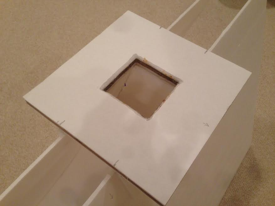

Ok, you've twisted my arm 🙂 Oh, and it seems to be working, so it might be worth showing...
Ages ago I wanted to build the cornu spiral speakers that Cal Weldon and xrk971 had designed. I was struggling with Foam Core board, so I looked for a material that was flexible in one dimension, but stiff in the other.
Whilst walking around Lowe's one day, I came to the section where they sell damaged display items. Lo and behold there were a number of sheets of plastic that are used in lighting fixtures (the thin sheet that sits on a flange in the soffit, making the light from fluorescent tubes more diffuse).
Brand-new, these sheets were nearly $10 a piece, but the damaged ones (where a corner had been snapped off) sold for 10 cents! So began my escapade 🙂
Now, I'm using those sheets as the curved walls in the Trynergy. The plastic cut really nicely with my bandsaw, and I had some squares of 3/8" plywood left over from the abandoned Cornu project. So, I used construction glue to attach the plastic panels to the plywood sheet.
I did it in stages, gluing up the throat. Once that had set, I used small clamps as weights to hold the panels in the correct curve while the remainder of the glue line was setting.
I hope the pictures make sense! The first one was more time consuming, as the second one was approached with the jig that I'll eventually make from X's template in mind. Using a wooden tab I was able to locate the end of the mouth into the corner of it and a larger block, and using the small clamps again I was able to get the curve correct and glued up in one step.
I hope these pictures make sense!
Gluing up the first side, step two of three:
Step three of three:
Gluing up the second side, step two of two:
A general shot looking at the mouth. Note that the smooth side of the panel is facing us, so the texture is on the back. I didn't want to mess with any high frequencies! 🙂
I'm sure there will be bracing to do, and I'll have to think about where to cut the synergy ports, but I'm alright with the project running at this pace. I rarely get eight hours to work on something like this in one go!
