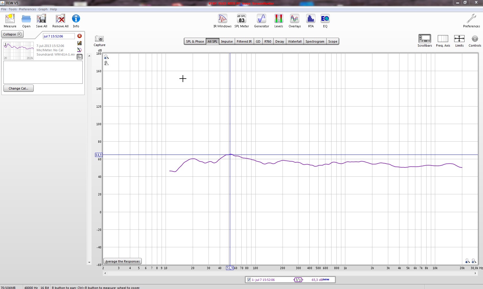

My test on youtbe with super open baffle did good, nice voices pf the new hybrid amp.
real diy testing, real fun. - YouTube
Open baffles with a T-TQWT is still a very nice to listen speaker, go very low also (under20 hz but room is to small).

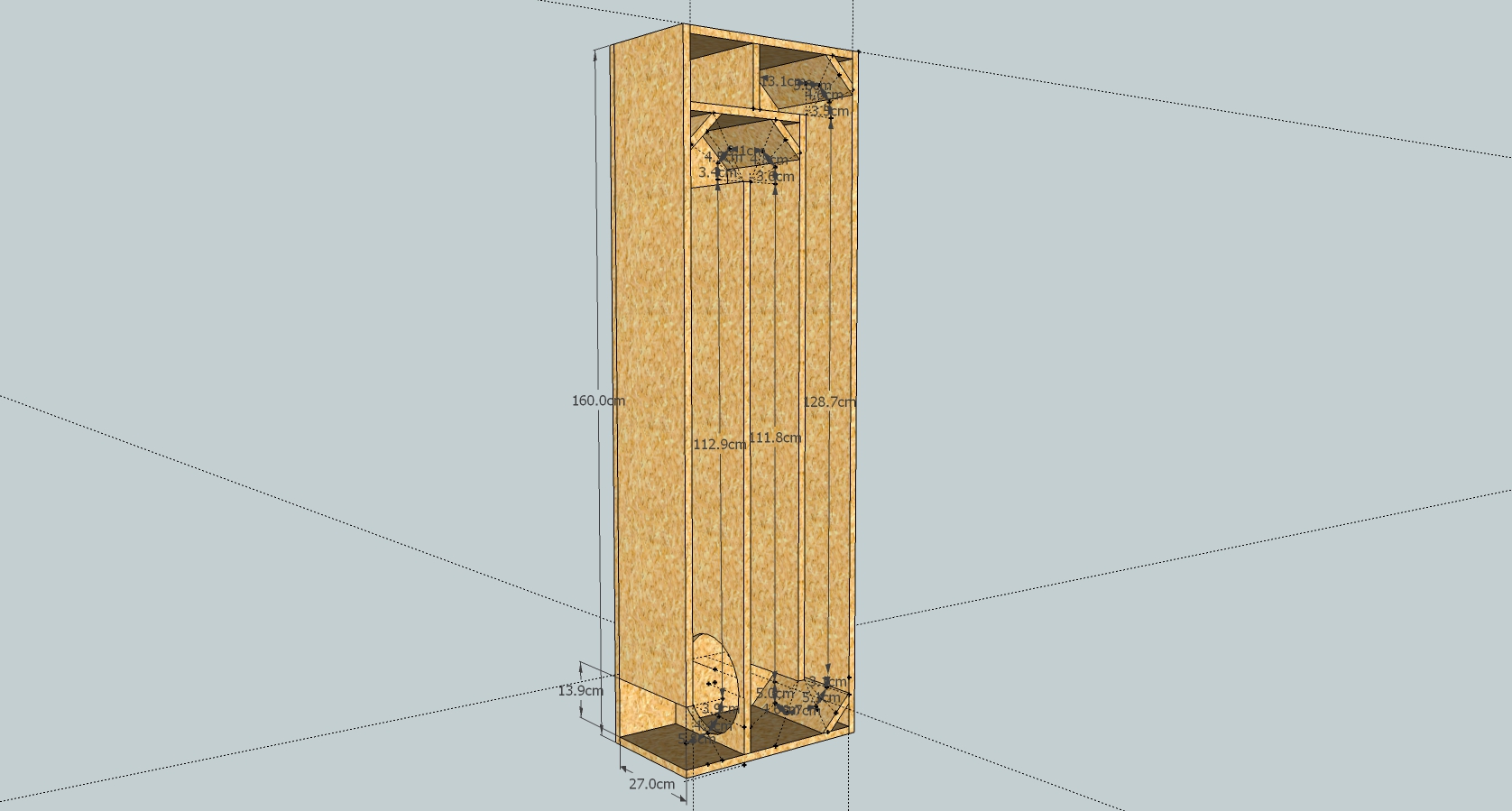

I have a "no baffle" with the phillips same as for synergy. and this sub for bass help.

Do not make me hungry to your design😀

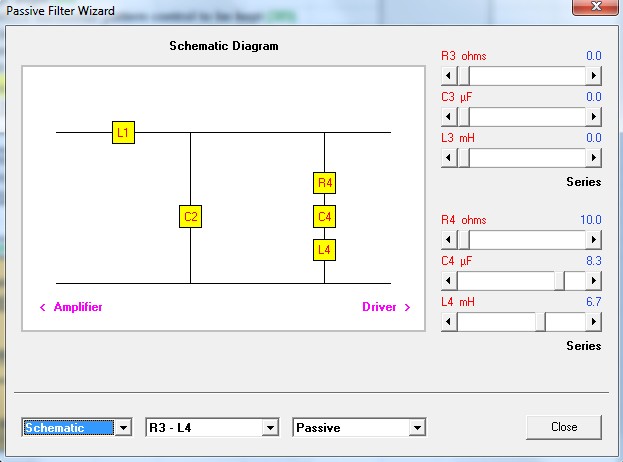

Yes sofware makers explode there software and make it big and sluggisch, I think back with tears as I see the assembler language was so beautifull.
I did try autocad 2014, 13 gigabyte download, this is super overbloated.

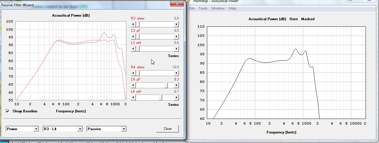

But did you see this in other thread? dig EQ or analog EQ.
You can see in hornresp what it does.
analog works fine and is easy to make when you now what to do.

Interest here analog RCL filters, those pictures there in corner saying "Passive Filter Wizard", what software package do this belong to.
