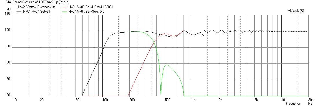

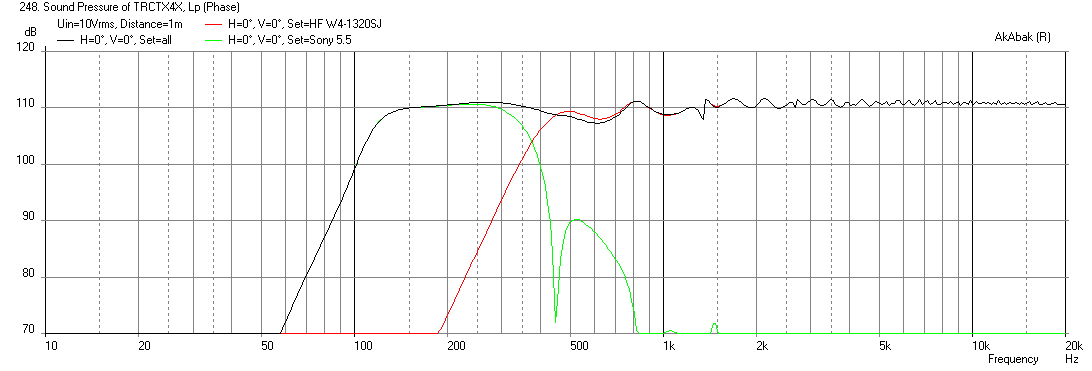

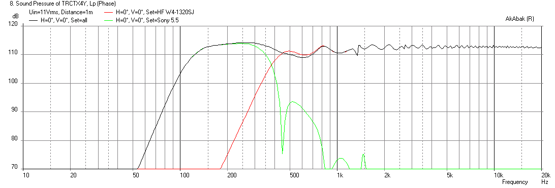

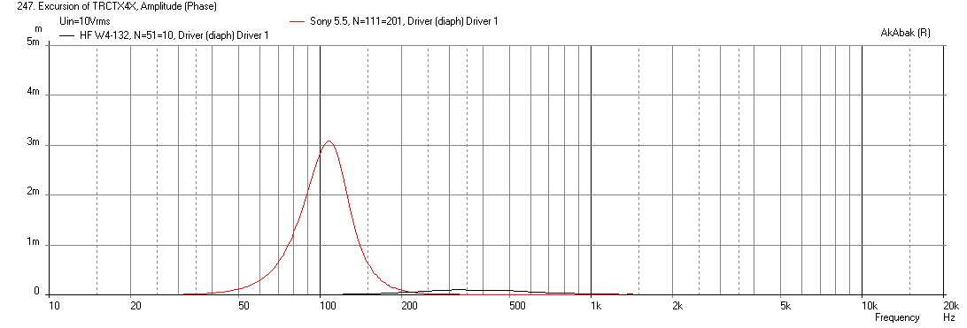

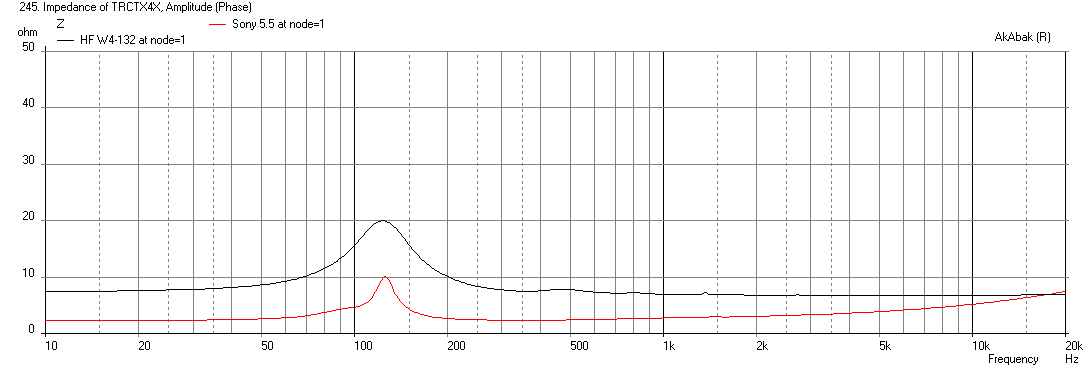

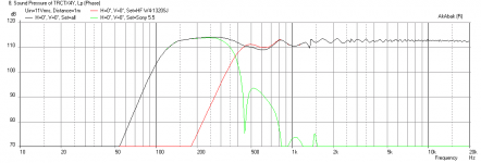

Trynergy with W4-1320SJ and Sony 5.5in woofers
I got a request for a Trynergy with some drivers that a member had on hand. The Tang Band W4-1320SJ (Nd magnet) driver seems to work well according to the sims. The salvaged Sony 5.5 inch woofers however, will need to be run qnty 4 in parallel for a nominal 2ohm load in order to to have enough sensitivity to work with this horn (even with the W4-1320 gain set at 0.4x). So a 2ohm stable amp will be needed for the woofers. This is not hard if you use a class D amp like TPA3116D2 in PBTL mode. This particular setup will only go down to about 120Hz rather than 100Hz or lower with the 6.5in PE buyout woofer. The dimensions of the speaker are assumed to be the same as the 0.7x Trynergy with same 9 liter rear sealed chamber for woofers and 3.2 liter rear chamber for full range driver.
Here is the freq response at 2.83V to woofer and 1.13v to fullrange at 1m:
Here is the impedance:
Here is the cone displacement at 10v corresponding to xmax (not much movement due to excellent horn loading):
Here is max SPL of 110dB at xmax:
I think it looks like it can work. Just be prepared to use a sub for below 120Hz content.

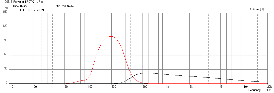

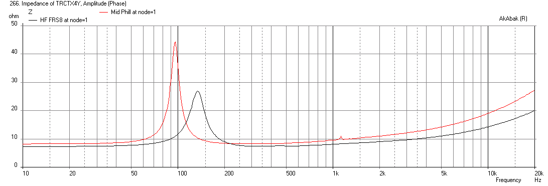

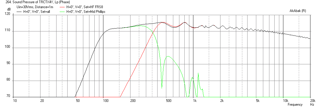

Kees,

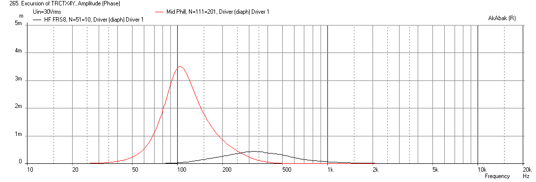

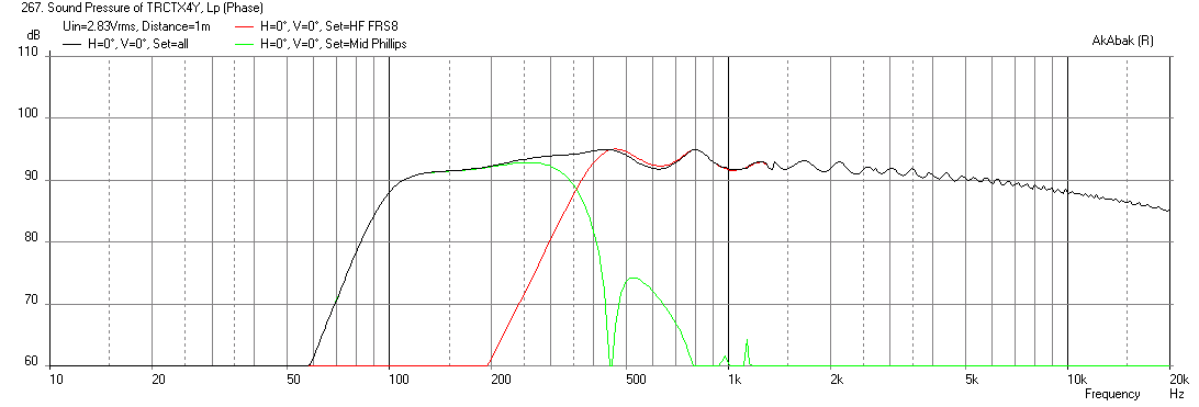

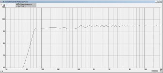

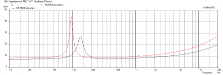

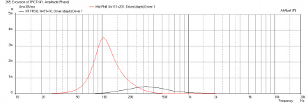

Here is the sim of the Trynergy with your selected drivers. I am using the FRS8 for the full range with a 0.45x gain relative to Phillips. I am assuming the volume of the driver chamber between cone and horn wall is 0.5 liter and I am using a 6.5cm dia injection port. Making it bigger did not help, and making volume of driver chamber did not help flatten or extend lower than 100Hz. The FRS8 somehow has a falloff with higher frequency from its T/S params. Not sure why. Overall your system looks good, the dual Phillips are in series for 8ohms nominal so will not appear as sensitive as a 4ohm setup with 4 drivers at 2.83v.
Freq response at 2.83v on Phillips and 1.28v on FRS8:
Impedance:
Cone displacement at xmax with -24dB/ocy HPF at 100Hz with 30volts:
Corresponding max SPL at xmax:
Electrical power required at 30v drive voltage:

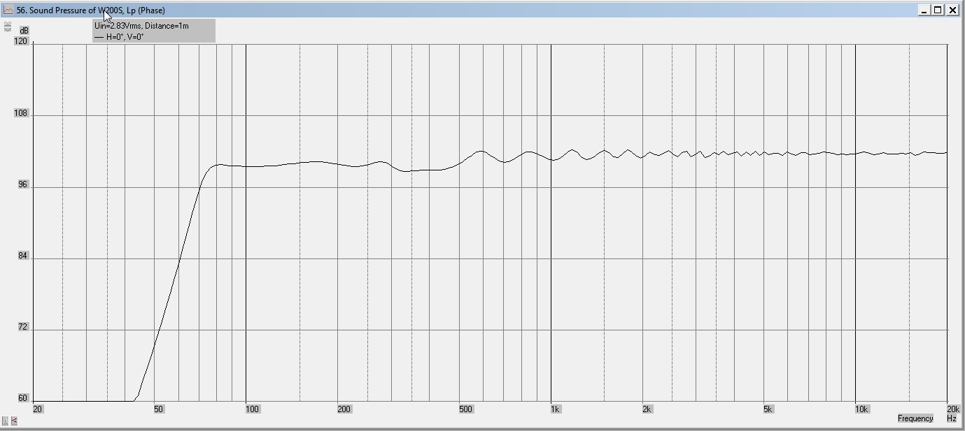

I have alter your script for the visaton W200S woofers 8 inch.
need some change in the allpass filter for get this respons.
and afcourse rear box, BR and injection ports are changed.
two woofers used.
and visaton FRS8M as replacement for your horn driver.
