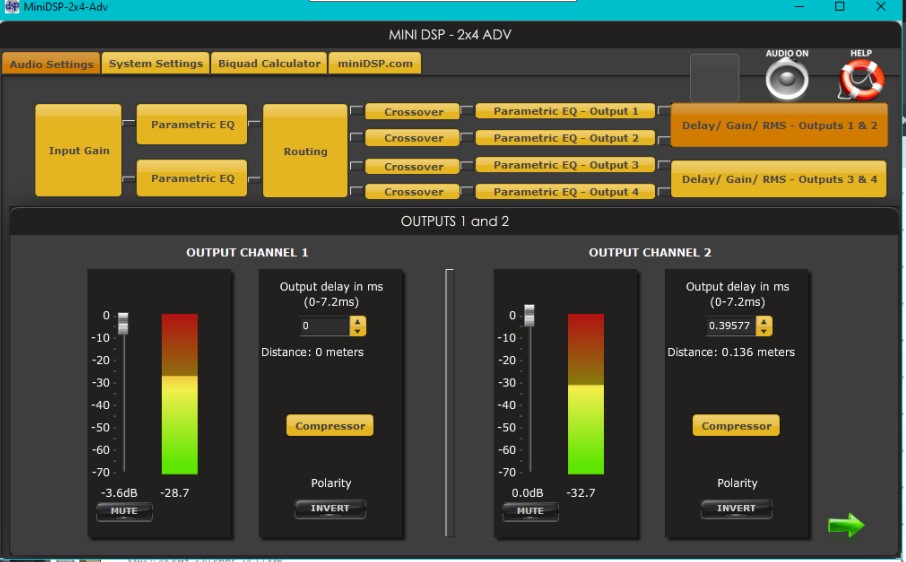

I tried to set up the system with the Harsch crossover. Each step of the minidsp has confused me, then it sinks in after a while. I looked at ur link and did my best but the whole time wasn't sure if what I was doing was right. Anyway I took a couple of dozen readings from about 0.7 to 0.3 ms output delay on the tweeter with it inverted. No matter what u type in, the software defaults to a preset number but they are all approximately 1/100 second apart. It seemed that 0.39577ms was a bit lower at x-o point than all the others so I left it there. Then started listening to music again. It's all subjective but it seems that the lower-mid bass is cleaner now. And the imaging/staging is remarkably better. Or I drank too much moonshine. The Lincoln Center Jazz Orchestra filled the room and I could pick out all the individual instruments. On a Stanley Clarke studio recording people were spread out way wider than the speakers themselves, the band was cooking, and at the end a voice commented on the great performance- and it came from behind me! Made me jump a little. But I was so happy after the experience I could only grin and agree. Here are acouple of screen grabs of my settings; let me know if something seems off. Thanks X!

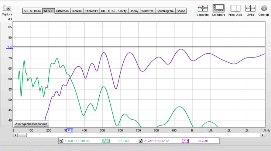

Nice work Bonjonno. Did you ever get a microphone? Please show your measured crossover plot. Woofer only, tweeter only, and combined. Despite setting the electrical crossover at 500Hz, the electro acoustic crossover (where the microphone measures as crossing) is the true crossover point that matters. If it is 500Hz, the time period for that is 1/500Hz or 2millisecond. Take half of that and the delay should be 1millisecond. However, your tweeter is already set back because it is in the horn throat. The other delay assumes they are on flat baffle. Hence, your 0.39ms might be perfect.
The way to check is look at the measured response. A correct Harsch will show the combined response to have a slight dip (<1dB) in the bass right under the XO point. And the step response will show a right triangle on top of a “hill” or “bread loaf”.

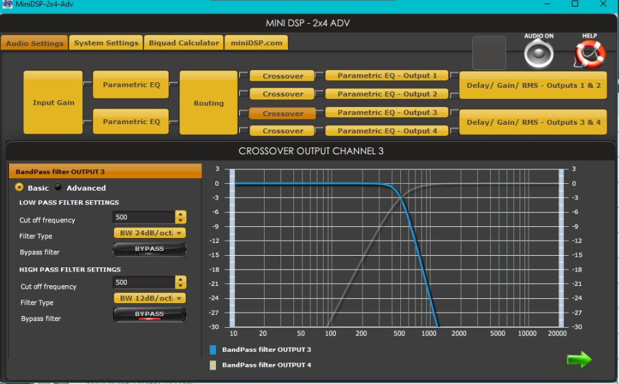

I need to take a break. No matter what I try I keep getting similar results that don't appear anything like yours. The way it's currently setup with the XO point to be 500, the graphs I get show a XO point of 318Hz or so. If I raise the XO point in mini dsp as high as 1000Hz, the graph still shows the XO at ~ 345Hz. and the rest of the reponse looks terribly ragged, yet it sounds good. Even tho the mic is calibrated, the only way to get it into my laptop is thru a digital mixer, out of its headphone jack and into the laptop's mic input and thru its soundcard. I think there's something ugly going on along the way...
You maybe too far from the speaker. Take the measurement at 0.5m and use frequency dependent window (FDW) 6 cycles. This will remove effects of external reflections.
So first thing before imposing filters for LP or HP is to apply PEQ gently (broad Q and only -gain) to flatten the response.
Then apply the electrical filter to achieve a measured -24dB/oct slope in the woofer and -18dB/oct Bessel on the high pass.

OK. Thank you for bearing with me. I had been measuring from one meter so I moved the mic closer. I have always been using FDW. 6 cycles means take 6 readings? When I take multiple readings they all look exactly the same. I imported gentle PEQ filters, all minus gain. Now the crossover may be where I'm screwing up. I thought I could just choose a type and amount in minidsp, but the resulting frequency response looks nothing like what I desire (nothing like ur graph) Do I have to keep trying combinations in minidsp until the resulting measurement looks like what I want?
The actual response is a combination of the electrical filter and the driver’s response to that filter. Hence, why the method I outlined earlier is the only way to do efficiently. It basically lets you simulate the response before you upload it. I know, it’s a complicated process. Takes hours and hours and hundreds of measurements. People who don’t do this don’t realize how much work is on involved for a good textbook response XO.
