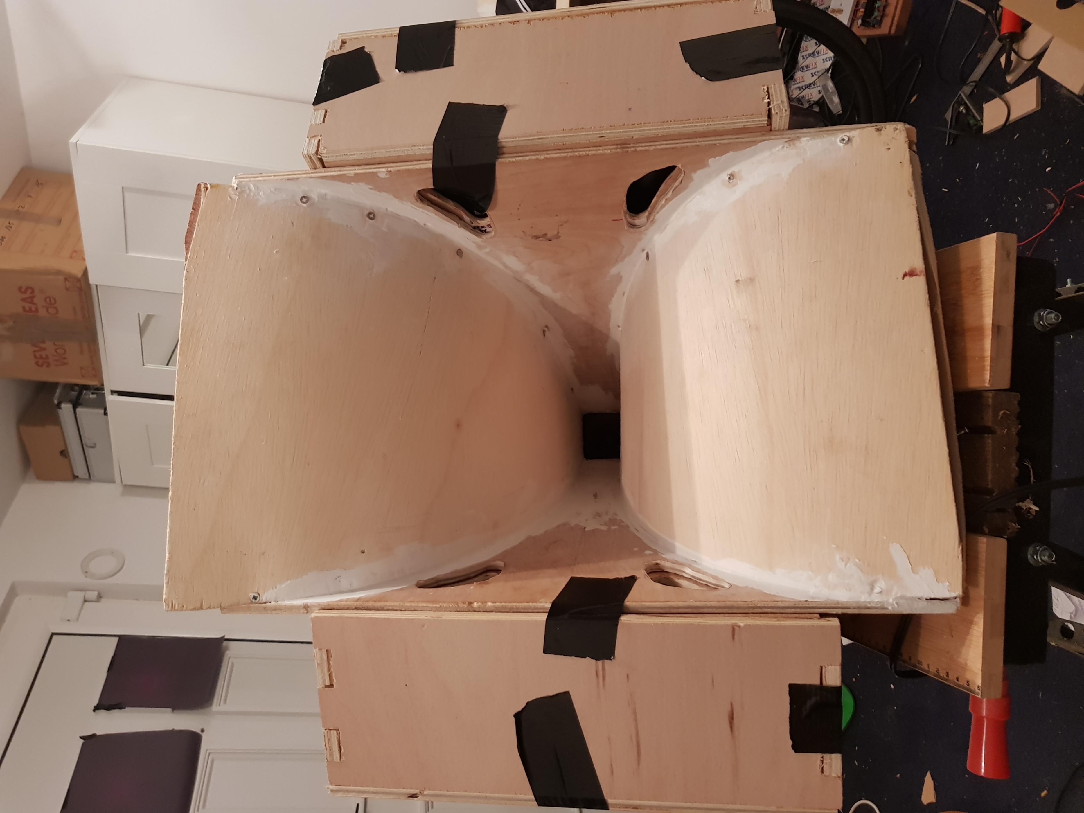

Sorry to resurrect such an old thread, but I wanted to show my appreciation and respect to XRK as the designer of the Trynergy.

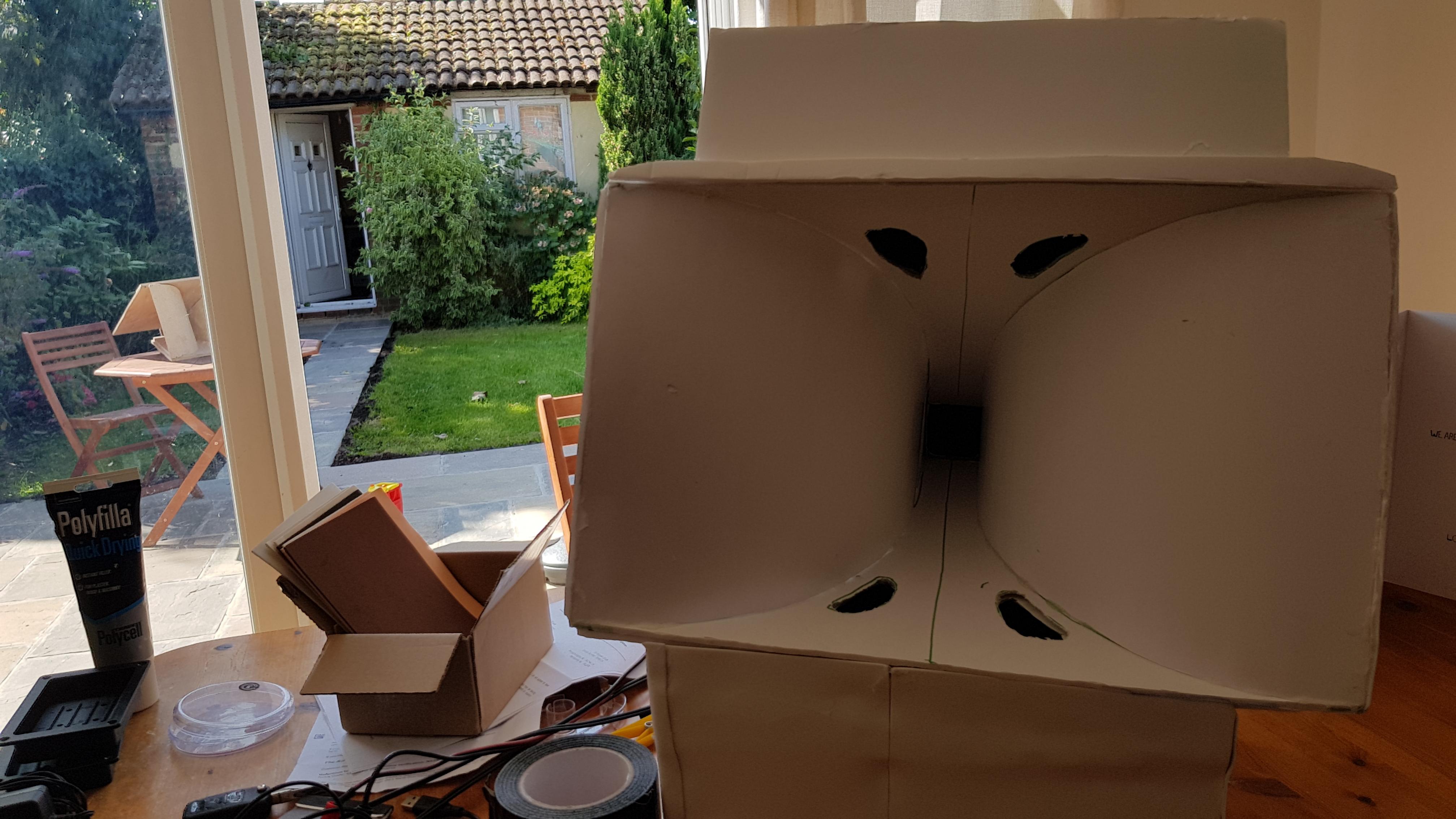

I knocked up a pair in foam core a few months ago and they sounded so good that I immediately started a build in ply. They are now complete (after a fashion, my woodworking skills are not great).
They sound incredible already, with a lot of work still to go on dsp and amplification (I don't yet have measuring equipment).
The amateur look and lack of data prevents me posting a full build thread, but I wanted to say how much I appreciate the hard work that went into the design. They are truly great speakers, thankyou for sharing. Also thanks to others from here (Kees, Patrick Bateman, Bwaslo and many others) who helped inspire me on my own journey, or simply provided incredible expertise, experience, interesting arguments, questions, theories and ideas along the way.

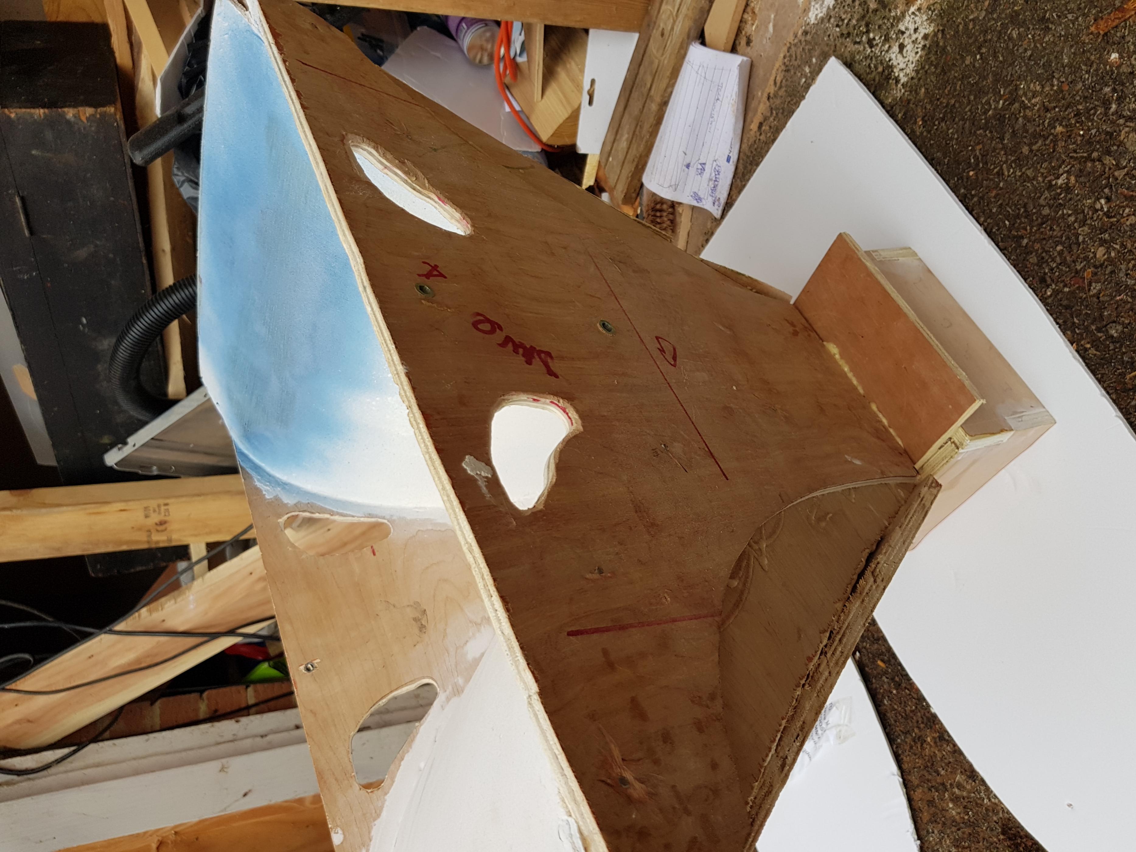

I realised there's no photo of the almost finished speakers:
indeed, making them was far beyond my woodworking skills when I started - much actual blood, sweat and tears included in the finished speaker.

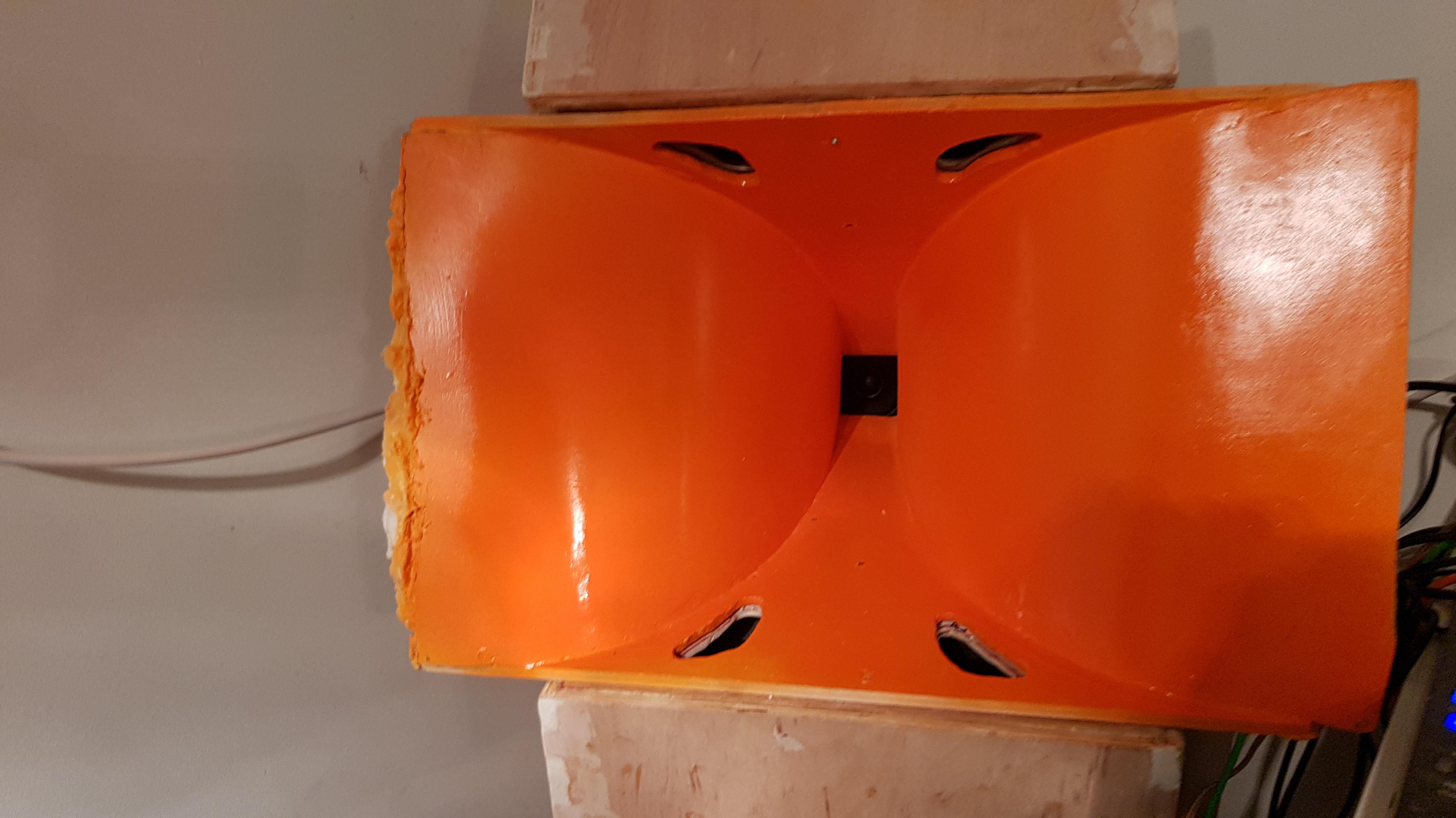

The interesting spiky finish on the left is where I used rather too much expanding foam to reduce resonance in the bendy plywood horn walls. It worked well, but i've only done one so far.
Good idea to use expanding foam. The orange color looks great, btw.

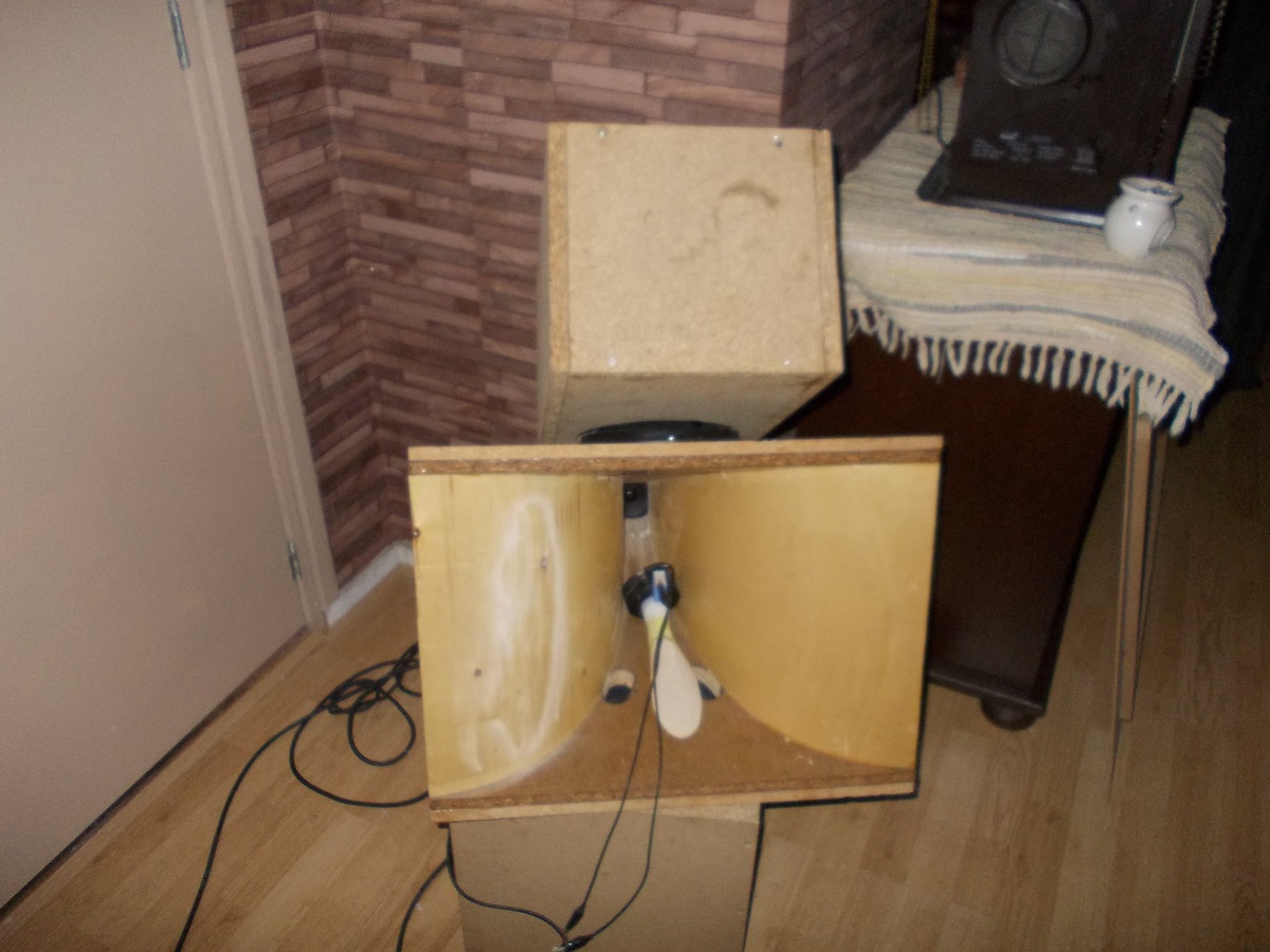

Looks a little like mine, but because of trouble in mine live, just not yet time to start going on, but I am almost ready with these troubles, yes X you now😀 and hope I can get peace now.
Looks nice that horn, I did make some clamps and make the horn flare with it by pressing some sheets of 3 mm thick with glue.
regards
thanks Kees. Actually many layers of filler and primer disguise an awful lot of bad workmanship underneath. I would do almost everything differently if i remade them now.

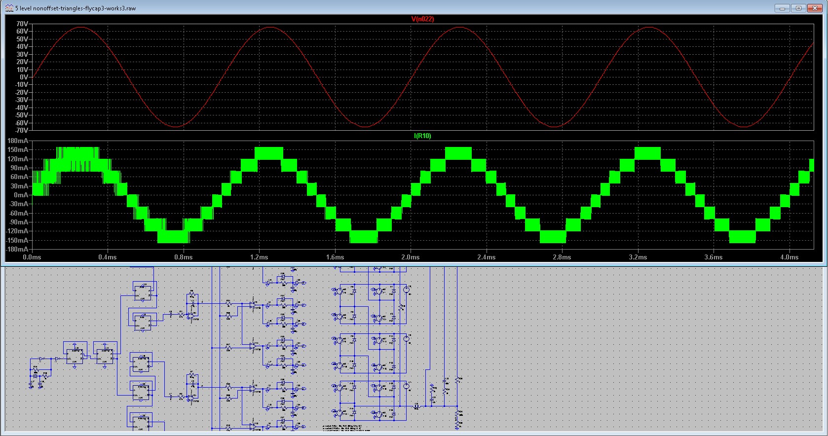

8 level class d maybe, high bandwith, even open loop, but now busy with circlotron, do well with autobias, sometimes timeout an some simulation of class D multilevel, super high power, 8 x carrier frequency, s0 200 Khz get,s 1.6 Mhz!! on output, just curious, I think 5 level is best for simpleness.
