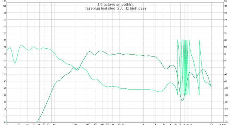

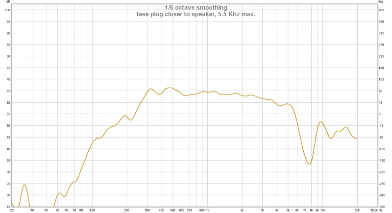

Hi all

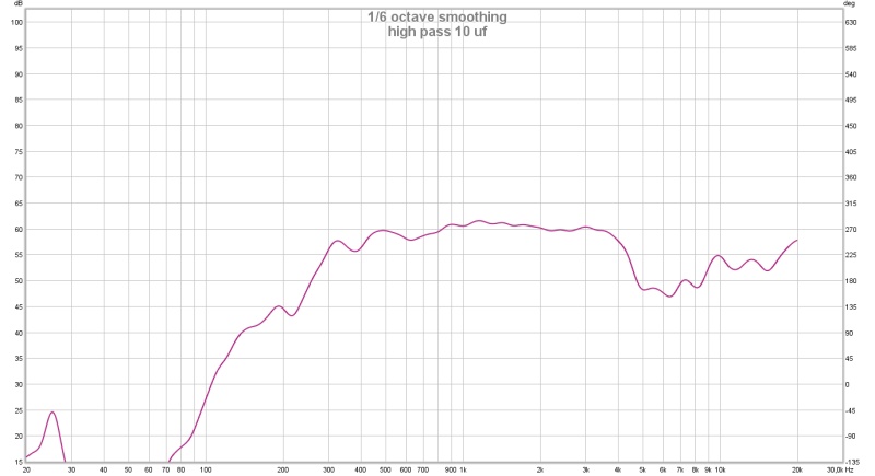

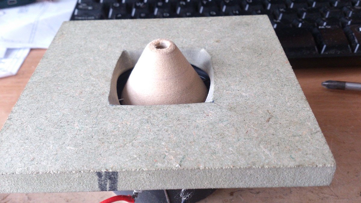

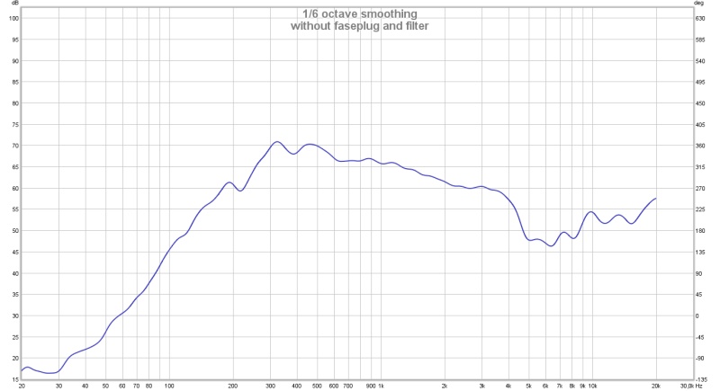

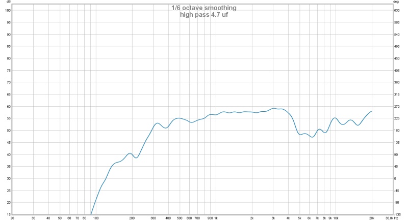

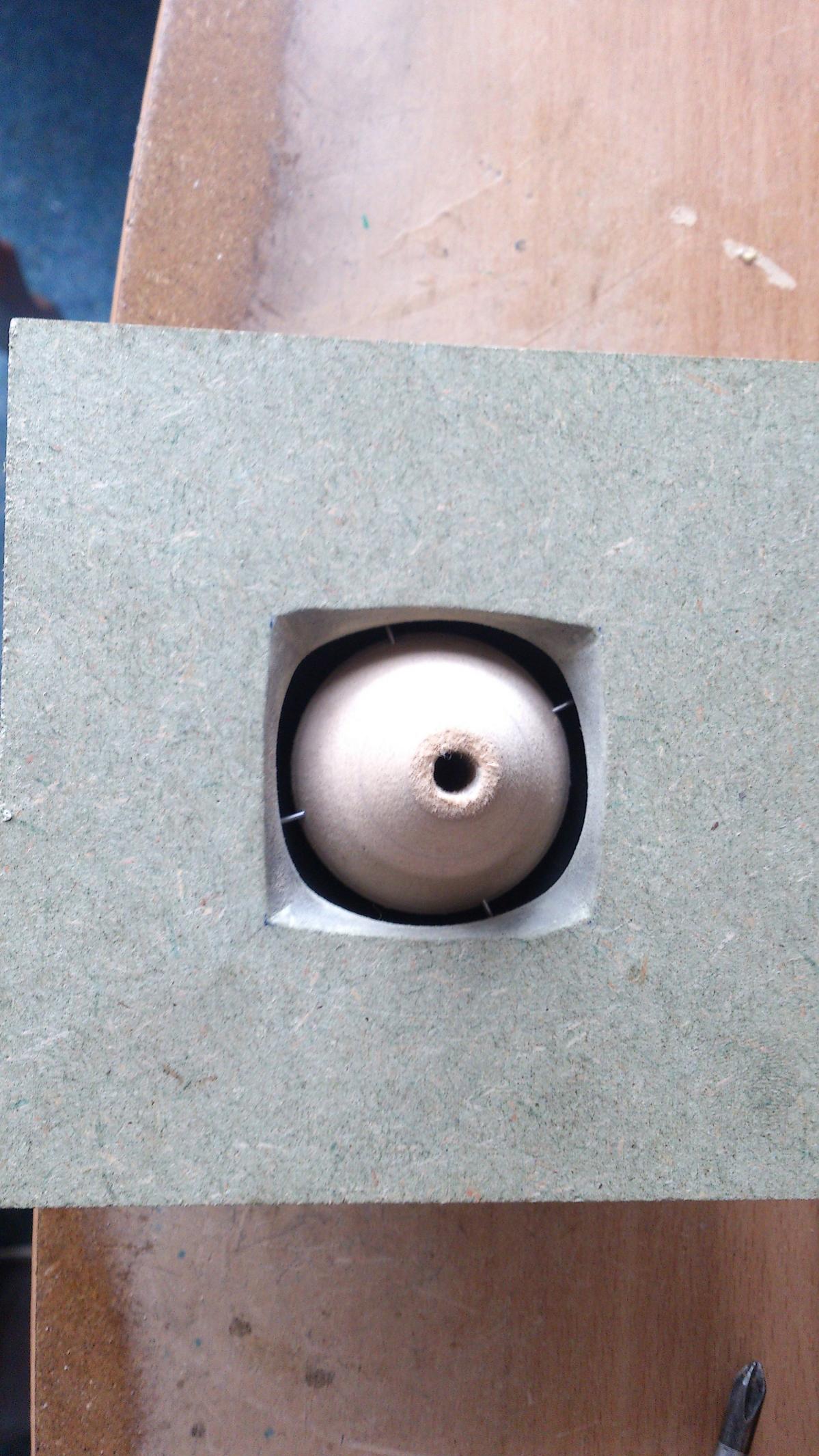

I have started agein the horn project, I have done some experients with faseplugs and adapter plates, however above 3 a 3.5 khz things get canceled, using a correction is in my eyes not right for the sound, so I start a nea approach like A K-tube and a compression driver from BMS, I think this wil go nice and efficienty is quite high, a high pass filter for correction to the end of HF lower that considerably and so then I can just listen to a direct radiation version speaker system.
here some measuremens after making a adaptor for the horn. Now I have a wood lathe this is quite easy.
regards

Thanks for the update. I think this confirms my earlier belief that using a stiff cone driver with a more powerful motor and no phase plugs with a smooth throat is the answer as shown in Bookshelf horn thread. The SB25WBAC25-4 seems to work very well for this application.
I think a faseplug with a good stiff cone can be used fine, look at HF when it get to much compression and so big peaks.
But the visaton did very well to 5 Khz, so I am happy with it and start part two, the BMS compression driver K-tube injector

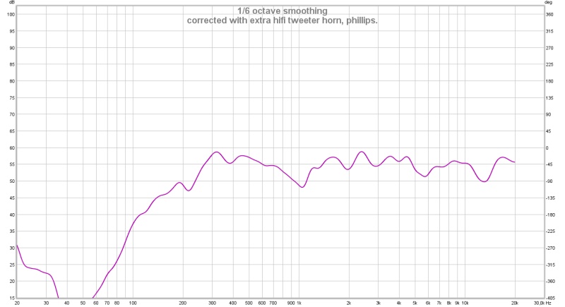

Did you use also the correcttion for the cone speaker in the horn itselfs? these are then cut down 10 a 12 dB for correction.
I have do not, I have full efficienty to 3.5 Khz, with a faseplug.
in picture tractrix wideband in throat is damped 12 dB for the tweeter horn in it who is 92 dB watt. measurement is some wild because of room impact.
regards

I calculated the horn with Hornresp. I don't like the highs from the mid speaker, so for me is not a problem that it doesn't go higher than 2600Hz. Recently i upgraded my tweeter to Seas 27TDC and i can cross them 2nd order at 2600Hz, so mating mid+high is pretty good at this moment.
