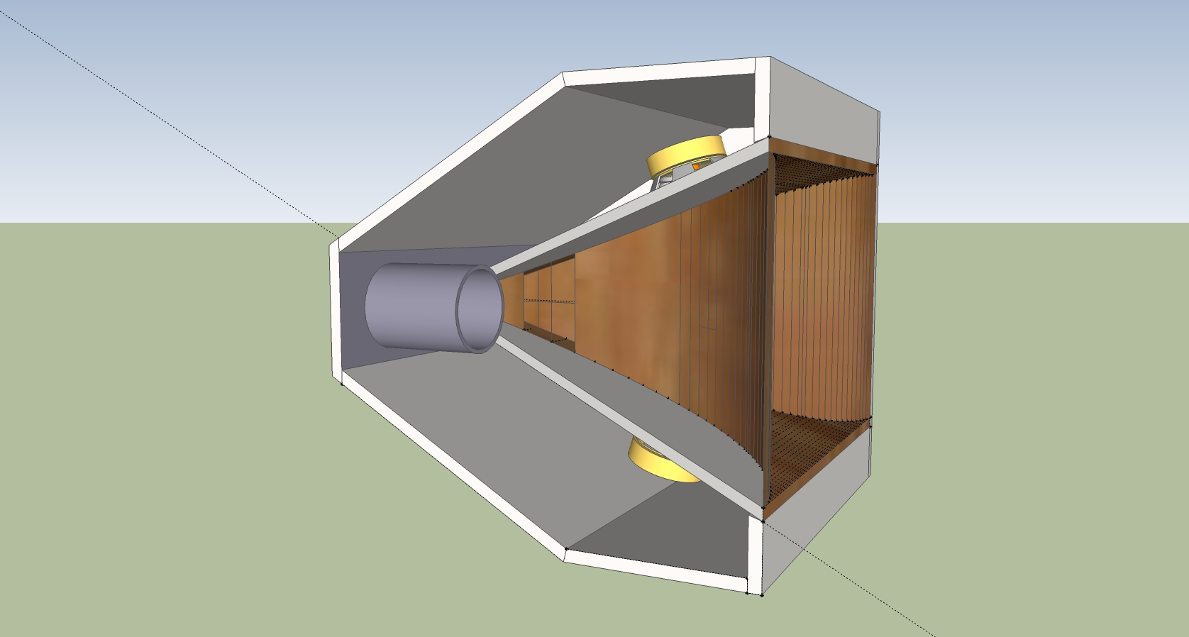

Presenting the Trynergy - a full range tractrix synergy.
I calculated the horn with Hornresp. I don't like the highs from the mid speaker, so for me is not a problem that it doesn't go higher than 2600Hz. Recently i upgraded my tweeter to Seas 27TDC and i can cross them 2nd order at 2600Hz, so mating mid+high is pretty good at this moment.

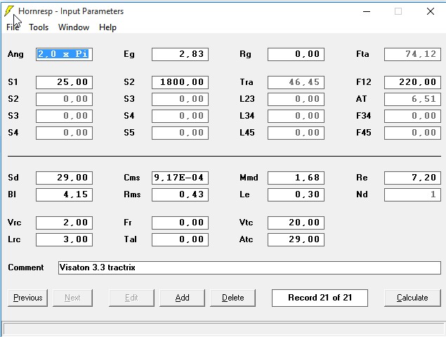

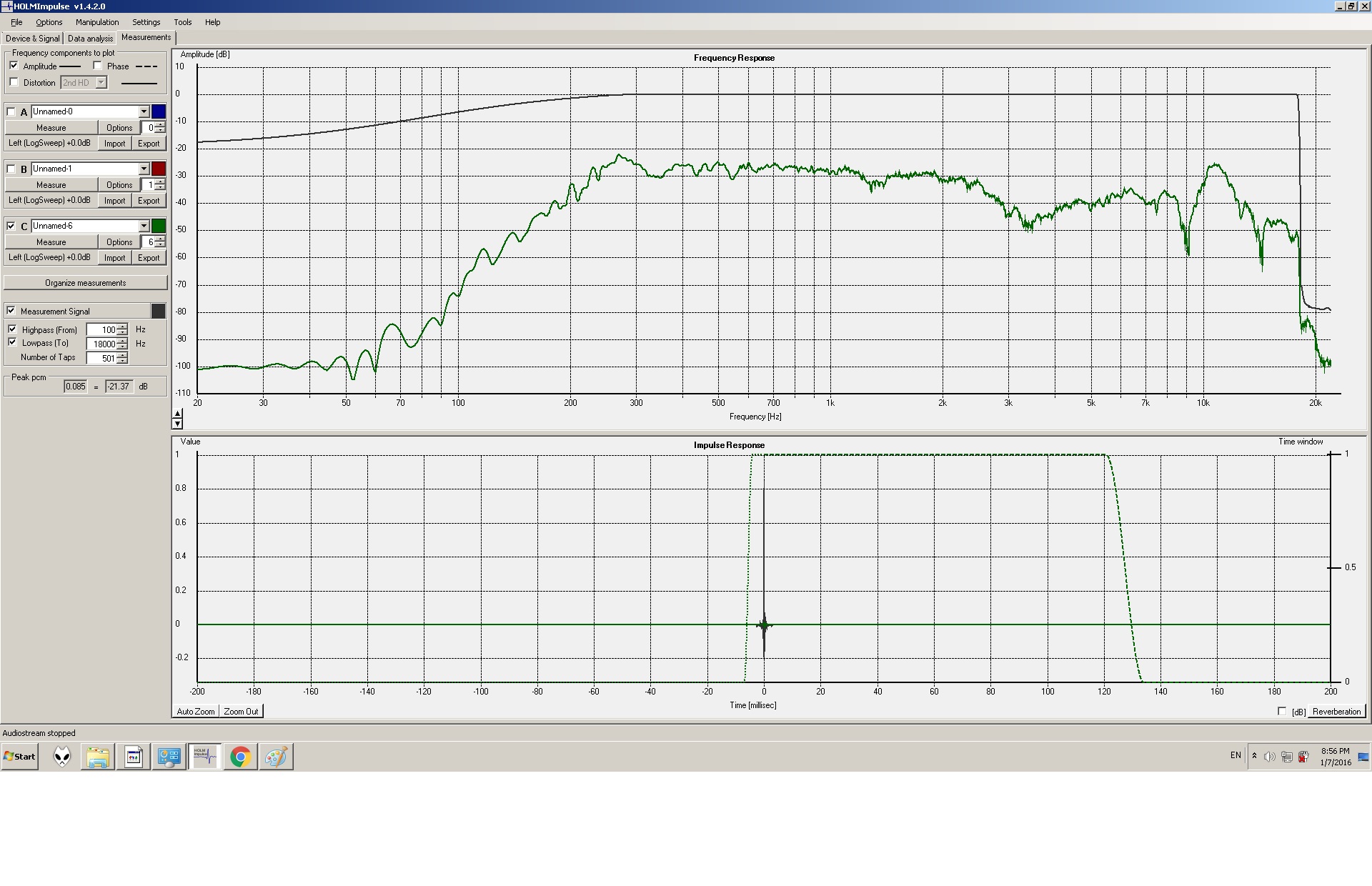

Hello kees, i don't have the actual input file for Hornresp, but i found the export for horn cuts and a model of the curved side. Also inserted the measured response. The driver is Visaton FRS8-M
Also some details:
1800cm2 mouth
25cm2 throat
220hz tractrix Fc
46.45cm axial length
Hope it helps..

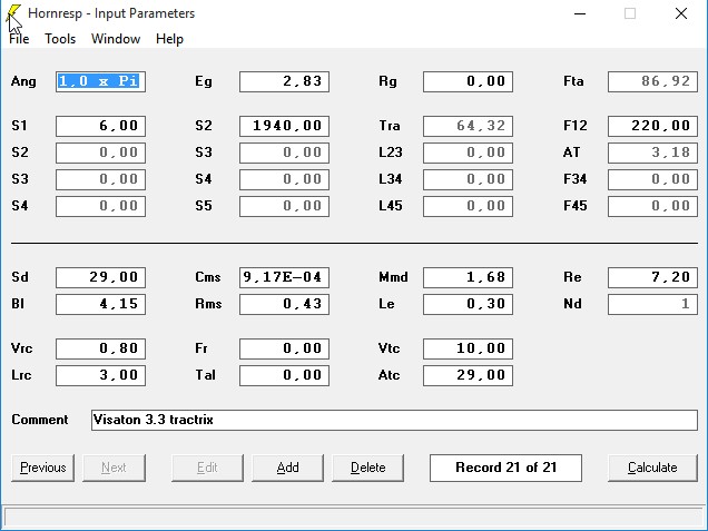

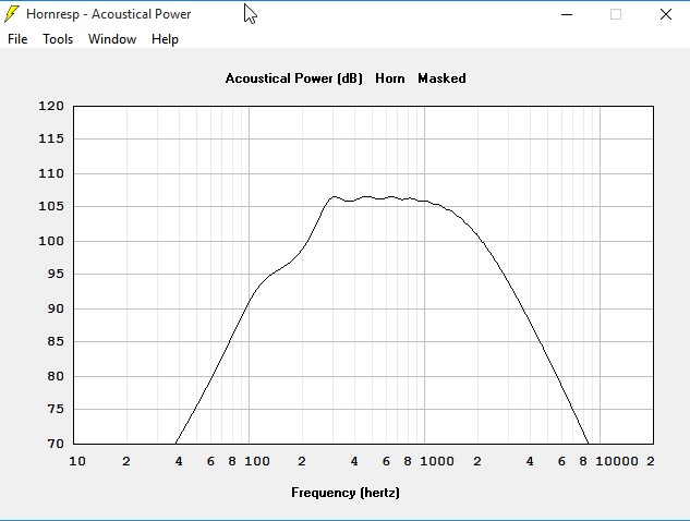

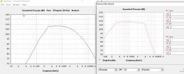

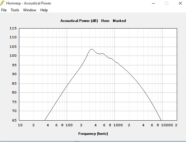

I have found the way hornresp do tractrix but I can not see how far it do go, for hornresp it fall of around 1 khz or so.
I have put in your data and did get the right hornresp length.
But as you see in hornresp HF is not so wel predicted, Did hear dat hornresp is not so well with HF output?
regards

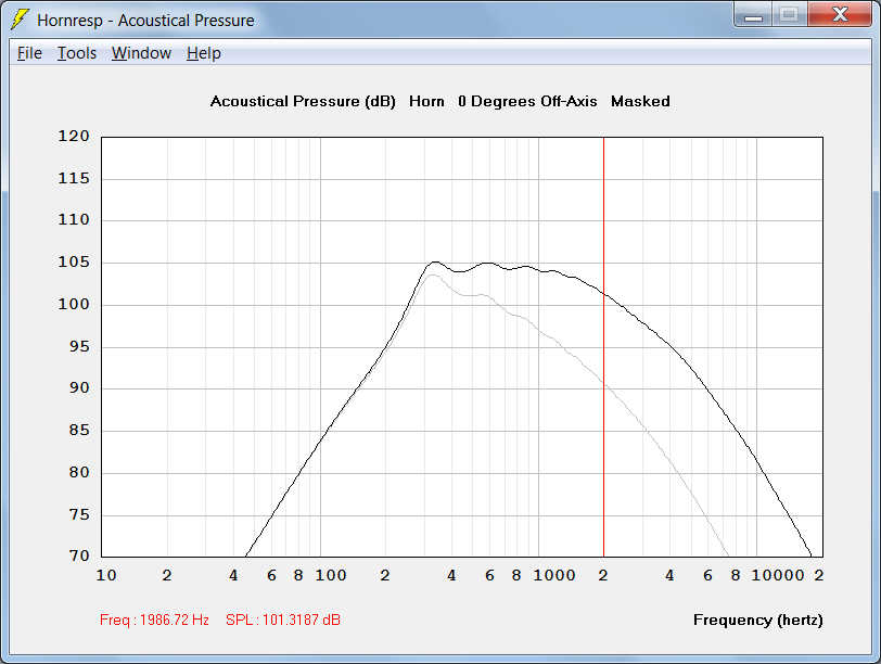

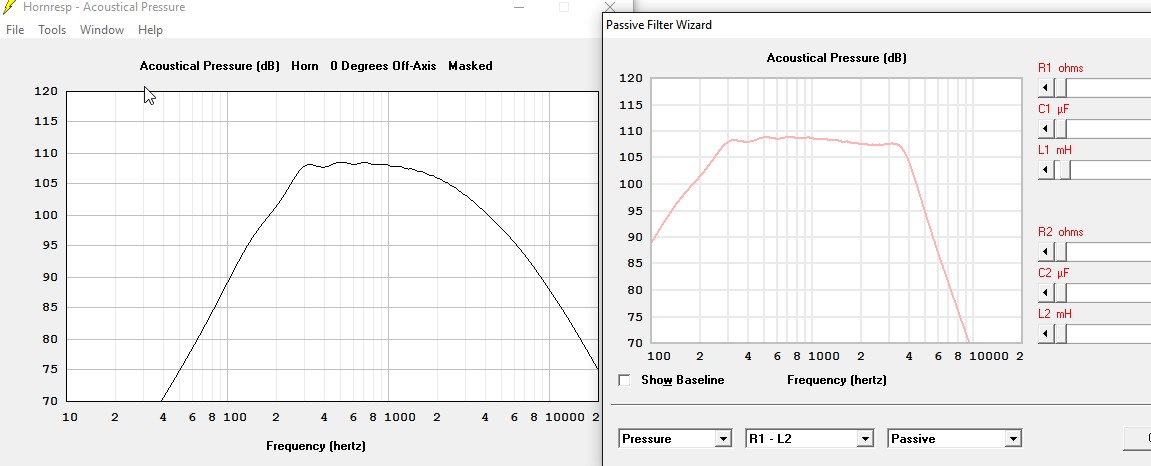

Try it out, made Vtc small because I go use a faseplug in the horn to prevent beaming and get as high HF as possible.
Thanks for the advise your program is like tressure hunting, finding the gold.
Volvotreter has help me making his program have output for akabak so I can copy and past it, and now I see hornresp can also do it, or even akabak is less suitable for it!!.
I hear a constant directivity horn do work also good get wide respons?. But there are not much or no calculators for it.
If I want to export the tractrix with conic sidewalls like on picture, on a 1.6 basis how to do this?. I need to make a new horn because I have play already to much with this one.
regards and thanks for advice.
kees

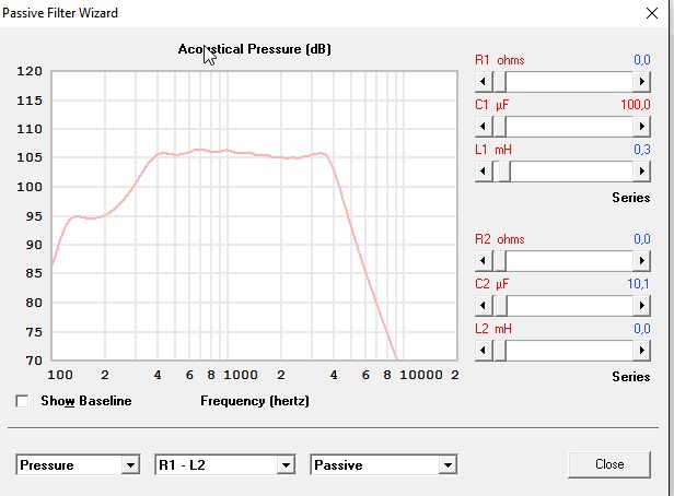

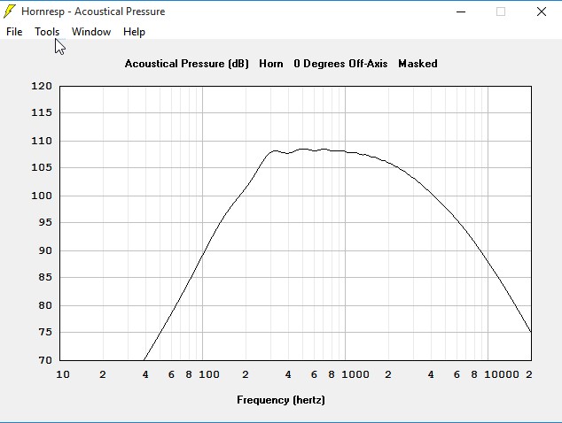

We can use a faseplug only for less beaming and some extention, for me 3.5 Khz is plenty and so do not need high compression plug.

Ihaver read some papers like the edgar mid horn, where it is shown that bigger throat give more extention in HF, while hornresp give a extentsion when make throat smaller, and so more compression, little confusion here.
A 2:1 horn and a throat equal to speaker sd give that, I did try but hornresp his meaning is different, I think it is what driver is used.
I like the idea of using foam between speaker and horn to damp resonances and remove horn like sound.
regards
