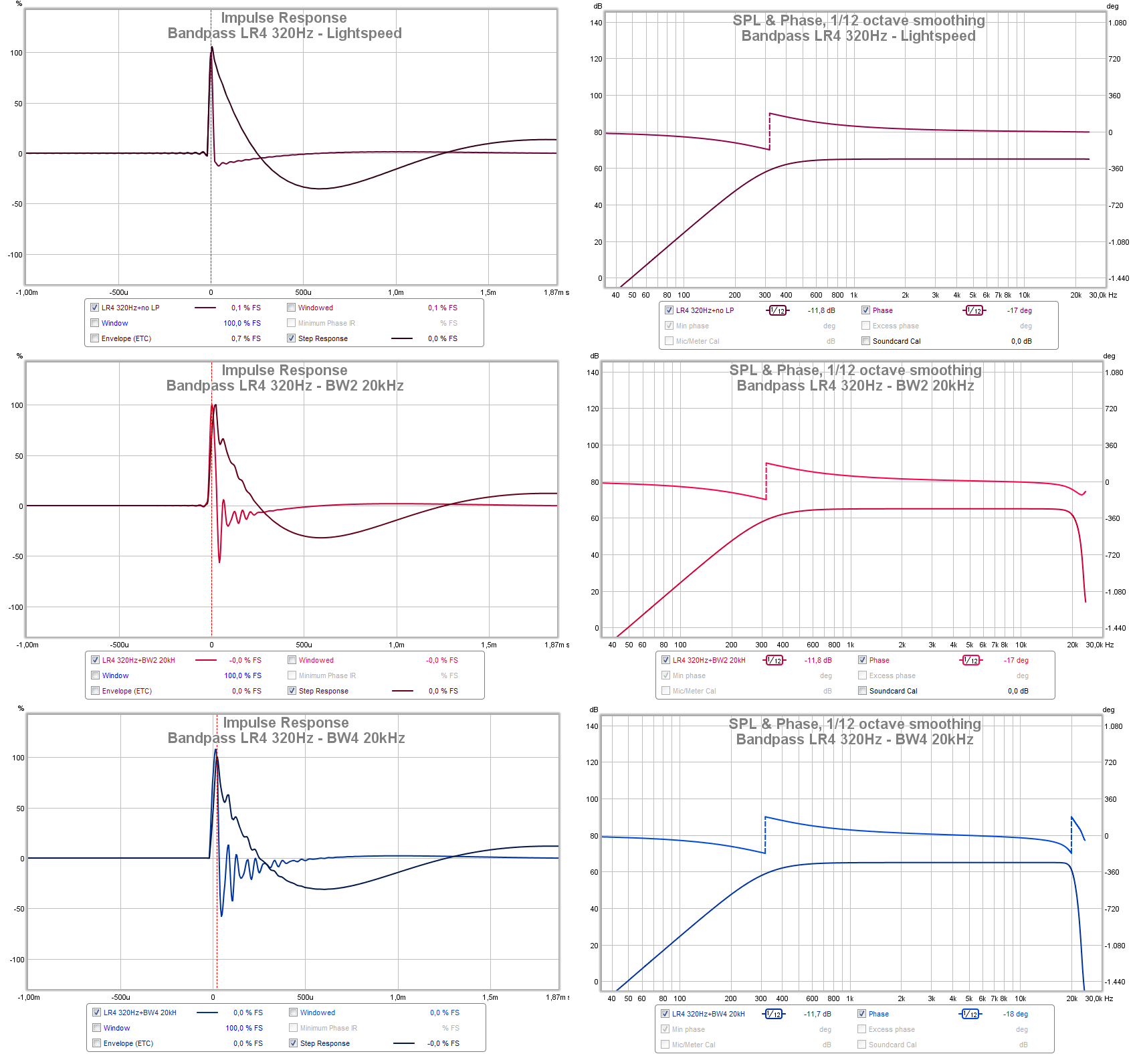

..... it appears all that hash and ringing is strictly a function of the bandwidth function of the speakers response. Very interesting.....
Yes that seems the reason see nice little bandpass study below.
All three plots have high pass LR4 320Hz set but first have no low pass bandwidth set so its light speed : ) second and third have 20kHz low pass as BW2 and BW4. For my slow brain these live studies are good to confirm if IR/SR in acoustic domain really should have all that ringing that > 1.order filters usually bring in.

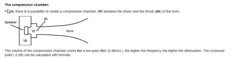

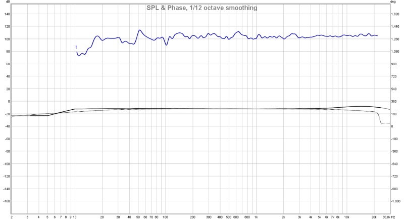

Wel I have done the mic amp, and can go on.
Why the 6 dB filter did work with me you can read here, the compression chamber on throat is a 6 dB low pass filter, so we need for shure to make it very small, so it is now it will give as much distortion as with a normal box when need so much correction.
regards
kees

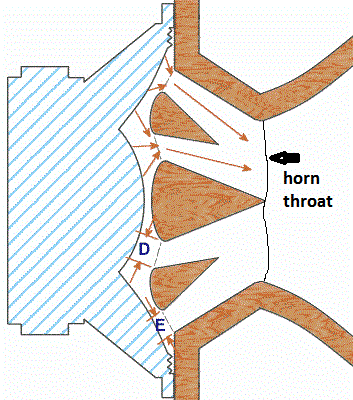

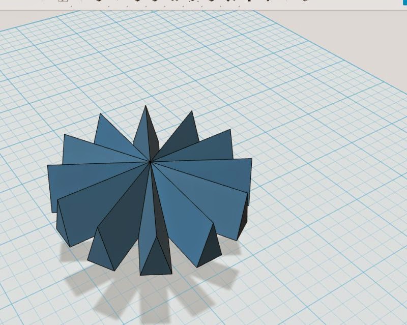

This fase plug design, I ask myself how to implement because I can not put a plug in the throat itself because it need keep the way it is, so I think (see picture) that I ned a extention beyond the throat like in the drawn befor the line I did drawn in .
Or picture two is also a idea you did mention earlyer.
regards

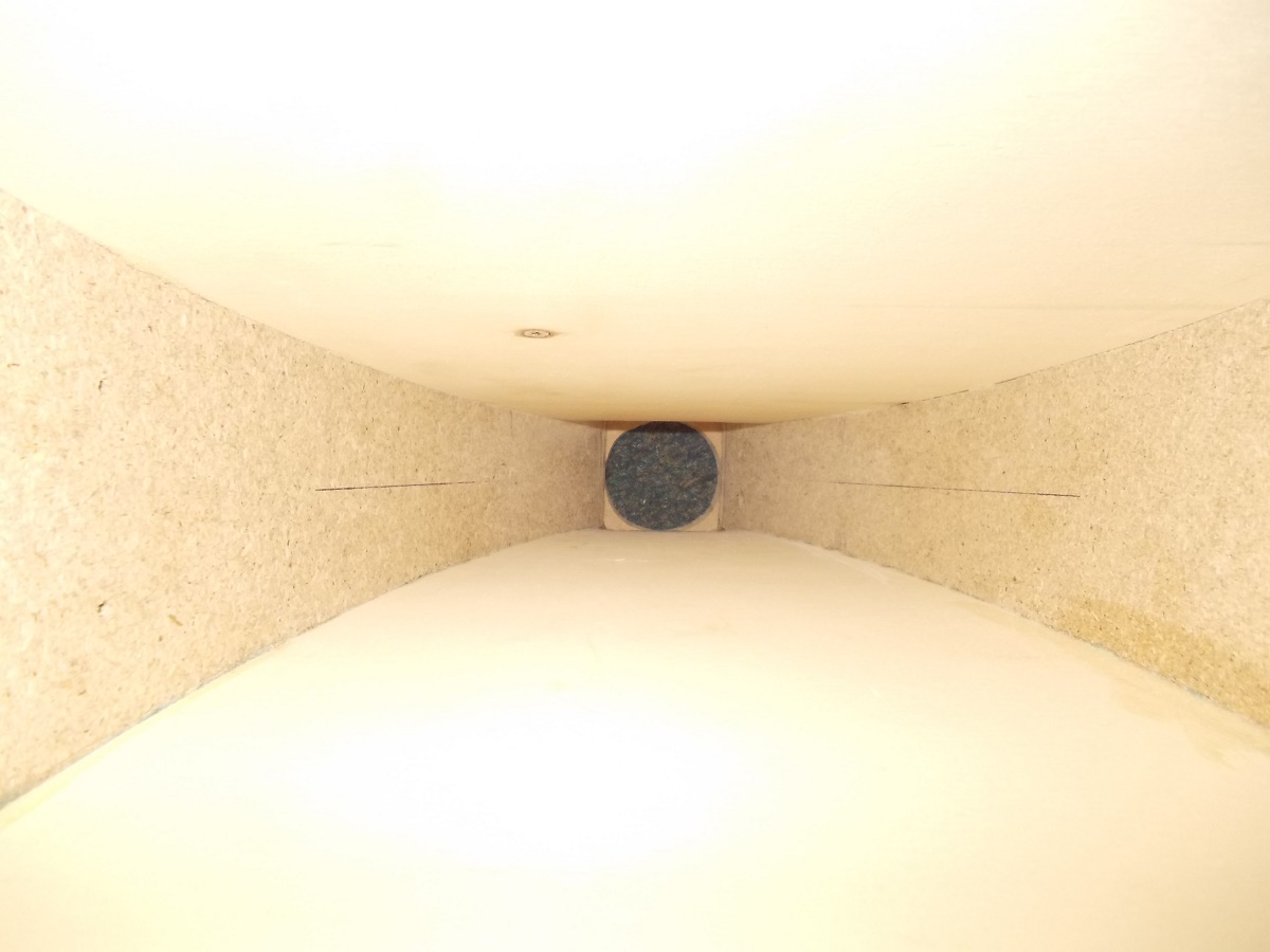

I go with the ports if I am ready with the horn throat solution, I go use plastic to made it, I put a extra square baffle and from there I go make it, so I keep the throat dimensions and the horn length intact.

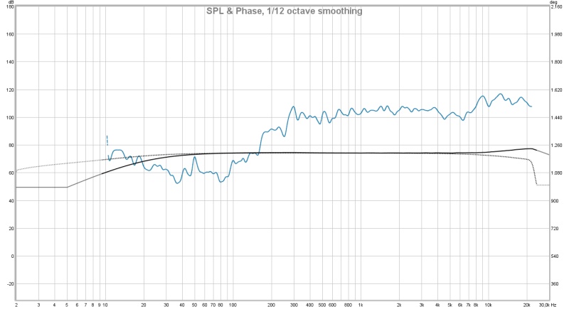

Doing this and a small faseplug did up the high..
regards
Looks nice 🙂 a shelf filter could correct the upped highs and system bandwidth HF low cut slope probably better with this small phaseplug, dips have changed now moved to 4,5kHz and 6,5kHz compared to post 600 FR, but okay you have got better microphone setup since that so probably it makes a difference too.
regards
Can you show photo of the phase plug please? That is good that you don't have a major dip. Although SPL went up above 4.5k, that it makes overall response not flat is not so good. Maybe you were just fine before? Look at phase in response - set gate to something short like 4ms and set mic 0.5m away. If phase is smoother vs no phase plug then a good thing because imaging and transients will be better. Please plot data with at most 10dB per major vertical division.

More sens from the bare speaker gives more headroom. Even if the response looked better before the phaseplug, I´d stick with the higher sense version (only if no further problems are introduced with the phaseplug, of course).. Some rise in the frequency can easily be dealt with afterwards with the x-over.
Watch the compression ratio - you shouldn´t run into problems with a small midrange driver, but better check than to fry cones 🙂
