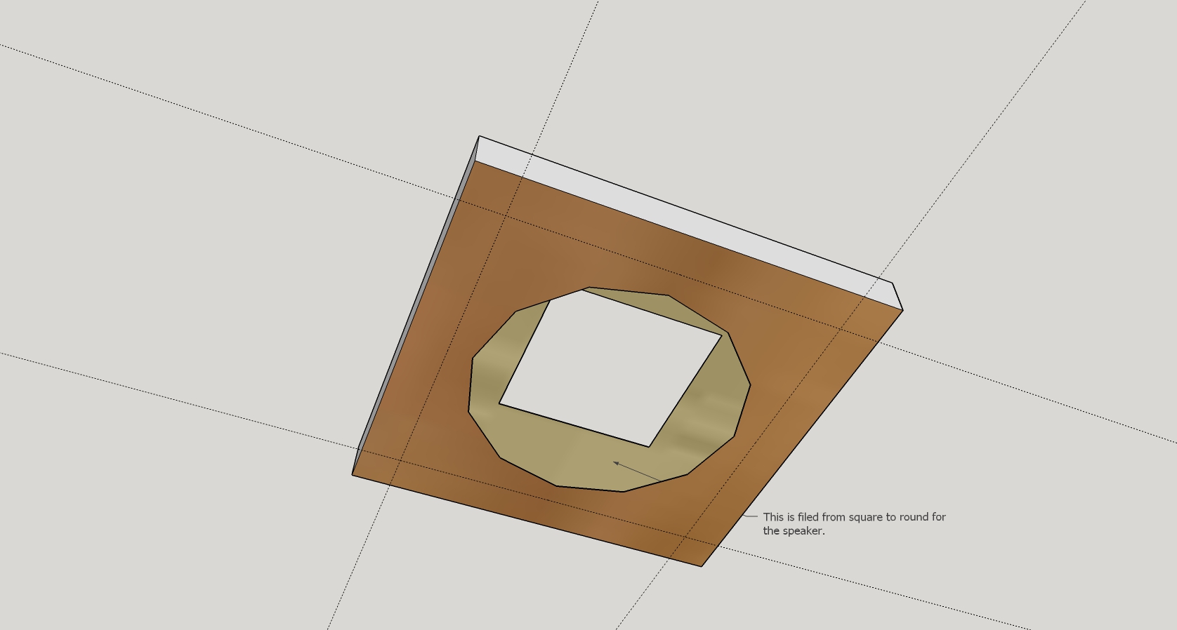

With wood it did, my horn has also can be a horn with round throat filed in square. But that is more problematic to make, need file it round to square like you see on other designs.

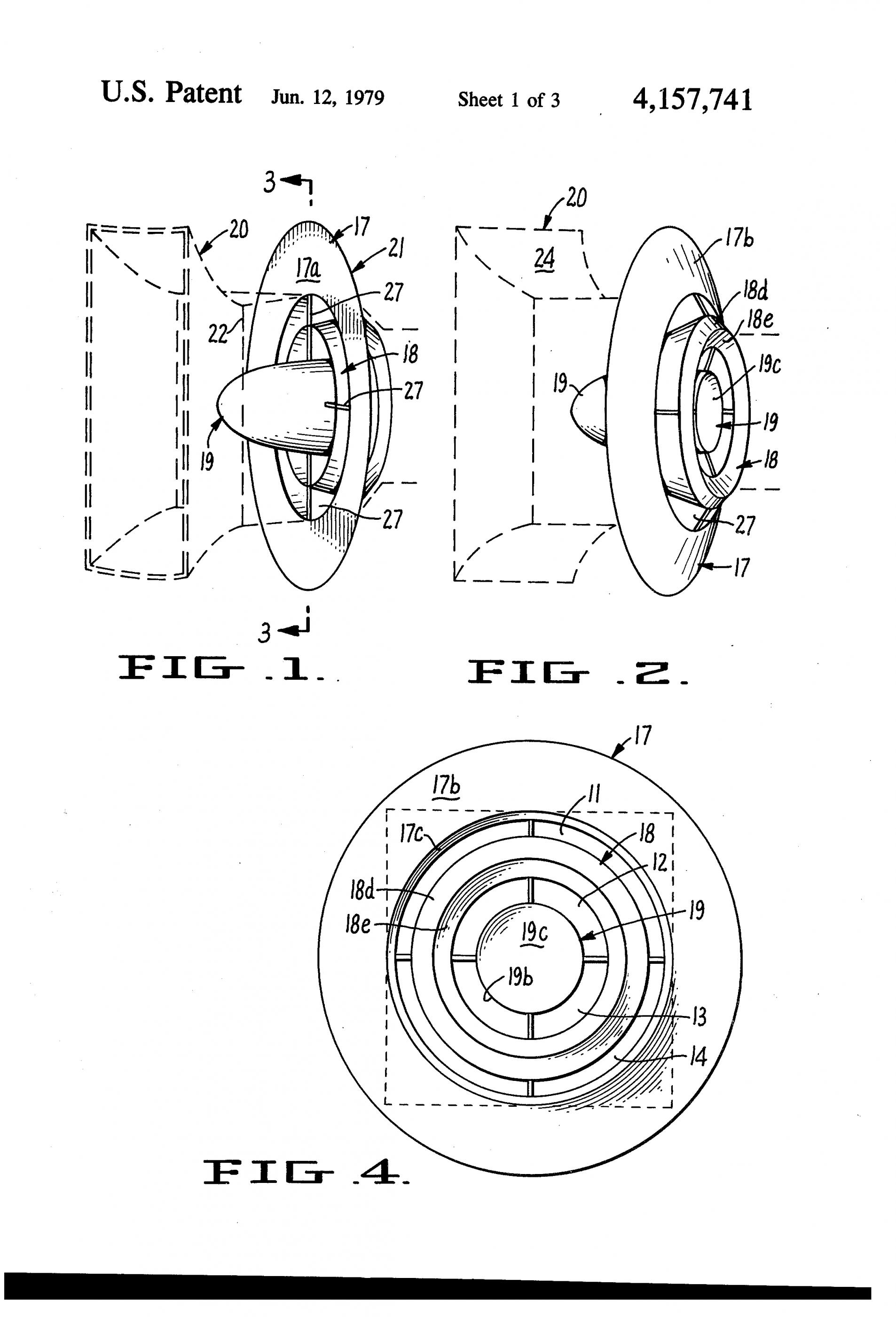

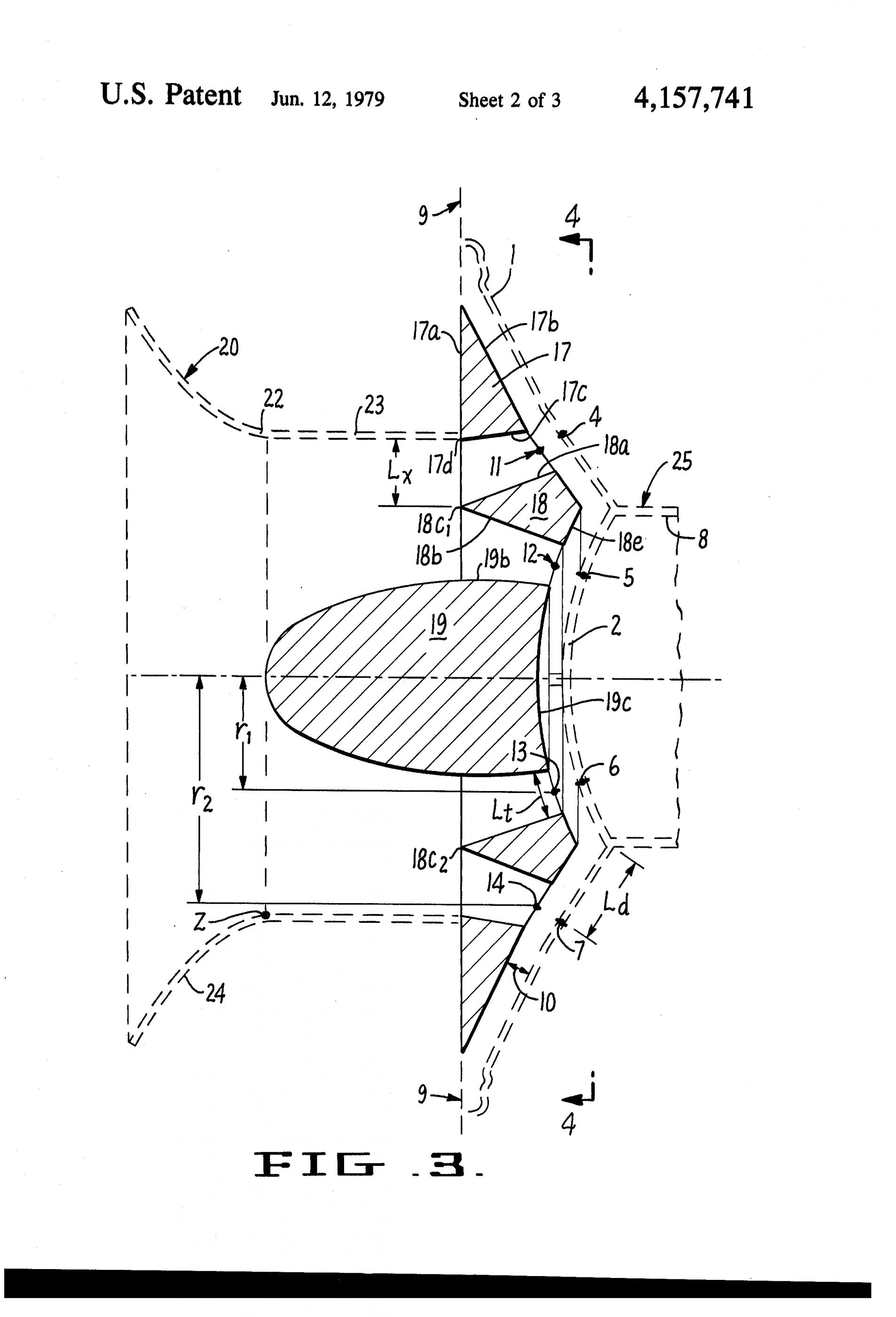

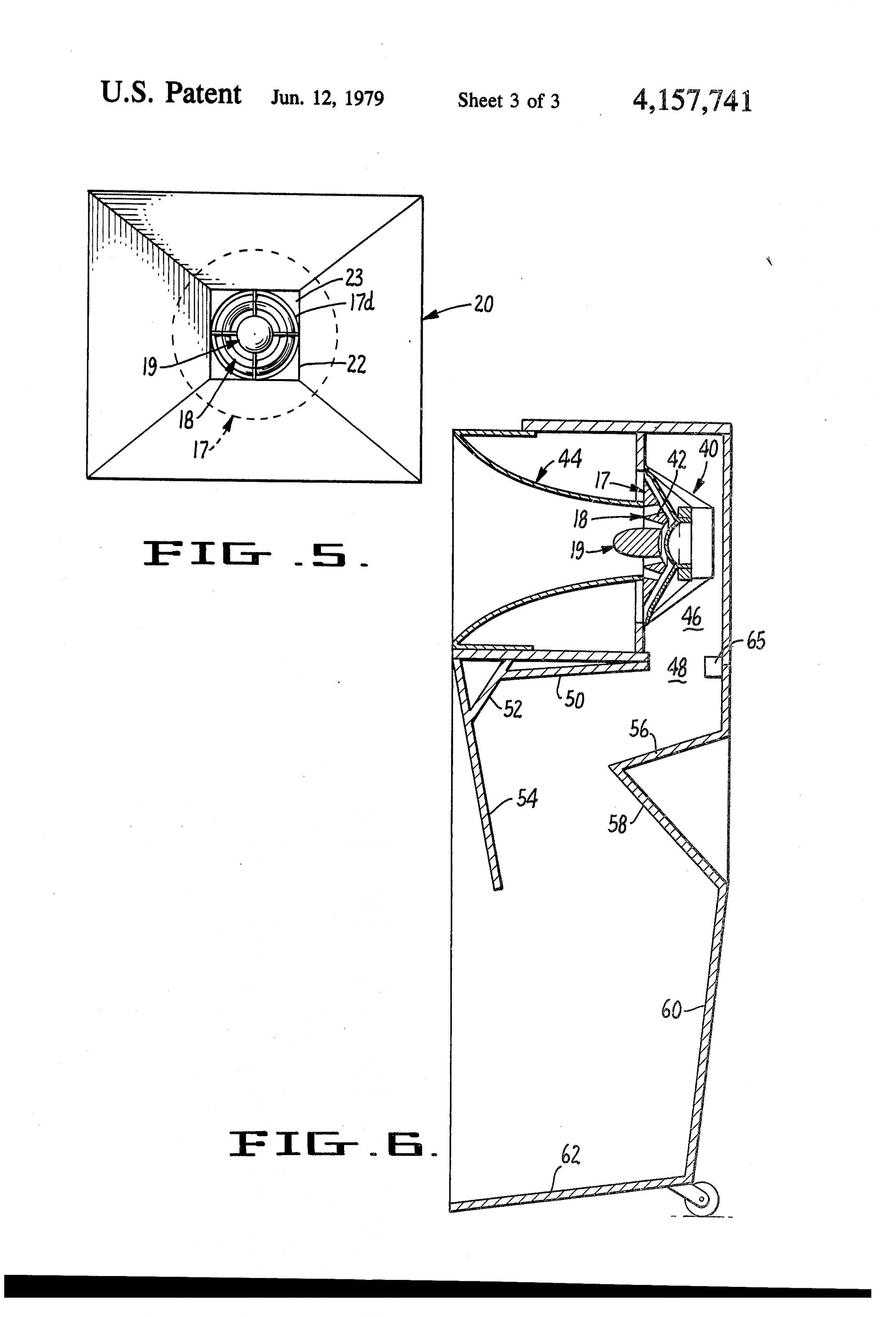

A tangerine style phase plug on the front of the full range driver at tractrix throat will help to smooth the smalll ripples and dips in the higher frequencies and possibly increase sensitivity in HF's so you would need less low freq shelf filter cut.
Use this example from Altec for inspiration:
There is a whole website somewhere that describes a lot of different DIY phase plugs. It's in my 5MR450NDY thread somewhere.

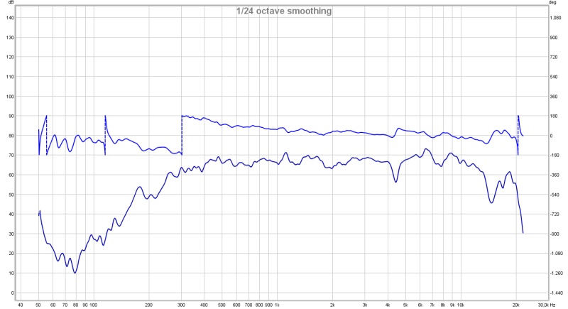

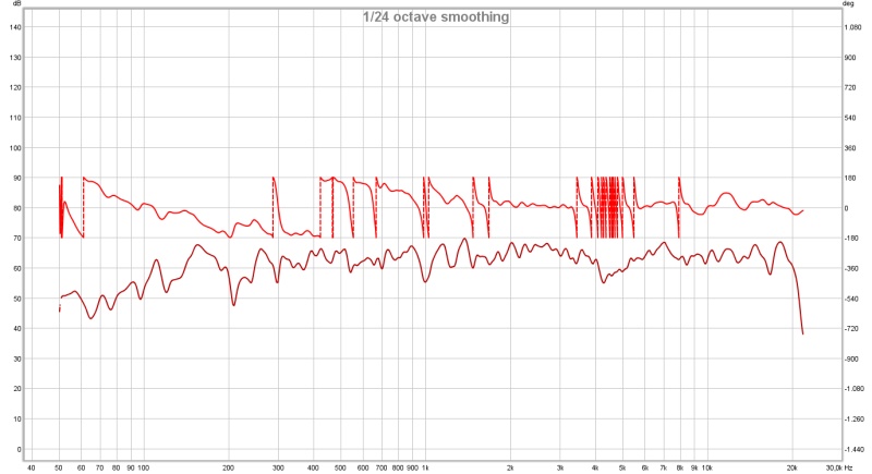

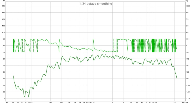

When using a simple 6 dB high pass filter do also work as a shelf filter making a good respons, see the picture, no shelf in amp but just crossover 3 khz high pass.
regards

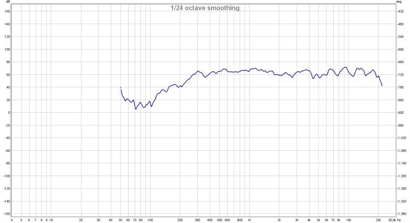

Good job! Could you please post the figure with a tighter scale, say 60 dB (20 to 80)? And include the phase response! Decreasing the frequency scale to 100-20000 Hz would also increase intelligibility.
/Anton
regards
That is an excellent result! Wow that is nice looking! Just your Visaton FR8 full range driver and a 3kHz -6dB/oct high pass filter resulted in this?
:cheers:
Can you please repost your data on 10dB divisions, from 40dB min to 100dB max? Or even better in 5dB vertical scales, and 10Hz to 20kHz horizontal scale like this for example:

Oke I have found faseplug ways on this site, you mean one of these, filling space give extensions oh HF. I did not see that in akabak? is it not there?
Phase Plugs
The horn has only a 6 dB high pas, just one 6.8 cap in series.
Phase Plugs
Yes, that is the website - you found it!
In Akabak all we can do is change the chamber volume for the bass driver - make it smaller to simulate having a volume filler.
Is that upstream before the amp or at speaker level connected to the driver itself? That is a fantastic trick to compensate for the large response at lower frequency with superb simplicity. I really like it.
It is connected on the driver as a simple 6 dB high pass, so between visaton and amp, removed the shelf in amp itsefs. It is a old trick and works fine, but need more tryouts, first I go make the mic amp ready so I can measure with line in, and calibrate the pc soundcard.

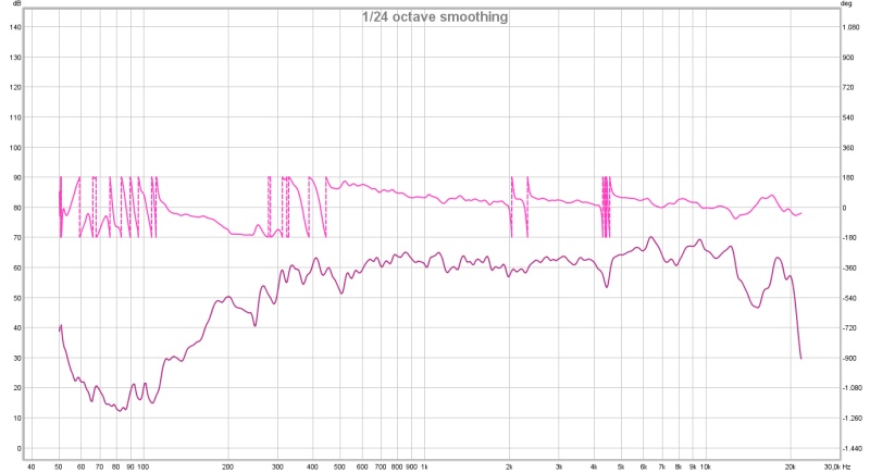

Thanks for making the scale more visible - now we can see how it performs and work on smoothing it out even more. You have cyclic dips which are probably cancellations from different parts of the cone cancelling out with itself, or it may be a non-ideal throat chamber and cross-section. The sharp dip at 1.3kHz corresponds to a half wave distance of 5.17cm or the cross-section of the throat. This means that sound waves from one extreme edge are cancelling with waves from the other edge. This is where a phase plug like the Tangerine style on a CD would help. Higher frequency cancellations are just harmonics of this fundamental one. You can really make this one not as big by not having a sharp edge on the throat. File it with a smooth radius into the driver diameter direction. It will make the dip a lot less sharp. Sharp deep dips like this are not as audible as a 12 dB peak at same frequency.
There is a lot changes when measure with different distances, like very close to one meter.
How did you measure? a lot of distance or close.
Last picture let see what I go try to do, with wood I can play with that, file it in speaker direction and make a faseplug for fill up that space.

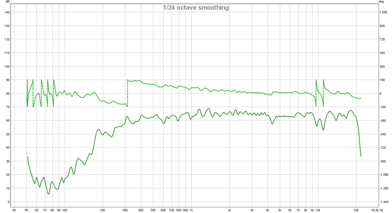

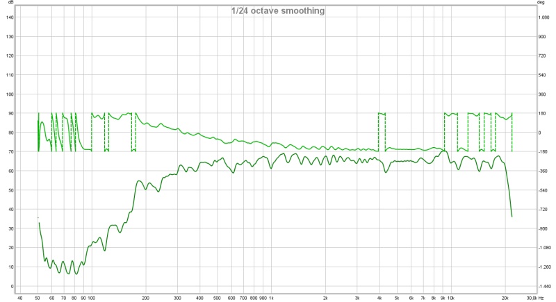

Filing the throat a little did change a lot.
I think a good faseplug is nice. How much air is need to go through? because ot small and it do not work, making one is difficult so i go try in hornresp.
Nice!!! 🙂
That was perhaps the best improvement I have seen from a file job! You are almost there - that is a great frequency response by the way. A 3d printer is what you need for the phase plug - and CAD software. You don't want to block it too much at the throat - maybe just 2 concentric rings with a tapered annular ring? I would just go with what you have now. You did an amazing job given no DSP or PEQ. Just a file and a 6.8uF cap!

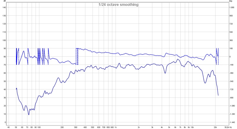

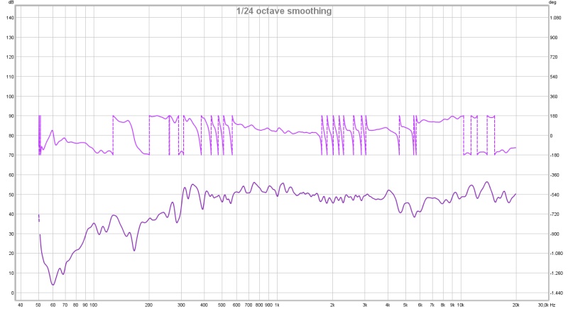

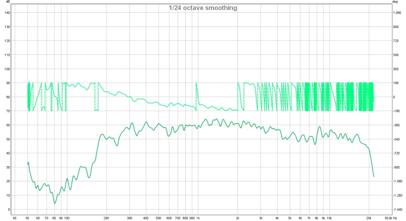

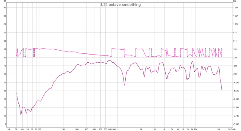

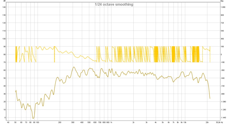

Is the Visaton connected correctly? You seem to have 180° polarity.

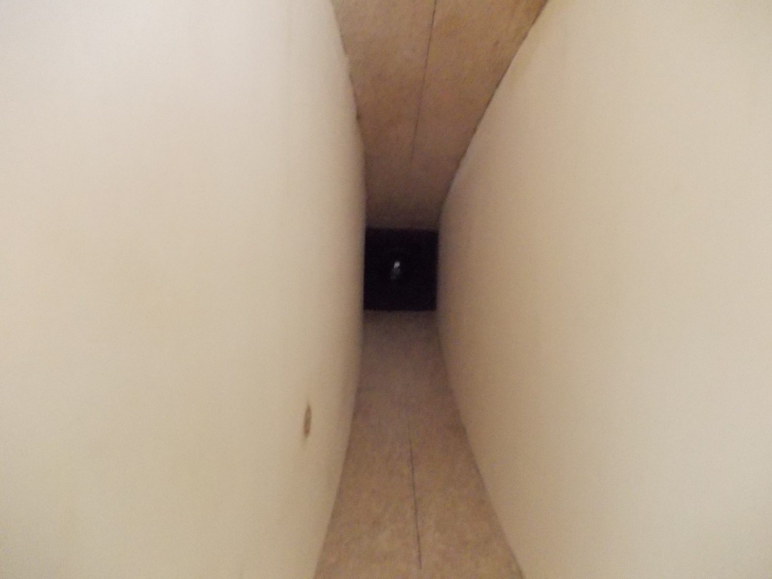

Please post a pic of how it looks like when you look down the throat and make some off axis measurements (0, 15, 30, 45°).

That is really impressive!
/Anton
Did the measurements for you, however the room give trouble.
I did also switch wires on speaker to see what happens first and second picture.
regards
