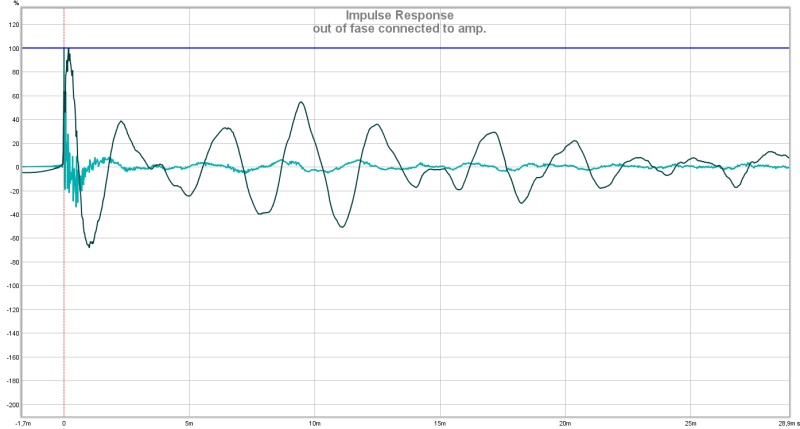

Plot the Impulse Response (tab above) and that will show polarity. A positive going peak means correct polarity (+ve pushes cone outwards). I did not expect reverse polarity to have such a different (worse) frequency response. Odd.

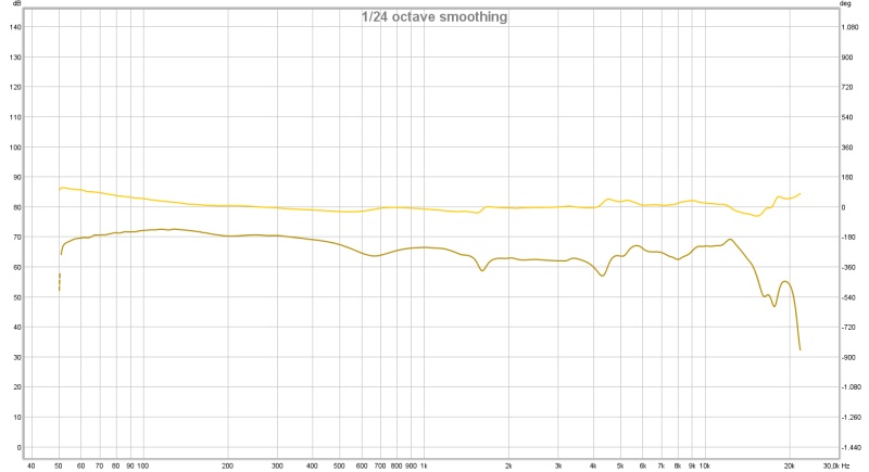

Did as a test measure the headphone who is most of the case lineair and see also dips and I think the wifi transmittor on the roof still do give radiation problems, the antenne give 6 a 8 watts of rf power because it has a reach of 15 km.
Or the problem is the pc input so I make a amp first so I can remove the long cheap thin signal wire.
If you compare that, and see it good, I have some over compensation of the horn, so it is so important to have a good measurement
system.

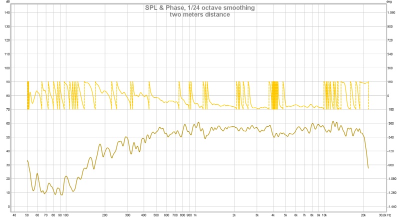

I expect the measuring distance is responsible for the huge change in the FR plot, the second picture with reversed wiring seems more in line with the other graphs. It looks like measurements further from the mouth there are more disruptions to the phase (not real phase turns but reflection/diffraction from the mouth?).

A plot of the impulse would help trace down the problems. Maybe a measurement with an absorber or round foam extension around the mouth?

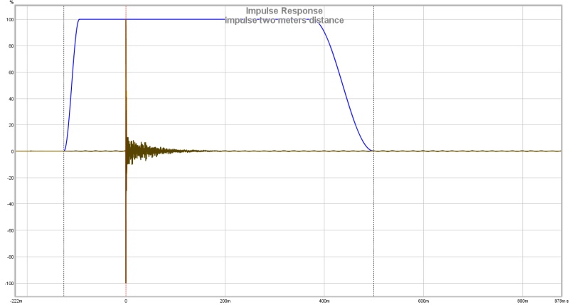

Did a measurement with two meters distance, just to see what happens, I did include the impulse also.
for comparing I did one with the open baffle, also a lot of dips, so room? or the mike, I go build the

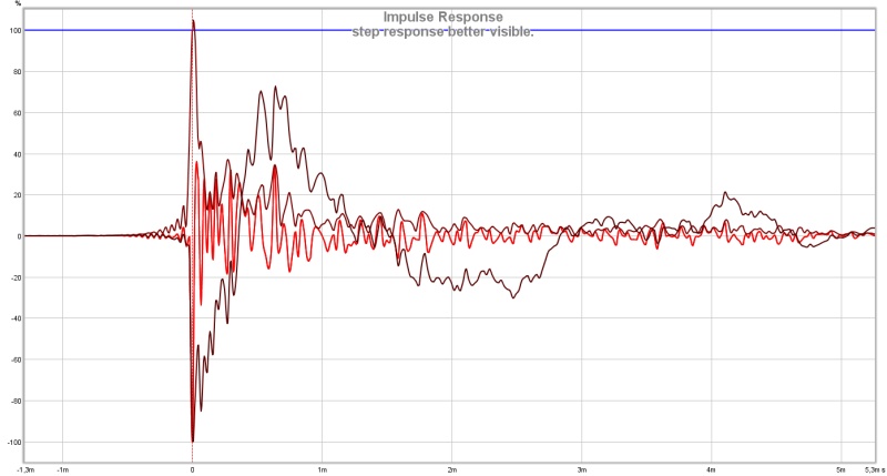

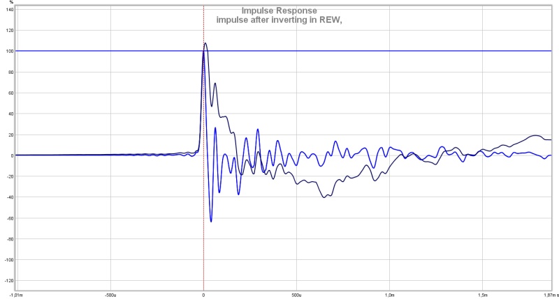

Now zoom in on the first ~20 ms of that impulse...
On that same impulse tab page you can also put a check mark (vinkje 😉) to show the STEP.

This plot shows the initial spike going negative (also the step starts negative) so you have reverse polarity here.

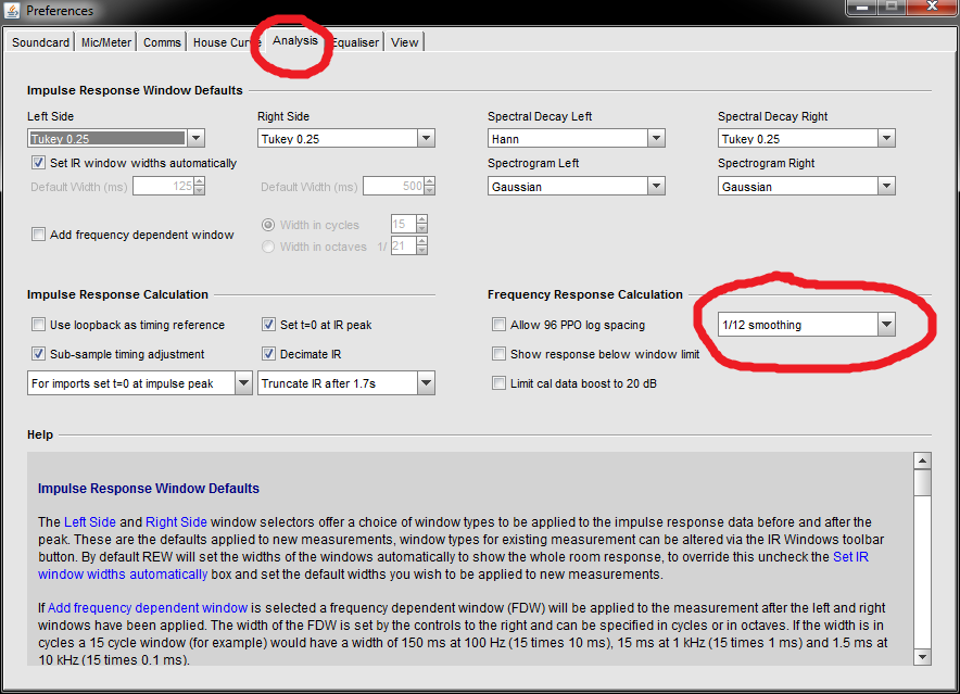

You may want to select default 1/12th octave smoothing - easier on the eyes and provides enough detail. Also, make measurement at 0.5m with horn mouth at least 36in off of the floor, then select 4ms to 5ms gate to get rid of reflections from floor and walls. Plot data from 300Hz and up.
These are all REW basics that you will get the hang of quickly. It is very easy to use and powerful software.
As expected, the biggest peak is down. So it's hooked up in negative polarity. It looks like you have Envelope ticked as well, I see double with both that and the step and impulse 😉.
Envelope isn't needed here (vinkje uit). We do see some restlessness in the first millisecond.

I have checked the polarity but is shure connected the right way to the amp, output to + speaker and so on, only horn is connected.
So what happens here.
I have double check the amplifier connections, all are right, something else do shift fase?, possible the pc mic input or the mic who is not altered, and so there happens a fase shift on the Jfet in that mike, but will this do make impact I do not now, so I do first make the amp so I can use line input.
I go use Plasticine for the fase plug making one as a test with this Plasticine I can make easely a model, is good idea.

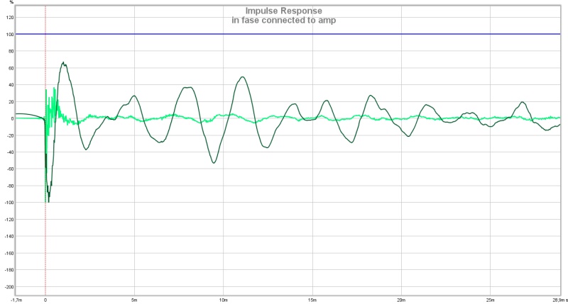

Yet your headphone measurement is in phase:
I'd check with a 1.5 volt battery and watch the cone movement of the Visaton to be sure. Whichever wire is touching the positive terminal on the battery carries the positive signal. If that signal pushes the speaker up, then your polarity is correct, if not, switch.
I have did check with a battery, and the headphone was connected to headphone output of the pc, not the amp itselfs, do now is the hybrid amp the problem, out of phase output!!.
Or the horn shifts fase somehow.
I go try the other output of that amplifier, who is a self designed hybrid.
regards

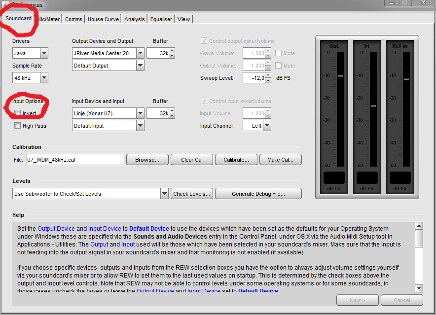

kees52 if setup for amp or microphone chain reverse polarity some where then there's a general setting into REW that can correct.
At top right corner hit the wrench icon and see picture one below for location, also when you are there see picture two how to get REW present plots as default 1/12 smoothing as xrk971 requested.
the 1/12 smoothing I have already found and corrected, the rest I go also, thanks for learning me.

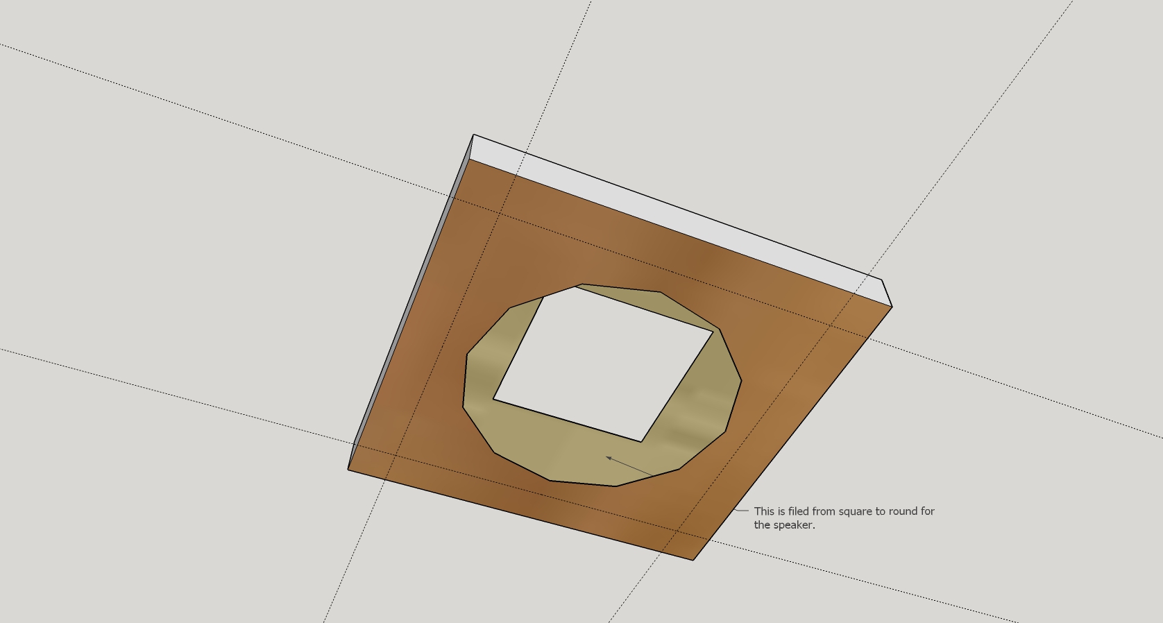

Hoping you can help Kees out with a phase plug Onni. 2in x 2in square throat - what can we do? I am sure you have some good ideas...
Thanks,
X
Is the speaker cone larger than the entrance and connected with this?
That could already be considered a phase plug and is probably partly why the response already is very good. I don't have any suggestions straight off. Might be good to focus on the rest of the task and later return to this when all else (injection ports and crossover) is working 🙂

Hi Anton
The room between cone and the throat is larger I file it from round to square part, Idea is to make it smaller when a fase plug fits in, but see different conceps on the internet, but miss the earea where air has to pass through without problems, the square is 4.5 by 4.5 cm, and speaker 6.8 cm total inc rubber surround on cone, only cone is 5.5 cm, so minus max excursion slot has to be 5.2 cm . I go get some Plasticine who get hard without a oven to test some things.

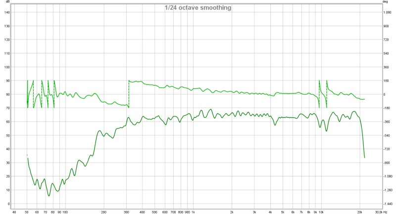

But I have inverted the input on REW and put Horn higher and more in a corner, but still not high enough like one meter and get this respons, but I finsh tomorrow the good mic amp and mike to get even better results.
But picture looks good, even more high output as you see when correcting the sound card cable who is quite long.

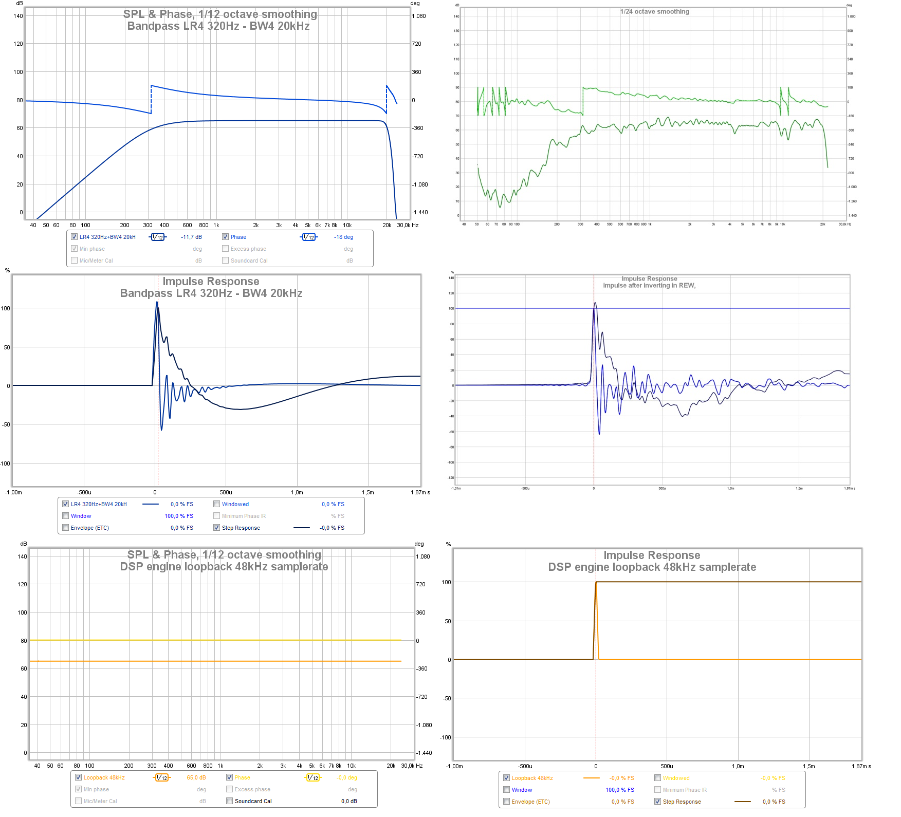

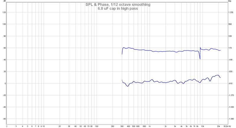

kees52 your data looks good.....😎

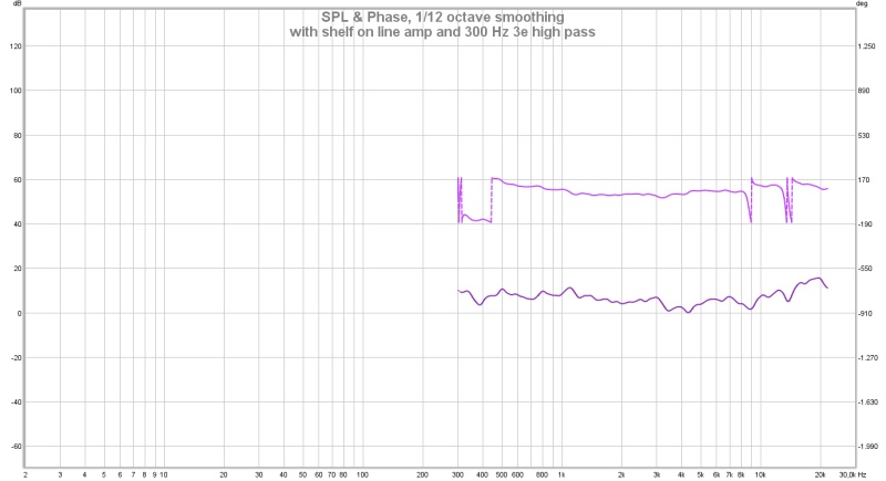

Below is live DSP engine in electric loop measured by REW, set a bandpass device LR4 320Hz - BW4 20kHz to get close to your FR seen at second plot post 600, then IR/SR compared to yours from post 618, and final to show we should be able to trust the DSP engine show a loop with no filters set.
Nice experiment Byrtt! You are really good at this and it appears all that hash and ringing is strictly a function of the bandwidth function of the speakers response. Very interesting.
