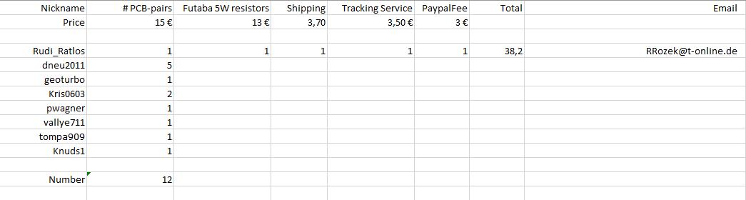

I have prepared an EXCEL sheet for the current ACA-PCB order (see image attached).
I have taken my forum's nickname as a "standard" order.
The standard contains:
- 1 pair (2 pcs.) of ACA PCBs (cost: 15€)
- 12 (4 x 0R22, 4 x 0R47, 4 x 0R56) FUTABA 5W resistors (cost: 13€)
- registered shipping (cost: 7.20€)
- PAYPAL fee: 3€
This sums up to 38.20€.
If it is o.k. for you: please transfer the sum to my PAYPAL-ID: RRozek@t-online.de
Do not forget and leave your Forum's nickname, home-address and EMail-address in the PAYPAL sheet.
If you want to change anything (f.e.: no resistors): leave a message in the thread.
I will order next Friday (08.01.2021) for those, who have paid me.

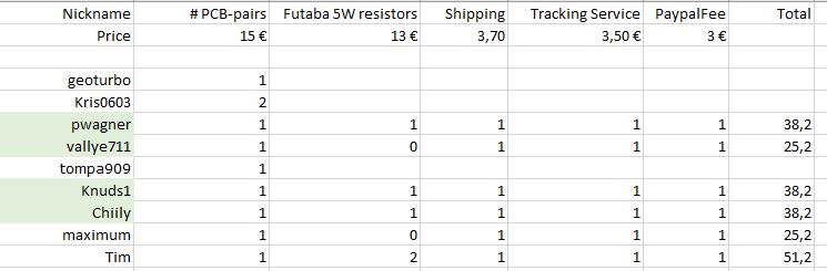

Gentlemen, find attached an image with the current status of the order.
I will include a CD with a couple of tracks (.wav) of a "AreYouAuthentic" - Sound-Juror CD.
I have attached the 2nd file of it - so you know, what I am talking about.
Not only will you be able to confirm that you have done everything right with your current build, but this CD allows me to send you the letter
with your order (PCB and resistors) as "documentation letter", the shipment of which costs much less than a "parts letter".
Best regards - Rudi_Ratlos

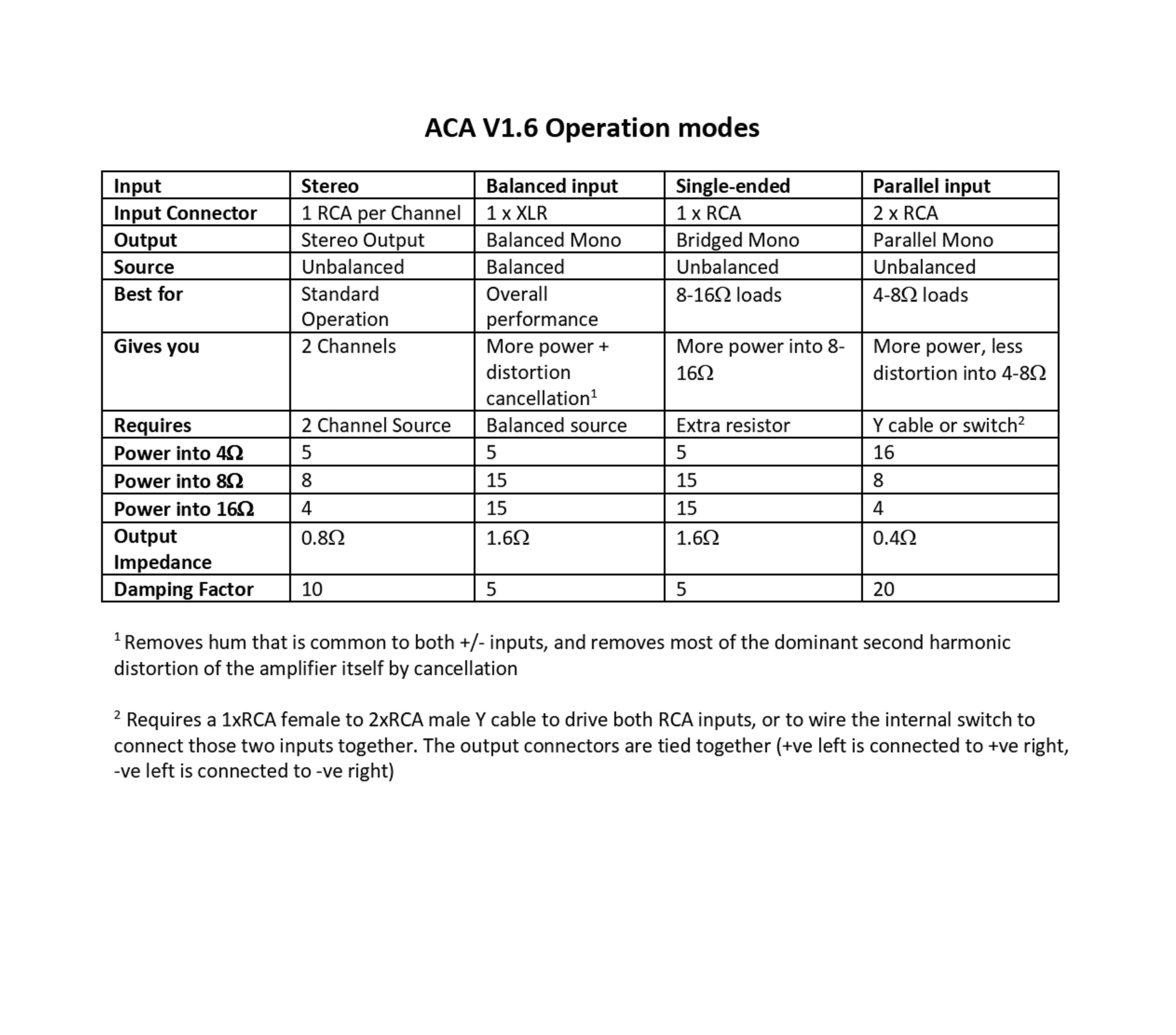

@geoturbo: have a look at the attached picture showing the ACA's possible operation modes.
@nautibuoy: chiily's build shows 2 speaker ports (Spkr and SpkrRtn) driven from his ACA. IMHO he built a "standard stereo ACA".
@chiily: your build looks o.k.

Do never even think about bridging an ACA!
I have once listened to a bridged ACA and have been very much disappointed by its sound.:confused:
If you need to provide more power to your speakers: think about building another ClassA (F5, F6, M2, ...)

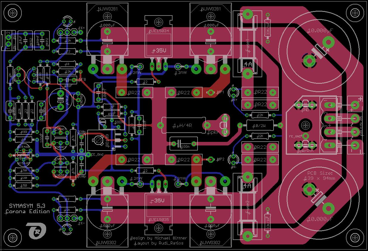

- or change to ClassA/B - "my SYMASYM" (2nd image) for example :)
- or even think about bi-amping your speakers with ACA (heights and mid) and SYMASYM (Sub)
Regards - Rudi_Ratlos
