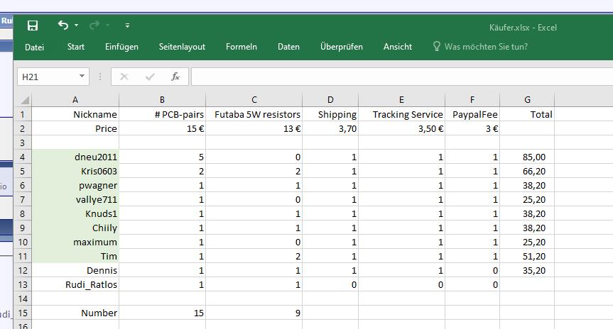

Find attached the final order - EXCEL sheet.

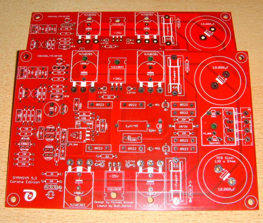

I have told you about plans to use the ACAs together with a pair of SYMASYMs in a BI-amping / active (?)
scheme to drive speakers with an impedance of < 8 Ohms.
I have 3 pairs of the SYMASYM , shown in the image below, left.
Is anybody of you interested to have a pair? A pair of SYMASYM PCBs costs 15€.

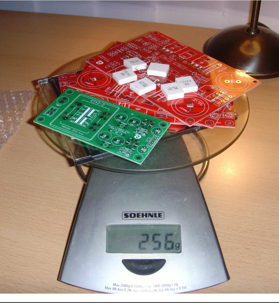

Peter, since the weight of the PCBs (2 x ACA plus 2 x SYMASYM plus a green PCB ), MPC resistors and Audio-CD does not exceed 500 gr,
I will include the SYMASYM PCBs in your ACA letter and you do not have additional shipping costs.
So: if you like to have the SYMASM PCBs: please transfer 15€ to my PAYPAL account.

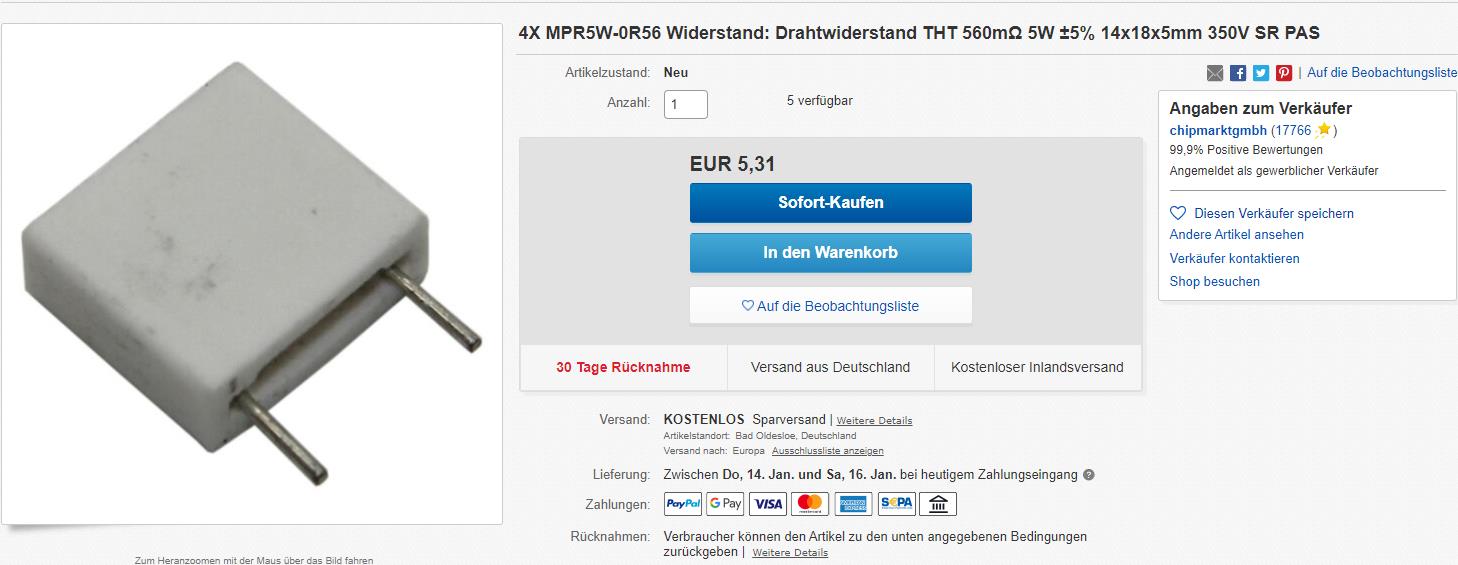

Patrick, I do not have any surplus MPC resistors at hand.
If you faill finding them (ebay.com?), I can order (if you like) the ones shown below.
The cost for 4 pcs. incl PaypalFee will be 6€.
Regards - Rudi

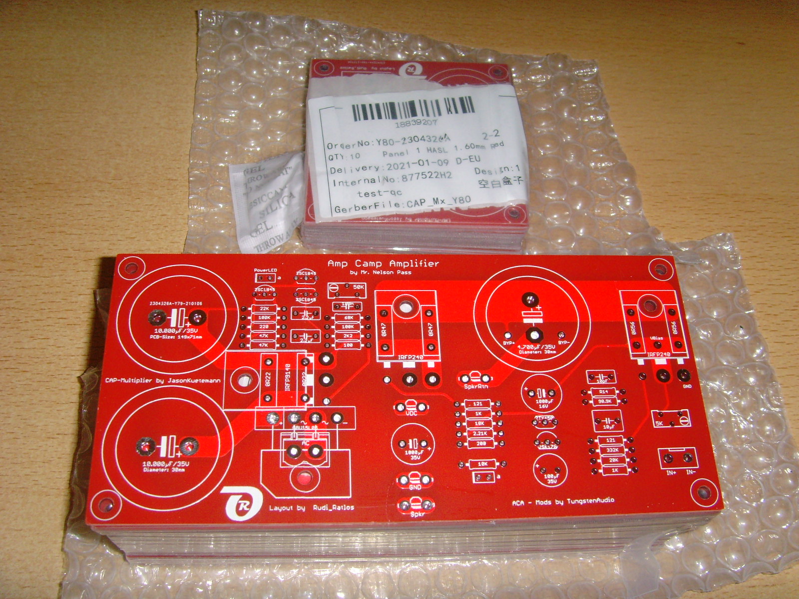

Gentlemen, I have received the "Premium ACA PCBs" this morning (image 1).
