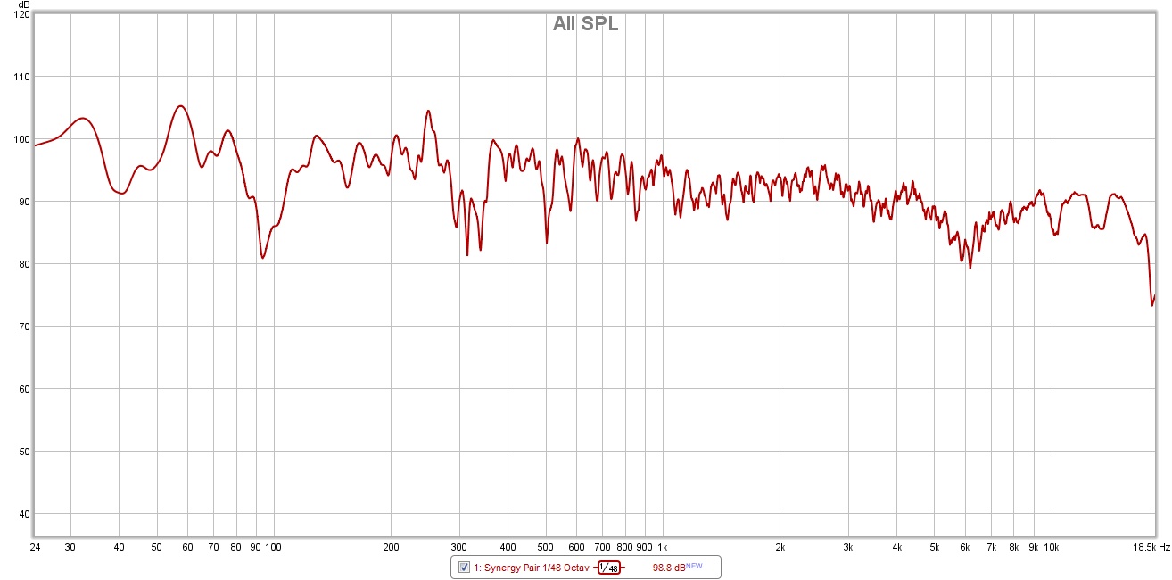

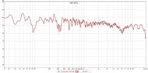

In the current configuration I've taken a measurement, 200mS window, both stereo speakers, at the listening position. The graph is smoothed at 1/48 octave to average out the hash that occurs with measuring this way from reflections furniture, microphone stand etc. There is a room mode null at 90 hz and peak at 58. Impressively even midband.....

If I understand this correctly, you had both your left and right speakers playing for the measurement? Is that the reason for the dip at 6Khz? Was the mic not exactly between the speakers (off by a couple inches maybe)?
It looks impressively smooth. Thanks for sharing.
Yes, this is both speakers playing the REW test signal. The gate time was 200mS which equates to 68.6 meters or 225 feet. So the reflections included in this plot are ones that have made multiple bounces off of the surrounding environment. (Longest room dimension of 20 feet.)
The dip could be both an off center microphone and a reflection off of the not very absorptive sofa fabric that was a few inches behind the microphone.
Keep in mind the measurement was made in a room with ZERO room treatements. No diffusion or absorption on the back wall other than an oil painting. Side walls have curtains and windows on one side and curtains (to make it a mirror image on the other.) The curtains cost $20...at a Bed Bath and Beyond clearance so the acoustic properties were not a first order concern.
