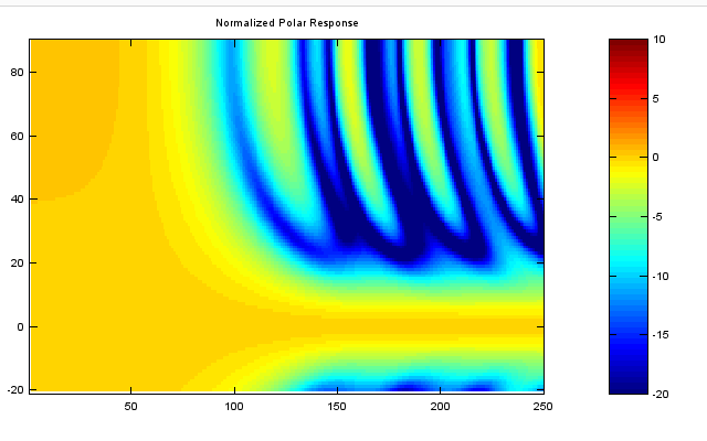

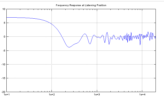

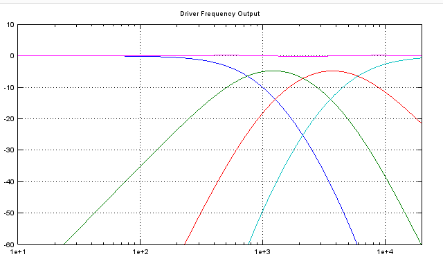

Here's the update with the theoretical stuff, ignoring actual driver limitations of all kinds.
Simulated as follows:
Crossover frequencies = 750, 2140, 6000
Driver Vertical Positions (inches) = +/-18, +/-6.33, +/-2.25, 0
No Baffles, No wall reflections, etc.
The driver frequency response graph shows relative outputs for pairs. The tweeter doesn't have a match, but it needs to match the relative levels of the other pairs (summed). So the tweeter needs to reach the shown level by itself, while all the other speakers rely on a partner to help reach the level shown.
Also, I didn't want to complicate things to add tweeter directionality, nor did I want to show a polar response that transitioned to omnidirectional at the highest frequencies, so I added a pretend crossover to a supertweeter at 20K for the polar and listener position frequency response graphs below. This listener position plot only takes into account the first floor and ceiling reflections: no walls, no higher order reflections. It's just a representation of how well the first vertical reflections could have been mitigated.
On the polar plot, 100 = 205 Hz, 150 = 945 Hz, 200 = 4347 Hz.
The source code wont upload with a .m extension, so I gave it a .txt extension. It should accept any number of crossovers more than 0. Also, a parameter was included to scale the driver spacing.
Are the drivers paired vertically above and below the tweeter?bbutterfield said:This listener position plot only takes into account the first floor and ceiling reflections
The comb filtering at fixed wider angles that could be caused by the distance from each driver in a pair swinging in and out of phase with frequency. If you want, this is ok as a way to effect directivity but you may need closer spacing within a pair. You can use more than two of each driver to extend the array length for lower frequencies. The floor and ceiling will mirror the length if you locate the woofers within range.
On the polar plot..
You could use an absorptive waveguide to help clean up the vertical combing "trails" that are near the pressure average.. a'la Duntech/Dunlavey & Lipinski.
