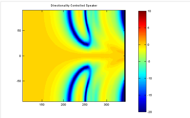

Specifically, I'm considering a wide baffle of more than 2 feet across placed directly on the wall, but angled. (See attached picture). The speakers would be triangular prisms (with a triangular base). The speaker depth would be small: half the baffle width or less. As a result, the depth would be small compared to the wavelength of frequencies that wrap around the baffle; resulting in minimal ripple from the reflection off the front wall (to the outside of the speakers). I'm really not sure how bad the front wall reflection (to the inside of the speakers) would be with such a narrow angle between the baffle and the wall. I suppose some mid/high frequency treatment might be in order. Don't corner horns use the room walls to extend the horn in a sense? What's been done there?
At any rate, if the vertical arrays null the first floor and ceiling reflections, and if the front wall is managed as described above, that seems like a good starting point for any room treatments and/or EQ. It seems there is almost a consensus that the lateral wall reflections are preferred, anyway, so preserving them might be a benefit of this approach.
It is difficult to get HF drivers close enough into a corner to survive the jump off unscathed. That is assuming you start with directivity matching the walls, and it is probably best to give it space to let you diffract it cleanly. It is easier at lower frequencies, and easier if you can mount the drivers behind the wall.I'm really not sure how bad the front wall reflection (to the inside of the speakers) would be with such a narrow angle between the baffle and the wall. I suppose some mid/high frequency treatment might be in order. Don't corner horns use the room walls to extend the horn in a sense? What's been done there?
