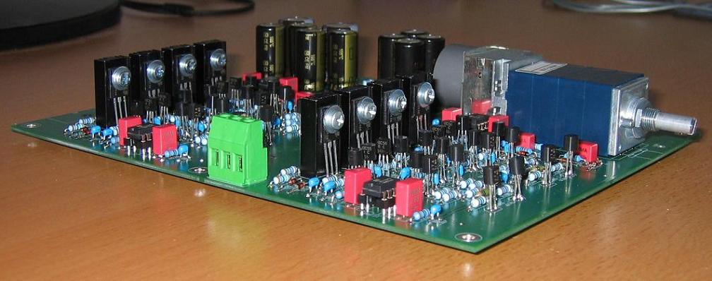

Hi Jen,
yes, it is possible even with standard idle current setup (40mA), that is class A up to 80mA.
I have just measured distortion into 75ohm at 1Vrms, and it is below 0.001% both THD and CCIF IMD 19+20kHz (with JFET's with Idss = 8.5mA matched within several 0.1mA). No high harmonics visible (re my measurement resolution)
I have also added technical parameters to Dispre 2 -

A balanced version is a nice idea, but... that balanced Alps may be a problem for you...
I've measured several two-channel Alps RK27 and the mismatch at low rotation (approx. 0 - 30°) was relatively poor, and if that error is repeated in a balanced configuration that might be a significant problem.
I think in balanced configuration you may need to consider a stepped attenuator?
I am preparing a fully balanced version of this preamplifier. It will have true balanced inputs and true balanced outputs. Quad Alps as a volume control. The prototype PCB is already being produced.
Is it possible to connect unbalanced source to this version too?
Maybe 64 position relay attenuator would be much better solution than quad Alps...also the costs are quite similar..
It is possible to connect an unbalanced sourced, but you would get an unbalanced output then (hot, ground).
Yes you are right, the relay or stepped attenuator would be more precise, but you can certainly connect it by wires into the pads of the quad Alps position.
This is a symmetrical version:

I am definitely interested in the balanced version. when do you expect to have PCB finished? will it drive 28 ohms headphone load balanced? or do I need to add a buffer? this is excellent as I just ordered a heap of LSK170 and LSK389. I ordered at 8ma, is this suitable for all positions, or should I get some other idss values too?
build will not be reasonably priced for me as I do not use analogue pot, this will be tacked onto a dac with digital volume. I will have my DCB1 buffer in external box for driving cables to active monitors.
