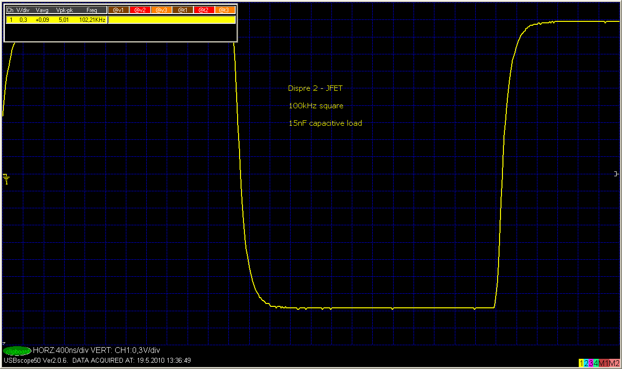

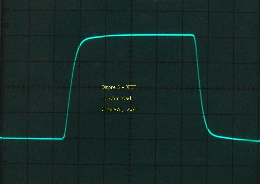

Do I see 45V/us into a resistor load and 25V/us while charging 15nF?

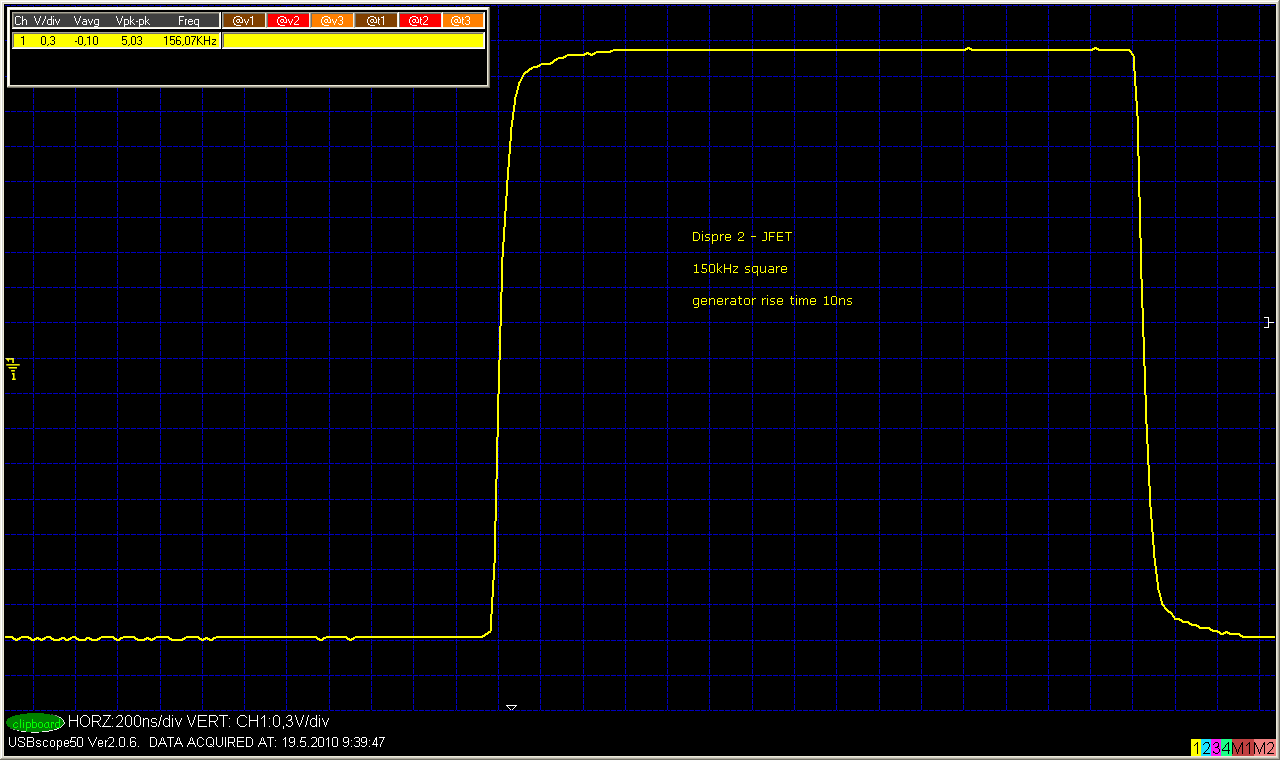

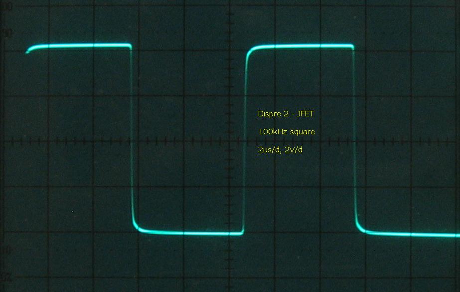

Both is RC exponential charging, not slew rate. My fast gen gives 2Vp-p max., so I do not know slew rate yet.
The previous measurement was for usual link level, a bit below 1V. Now the large signal, both in time and frequency domain. For the FFT, there is a resistor divider at the preamp output.
Analog scope is still the best one. Output cable terminated by 50 ohm, to eliminate reflections.

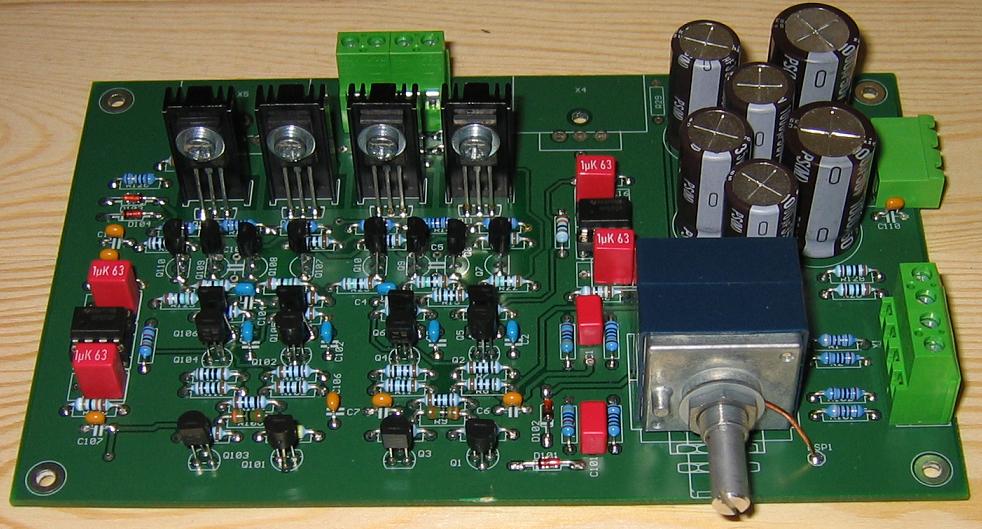

I would like to speak a bit about design goals of this project.
Engineering
1) excellent linearity even at high frequencies
2) inherently very fast, very high slew rate
3) very stable
4) low noise
5) class A output stage
Subjective
6) very good sound

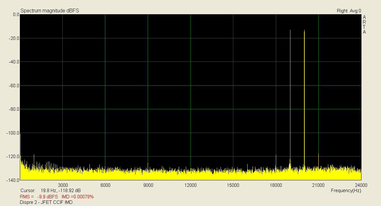

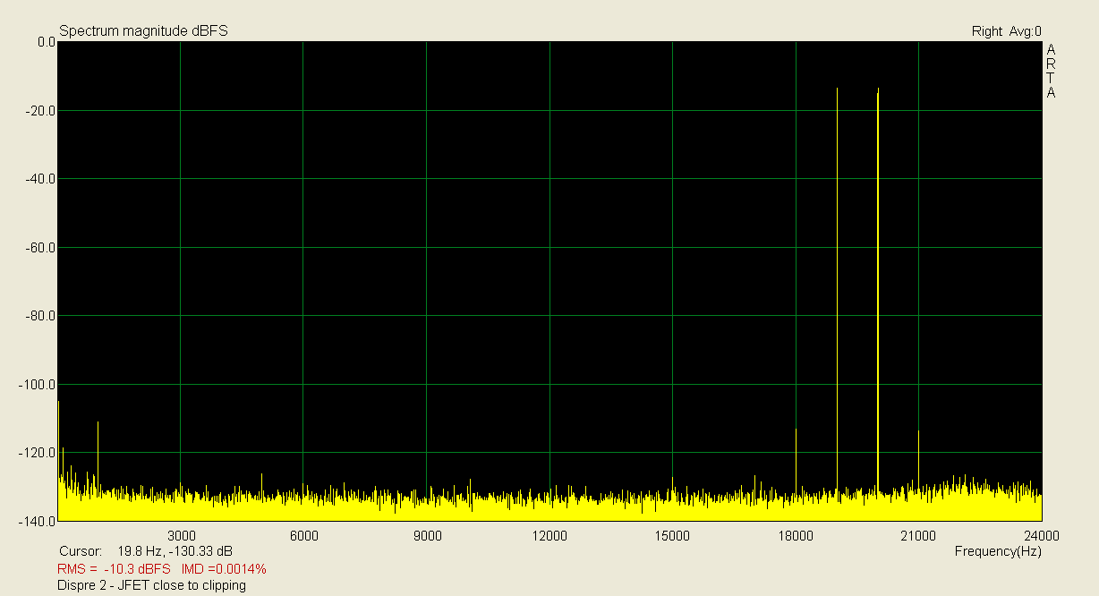

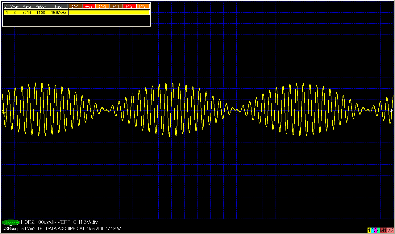

I believe all the goals were achieved. I have already shown CCIF IMD results, which are below my measurement threshold for practical link level output.

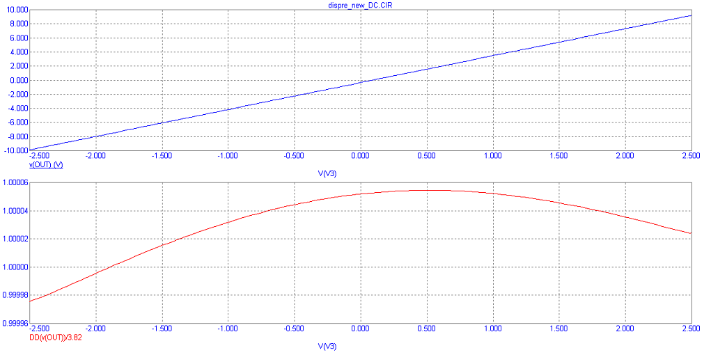

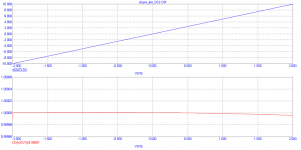

Now i would like to add simulation comparison of Dispre 2 vs. Dispre 2 - JFET static linearity. They are for output voltage range -10Vp to +10Vp. Red line shows normalized dVout/dVin, i.e. normalized gain vs. input voltage. Blue line shows output voltage vs. input voltage. Finally I attach 100kHz square response, without capacitor in an input RC filter. In this case, the preamp has 3.68MHz -3dB corner. This will be reduced at some 200kHz by input RC filter.
